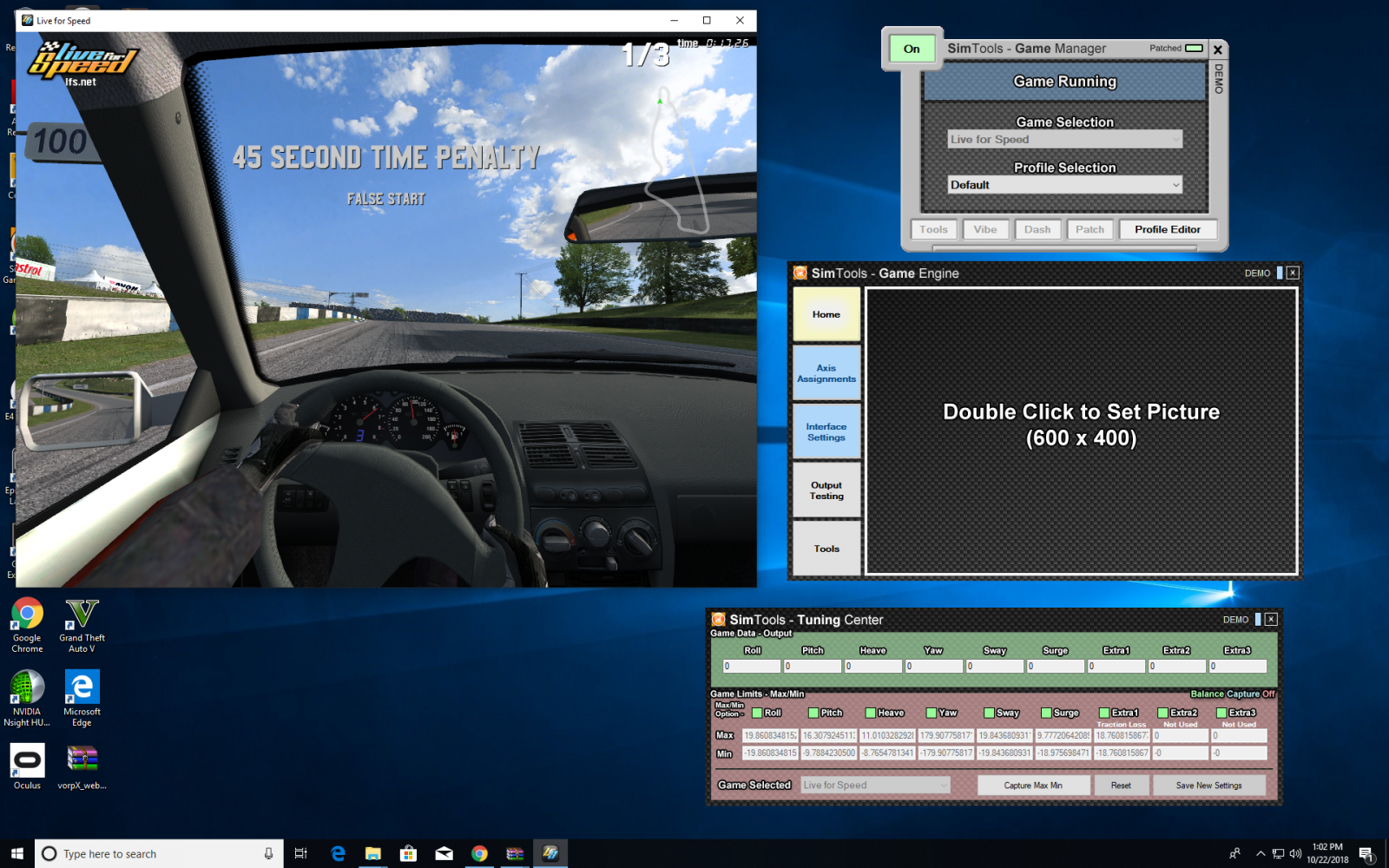

    I am testing the output from LFS with simtools 2.3 demo.
    With the following setup, the game manager can show connected information but there is no output in the tunning center. Please help.

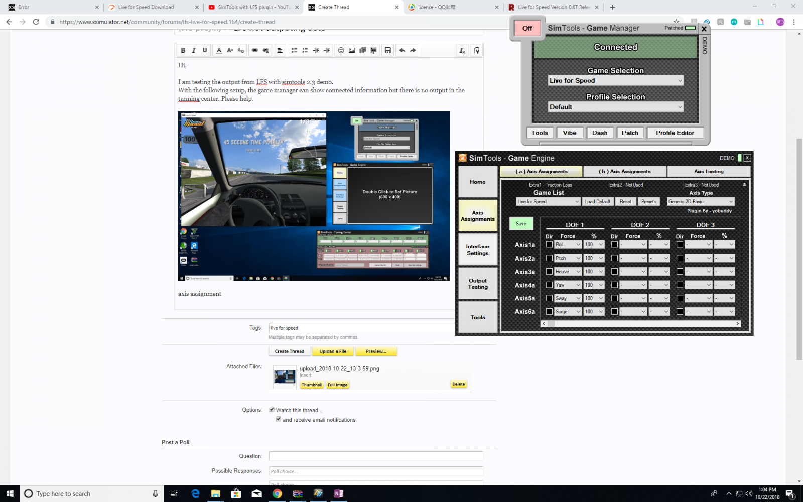

    axis assignment

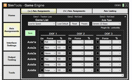

    the axis assignments might be unclear

    the LFS version is 0.6T
    @yobuddy I wanted to test the Video Ride Recorder with LFS but found even more problem. LFS used to work fine with default setup (output is normal in tuning center) but now it can't work. The simtools I was using is a newly installed version 2.3. But the LFS wouldn't work on another computer with PRO licensed v2.2.5

    Un-patch LFS.
    Then launch the game and complete a race.
    Exit the game and re-patch it.
    Out of all of the games, I know LFS works, I use it for testing all the time.

    Thank you @yobuddy This works! The video recorder is working fine but cannot capture data. I will detail the issue in the other thread under video ride recorder.
