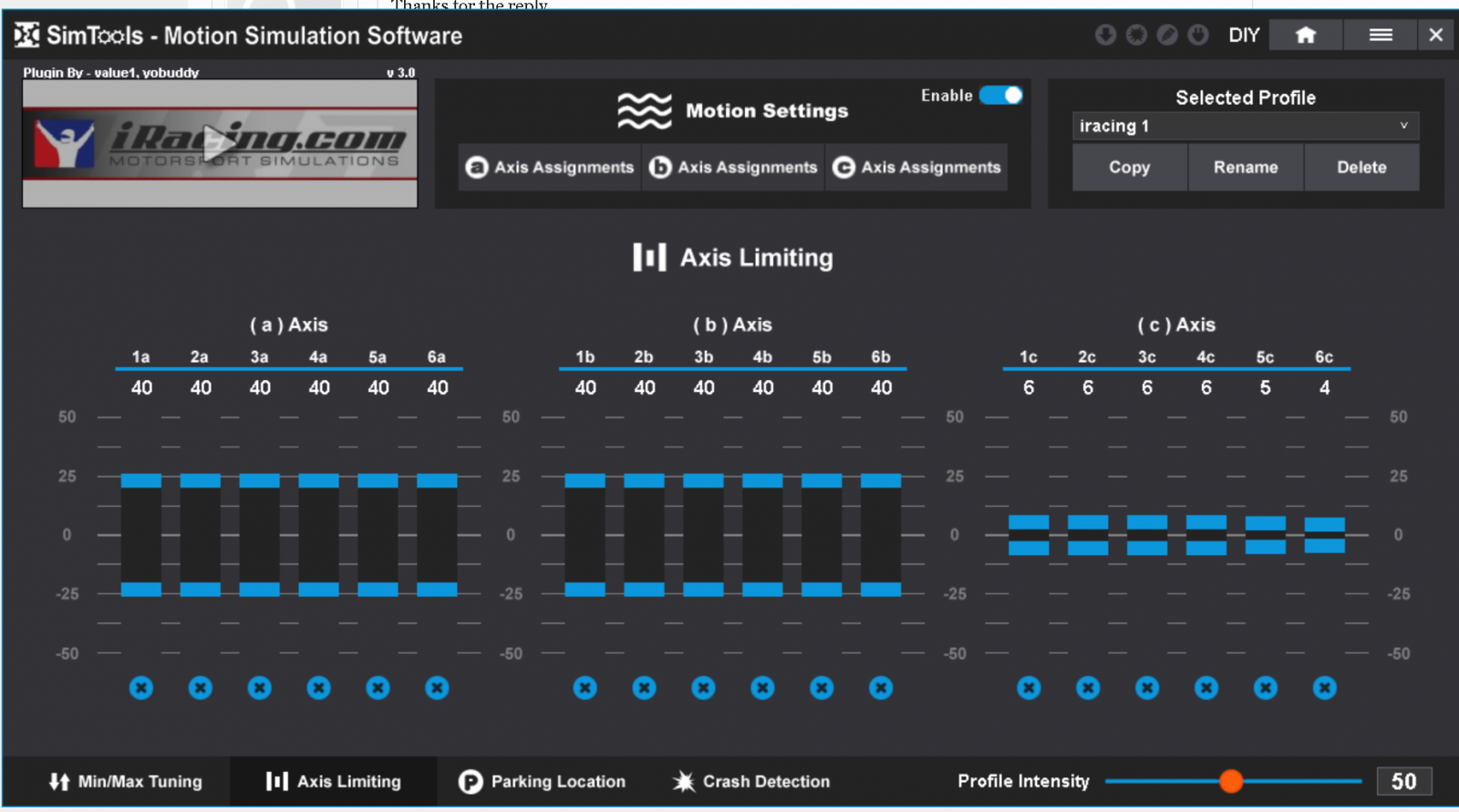

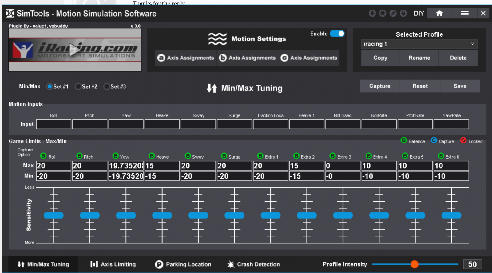

    +5,038 / 16 / -0
    Where did you download the plugin from?
    V2 plugin are on xsimulator.net, and v3 plugin are downloaded thru the app or from simtools.us.
    For now don't use the axis limiting section (screenshot 39).
    And for now leave (screenshot 40) page set to linear.
    Next can I see the axis assignments for the game?
    Chat soon,
  5. JDEWizard
    JDEWizard New Member Gold Contributor
    Jul 15, 2023
    12
    80Coins
    yobubby,
    Thanks for your reply

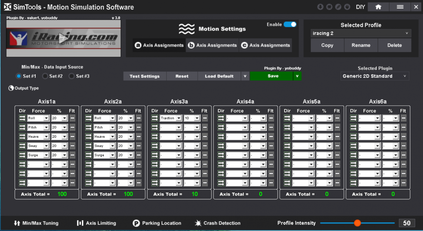

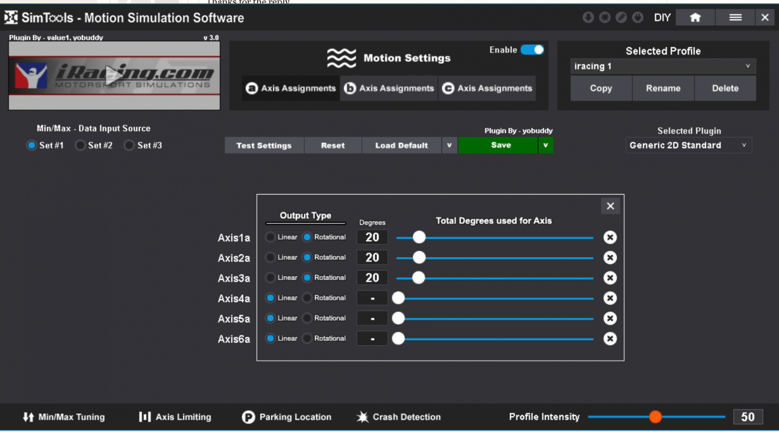

    I plugin Iracing thought the v3 app.
    here is the screen shot of the axis assignments
    JDE Wizard

    I'm not sure what your sim looks like, but I suggest doing one DOF at a time.
    Like start with surge, get it working, and then set it to 0 while we do sway.
    Just getting surge and sway working on the sim will help a ton.
    So maybe put surge on axis 1 and 2 at 50%, and then run the game and see if its working correctly.
    If its backwards, then click the 'Dir' button on both surge assignments to flip the direction of the DOF.
    Give it a try and let me know how it goes buddy.

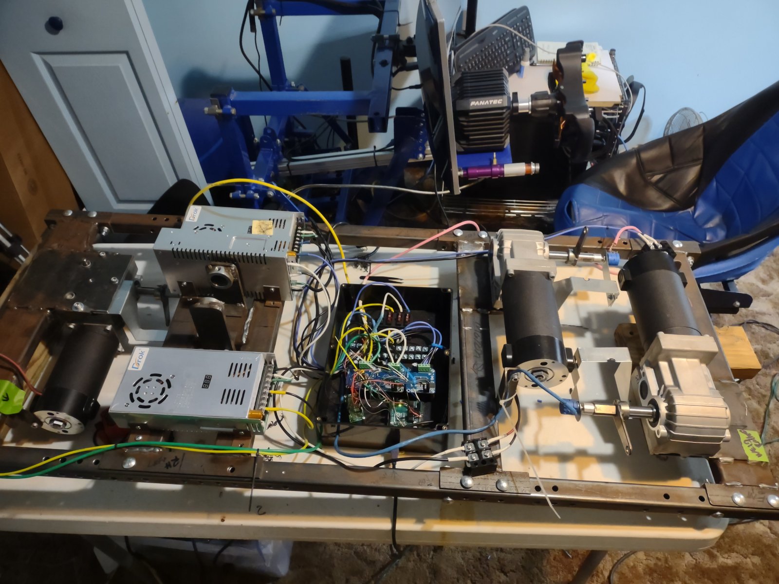

  8. JDEWizard
    Jul 15, 2023
    12
    80Coins
    yobubby,

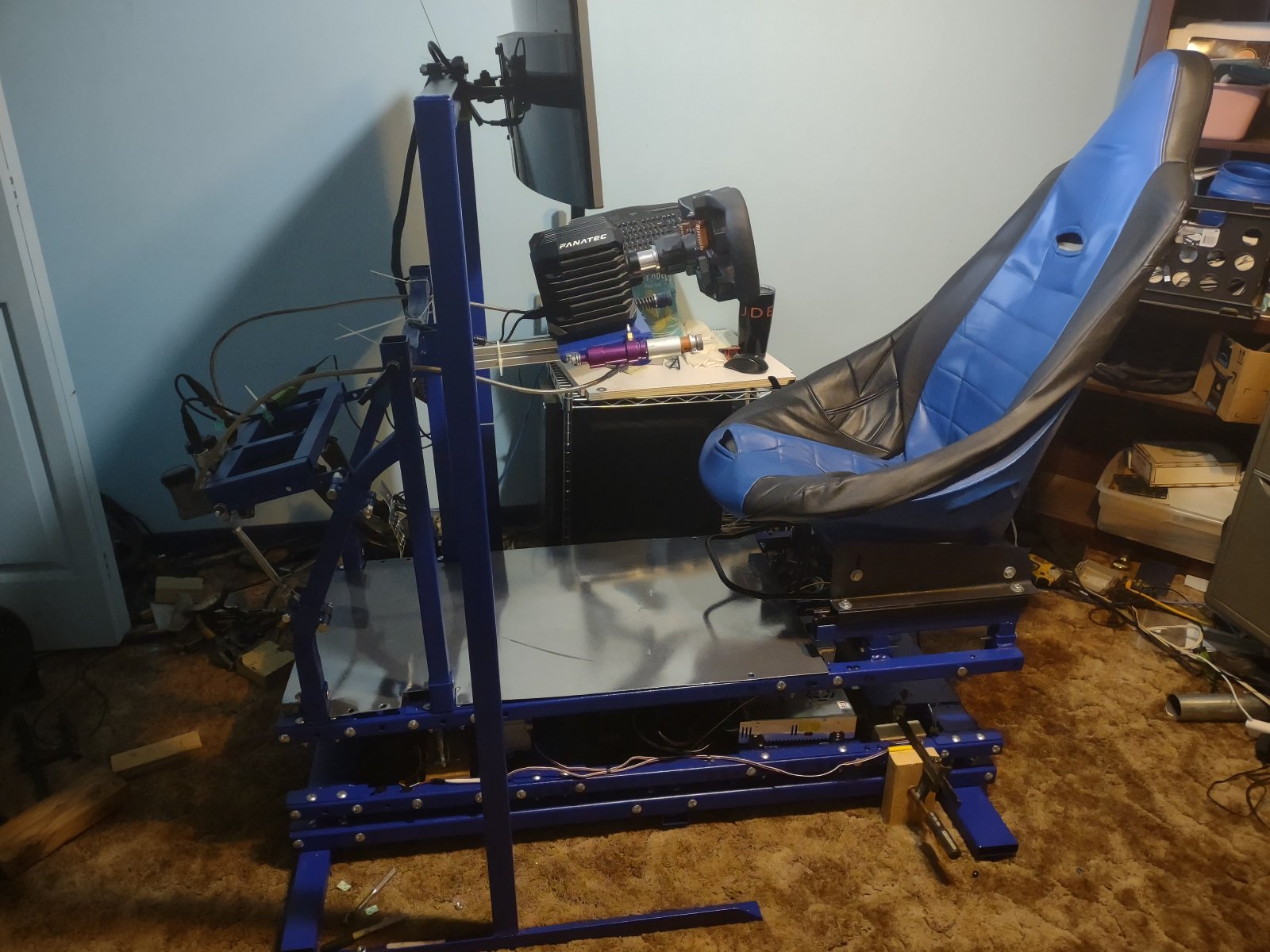

    A few specs of my rigg .
    has arduino uno r3
    3 ) IBT2 motor drivers
    3) 24 volt 350w motors with 32.1 ratio. ( has 2.75 center hole the center hole arms .)
    3) 24 inverters 450w
    Pictures are attached
    Should I uninstall Simtools v2 from the computor? would it help?
    Thanks For your help!!!

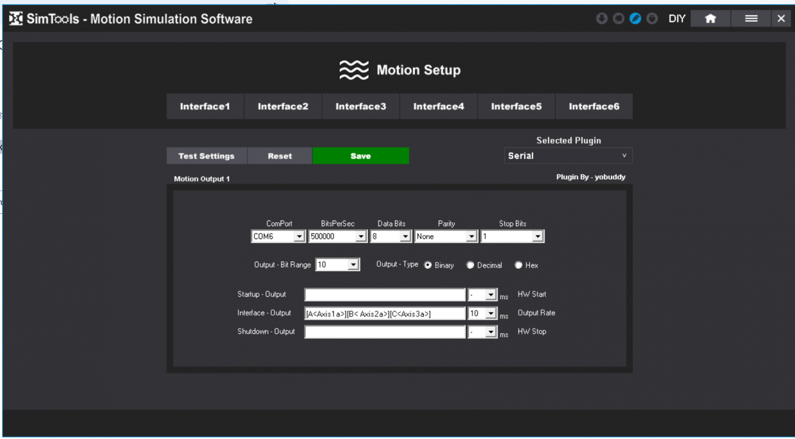

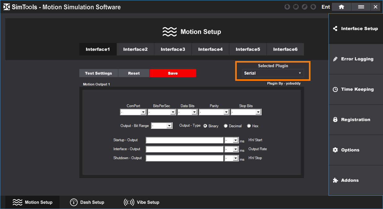

    So we need to setup a motion Interface in SimTools. Let's setup Motion Interface #1 in SimTools v3.
    (If you need to, you can install the Serial Plugin from the plugin manager - under Interface plugins)
    Click the hamburger menu, and then select Interface Setup, then select the serial plugin.
    The settings for the smc3 sketch is found toward the bottom of the first post here.
    but here is the pic.
    Now after you fill out the form and hit save, click the Test Settings button and see if it is now working.
    (Be sure that the SMC3 app is not running)
    Please give this a try, and see if we can get the interface setup and tested.
    Please let me know how it goes.

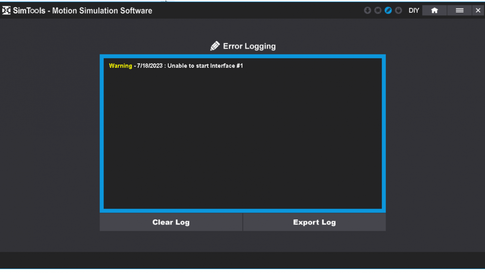

  12. JDEWizard
    Jul 15, 2023
    12
    80Coins
    Good Morning yobubby,
    I have inputted the information as above in my #1 interface . in which was a little different than what I had .
    I tried a test. I heard a beep, and code came up.
    I have attached screen shots.
    I am so sorry that this has became a problem!!
    I do Thank You for the help!!

  15. yobuddy
    5,167
    48,248Coins
    +5,038 / 16 / -0
    It's totally ok buddy, it's what I'm here for. :thumbs
    This means interface could not start error.
    (but you know that, just here for others)
    Swap the leads with the two motors, does the second motor now work?
    Or does the original motor still work?

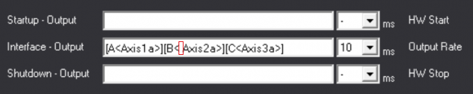

    It looks like you have a space in your interface output line.
    "B< Axis2a>" and it should be "B<Axis2a>" (no space) - the space is after the 'B<'

    yobubby,
    That was it :thumbs The testing and getting the motors working.
    Now I tried to load into Iracing.
    Iracing loads but not motion.
    **What do I it need to do, to make sure I have downloaded the game correctly?**
    And Thank You for the help on the motors.
    it appears that largely it was the space in the interface code.
    go figure!!!

    Now that both axis are working, you can configure and test your axis assignments for Iracing.
    Once everything is configured correctly, then give the game a go.
