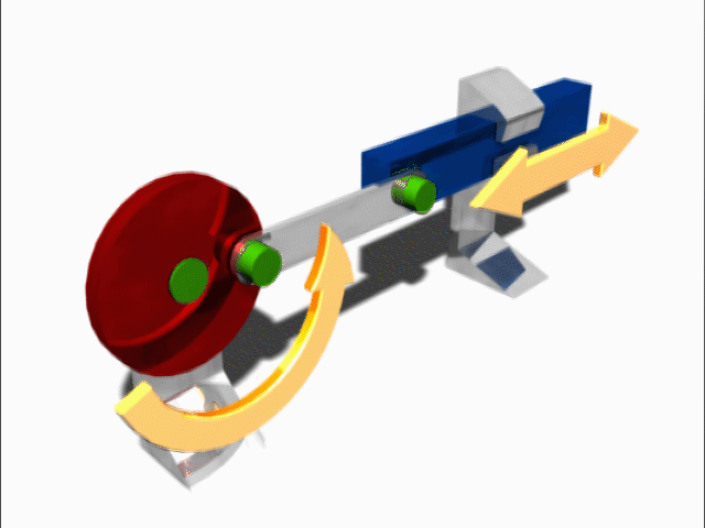

    DC motors can do the job:
    - rotation like joyrider design
    - translation Frex-like design (see below)
    Nice achievement between Unity and Arduino :)
