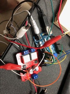

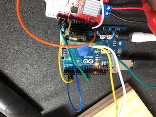

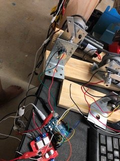

    Hi guys.
    I'm new to all this technology. But since i'm retired i have time to work and learn. I had read the 96 pages of the SMC3 thread and i had started to develope my own sim, using the information and software developed by rusfuus. Looks excelent.
    I have had a bit of problems trying to set up the motors..
    I'm using Arduino UNO with Motor Moster Shield and SMC3, also 3 Wipper Motord 12V, 30 Watt, 50rpm no load and torque of 6 Nm.
    I have had bad luck, since the first MM1 blow one of the capacitors burn, then the second one MM2 does not do anything with motor 1 or 2, with MM3 operates well the Motor 1 but does not do anything with Motor 2, no even the lighst turn on. With MM4 both motors operates without the pots but one rotate CW and the other CCW, but i can't make them work with the pots to auto regulate.
    I can hardly understand how i could bought 4 monster motor bridges that are bad. Any suggestion, will be highly appreciated

    @norbeast To understand better here are some videos of my connections.
    Right now i'm using MM4 only one motor connected, no pot attaced to motor

    noorbeast Thanks
    I will try again, but "With MM4 both motors operates without the pots but one rotate CW and the other CCW, but i can't make them work with the pots to auto regulate." it might have anything to do with the deadzone parameter?
    i will let you know

    noorbeast
    I did connect the pot's, but since they only rotate in one direction, the feedback reach the max limit on the second cicle....
    as i said before, with MM2 motor 1 works fine, and motor 2 does not work at all. led's does not even lit

    Thank for your input.
    You right. I decide to move to IBT_2 and now it's working.
    Do you think it might be good to have double bridge to drive the motors? I'm also changing the motors for
    Tarp Motors on the market! 12 VDC, 2 HP, 1200-WATTS, 40 AMPS, Reversing Gear Motor, 50 NM Operating Torque and a 90:1 gear ratio.
    i'm a 260 pound person.

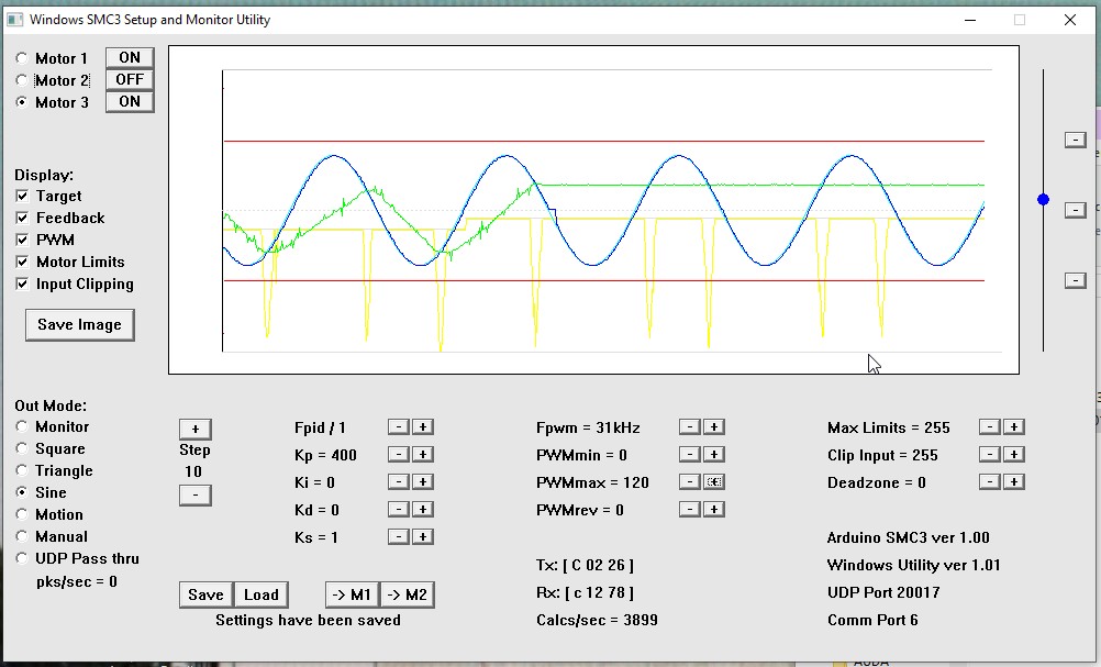

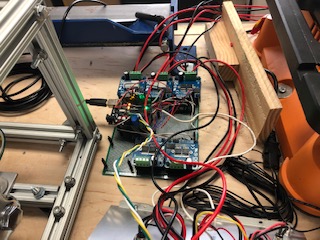

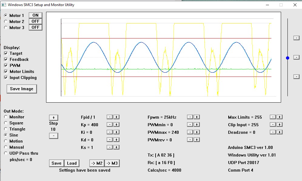

    Hi guys.
    I had been working for the past two week on my rig. After a succesful setion i did connect the 3 windshield motos and the look to operate perfectly, no load.
    I diside to change the windshield motors for 2HP 12V Motors, to support my weight. Also i diss assemble a new circuit board to have all together the 6 IBT_2 (Two for each moto, at this time only using one), the ARDUINO UNO running @RufusDufus SMC3 and the control ON/OFF circuit for the Mining 1600 Watt Power supply that i'm using.
    Also now the pot's are not attached to the motor shaft, i had include pulleys and belts to sincronize them. look at images.
    Finally when i start checking the final assembly i'm having problems again.
    Motor 1, its not working at all
    Motor 2 works, but saturates because its not following the TARGET, same with Motor 3. look at the prnscr of the SMC3 Utilility.
    Do i have to reverse 5V and GND for the pot's in order to correct this situation? or if i change the voltage on each motor it would be ok?
    Also i do imagine tha BRIDGE for motor one have gone and i should replace it.
    Please any comments would be highly appreciated.

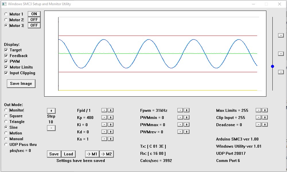

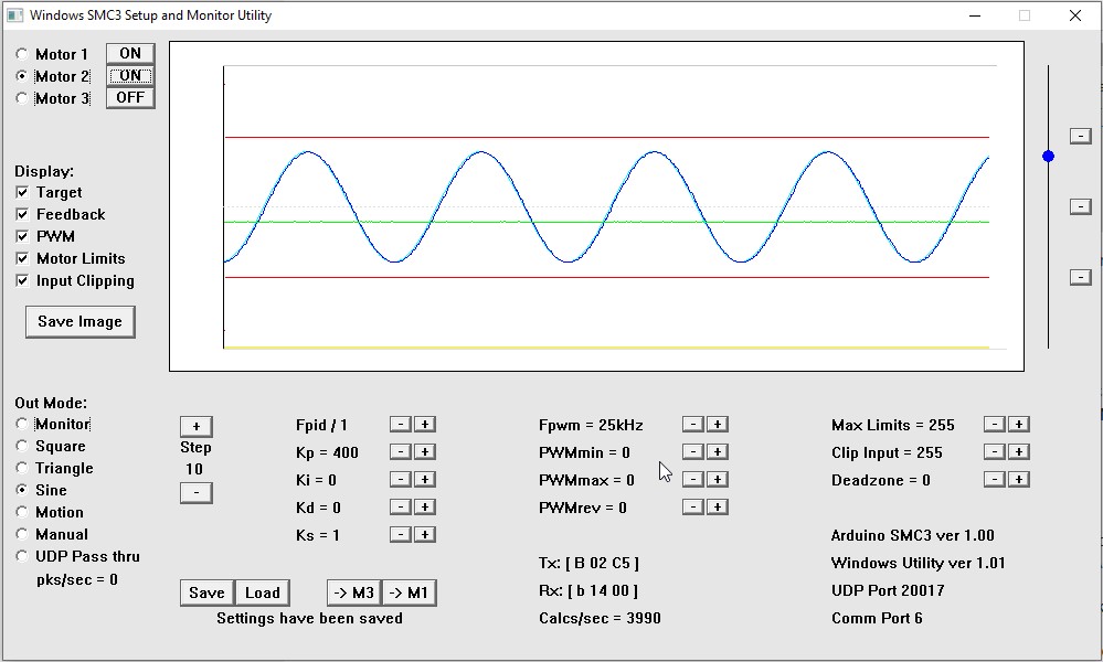

    I just change the voltage at the motors... Here is the SMC3 Utility results
    It try to follow the target, but it saturate's. Could it be that the belt is not tide enough and it's regulation is not sharp?

    @noorbeast and @Pit
    After a few attempts, it looks that i'm having the same problems that @Pit had when using IBT's. They work for a few minuts and then stop, no load. When the H Bridge get's cool it work again, but in the SMC3 Utility they always appear ON.
    Look that my next step is to use 2 IBT to drive each motor? What do you think?

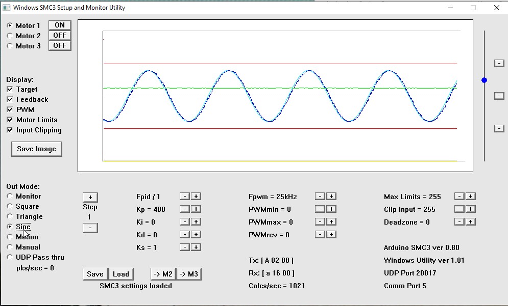

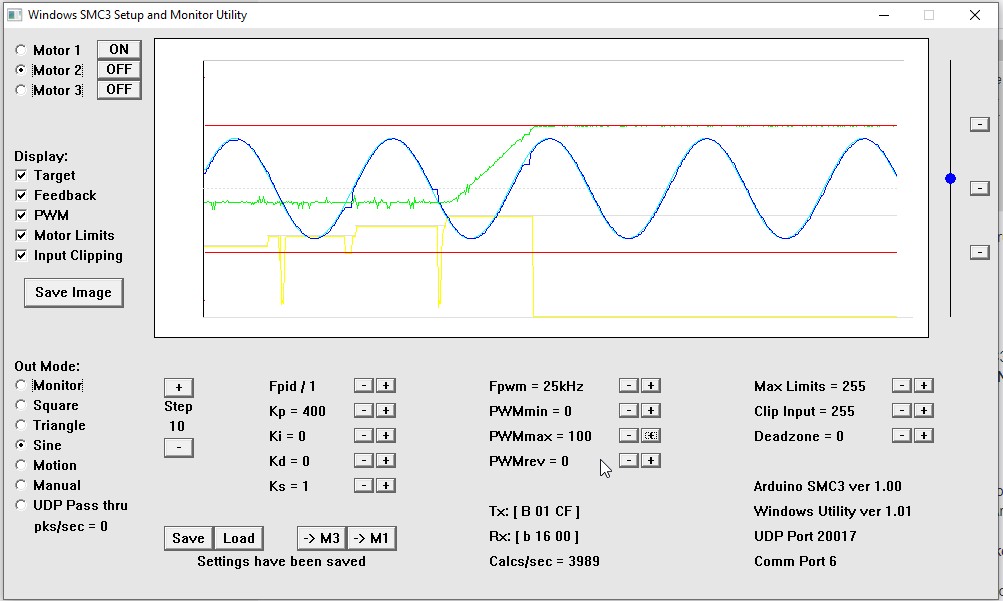

    Hi Guys, i had been away for a few days due to personal issues. I deside to go with Sabertooht 2x60 and i ordered. Now i did installed and i'm facing a few problems that require your guidance or advice.
    I'm using 2 Arduino UNO, one for the two upfront motors and the second one for the back motor.
    When i'm trying to set up the motors using the SMC3 Util 1.01, first thing that i notice is that when i manually turn the pot corresponding to motor 1, this does not move the line feedback, no power at this point.
    Feedback line is a little bit over the dotted line (center of the wave). When i increase power, using the sine wave, the motor start to move, but the back and forth movement it is not similar, it rotates more in one direction than in the other, this does not look right for me???
    Can any of you or any body help me with this matter, i can't move forward....
