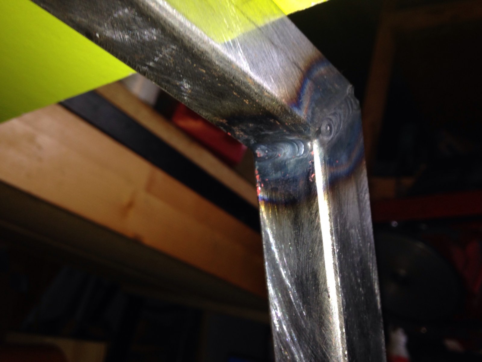

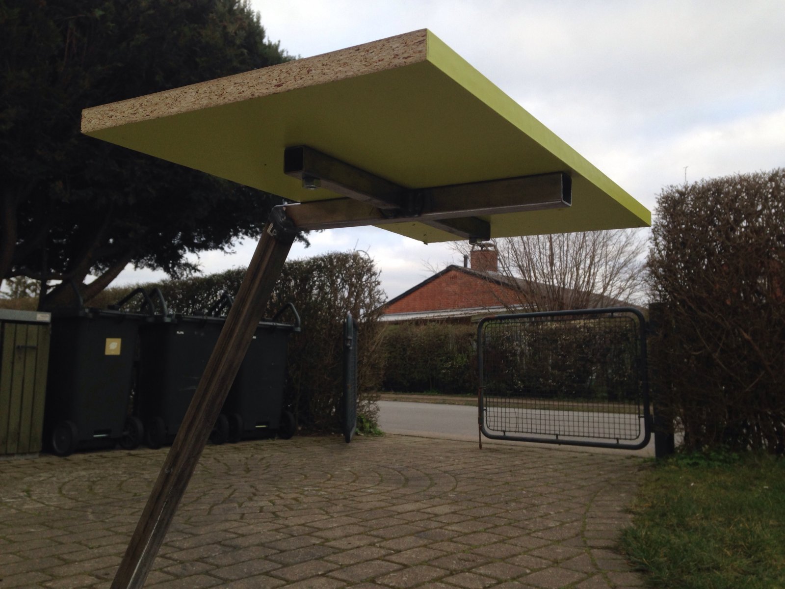

    Hi all. About half a year ago i acquired a logitech g29 steering wheel and found out that sim racing is... quite fun! Så now i'm gonna go all in!

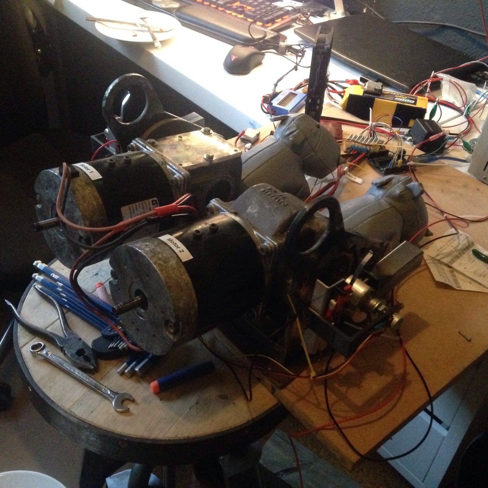

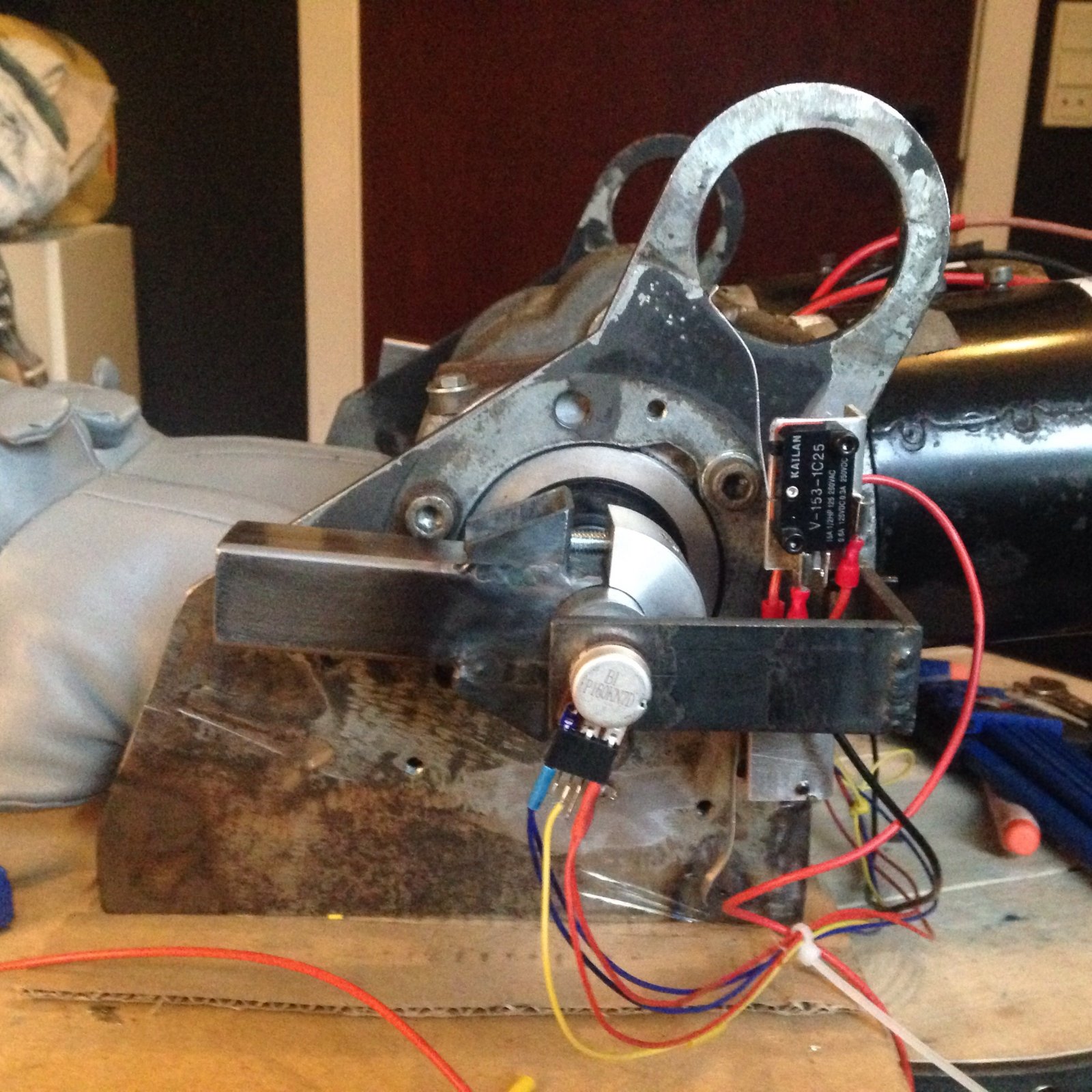

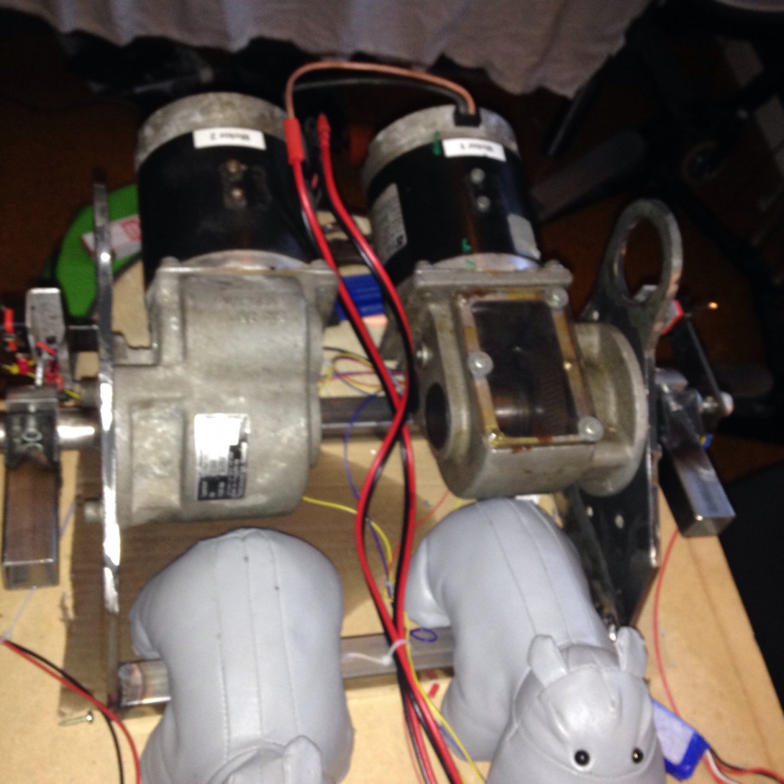

    I'm going to build a 2dof motion sim with two 22v 300 watt wheelchair motors. The frame is going to be made from square steel tube and is going to be made as compact as possible, as i don't have a lot of space.
    I'm currently about 3 week into the build and i think this is a good time to show my progress.
    Parts list (as of now):
    - 2x 22v 300 watt wheelchair motors
    - 2x Dual VNH5019 h-bridge motor controller (maybe two of those is one is not enough):
    https://www.pololu.com/product/2507
    - 1x 24v 100A meanwell power supply, that i found unused/used.
    - 1x Arduino uno

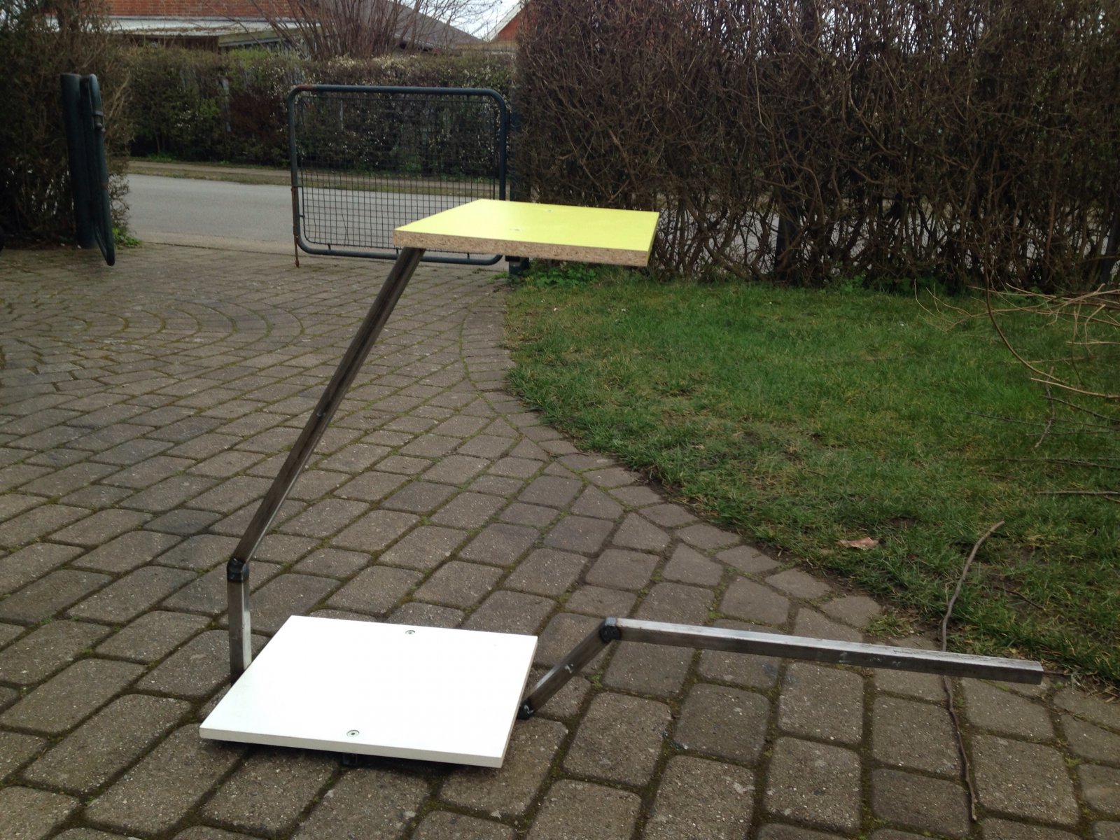

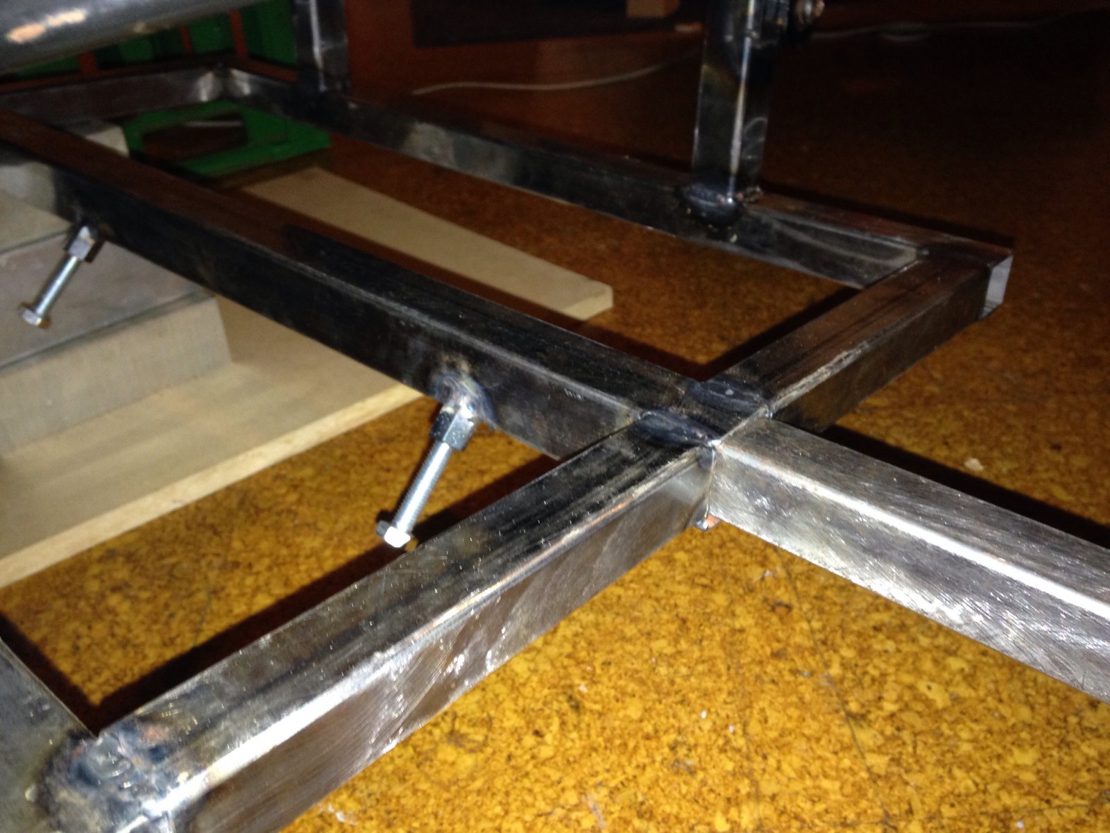

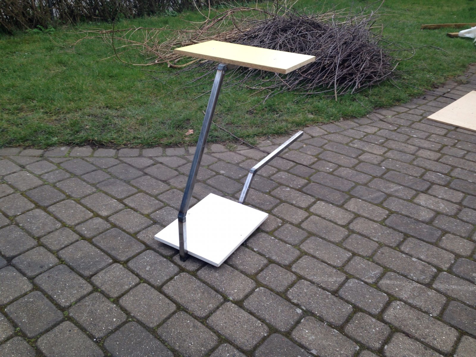

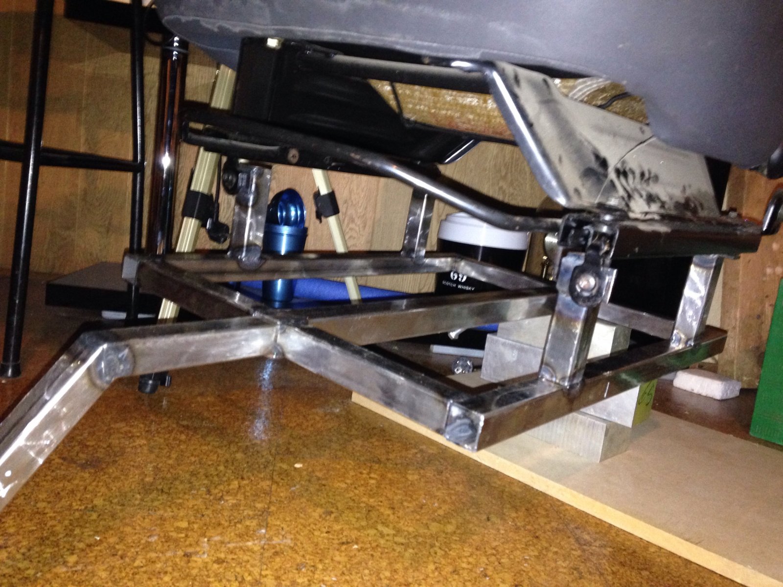

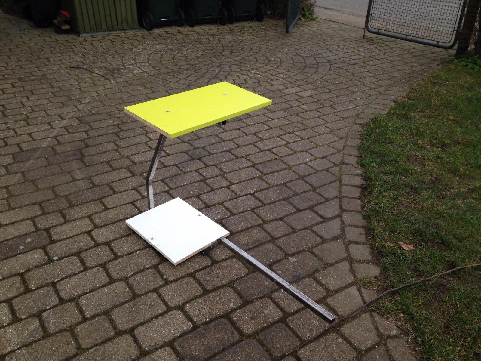

    Some pictures of my progress:
    This is about how far i can come without all the parts that i am still waiting on. I still need the seat, power supply, rod end bearings, and one more VNH5019 motor driver.

    DC motor, Arduino

    Well... that's annoying. I did consider those but as it was a stepper driver, i thought it was not suitable for brushed dc motors. Is the 43A peak? Because i am using quite large motors (300w each) and my idea was to use 1 driver for one motor, so i get 60A each. I think i am going to buy two the BTS7960B instead though. I have just always had bad experience with cheap electronics, so i just went with the name brand instead.
    Thanks for the suggestion.

  5. Spart
    Spart Member
    Mar 3, 2020
    34
    Student
    Kauno kaimas
    229Coins
    +27 / 2 / -0
    DC motor, Arduino
    Yes you need one controller for each motor (if you want to control them independently) .Yes its 43 A peak but I have no problems with slightly more powerfull DC motors so this should work for you as well. By the way, consider adding some kind of cooling fan, these controllers get warm after 30 mins of intensive usage. The only downside of these controllers is that they operate on pwm frequancy up to 23 khz, so it might be tricky to make both motors silent and stay below 23 khz (atleast its was imposible to do with arduino nano). If you go above 23 khz controller shuts off under load.
  6. Spart
    Spart Member
    Mar 3, 2020
    34
    Student
    Kauno kaimas
    229Coins
    +27 / 2 / -0
    DC motor, Arduino
    They are probably cheaper because they purely made in china and pcb will probably hold 35 amps constant and not more. Screw terminals are a bit small for these currents so I soldered wires directly to pcb ( I am using 4 mm^2 cable )

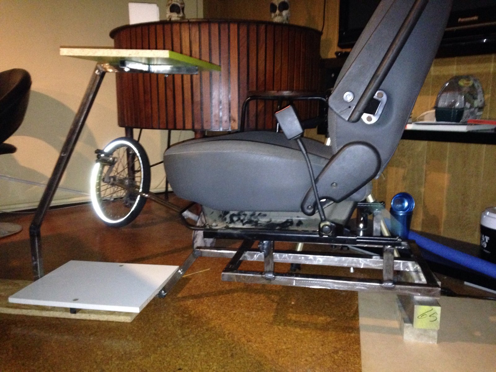

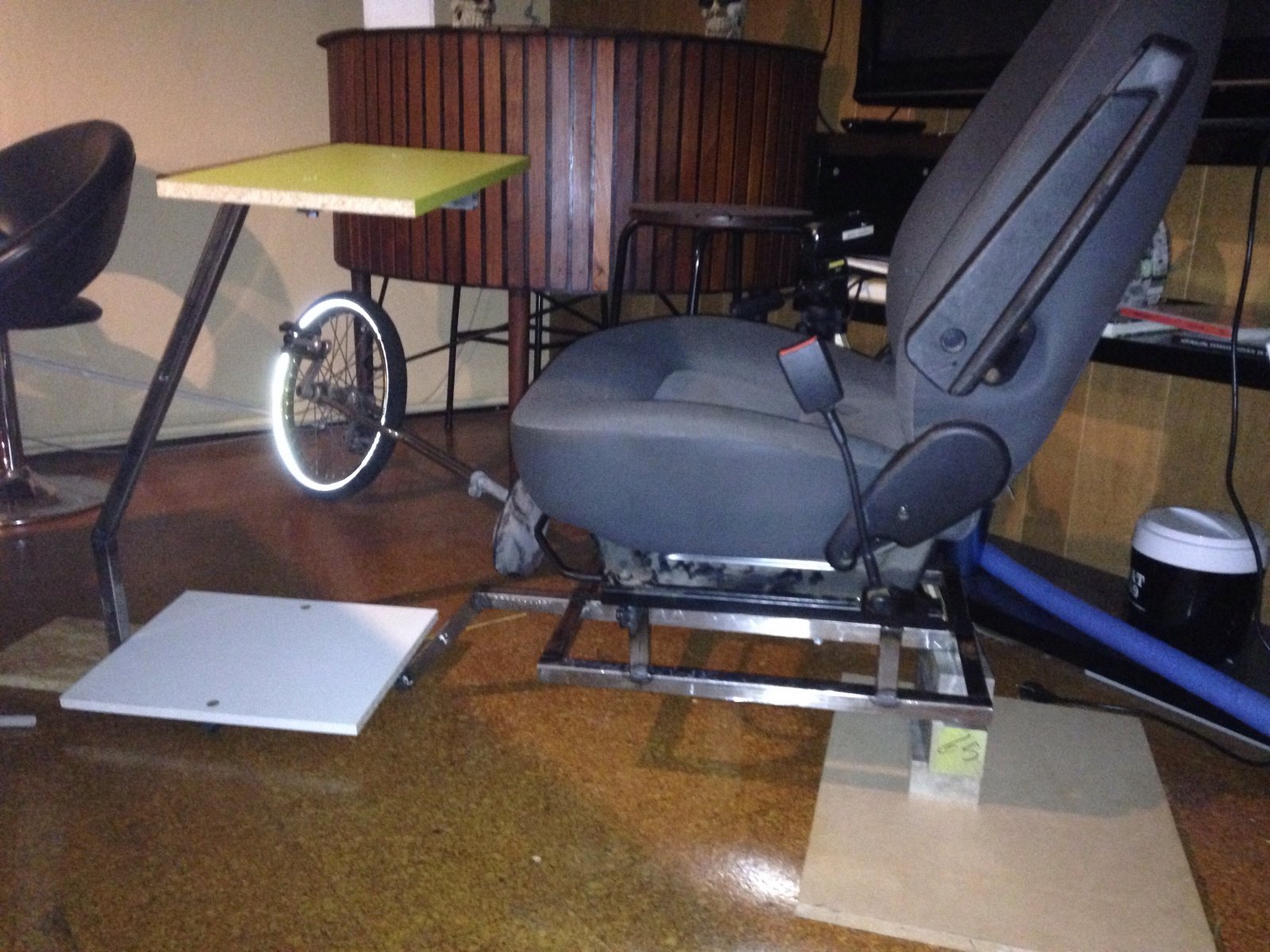

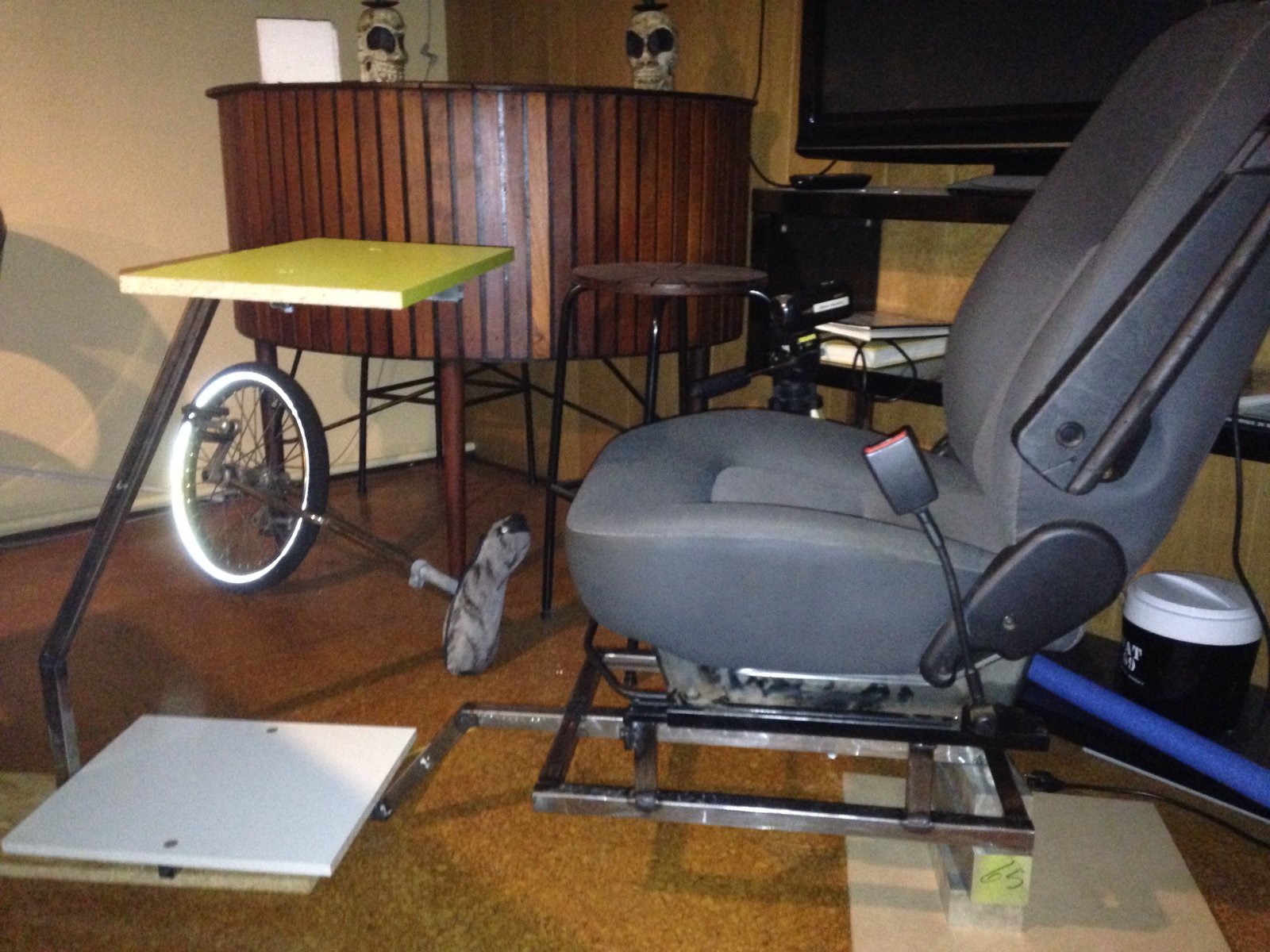

    Today i got the seat mounted to the frame. I found this Fiat Ducato seat used (apparently it has never been used) For about 33 euro. I think i got the geometry just about perfect for the pedals and the steering wheel.
    My plan with balancing is that that it is done by moving the seat. The frame is sitting on a piece that can move back and forth, for size adjustment. The seat can also move back and forth (independently) which allows for balancing, since most of the mass is on the seat.
    I also ordered two BTS7960B motor drivers instead of the VNH5019 because at was cheaper. So now i got a spare motor driver, what should i use that for? Seat belt tightener maybe?

  9. Spart
    Spart Member
    Mar 3, 2020
    34
    Student
    Kauno kaimas
    229Coins
    +27 / 2 / -0
    DC motor, Arduino
    Nice to see the progress! Dont you think pedals are a bit too low or are you aiming for comfort ? With balancing I have a sugestion to you, it will be hard to balance everything only by sliding seat. If you slide seat back to get the balance, pedals and wheel might be too far and vise versa. You can try countering that by having some adjustment to pedals and wheel too, it will be easyer to balance everything and get comfortable position. P.S tilting back rest of the seat is a good way to do fine adjustments to center of mass .
  10. Spart
    Spart Member
    Mar 3, 2020
    34
    Student
    Kauno kaimas
    229Coins
    +27 / 2 / -0
    DC motor, Arduino
    Oh nevermind, I just noticed, you already have adjustment for pedals and wheel, my bad. By the way if you use wheel with strong ffb that stand might flex, you might need to reinforce it.
  11. jonas bandier
    jonas bandier Member
    Feb 14, 2020
    30
    272Coins
    +9 / 0 / -0
    @Spart
    Yes it needs reinforcement as there is too much flex in the collum. I think i will mitigate that with the gear shifter and handbrake mount, so it forms a triangle.
