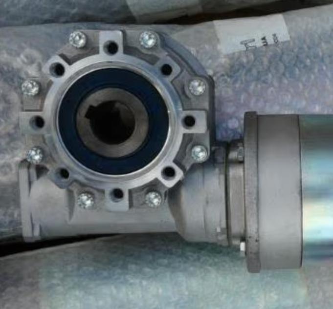

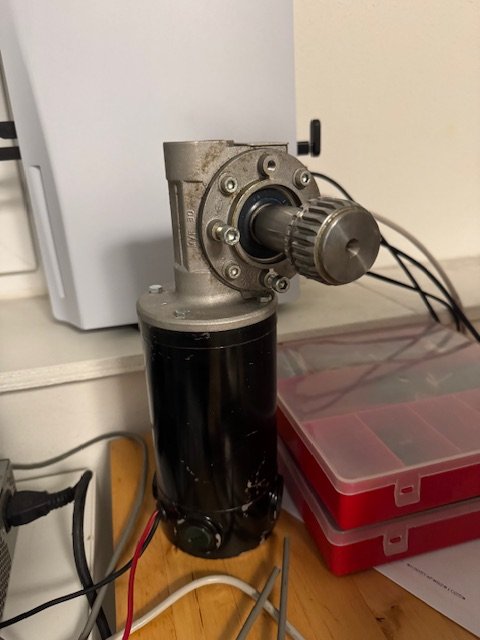

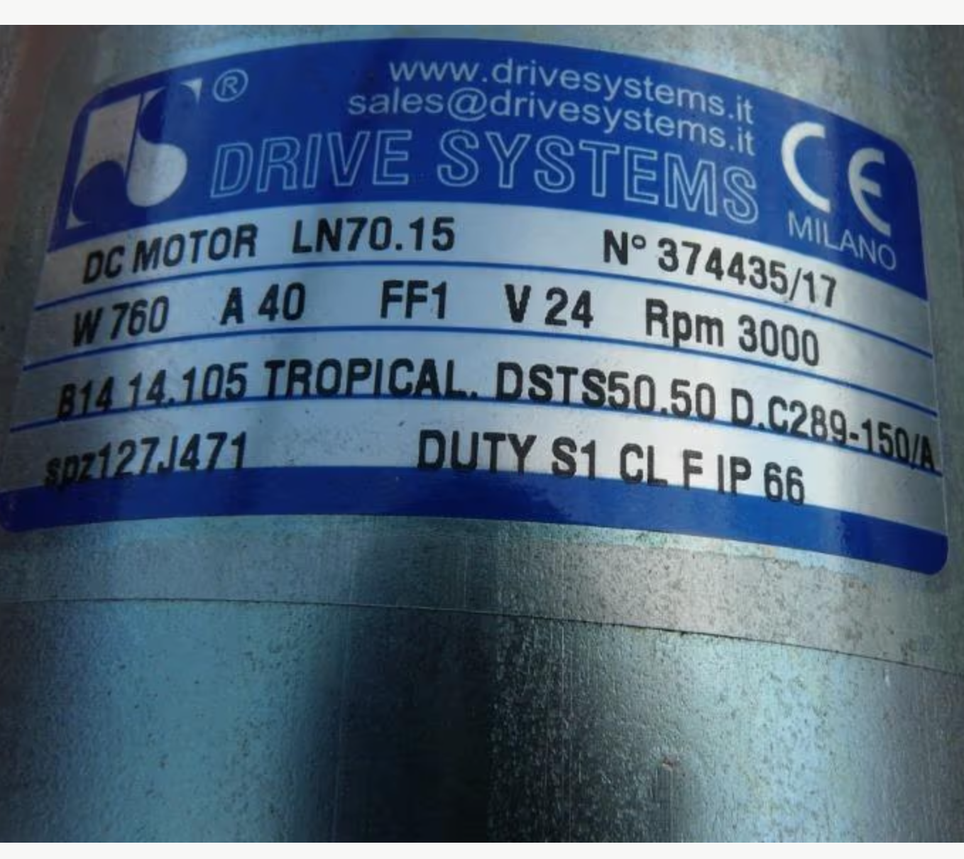

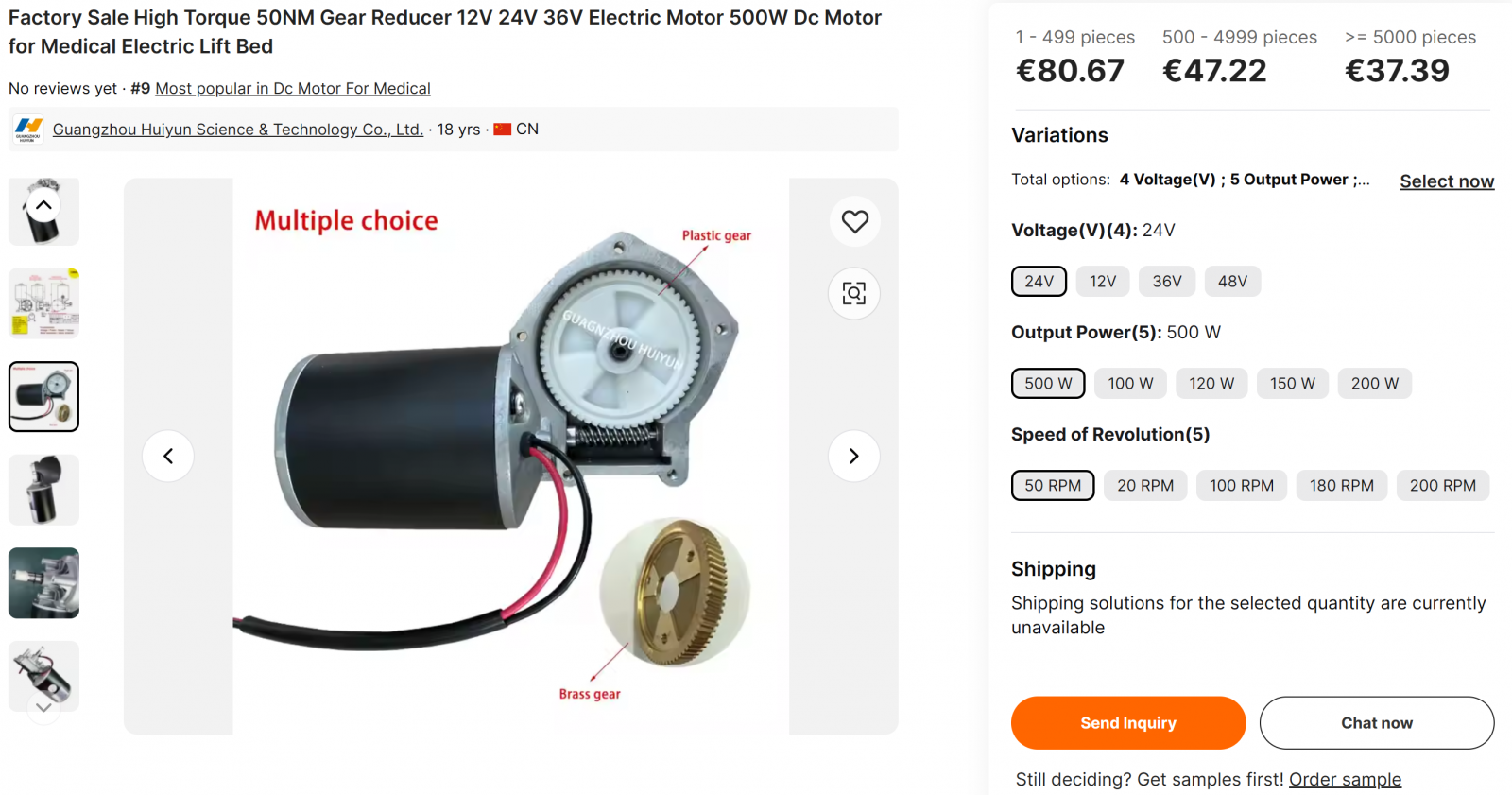

    I looked at different types of motors. I think the wipermotors are to weak (max around 45 watt) to be future resistant and they cost about the same (new) as these motors I found.
    3. Which ones are the most preferred and why is that?
    Encoder selection
    I see different types of position feedback. Also different people say different things about the compatibility with the software. I do not want to use a potentiometer, because of the lack of quality feedback.
    4. Is this a simple plug and play encoder for the soft- and hardware I want to use?
    Motor option 1 (with brass gear)
    Motor option 2 (I don’t know the geartype of this one)
    Motor option 3 (different geartype than option 2?)
    Motor 4 I can buy these secondhand.

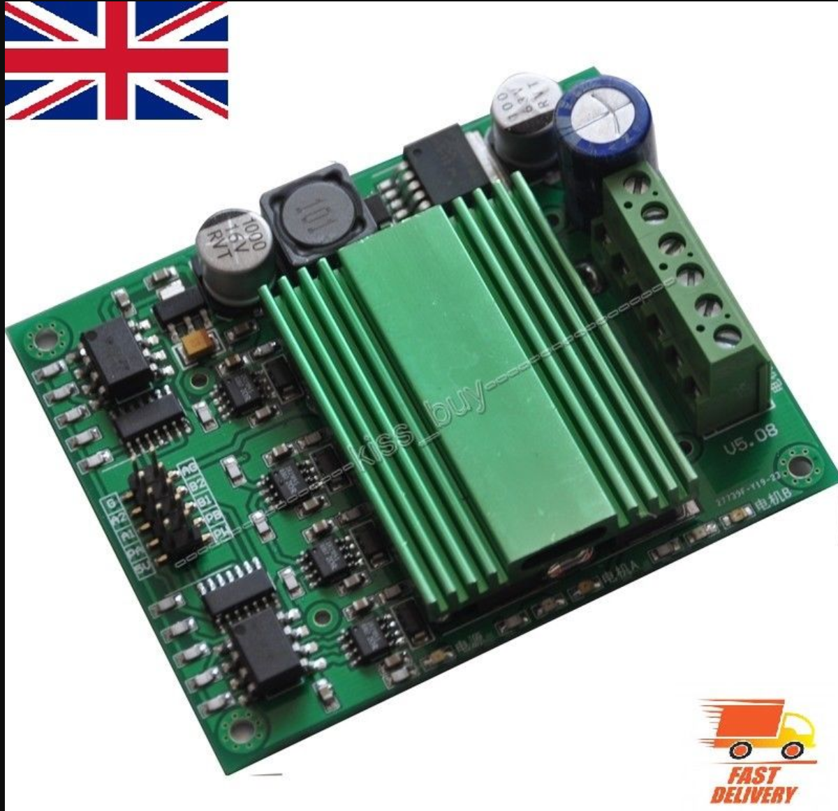

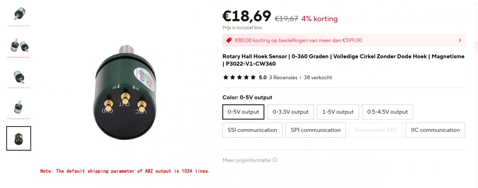

    Use a 180 degree Hall sensors, rather than 360 degree, as this will give you greater resolution.
    IBT2s have been reported as somewhat variable in quality, and lowering the voltage from 24v a little seems to help longevity.

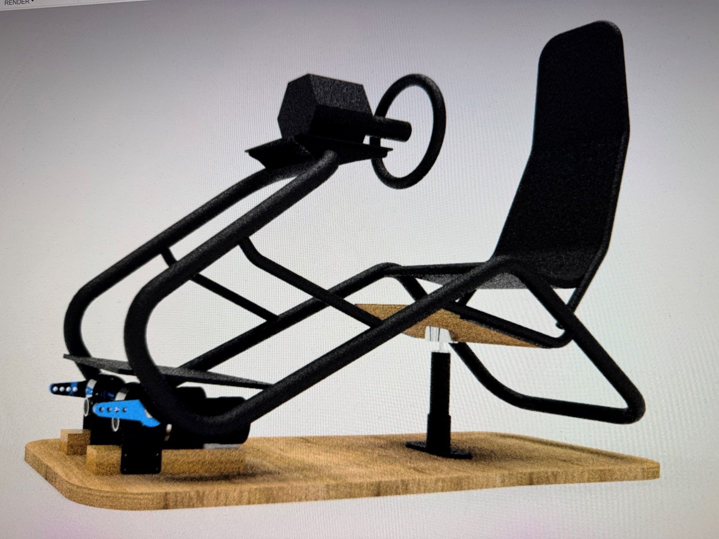

    Design greatly influences motor choice, so specifically what design rig do you plan to build and can you please post some sketches of the intended design.

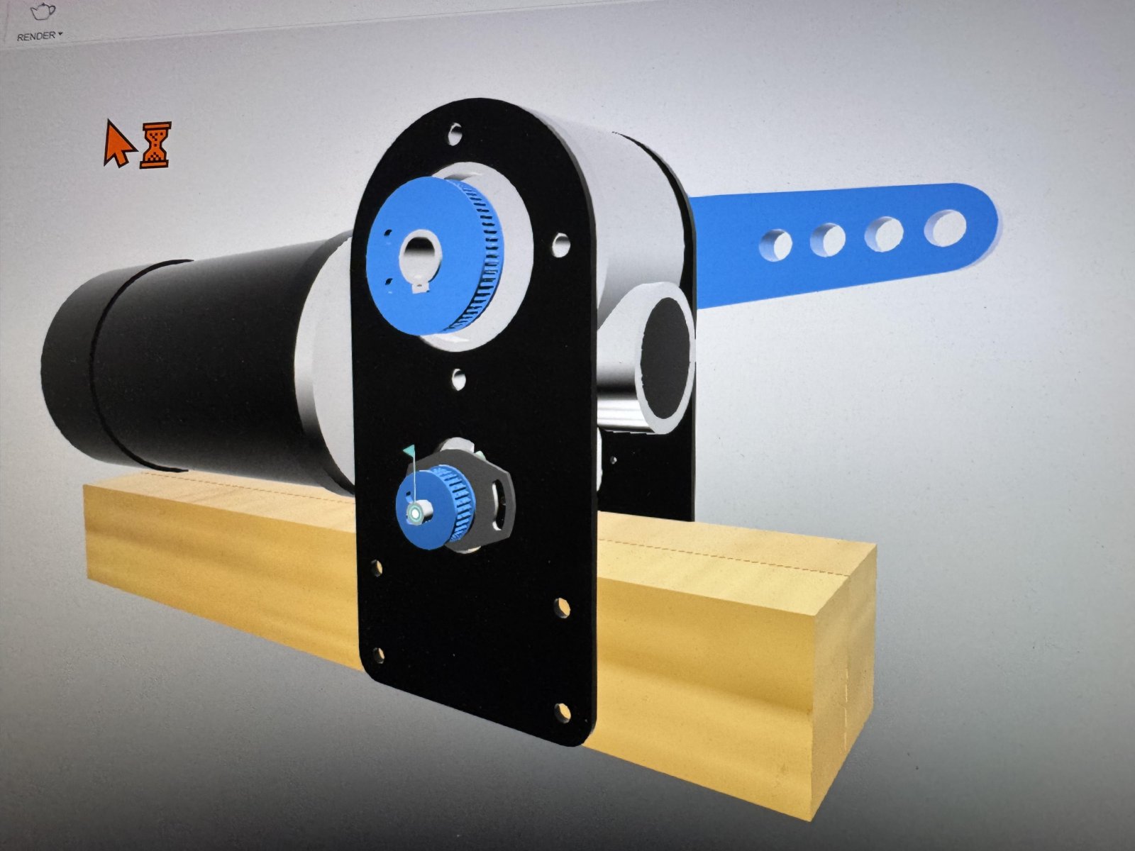

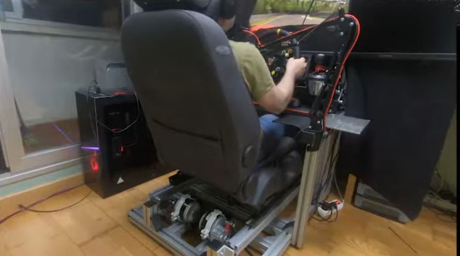

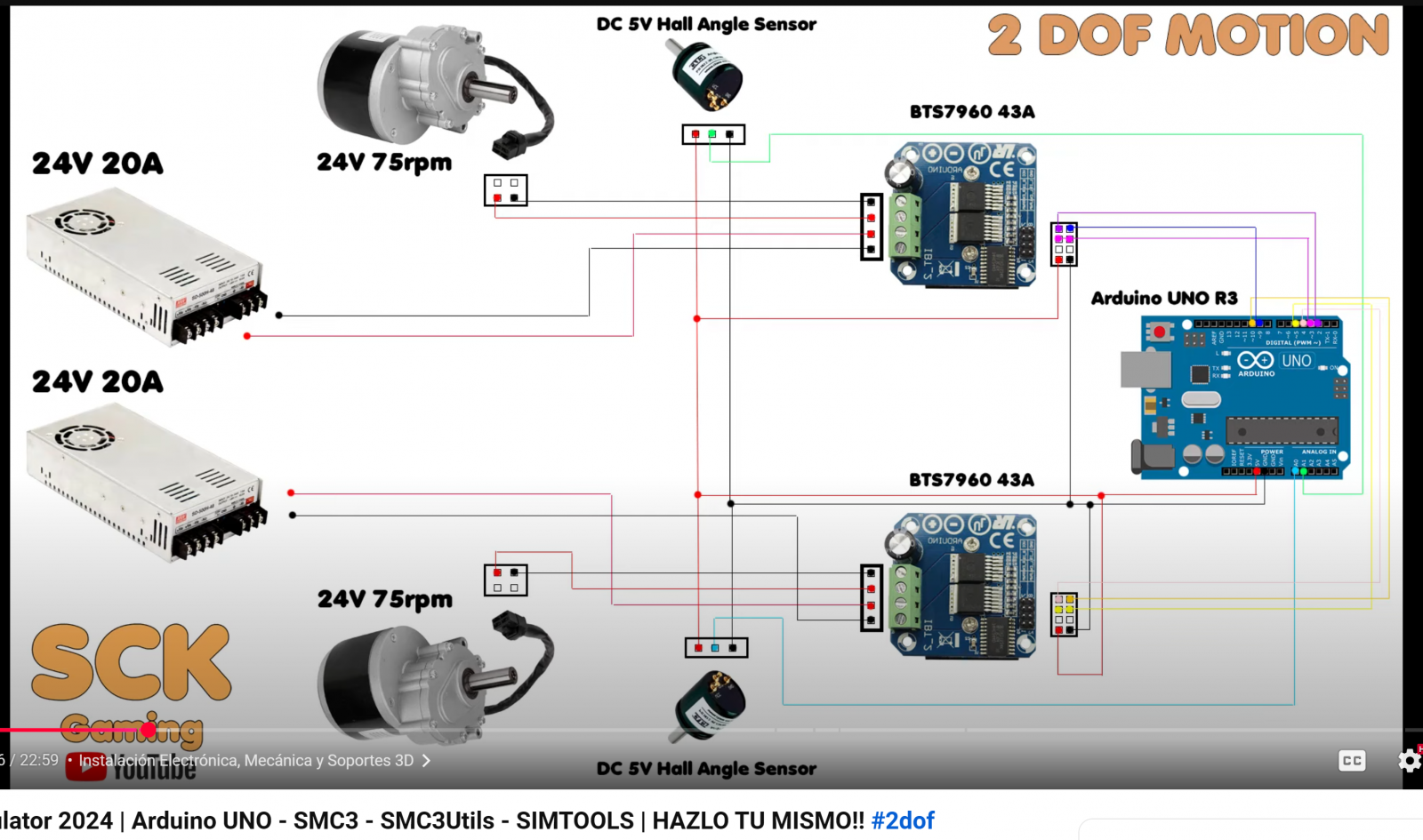

    I am thinking of a setup like DOF reality h3.
    I was watching this setup, which is made of the same parts including the motor option 3.
    I did not have it in 3D cad yet, because i want to choose the motors first so i can design with that specific motor, gear and Nm's. I started with the playseat...
    My thinking at this moment is to make a basic design with a plateau where a can put on any type of static simset. I have an old playseat at this moment, which i might upgrade soon of later.
    Is there a better option for the IBT2 which can be replaced without extra programming?

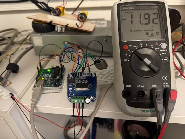

    I have bought some motors. 180W, 10A powersupplies, IBT-2 drivers and arduino uno (origional)
    I started to leard arduino, so i can understand the files better.
    I orderd some encoders and waiting for those.
    I installed the SMC3.uno file on arduino and changed it to mode2 (no further changes)
    I made a trail setup for testing with SMC3.

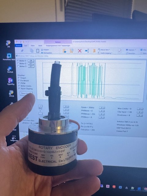

    I also have an encoder from my cnc machine attached to the arduino, which SMC3 sees
    I connected the wires like this example to the arduino and IBT-2
    before i connect the motor i wanted to test the motor voltage output of the IBT-2
    I connected a 12V powersupply and measured the motor voltage.
    I thought i can see the voltage move with the SMC3 test.
    PROBLEM?
    i measure +12V on the input and measure -12V on the motor output
    there is no program running yet! (except the arduino)
    1. shouldn't this be 0V from startup?
    2. when i turn the encoder the voltages moves very fast from -12 to +12v, like 0.1 degrees is an almost instant changes in voltages. Is a wrong encoder for this to test with?
    i connected the A (encoder) to A0 (arduino)
    (rotaray encoder ibest type isc5810-c01g-1024bz3-5-24f)

    Most use 10k pots or preferably 180 degree Hall sensors.

    ok thanks.
    i read that it would not work with pots.
    and i wanted more consistant hall-sensors.
    i orderd these. P3022-V1-CW360
    which i saw multiple others use.
    green ones from ali.
    if 360 is a problem, i can change ratio 2:1
    should this work without changing the settings in the code?
    i don't understand the difference with the one i use now.
    the resoltion is the same.
    I think the signal works also the same.

    A 360 degree is not so much a problem, but rather it will result in less resolution.
    Technically speaking a 90 degree Hall sensor would be ideal, if no more than 45 degrees up or down is ever used, but that can be a bit tight in terms of having some headroom, so most settle for the 180 degree Hall sensor.
    Back to your issue, can you please confirm SMC3 is configured for Mode 2 for IBT2s: https://www.xsimulator.net/community/threads/problems-with-my-simulator.15382/#post-207320
    And if you have multiple IBT2s do they behave the same, as many users have reported faults in brand new IBT2s.
    Please post clear pictures of all your SMC3 settings.
    And advise at what setup of the standard SMC3 setup there is a failure: https://www.xsimulator.net/communit...3dof-motor-driver-and-windows-utilities.4957/

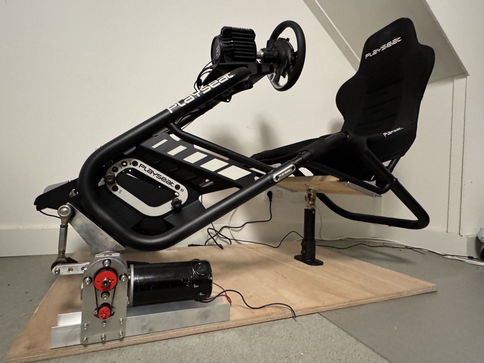

    Hello, thanks. Here is an update,

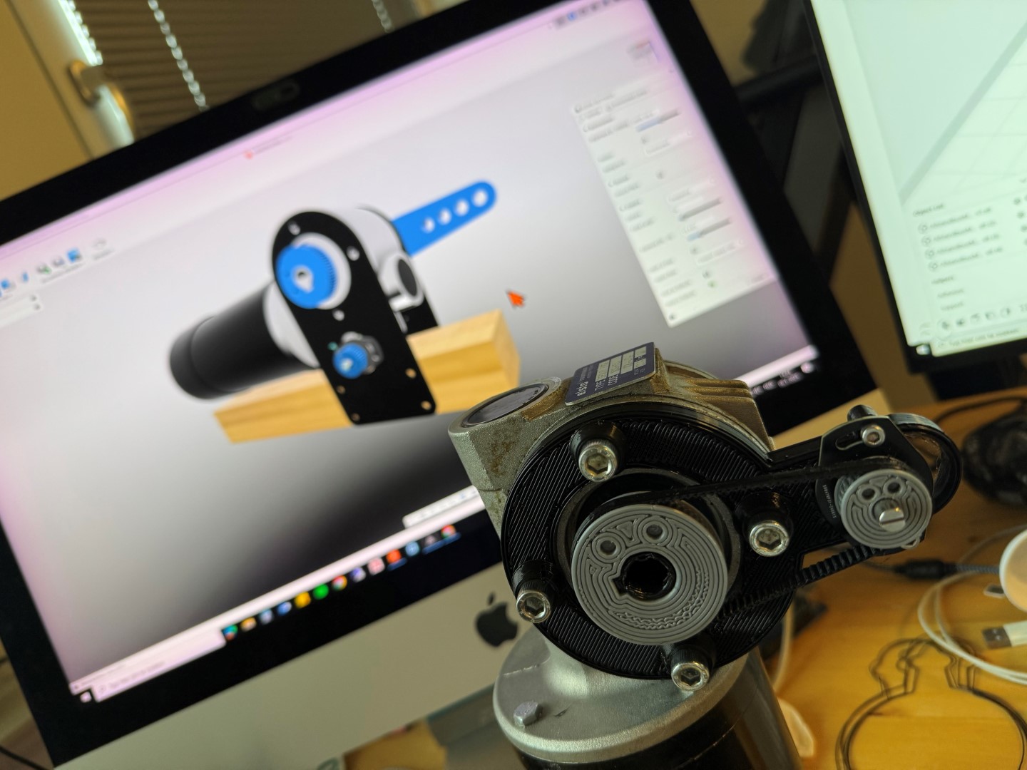

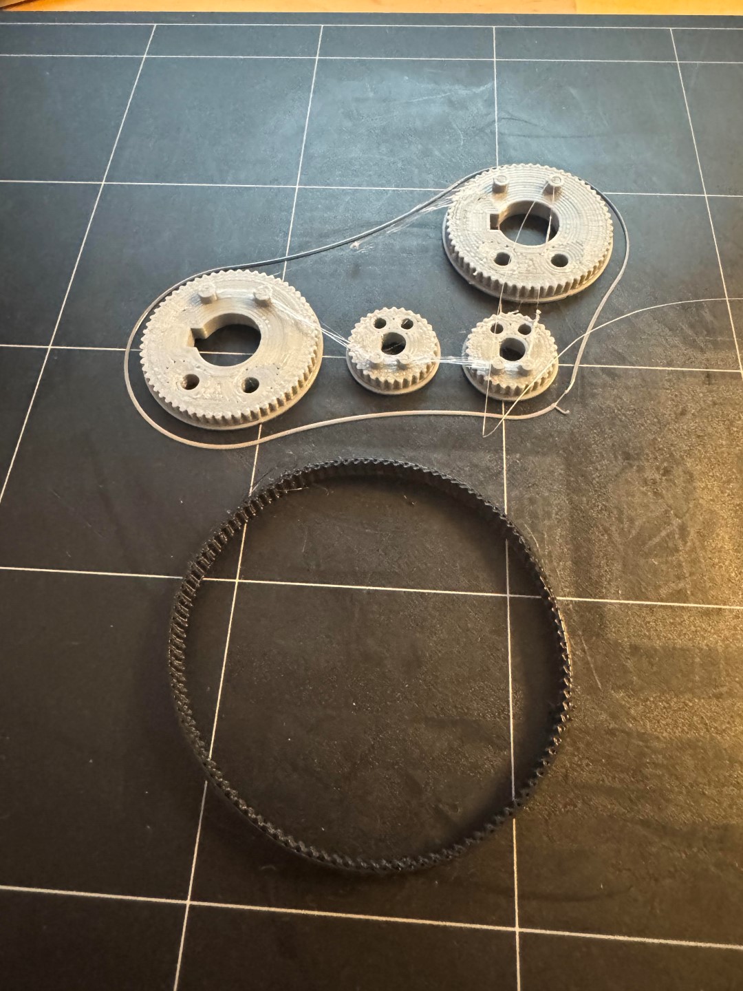

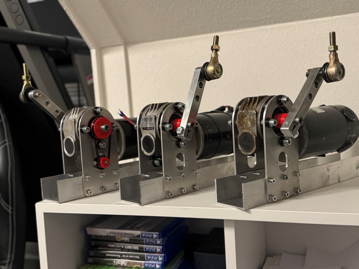

    I made a design for the motor setup with encoder.
    I received my encoders (360 dgr) and 3D printed a 1:2 gear and mounting plate.
    the belt is made of flexibel 3Dprint material!
    I made the parts and tested it today.
    I have a video, could not upload it yet. I have a link to it
    https://drive.google.com/file/d/1obAomn0NKLlbzScPW6uKeFEm8Kn6M0dJ/view?usp=sharing
    I think it works like intended, Green follows the bleu line
    I see a few thing: Do you know if this is good behaviour?
    1)
    The voltage i measure while testing is only +/- 2.5 volt.
    The supply is 24V - 20A. I tuned the supply down to 22V, because i was told this is saver for my IBT2.
    I couldn't change any parameter to get more voltage reading.
    I would think it should be -22 / +22 volt.
    (ok it tested some futher... When i put it in manual mode, i can test a wider range of motion. I see the voltage is much more and the movement is solid. There still is a noisy ratling sound when idle of slow speed. Too loud for using it...)
    2)
    The motor does not move fluid.
    I tuned the parameters a bit, it approved but not convincing.
    Could be the low voltage?
    (when i do manual big movement, it is solid. But slow is rattling / nervous movement)
    3) it turns only about 75 degree (+/- 37.5). I would expect to get it like 180 (+/-90) degrees with testing parameters. Is it a normal range of movement?
    (When i do manual this movement is bigger. I can pullup the blue line to max and bottom. the movement is accordingly. Stil no 180 degrees, but more than 90 degrees. So this should be ok.

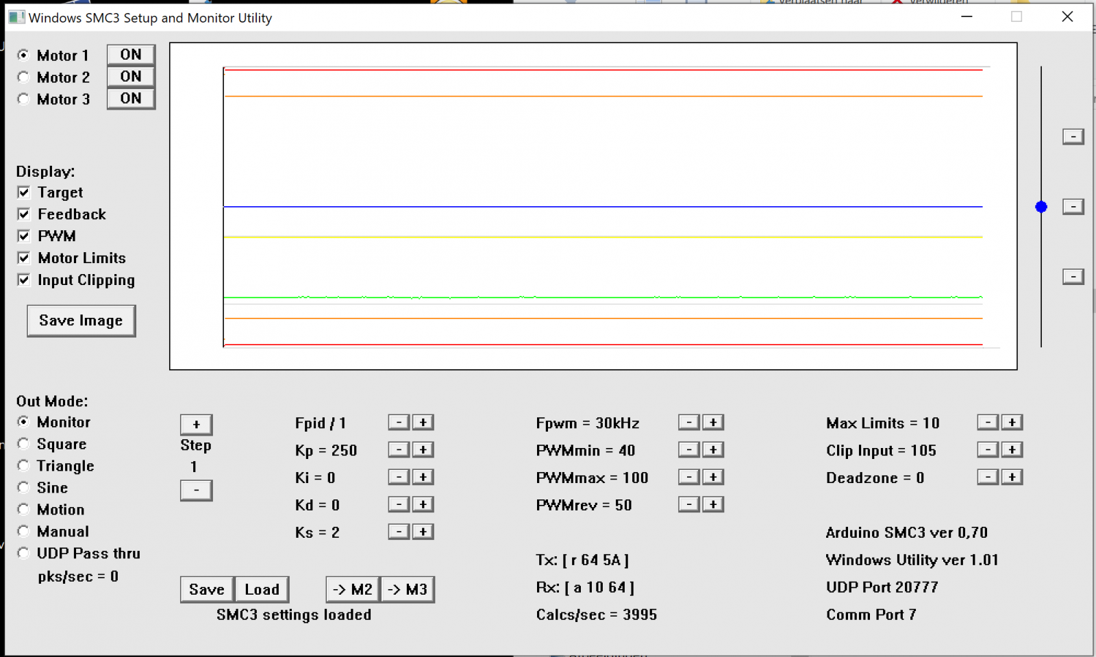

  12. noorbeast
    22,095
    154,190Coins
    +11,175 / 57 / -2
    I don't use SimHub, but that sounds like a hardware related communication issue. Do make sure you don't run SMC3 and other software like SimTools or SimHub at the same time, as that will create a port conflict.
    Can you please re-post your SMC3 settings running the Sine test.
    At a guess I would have thought Kp, PWMmax and PWMrev settings would have been a bit higher, Max Limits is pretty low, the functional explanation of the various settings are here: https://www.xsimulator.net/communit...driver-and-windows-utilities.4957/#post-48121
  13. Jodino
    Jodino New Member
    Dec 9, 2024
    23
    The Netherlands
    99Coins
    2DOF, 3DOF, DC motor, Arduino
    The settings of the previous video are
    Motor1_Kp=100
    Motor1_Ki=1
    Motor1_Kd=0
    Motor1_Ks=1
    Motor1_PWMmin=10
    Motor1_PWMmax=100
    Motor1_PWMrev=10
    Motor1_Limit=10
    Motor1_Clip=230
    Motor1_Deadzone=0
    I tested a lot of combinations. i don't think it is the settings. I understand the purpose of the settings.
    The settings do a little to the sound. The higher the numbers the higer the sound. (restless motor)
    I did a test without the belt (no direct feedback AND no SMC3 running: only arduino and powersupply)
    The sound was still there, but when i turned the hallsensor by hand, it became quite sometimes.
    I was thinking: maybe a filter on the output of the hallsensor will help.
    I did a software filter in arduino. with the help of chatGTP (you.com)
    implemented in de code.
    then the noise was gone.
    https://drive.google.com/file/d/1jGti_SMCbXUdqyMjKAdILE3_Qs443f7T/view?usp=sharing
    after this i tried SMC3 again.
    The noise was the same.
    The PWM signal (yellow line) was also restless.
    i am thinking it could be SMC3-utillity, which is causing the restless motor behaviour.
    By hand there is no problem with the arduino SMC3 code running.
    I will try some other values of the software filter.
    But i think SMC3 does not do something with this filter.
    I will try a hardware filter (i have some 10 uF capasitors to try).
    update,
    i have tested the capacitors. There was not much difference. i tried 10 and 0.1 uF between output and gnd.
    Although the sound is there with SMC3 running, i see my yellow line (PWM) jumping around.
    The higher it jumps the more sound it makes.
    Can this be something to check of filter? - so for for today.

    Try lowering Fpwm to 25.

    Hello, Thanks Noorbeast for your support!
    i have connected simtools2, setup my axis, drove a 1 round single race, patched. then tested manual with game engine and it reacts on my input.
    then i started LFS te see if it moves when driving but it doesn't.
    simtools says it is connected with LFS (green)
    i have downloaded the manual and checked my setup.
    Can it be that i did the LFS round (before patching) wrong?
    i tried a few times (unpatch, 1 round single race, patch)
    the motor works every time in testing mode.
    And it get connected with LFS and game manager and game engine
  17. noorbeast
    22,095
    154,190Coins
    +11,175 / 57 / -2
    LFS has to be run before being patched for motion, as that generates some required files: https://www.xsimulator.net/communit...run-in-first-person-mode-before-patching.365/

    Small update.
    Some progress on the parts i am making...
    I have to print some parts and hopefully i can make the groundplate + adapterplates for my chair (trophy playseat) this weekend.
    chair pivot
    motormodules
    my concept at this moment.
    motors wil be put outside, next to the front
    the 3th motor wil be controlling the sliding at the back combined wth a second plate.

    I assembled my rig and notice a big side-ways stability problem.
    I thought this could be an issue but i do not see why i dont reaad or see other rigs with the same problem. compared with other rigs with the same setup. see video of the problem.
    https://drive.google.com/file/d/1HhdMXzhFZfZE7JEHWUheV4Ih4y2QQwjy/view?usp=sharing
    Is everybodys rig so much more stable at the seat cardan pivot? I think i need a massive cardan pivot to fix this. This was the biggest i found. It looks very good. but i do not think this works.
    any suggestions?
