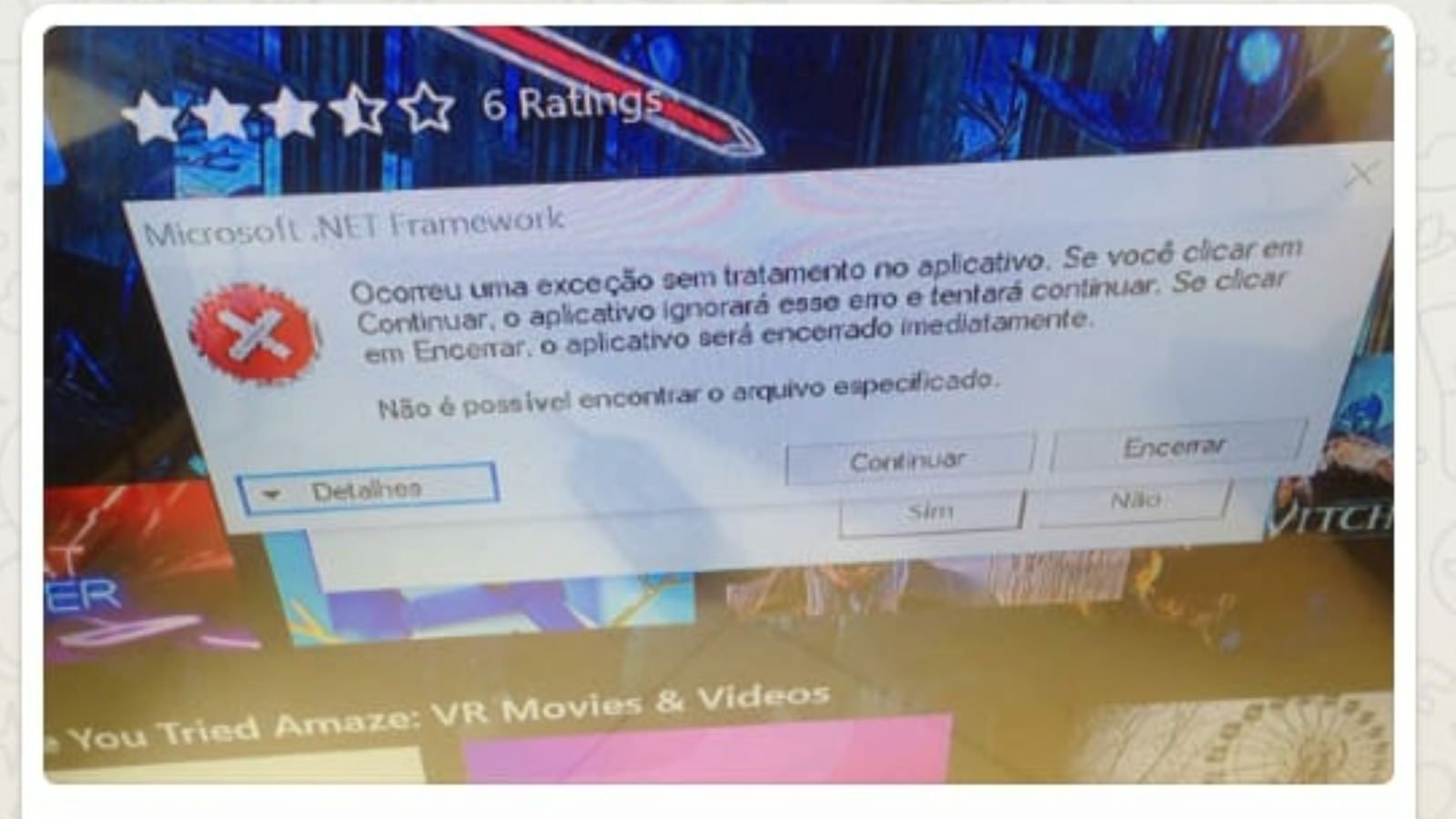

    Hello.
    Has anyone got any solutions to the .NET error? Would not a new plugin be needed?
    Tank you.

    What .NET error? Can you pleas post the full error details.

    I do not have all the details because a customer who reported the error.
    I'll ask him to send the details, but another member has reported the same error on the previous page.

  6. Michael Keymont
    Michael Keymont “I’m racing a Ferrari in the Matrix...” Gold Contributor
    Mar 24, 2017
    32
    Creative Technologist
    Bellingham, MA - USA
    394Coins
    +17 / 1 / -0
    That looks like the error message that I was getting that turned out to be about not having SlimDX.dll. I Googled SlimDX, found an installer for the (x86) version and that seemed to solve it for me. NOTE: the (64 bit version didn’t help, only the (x86) version.
    I hope this helps!
    Mike

    Is it really related to language?
    This started suddenly after a Windows update.

    Who knows for sure at this stage, but troubleshooting is easier if you eliminate possible causes one by one. And at the moment I can't even read the error message.
