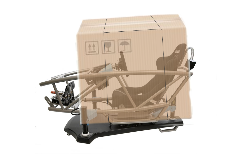

    Future VR headsets will have inside-out tracking which is not suitable for motion sims at first. I was thinking for a possible solution and I just came to this stupid idea: to create a body for the sim using cardboards.
    The sensors will detect walls and a ceiling, but those will be traveling with the sim. That should do the trick.
    This would open to a new world of customization, there is no limits to create a cool body for the sim, (does not necessary has to be cardboards) it could also have cool ventilation system and all...
    What do you think? is there some user with inside-out tracking system that could try this out? :)

    Maybe if you paint a checkerboard pattern or something on the cardboard it would work. From Microsoft:
    The product has been designed to work in normal environments. Consider the following thought experiment - if you were in a completely blank room (white walls, white ceiling, white floor) then the tracking system would find no features to track and would fail. If you were in a room that was covered in art work and decoration, then the tracking system would find many features to track and would work well. For the most part, typically decorated homes and offices have been demonstrated to have sufficient feature detail to track well.

    Using an HP Reverb (inside-out tracking), I tried building a cardboard enclosure on my motion platform with various stripes on the inside of the cardboard for the headset camera to pick up. It was a big failure. The picture would jump and if I was driving around a corner then some of the jumps would put the horizontal at a sickening angle - I had to stop after less than 10 seconds. It gave the impression that the tracking system was seriously struggling to work out the orientation. It would seem that the gyros in the headset were outvoting the camera inputs. For this to work, the gyros would need to be disabled so that only the cameras are used.

    Every SteamVR supported device works with motion compensation.
    The issue is the tracking itself. If the HMD tracking does not work reliable on its own, no software can compensate that.
    The tracking has to work on its own in the desired environment. If this works, you can start adding additional layers to it, like motion compensation. But if the tracking is wonky out of the box, there is no way to adjust for that in software.
