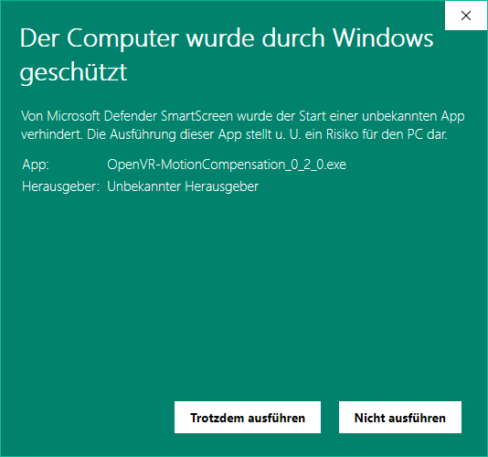

    Despite of the Windows Defender warning it works so far without any issues using standard settings, tested 20 minutes on Nordschleife, which is very shaky and bumpy.
