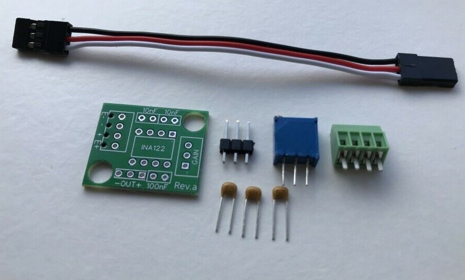

    [QUOTE = "Erik Middeldorp, post: 199542, membro: 31067"] você leu este tópico: https://www.xsimulator.net/community/threads/diy-load-cell-brake-pedal-short-tuto. 6042 /
    Hello Friend. I made a PCB using the INA122 for my Thrustmaster T3pa Pro pedal. He had seen the project in a video in which another friend made for pedal G27. I asked if it would work with the pedal of my T500RS and the answer was positive. It really worked, but I have small "swings". I think some filter is needed. I found on the net an example of a board that uses 2 more 10nF capacitors, attached photo, but I don't know how they would be inserted in the circuit. Would you know? Sorry my english .. I'm from Brazil. Hugs
      File size:
      151.8 KB
      Views:
      2,662
  7. Erik Middeldorp
    Erik Middeldorp Member
    Sep 15, 2018
    50
    sheet metal worker
    Auckland, New Zealand
    643Coins
    +46 / 0 / -0
    Sorry, I don't know.

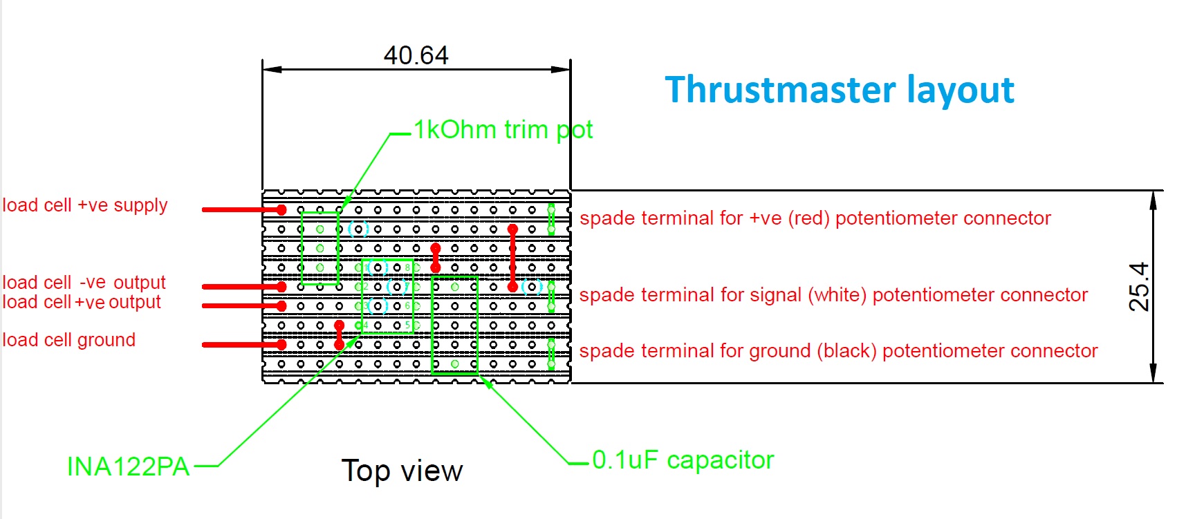

    Hi Erik, thanks a lot for so great contribution!! hug:
    I am managing to convert my crappy 2 pedal set (from the Thrustmaster T150) to load cell ones, and if I understood well, the PCB I must create based on the one for G27 you put, should be like this. I swapped load cell ve outputs and linked pin5 of the INA122 PA to ground. Could you please confirm it?
    Thanks a lot!
  9. Erik Middeldorp
    Sep 15, 2018
    50
    sheet metal worker
    643Coins
    +46 / 0 / -0
    Yes, that looks correct.

  11. Hannu
    Hannu New Member
    Jan 29, 2021
    12
    105Coins
    +15 / 0 / -0
    Hi guys, this goes slow but safe :)
    I assume both the pot and the cap have not polarity, is that ok?
