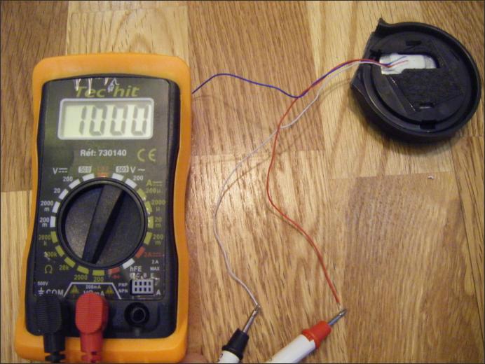

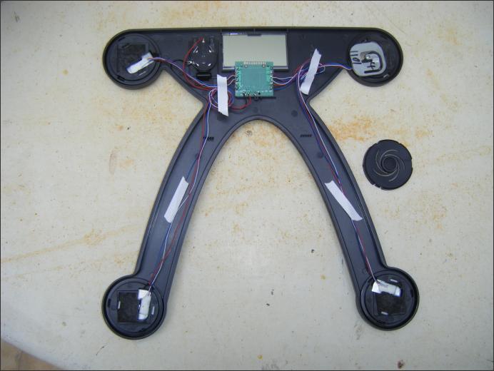

    Take an unused bathroom scale @10€ or buy load-cells at eBay
    you got this piece :
    You need 2 load-cells to make a wheatstone bridge :

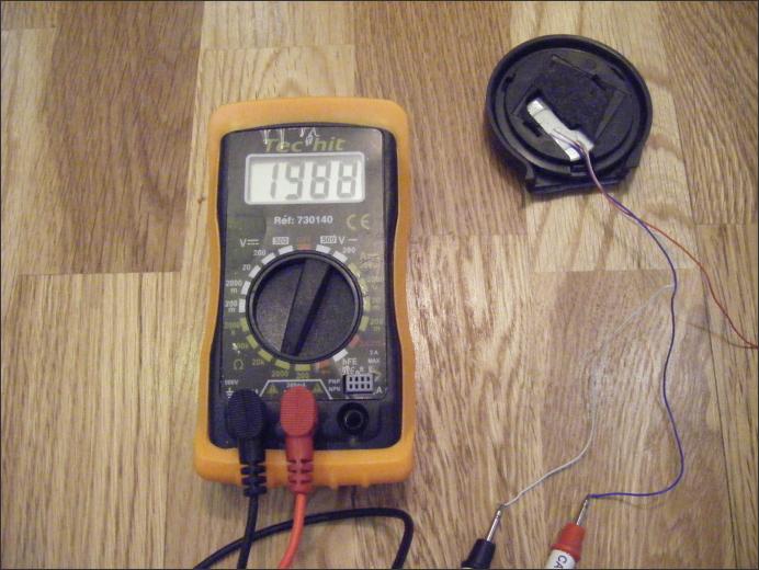

    Check the 3 wires to find the wire in the "middle"
    20130613214516-RacingMat-jauge-contrainte-pese-personne-7-.JPG 20130613214431-RacingMat-jauge-contrainte-pese-personne-4-.JPG
    check the 3 combination, you should obtain 2 equal measures and one twice bigger
    2000 ohm blue - white
    1000 ohm red - blue
    1000 ohm red - white
    hence wire the red (middle) to the Amplificator

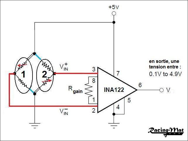

    blue Loadcell 1 with white Loadcell2

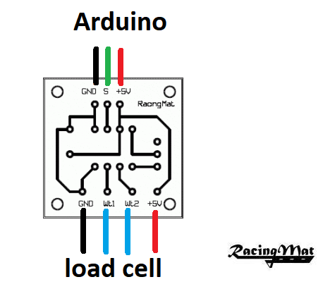

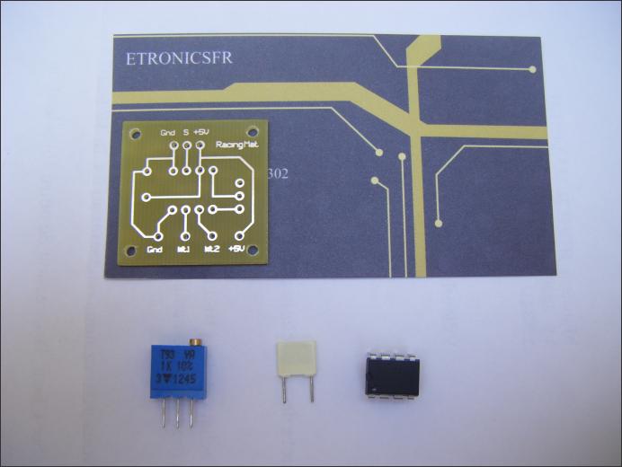

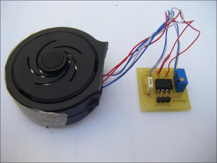

    You can make a small board or use a protoboard
    S is the Signal from the load cell that you need to connect to the arduino pin that will convert the Analog Tension to Digital values (DAC)
    5V is taken from the arduino 5V pin to power the INA
    Ground to Arduino Grond Pin: mandatory
    you need
    - operationnal ampli (INA122PA ou INA125) to amplify the signal 6€
    - condensator to filter 100 nF
    - resistor to adjust the gain 1,0 kΩ cermet 25 tours
    based on the design of Andrew on www.hux.net
    or you can buy a dedicated board
    - derekspearedesigns
    Freestanding Load Cell Amplifier with Variable Gain LCA1C à 26$
    - another board 28$ chez Elane.net
    it works!

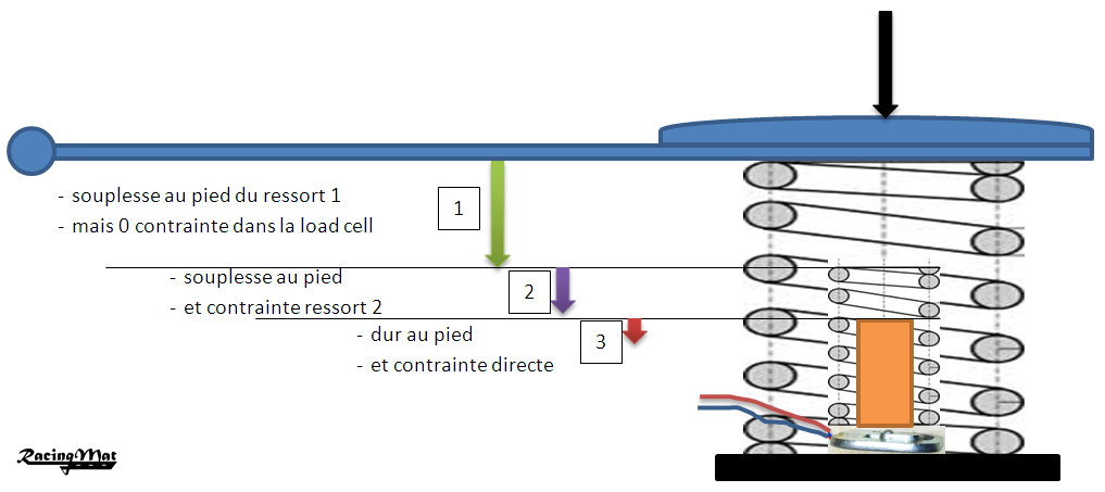

    no need to do that in my opinion...
    I made this sketch in the french post:
    you just have to use 2 different springs at different location and a hard sleeve.
    first spring:
    - between pedal and basement
    - not connected to load-cell
    - only here to find the pedal under your foot
    - like in your car: first you "feel" the pedal and the first centimer you press but no pressure is applied on brake
    - rather weak spring
    second spring:
    - this spring is between pedal and load-cell
    - the pressure is converted into braking
    - rather strong spring
    - in your car, your foot can still go down and braking is effective
    hard sleeve:
    - between pedal and load-cell
    - the total pressure (less the first weak spring) is full applied to the load-cell
    - no pedal travel is possible
    - pressure = braking at no move

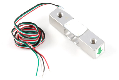

    @WowaDriver : what are the specs of your load cell?
    like this one?
    if so it will fit. You can see 4 wires because it is in fact 2 load cell in wheatstone bridge ;)
    It only requires to output 0-5V range (for 0 to 150 kg range)

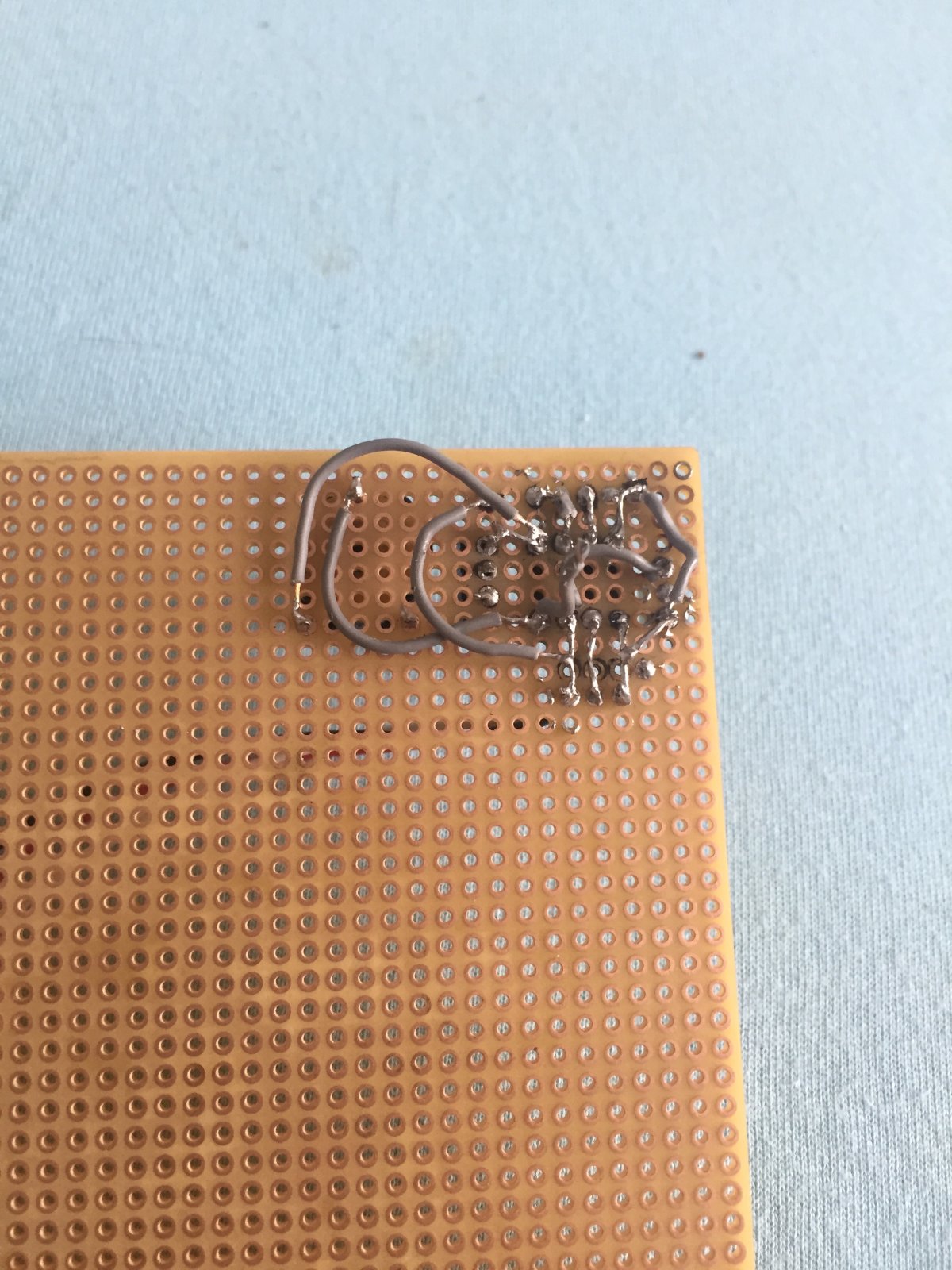

    @RacingMat Yes sure no problem. But please don't laugh... it is only a ten minutes prototype to test :D ...
    I tested out also a normal pot too... It didn't have the precision of the blue one, but it works too

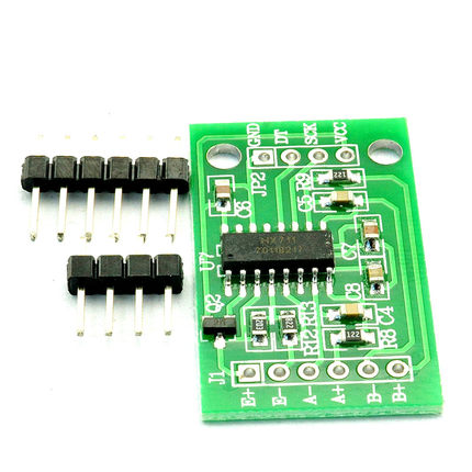

    Will this one be OK?

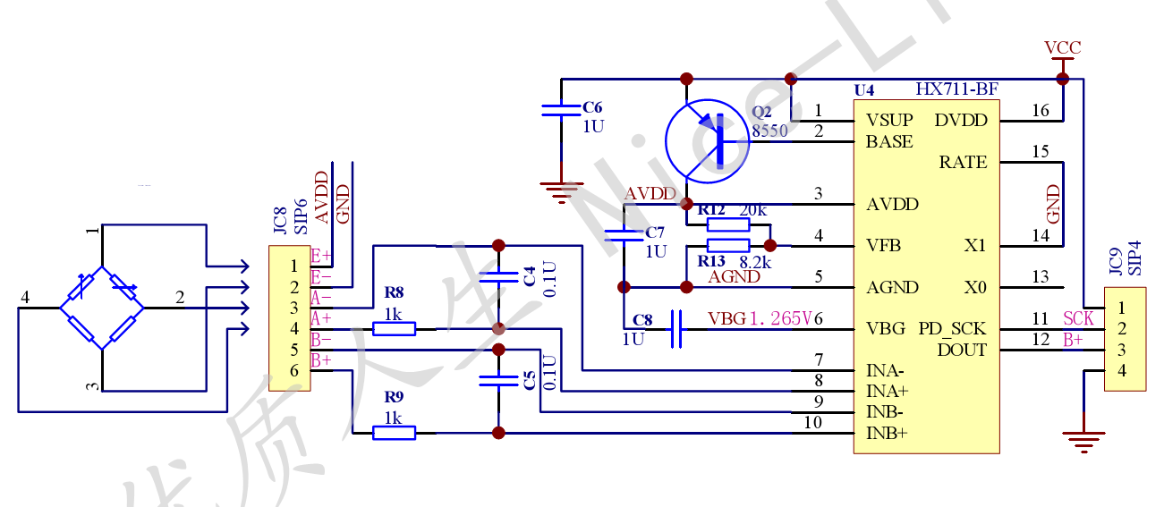

    In my load cell datasheet specified Working voltage (Excitation) 9-12V. Can I connect it to HX711 directly?
