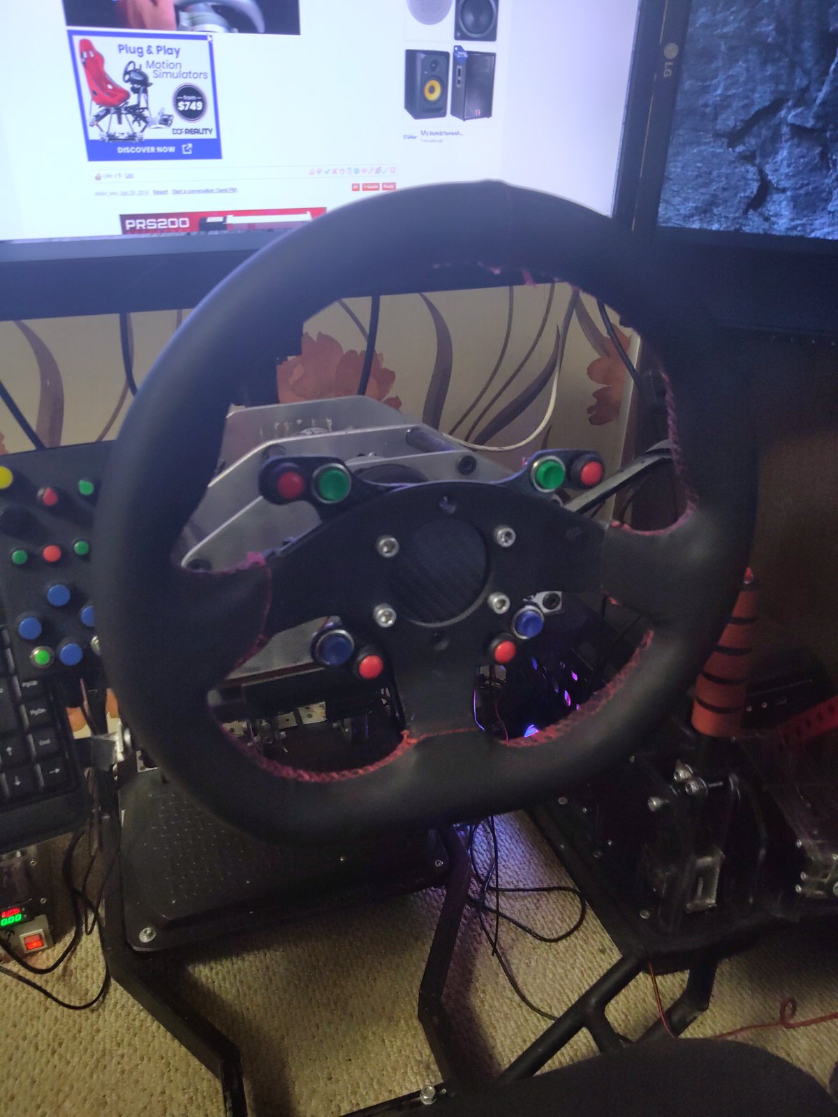

    IMG_20200920_134738.jpg So I want to share my ideas and experience, maybe it will be useful to someone.

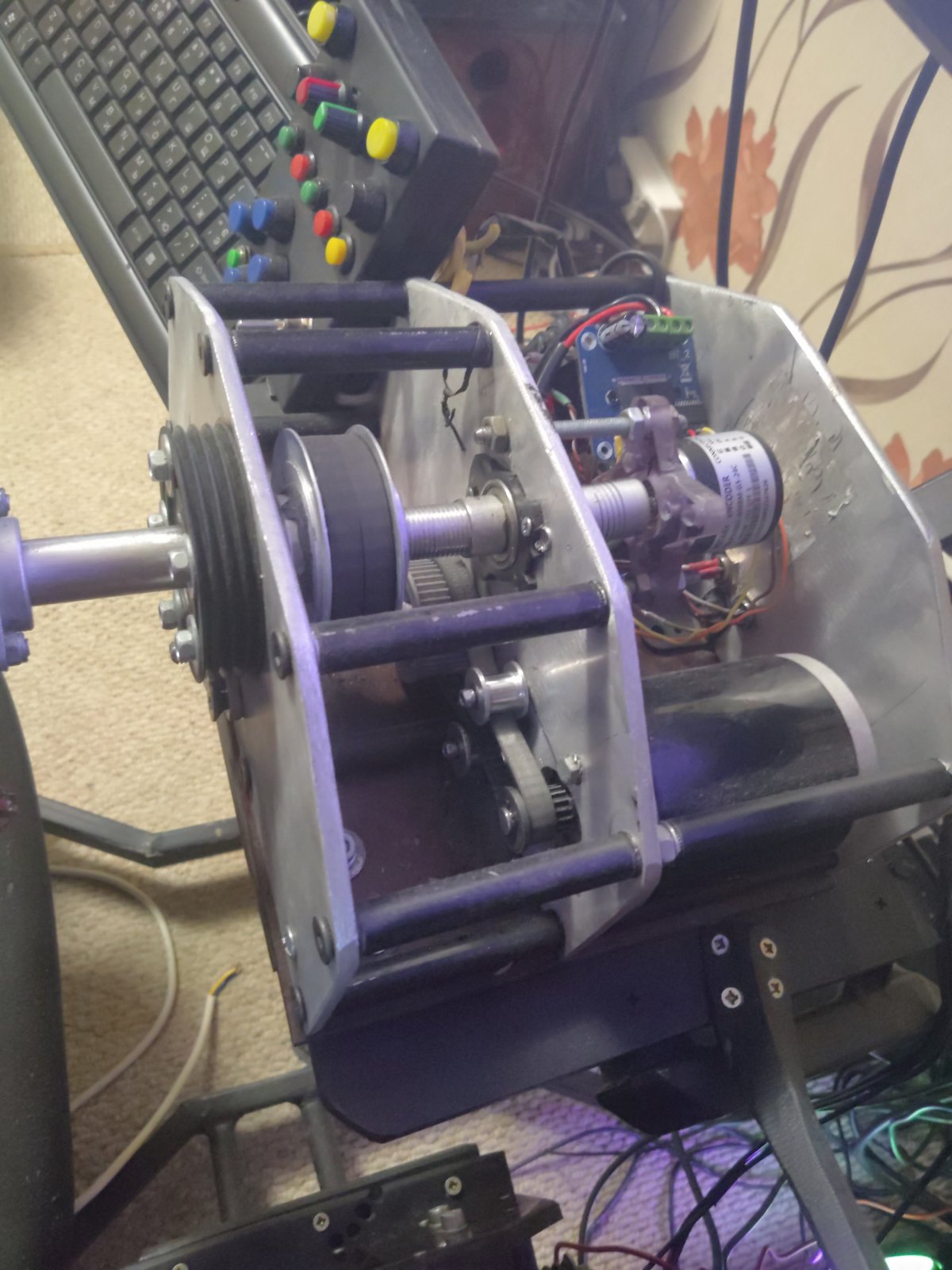

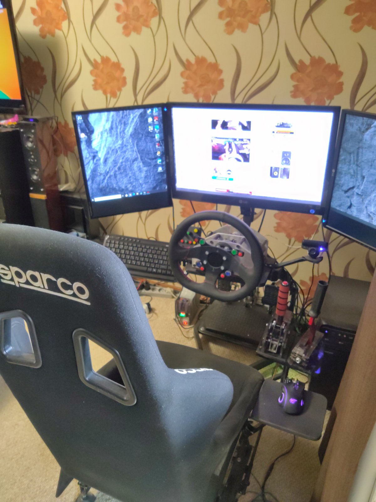

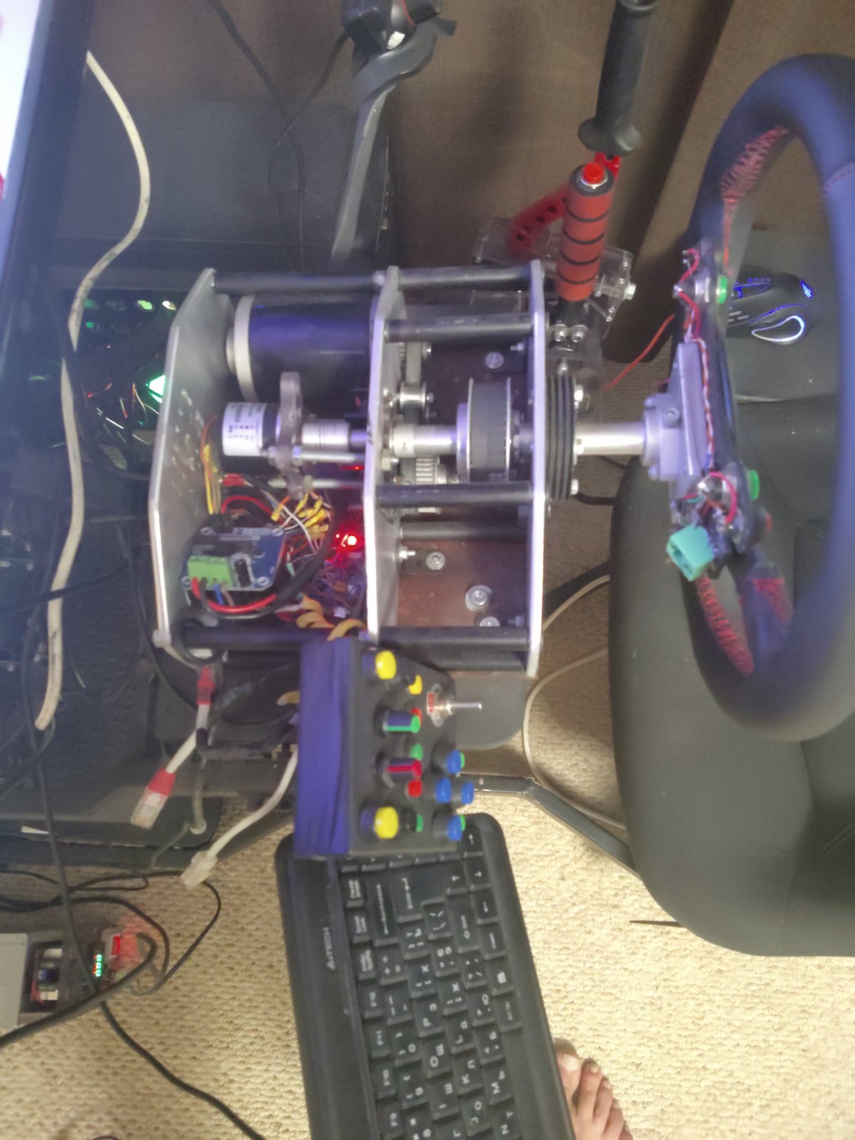

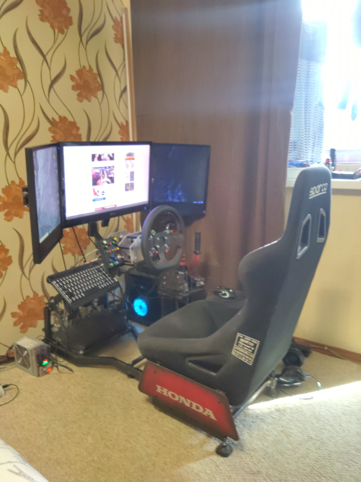

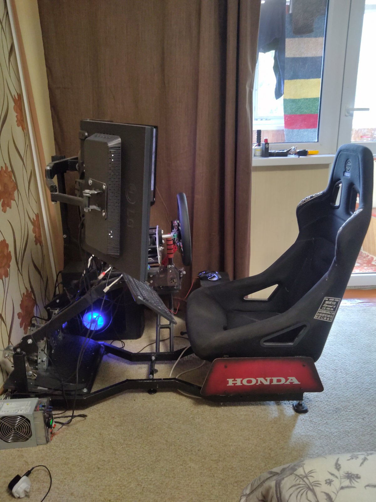

    About a year ago, I decided to build a cockpit, my friend, upon learning about the project, gave me a sparco seat from his drift machine, I used a 20 * 40 pipe, welded everything without drawings - constantly making fittings in place, then I already had a steering wheel with a force fedback which was made according to the ebolzmagy scheme, I used a stm32 motor from an electric scooter my6812 120w various gears and belts from a power tool, the body is made of aluminum

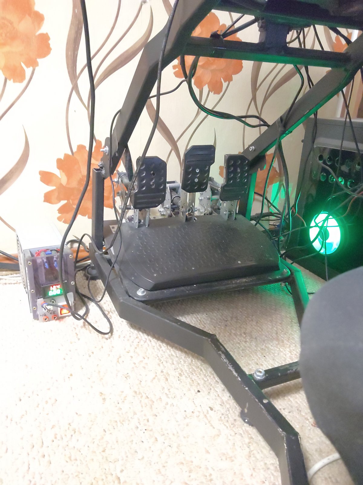

    The pedal unit is a sequential gearbox and a handbrake are also made by me all the ideas I looked for on the Internet from various people,

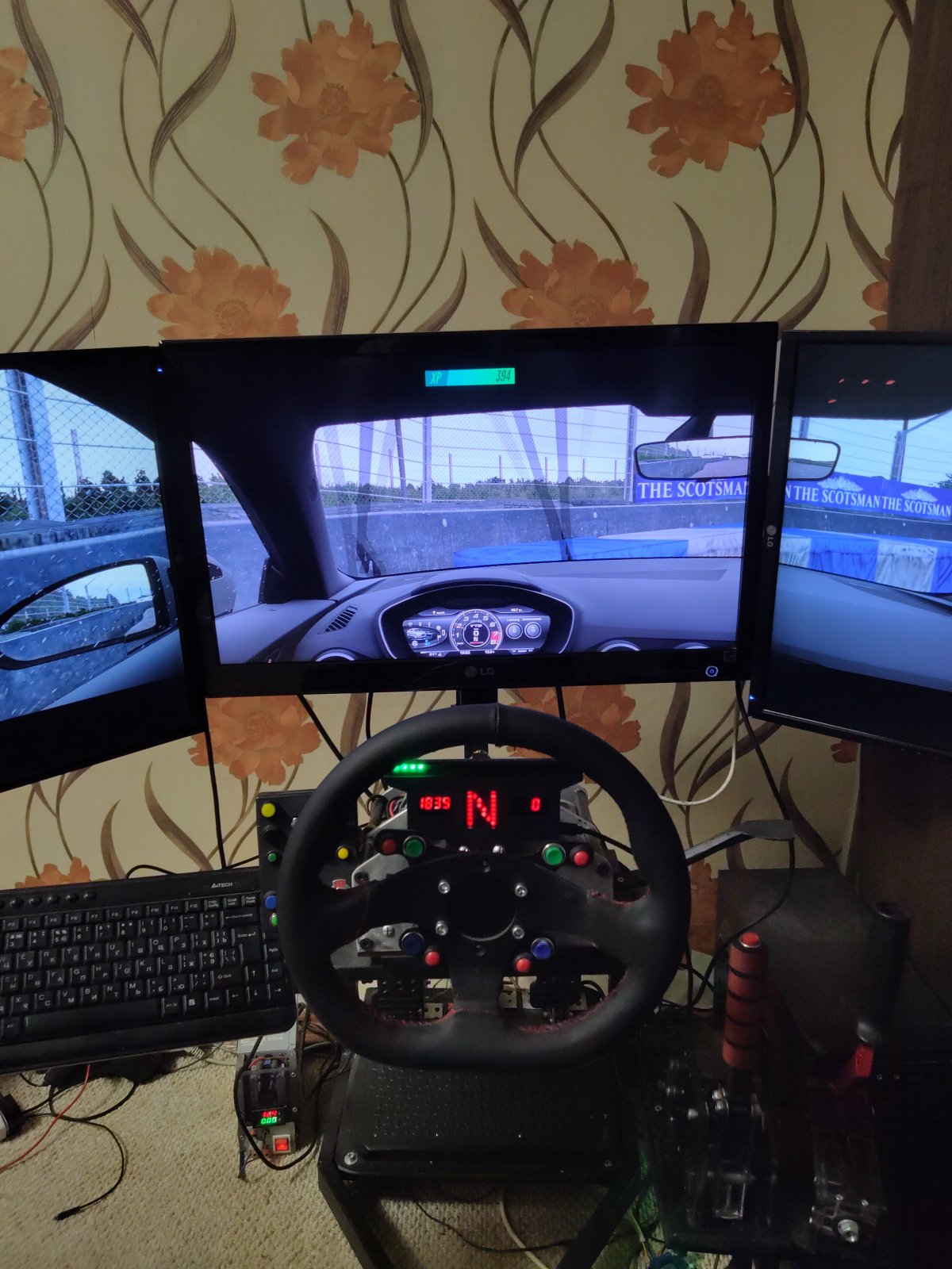

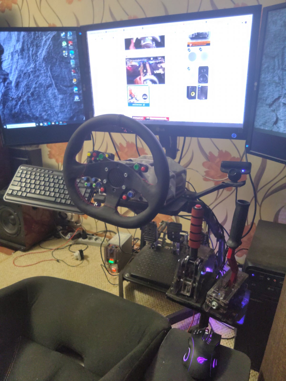

    was also installed budget triplescreen consisting of a main 25 and two side 19 in a portrait position

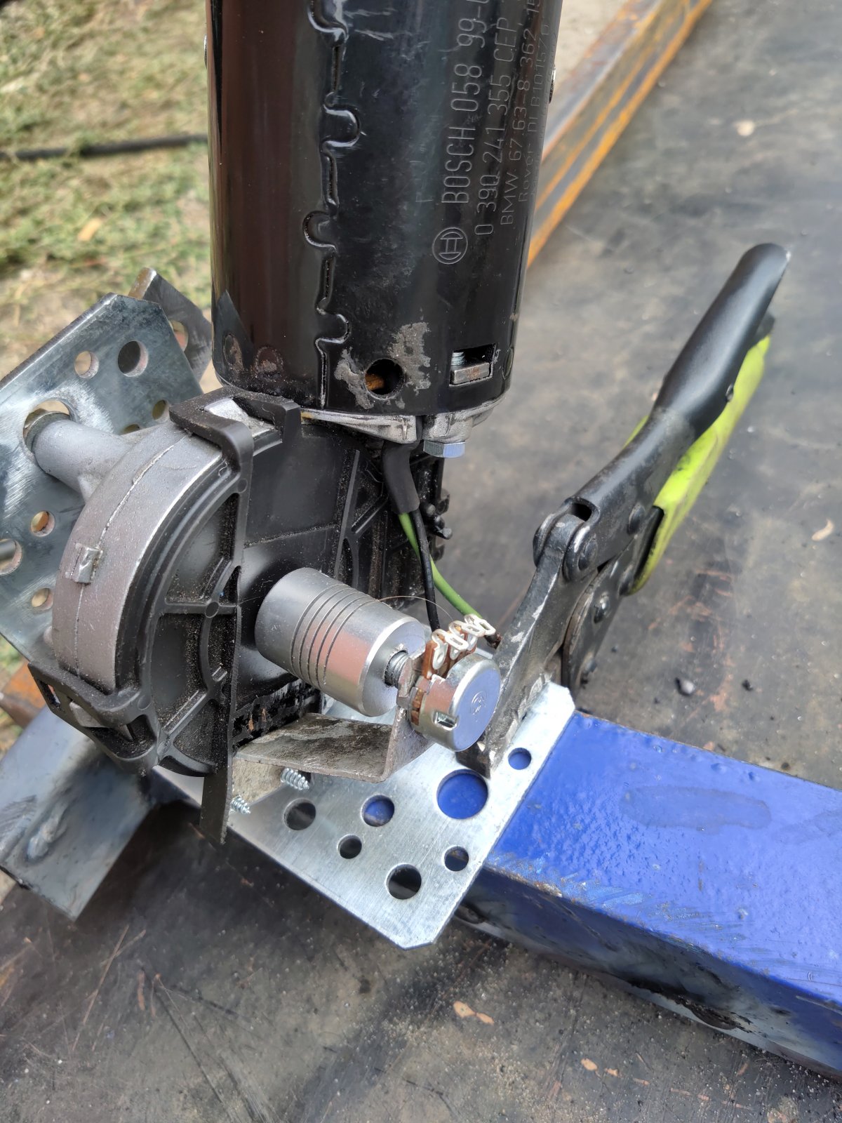

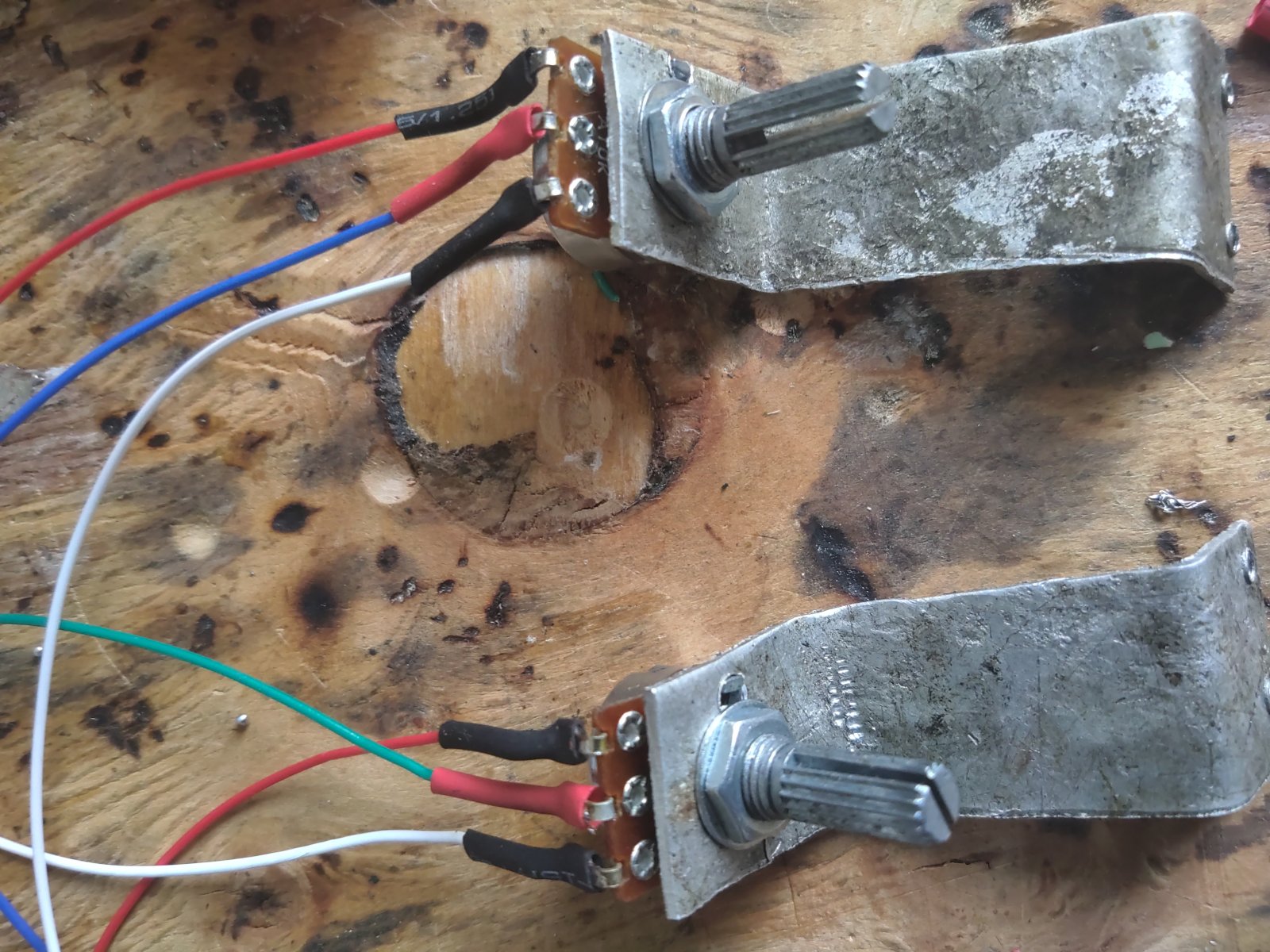

    Now I started building a 2dof system, thanks to your community, I have a huge number of ideas for building and implementing my project, I will lay out my steps for converting my static simrig into a dynamic platform, yesterday I started the first steps to my 2dof system
    IMG_20201002_104319.jpg IMG_20200918_093423.jpg IMG_20201002_115217.jpg IMG_20200922_075552.jpg IMG_20201002_115247.jpg IMG_20201002_115230.jpg

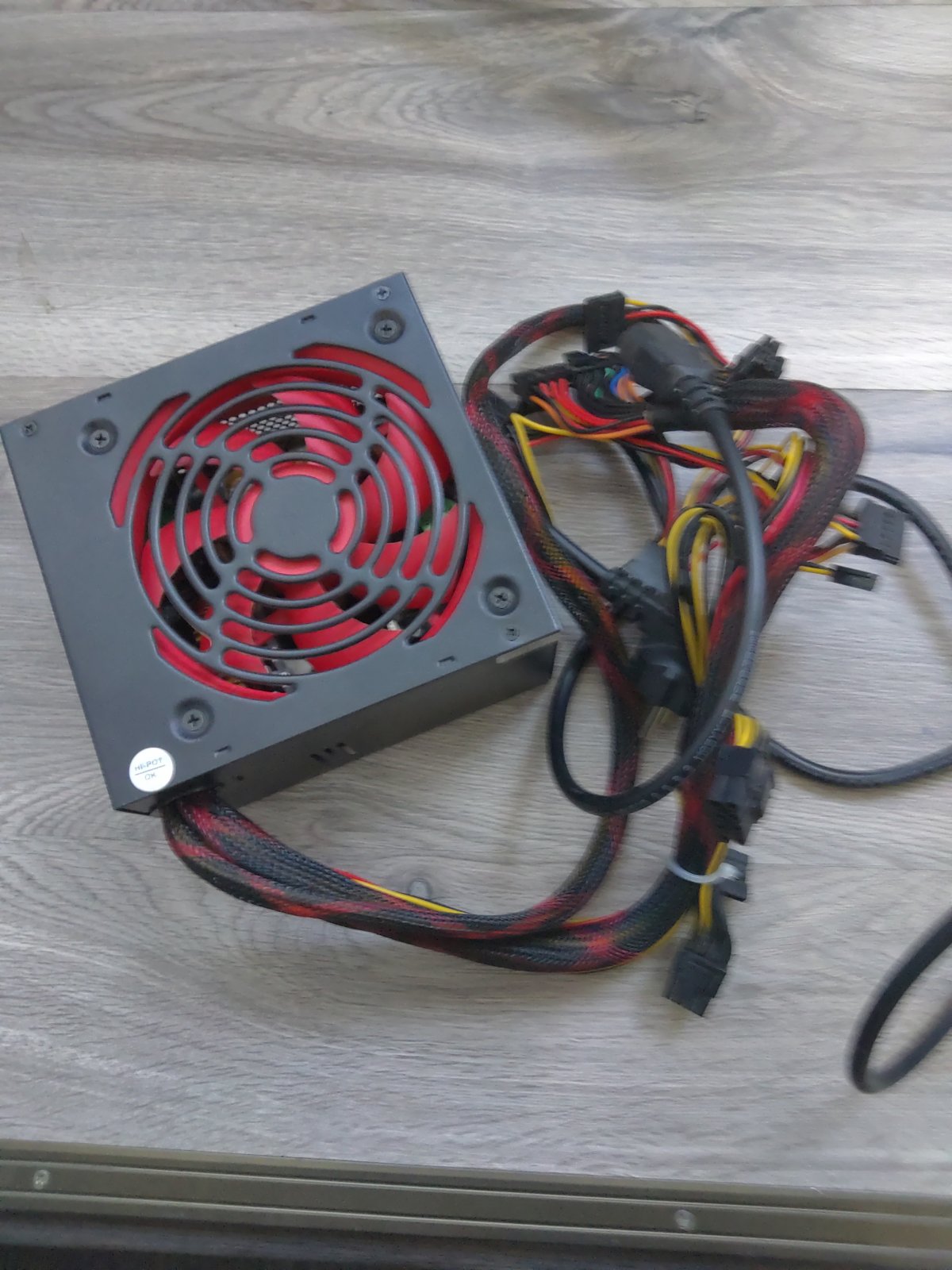

    Today I took the electronics at the post office, for my project and some other spare parts.
    IMG_20201005_091907.jpg IMG_20201005_091846.jpg IMG_20201005_091856.jpg IMG_20201005_091924.jpg

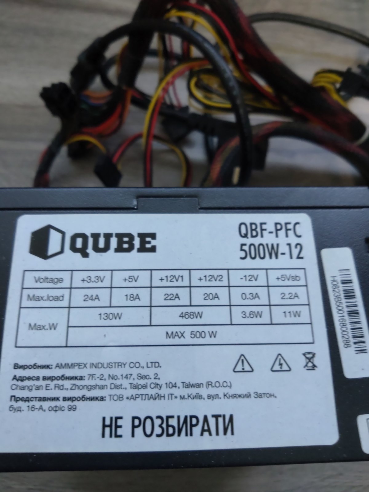

    As a power source I will use a 500-watt computer power supply with a powerful 12-volt line.

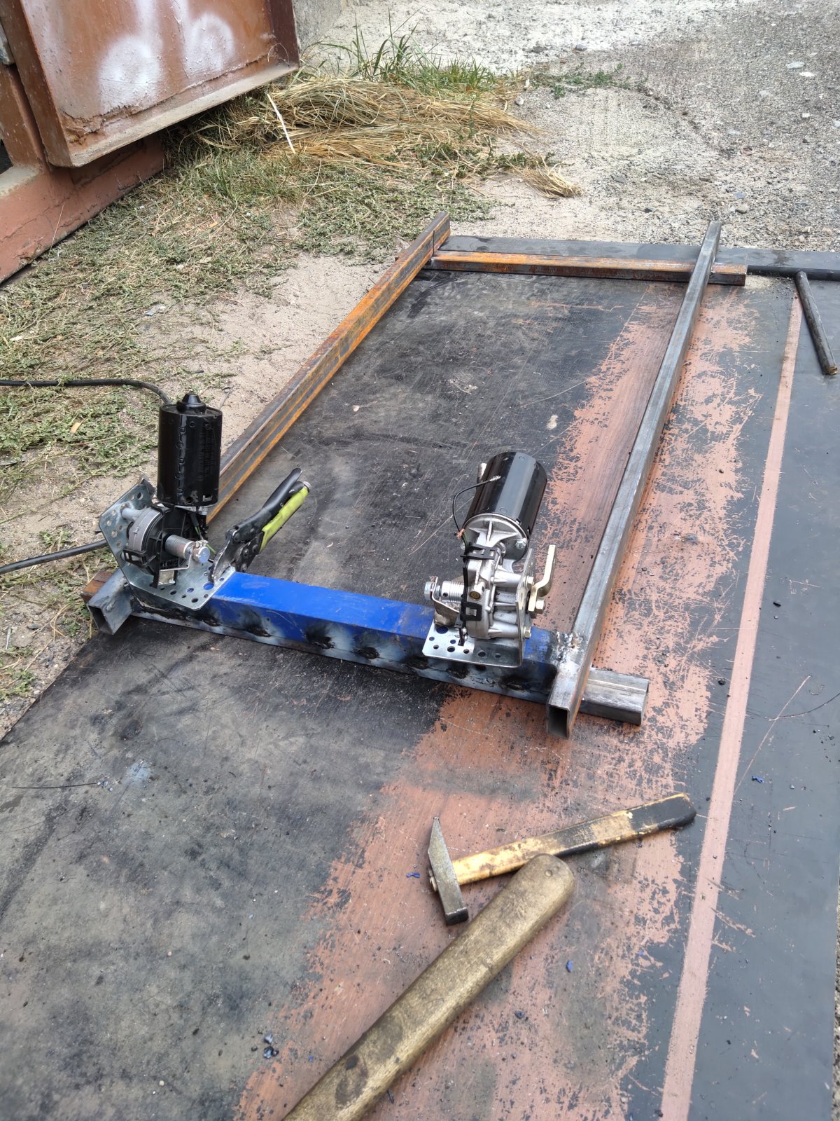

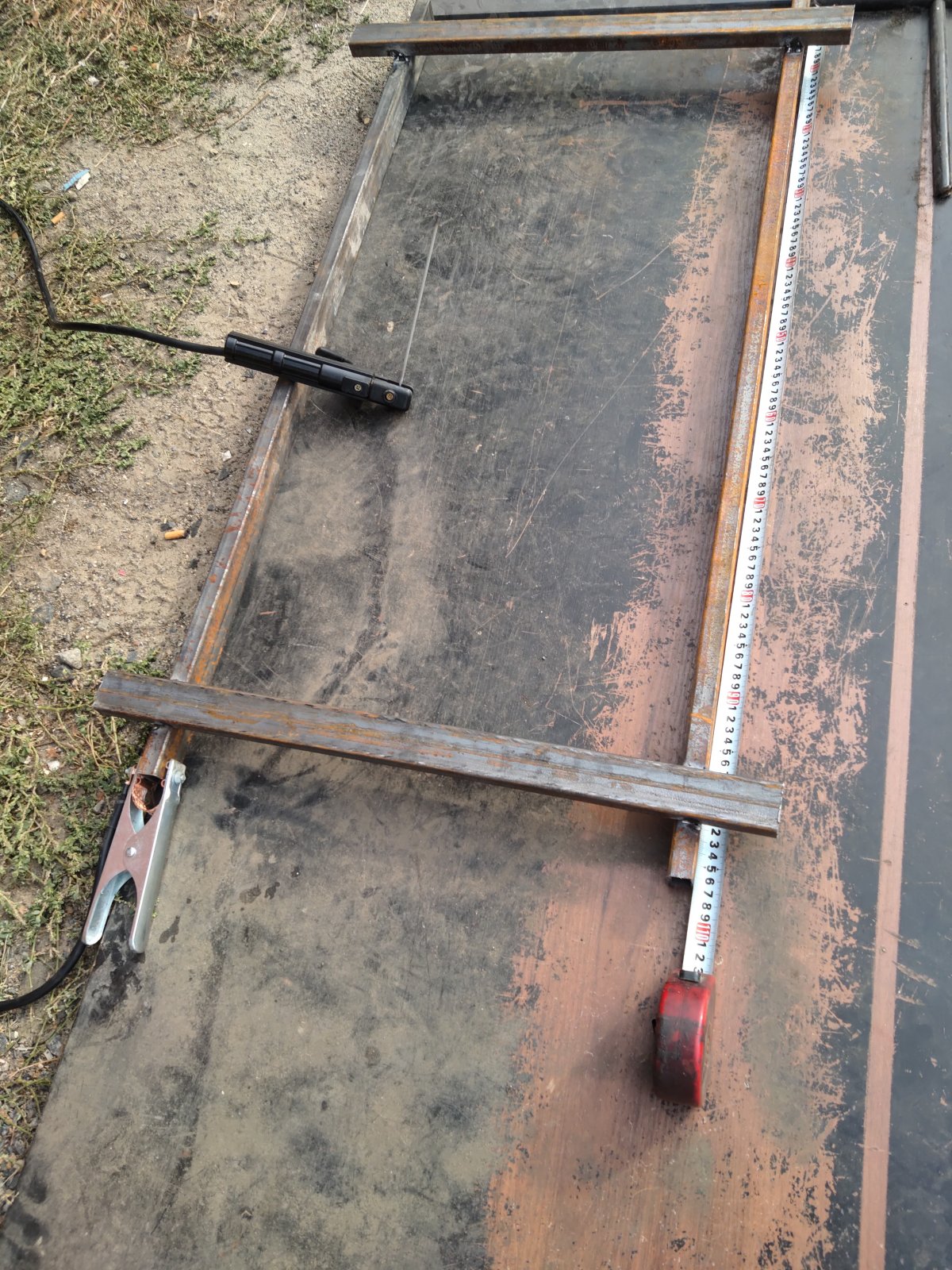

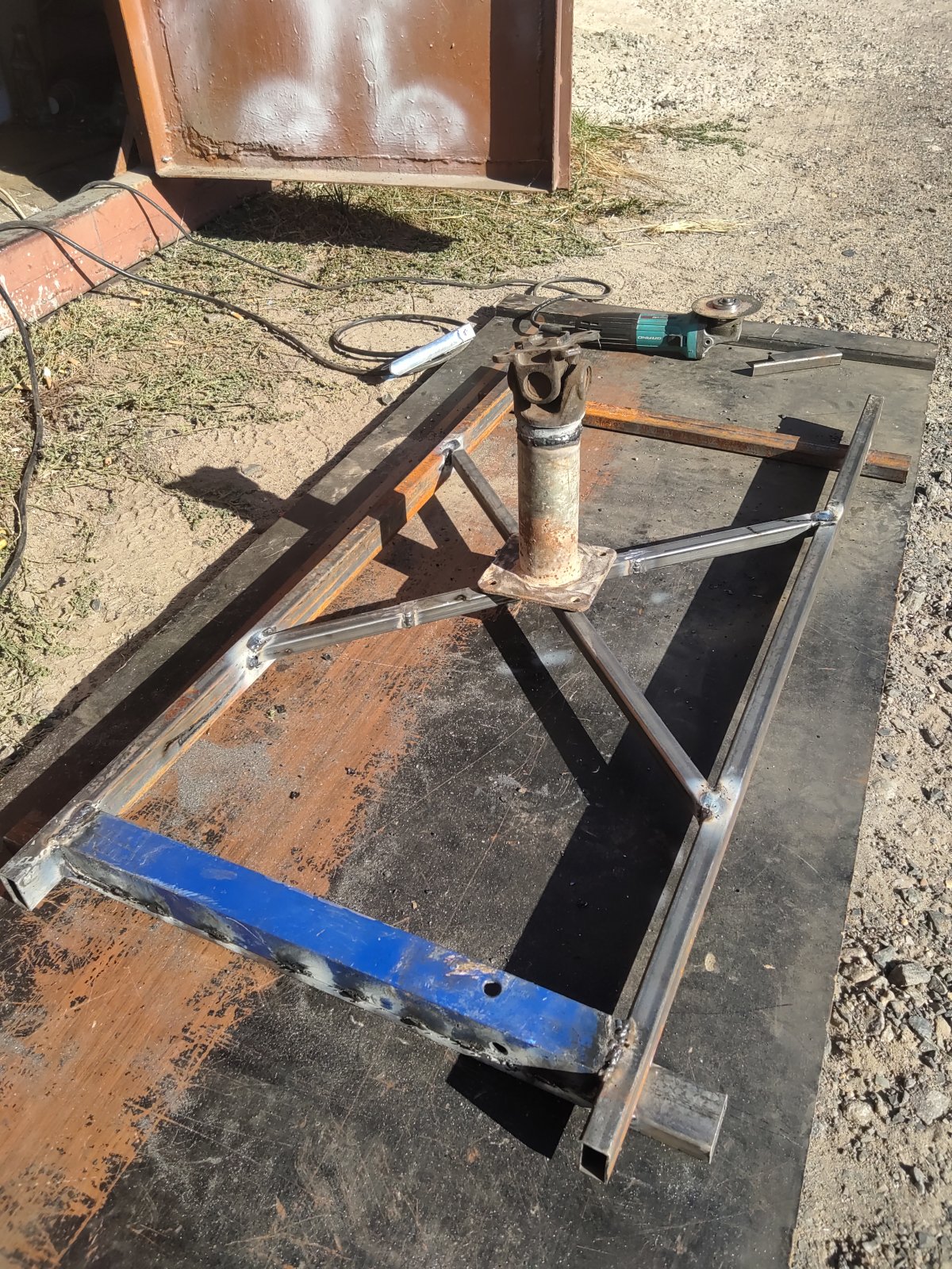

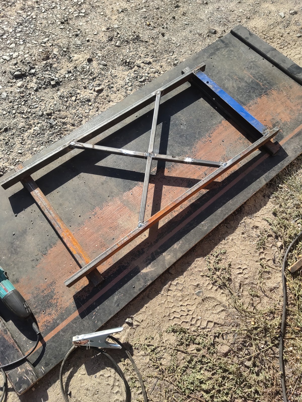

    I also welded a few more elements to the frame.

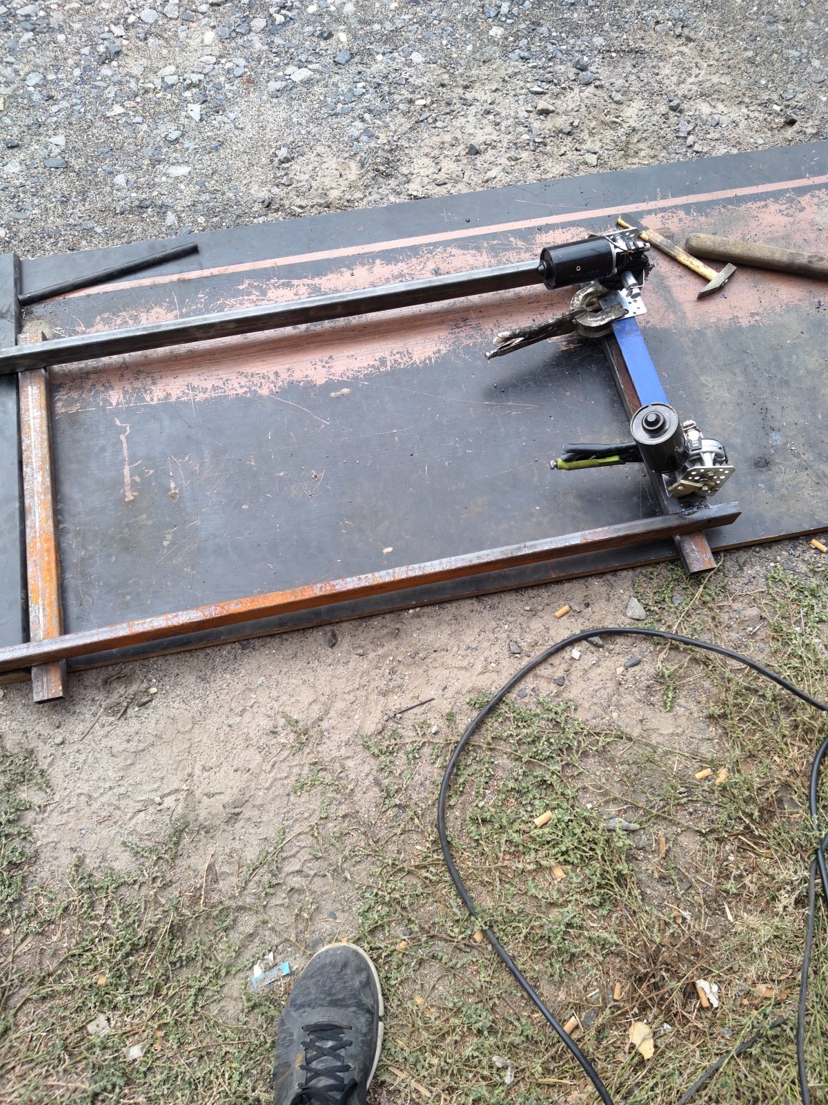

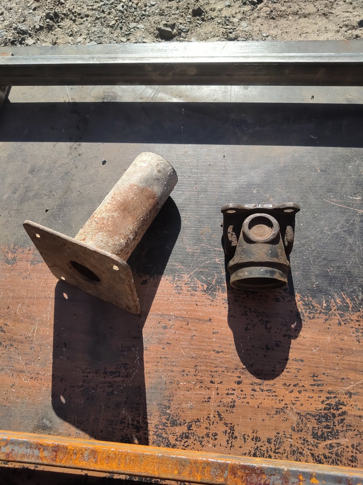

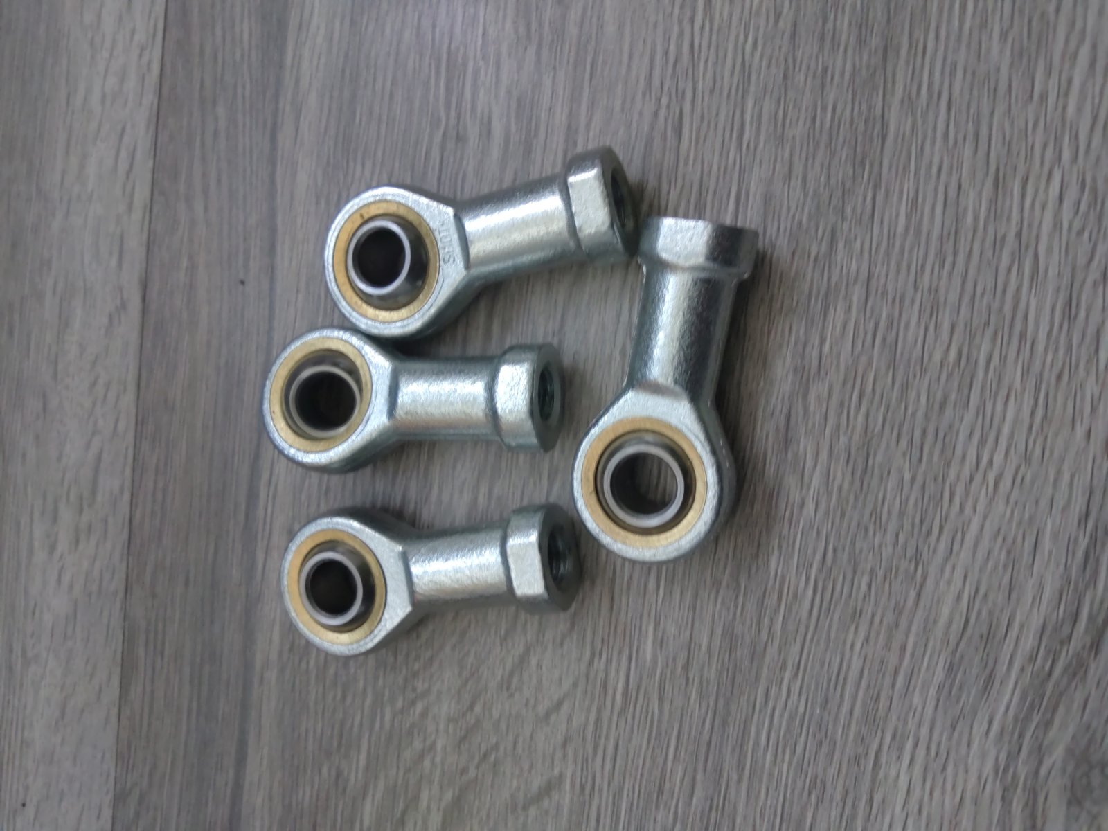

    should be at me now 30 centimeters, in my opinion this is a lot, I think to do 20, what can you say?

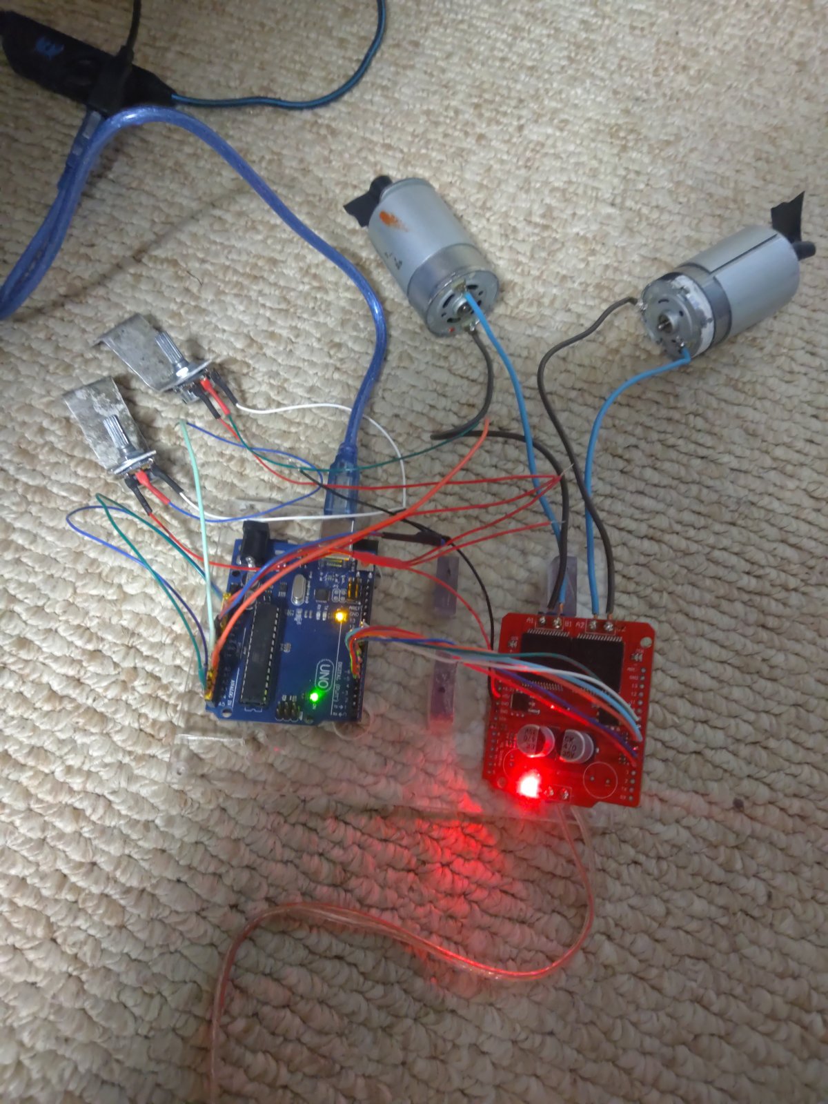

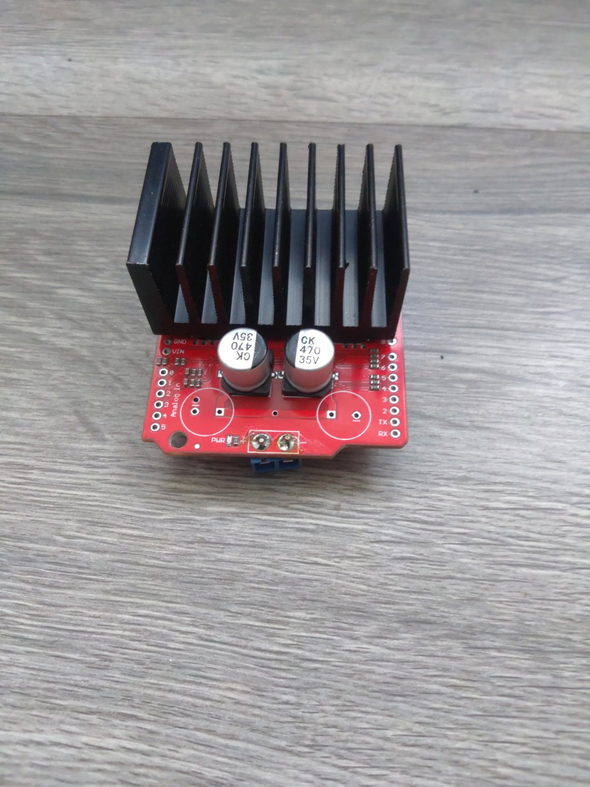

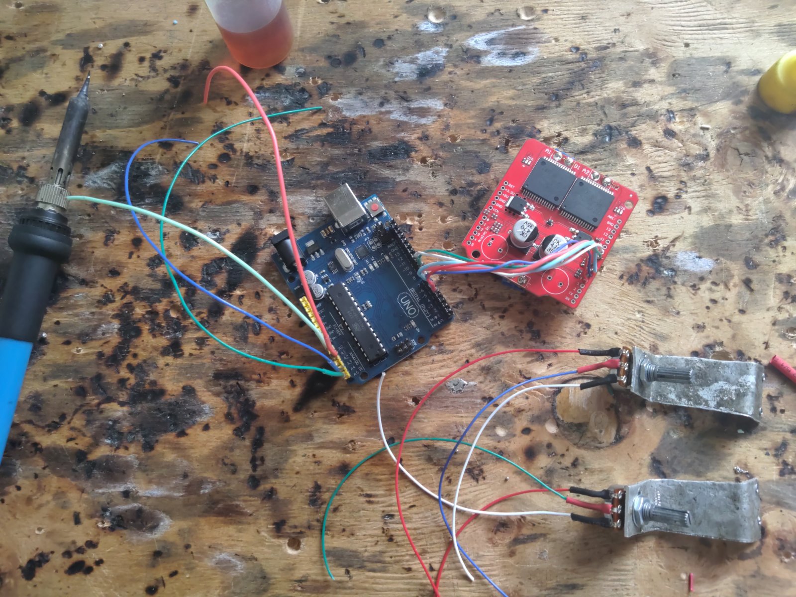

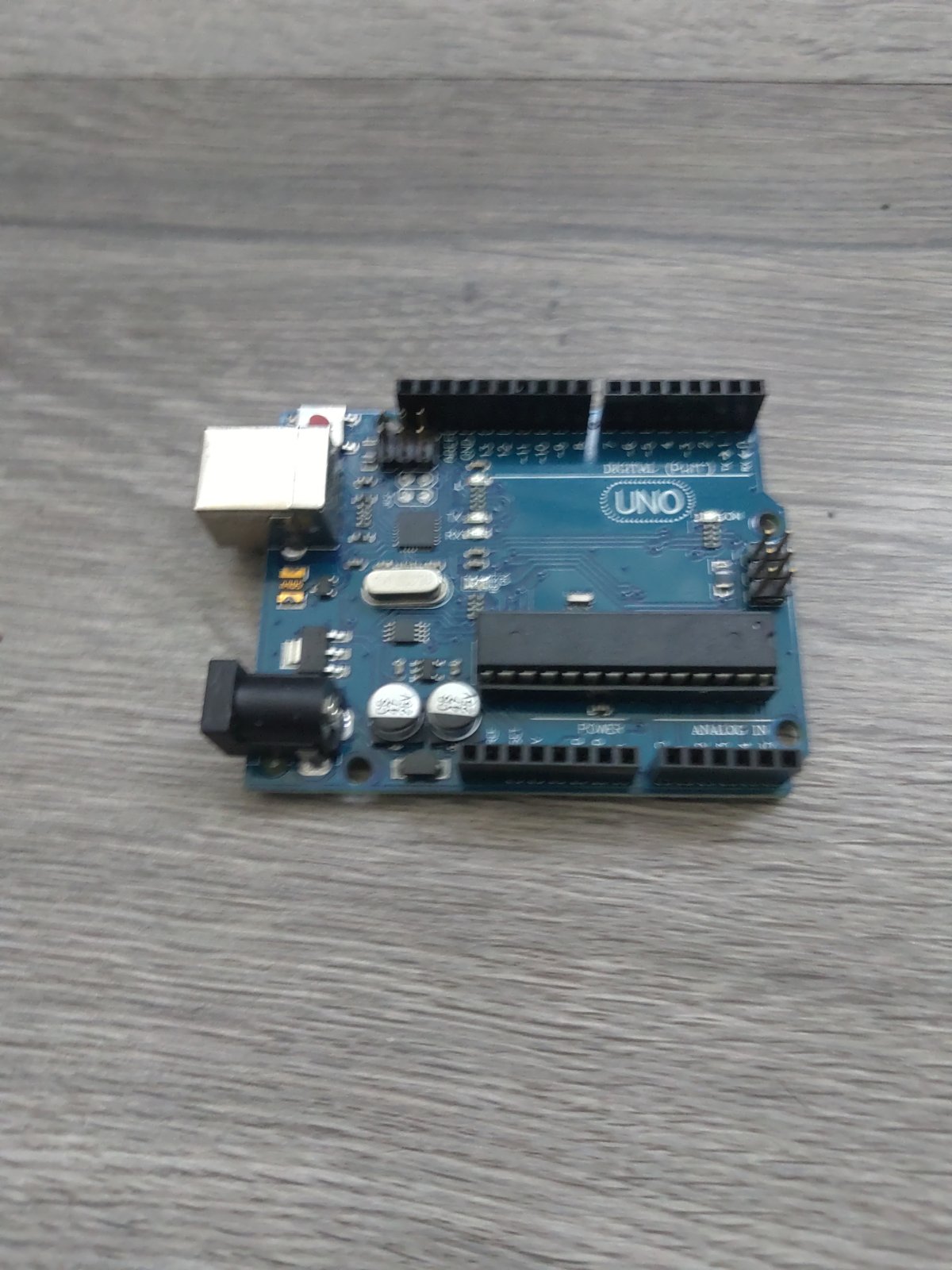

    Finally, there is time to continue my project

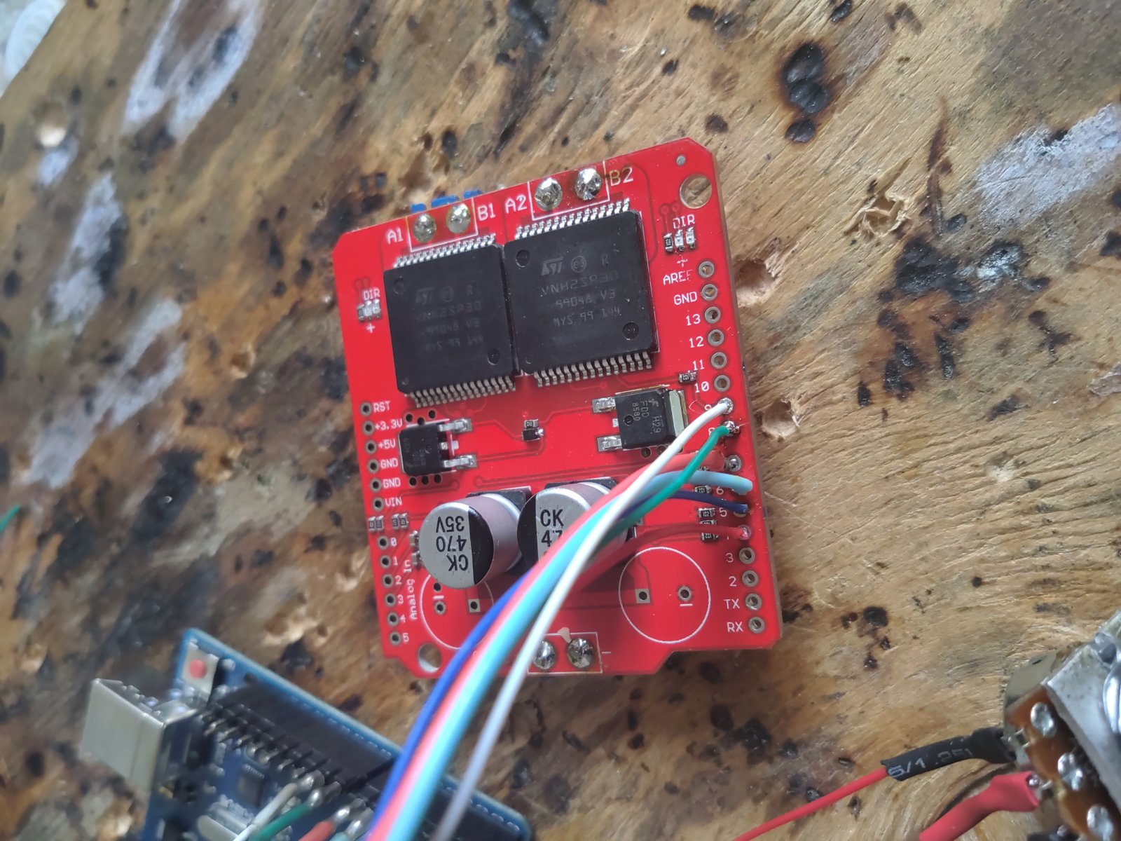

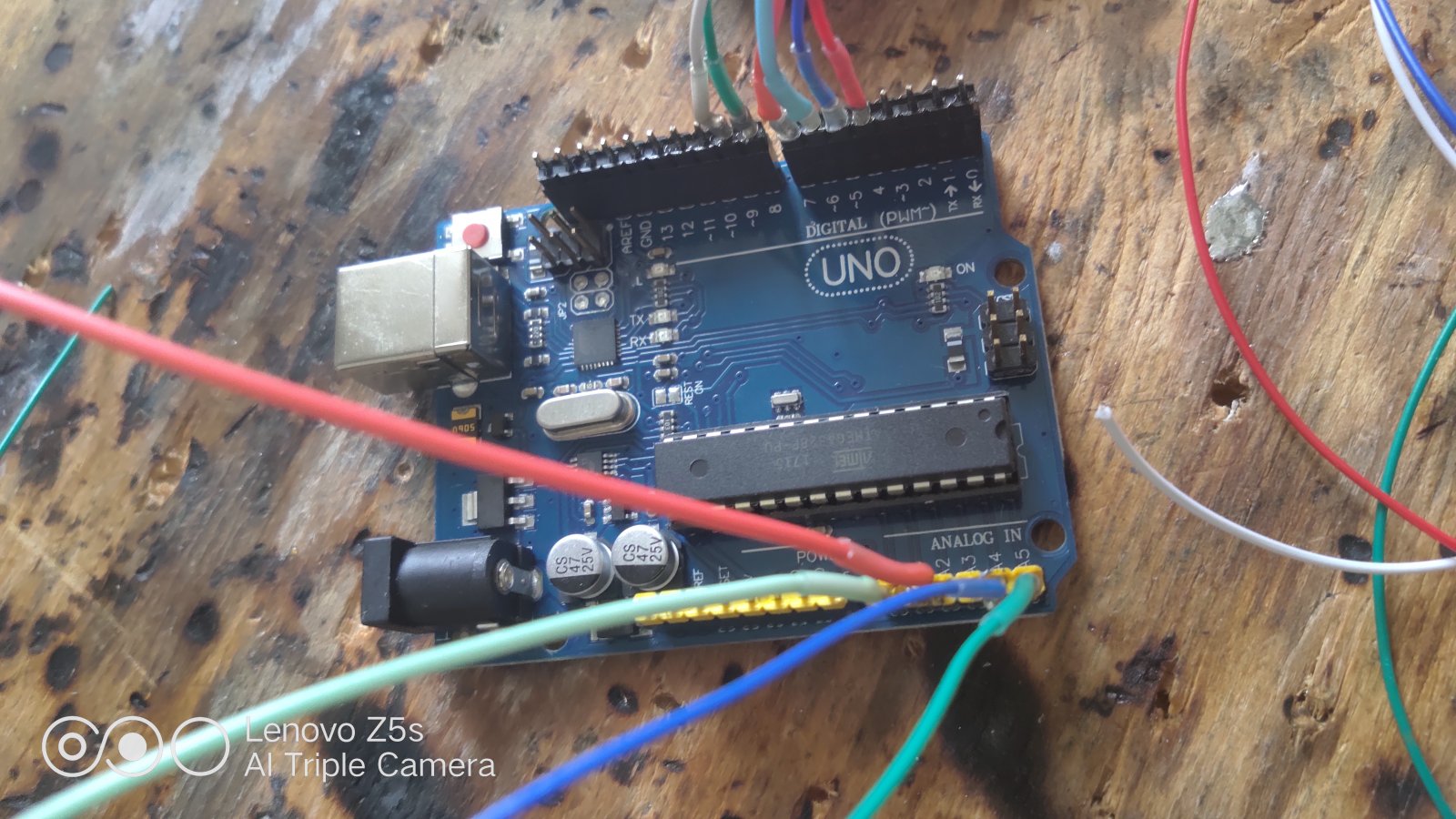

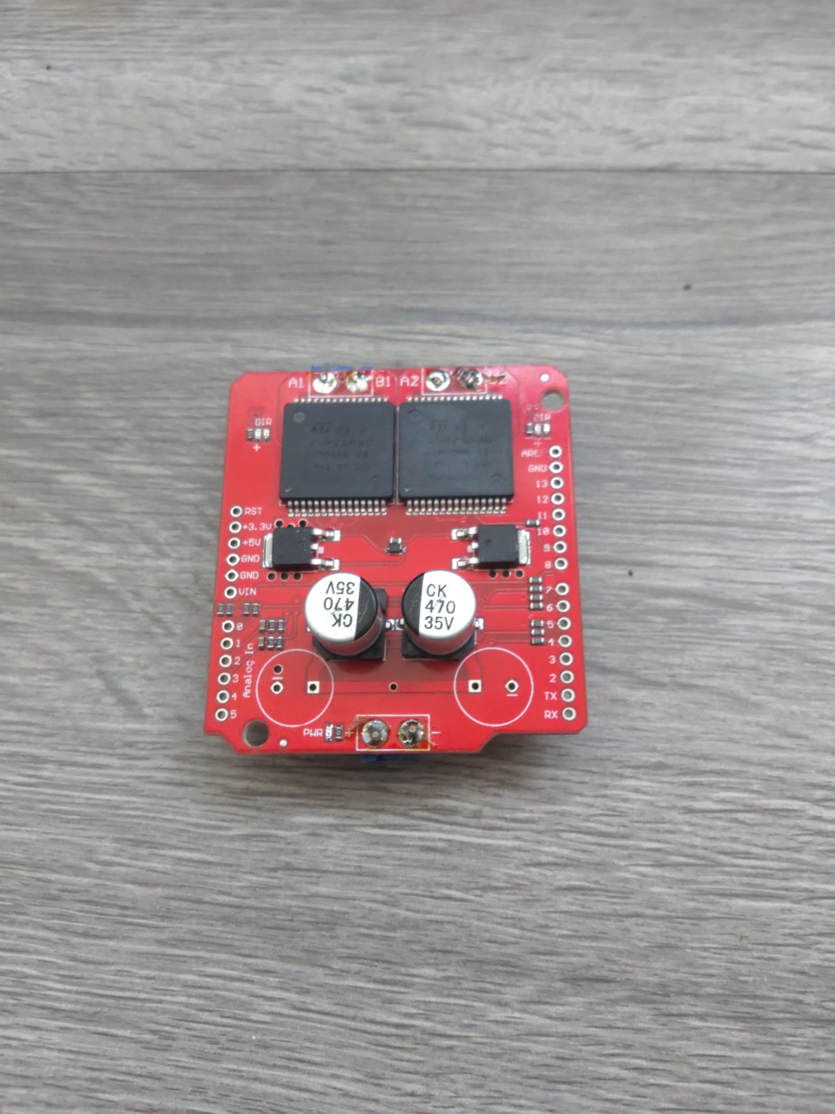

    today I soldered all the electronics, in arduino I used the code from the "racing mat"
    IMG_20201010_094503.jpg IMG_20201010_094526.jpg IMG_20201010_094532.jpg IMG_20201010_094543.jpg
    immediately decided to conduct tests, but nothing happened - the motors did not spin, there was no reaction to the rotation of the potentiometers
    First failure, I will look for a problem.))) !! ???

    Did you test the MMs: https://www.xsimulator.net/community/faq/monster-moto-testing-before-use.158/

    No, I bought MM from a trusted seller who assured me that it was 100% working fee, I decided that the problem was in arduino, first I rebooted smc3 1.01 and immediately the left motor started working, the right one continued to be silent, I downloaded the code from the racing mat again and that's it working ))
    but i have questions
    1 - the motors do not stop in the middle of the rotation of the potentiometers about 80\20
    2- left motor rotates twice slowly and multimeter shows only 6 volts ??
    why so and how to adjust the position of the potentiometers ????

    I am confused, you mention using SMC3 code, then @RacingMat's code.
    For SMC3 make sure the pots are connected to the motor and you can use the handy configuration app to center the pots and set the clip limits.
    If you are showing 6V then test the MM.

    i first loaded smc3 the right motor didn't work at all, then loaded the racing mat, right motor works well
    , left motor in one direction 12 volts, and in the other 6

    Yesterday I was looking for the reason for the incorrect operation of MM all day, apparently the reason is in MM itself, one motor refuses to work normally, then it sharply changes direction, then it turns slower in one direction. I will buy IBT-2 BTS7960, I'm very sorry for the time spent now again wait until the spare parts arrive)))

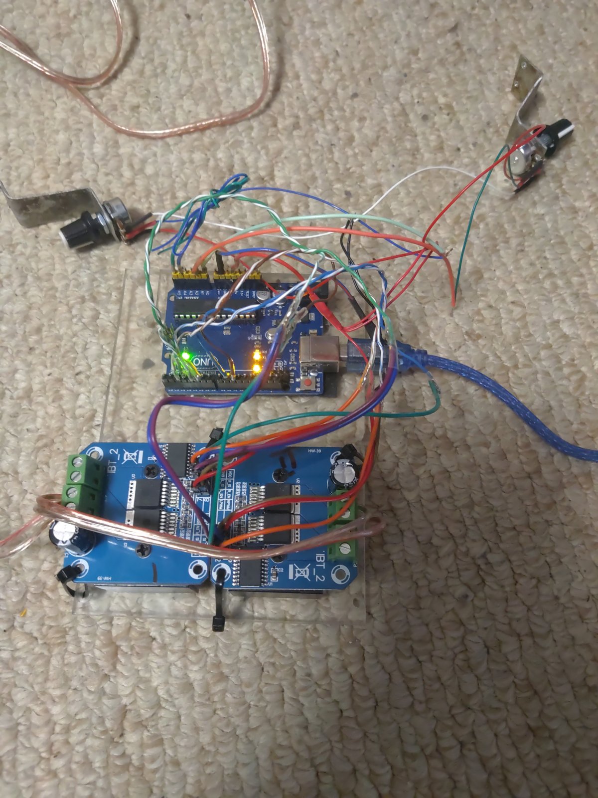

    Today I bought 2 pieces of IBT-2 BTS7960, installed smc3 -code2, smc utility, performed all tests without installing sim tools, everything works well, now i need to download a demo version and connect the motors with installed potentiometers and conduct tests in simtools IMG_20201019_154759.jpg

    Noticed you're working on carpet - walking/moving around on carpet can generate static electricity which can damage and/or kill electronic components (mainly IC's). You're better off working on a wooden surface and discharge yourself to a earthed connection before working with static sensitive devices. Earthed anti-static mats are also handy.

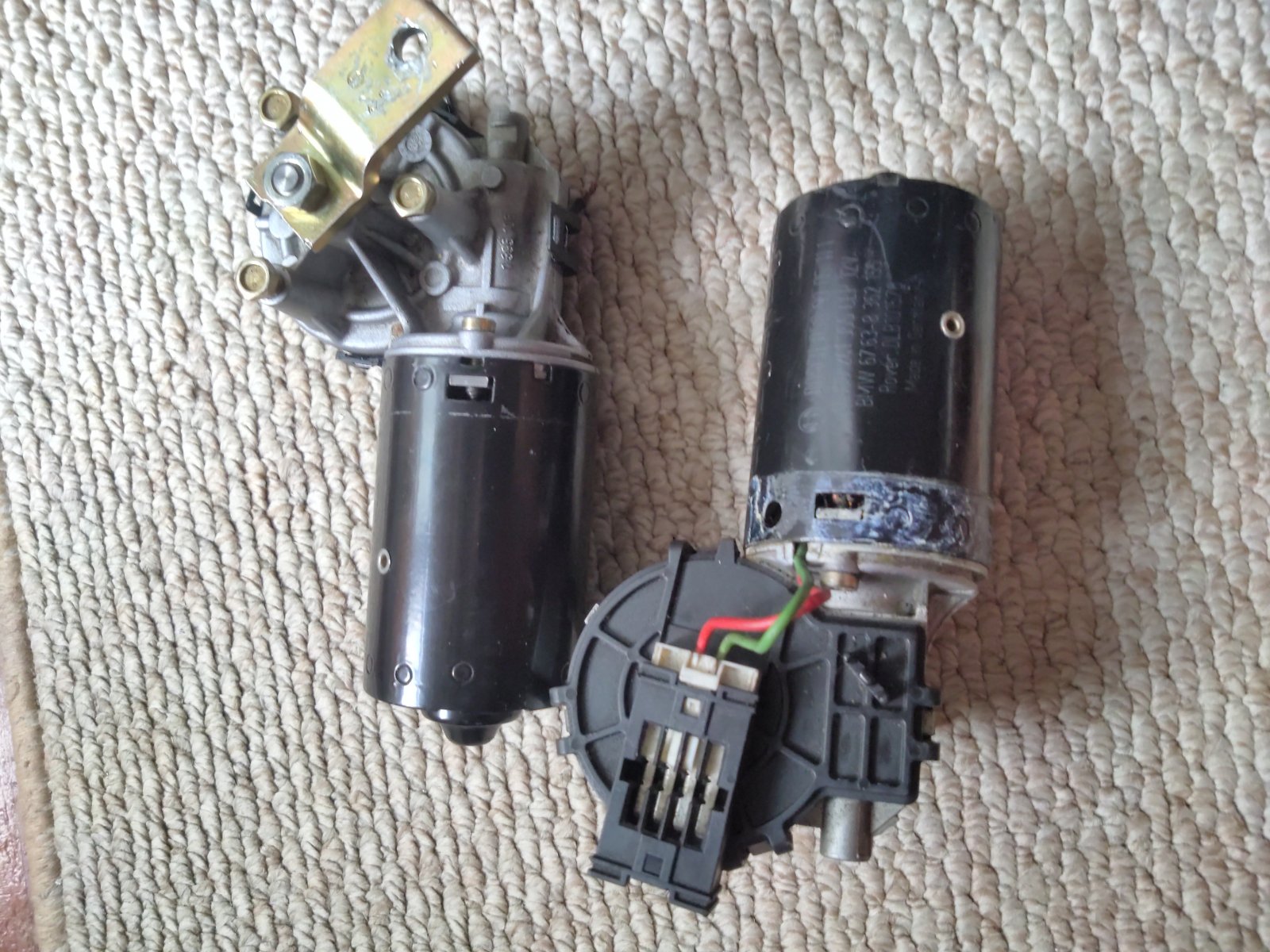

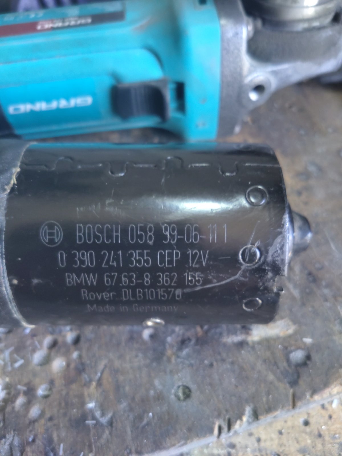

    Tests passed today, wiper motor from BMW e46 , Arduino UNO + SMC3 & BTS7960 * 2

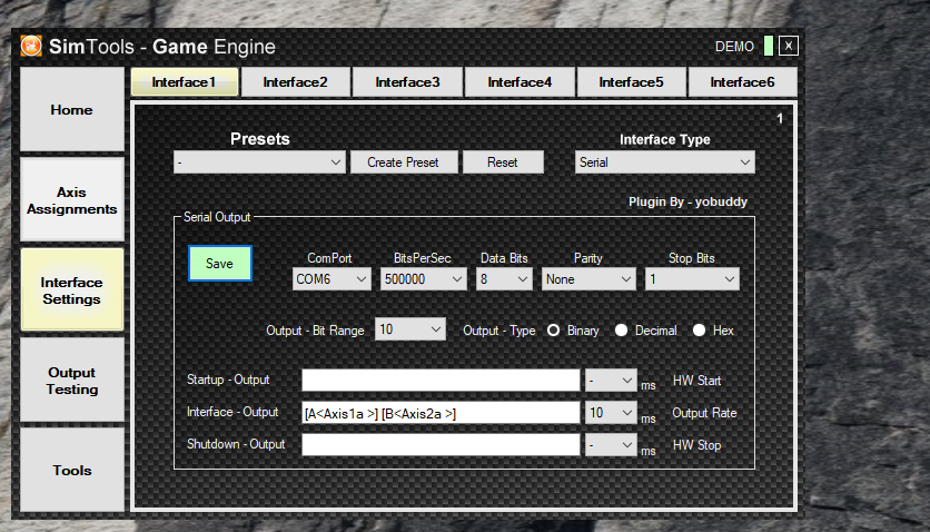

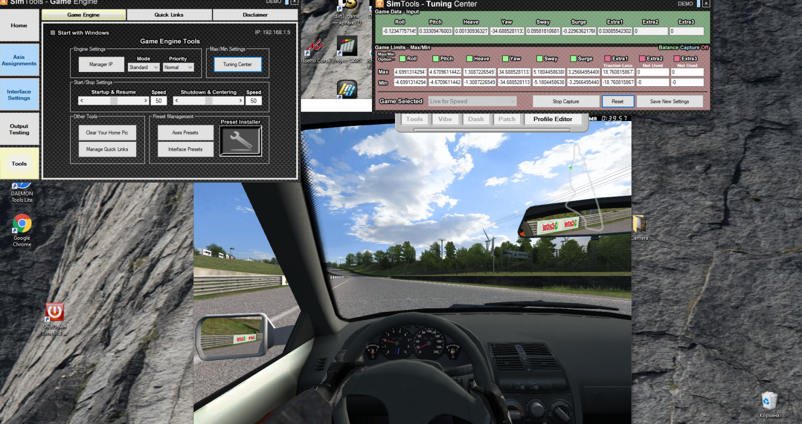

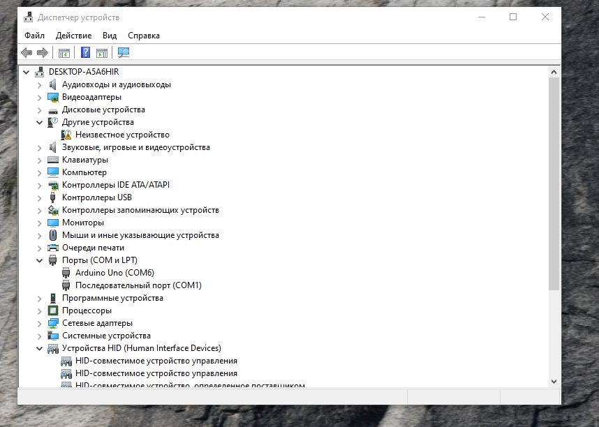

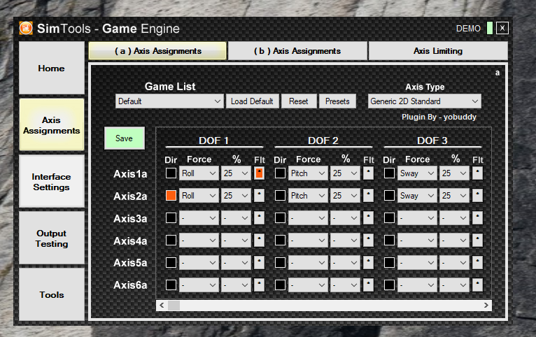

    Help, what am I doing wrong, I installed simtools, installed the LFS plugin, telemetry works, but Simtools does not transmit a signal to the Arduino, in test or game mode, test with SMC3 fine , everything works well, but with Simtools the test is nothing? I turn on LFS telemetry is running but the motors do not move as if there is no connection between the computer and the Arduino

    in what order to launch,
    -sim tools first and then LFS ,or it doesn't matter
  18. noorbeast
    21,592
    151,215Coins
    Have SimTools running then launch LFS.
    Does Output Testing work as expected?
  19. redford 77
    redford 77 Member
    Sep 13, 2020
    47
    Technologyst of fiberglass
    Ukraine Kharkov
    - 131Coins
    +21 / 0 / -0
    No, I do output test ,but nothing to move
