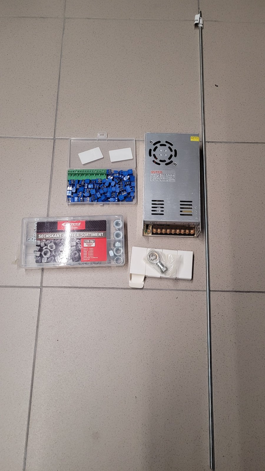

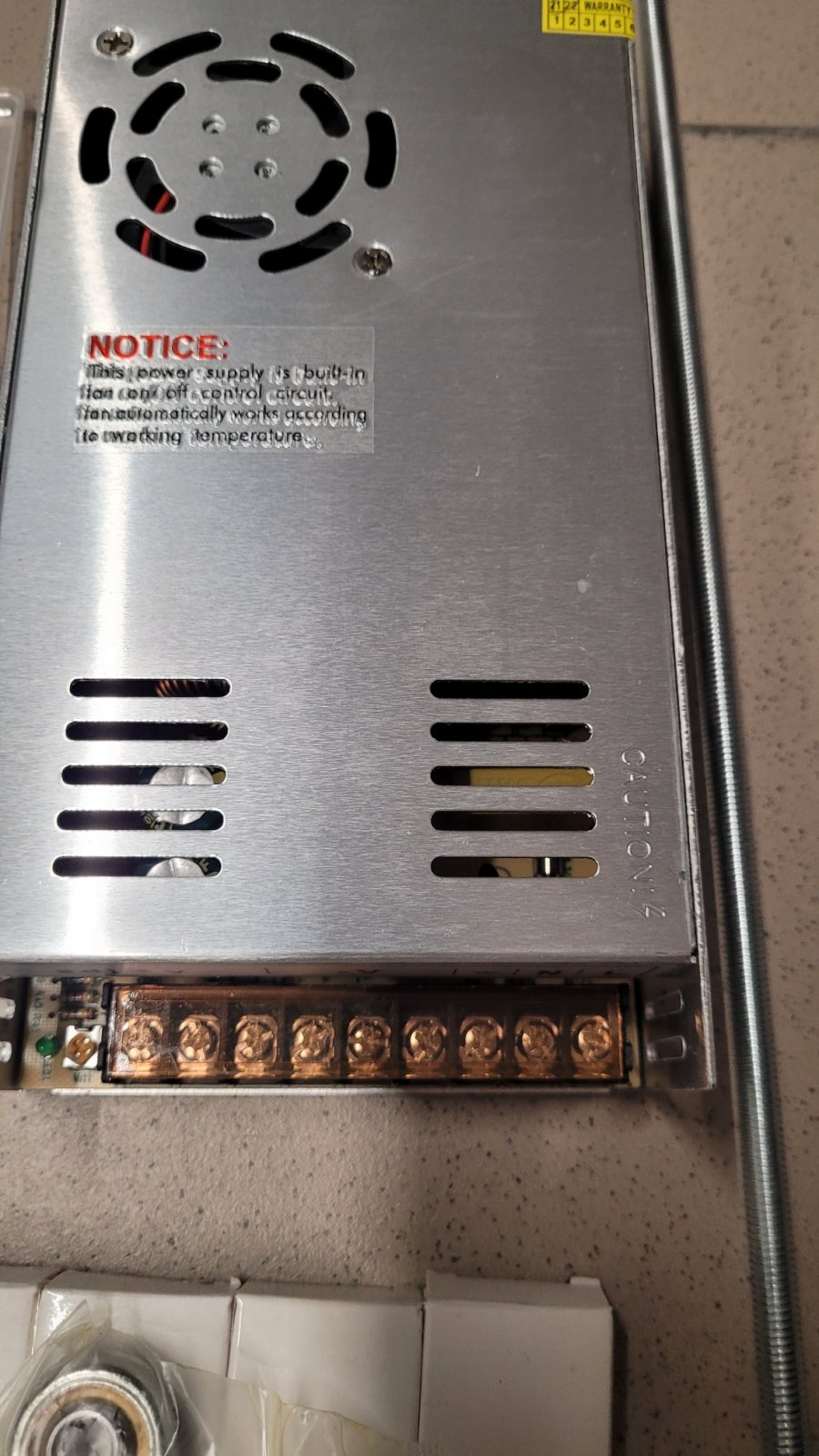

    material is ordered (motors a MMs and 400W power supply) now it's time to wait to move on

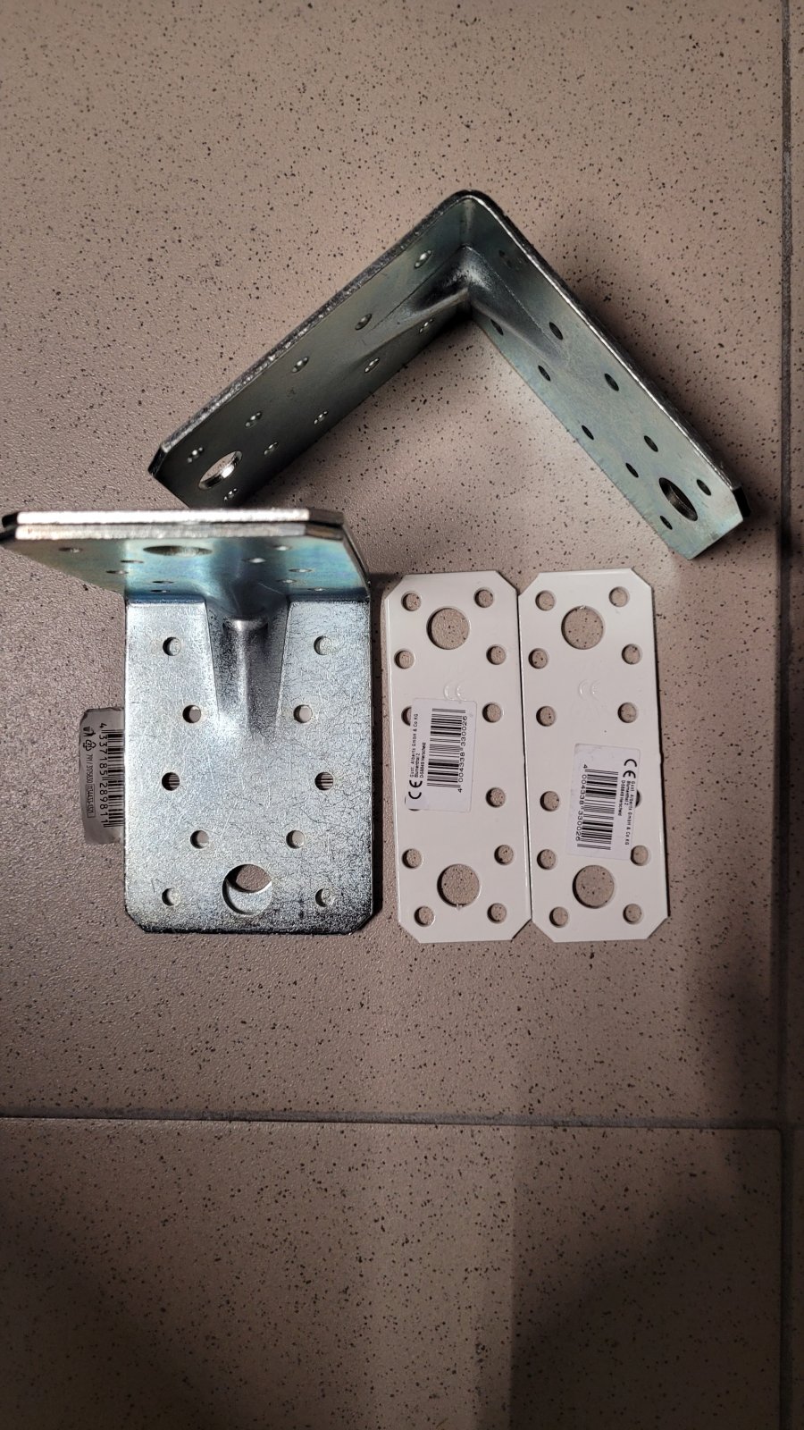

    slowly the remaining components are coming
    a pair of brackets and bars

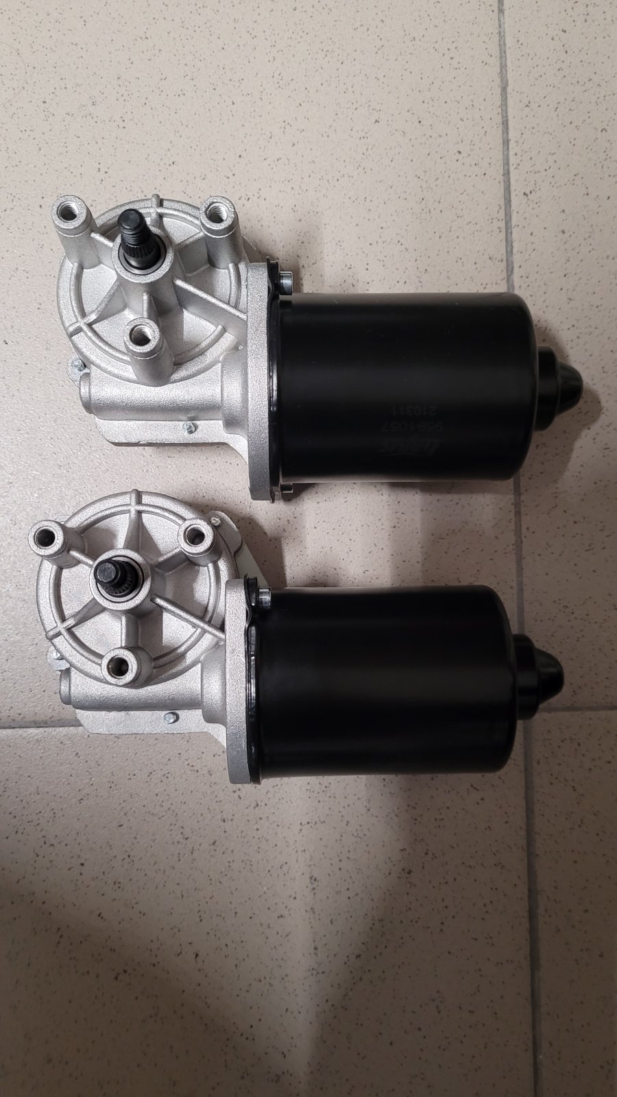

    and the Wiper motors are also already there

  9. xmcnodx
    xmcnodx IL2 Sim with 2Dof
    Sep 7, 2021
    99
    Schmelzer
    Zirndorf Deutschland
    94Coins
    +19 / 0 / -0
    @noorbeast Thanks for the link it was my rescue
    so the rest of the material arrived the construction can begin

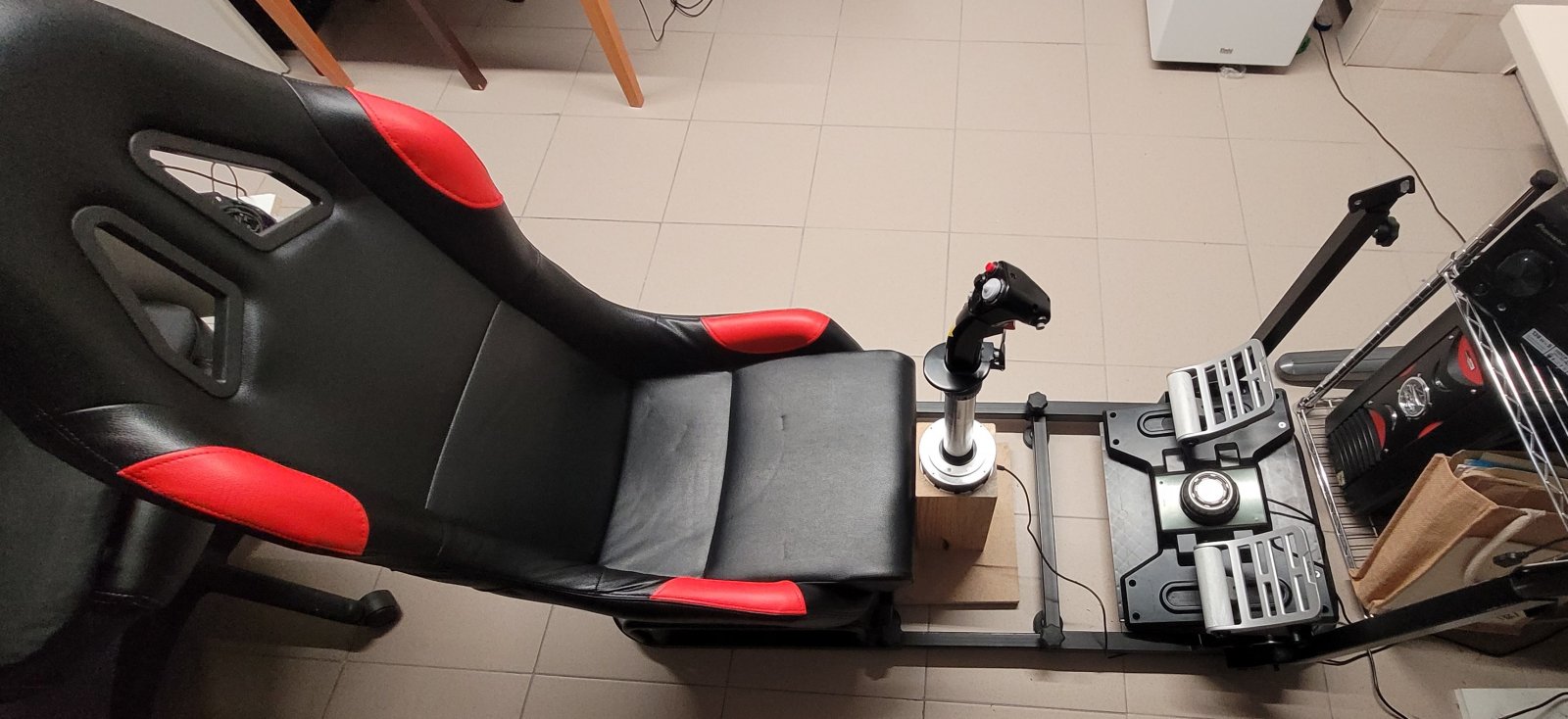

    Finally my son has brought the chair

    now a few pictures of the construction

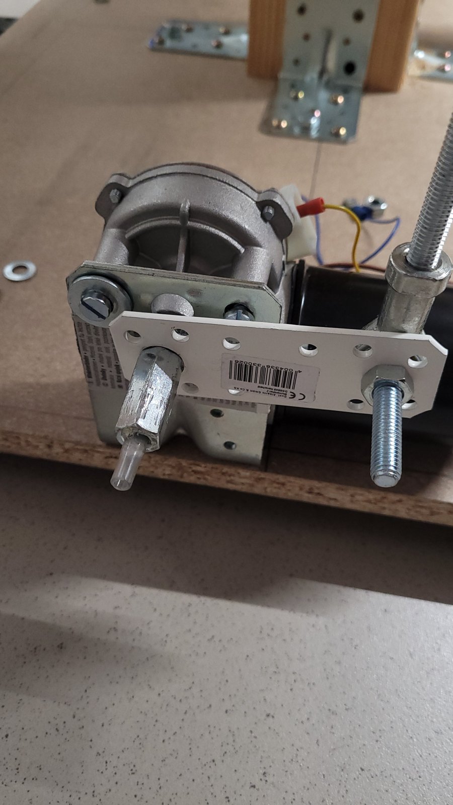

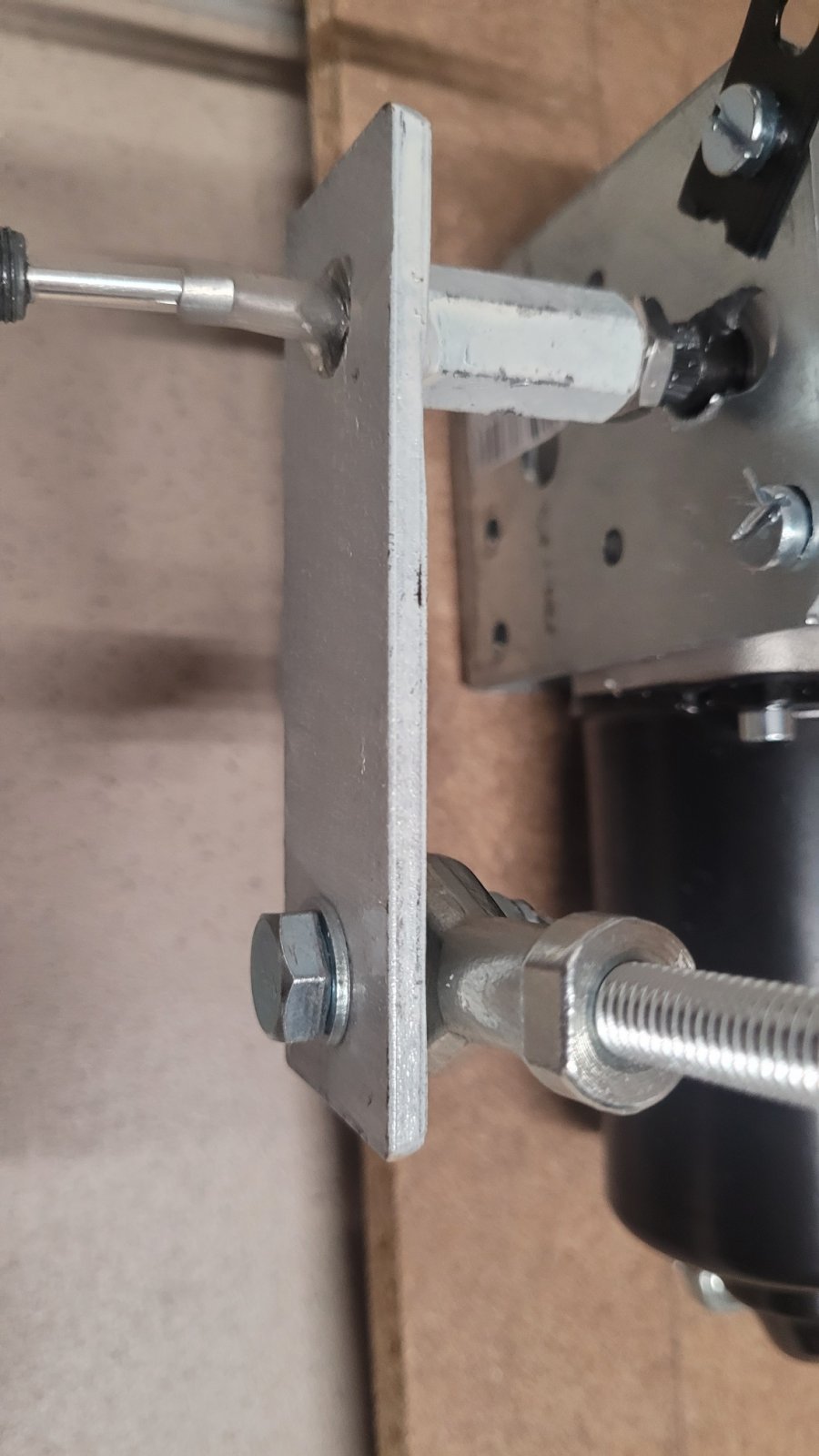

    today i got a jolt during the set up process
    the steel plate on the Wieschermotor slips when it turns
    I have to weld the M8 nut to the plate to get more stability.

    What is the lever CTC distance, you can set a lever up with multiple holes so you have options? Do start at the conservative smaller end (40-50mm CTC) to check what your rig can cope with, without stressing or burning out the motors?
    The levers are also subject to a lot of force, so make sure they are thick enough that the won't flex under extreme loads.

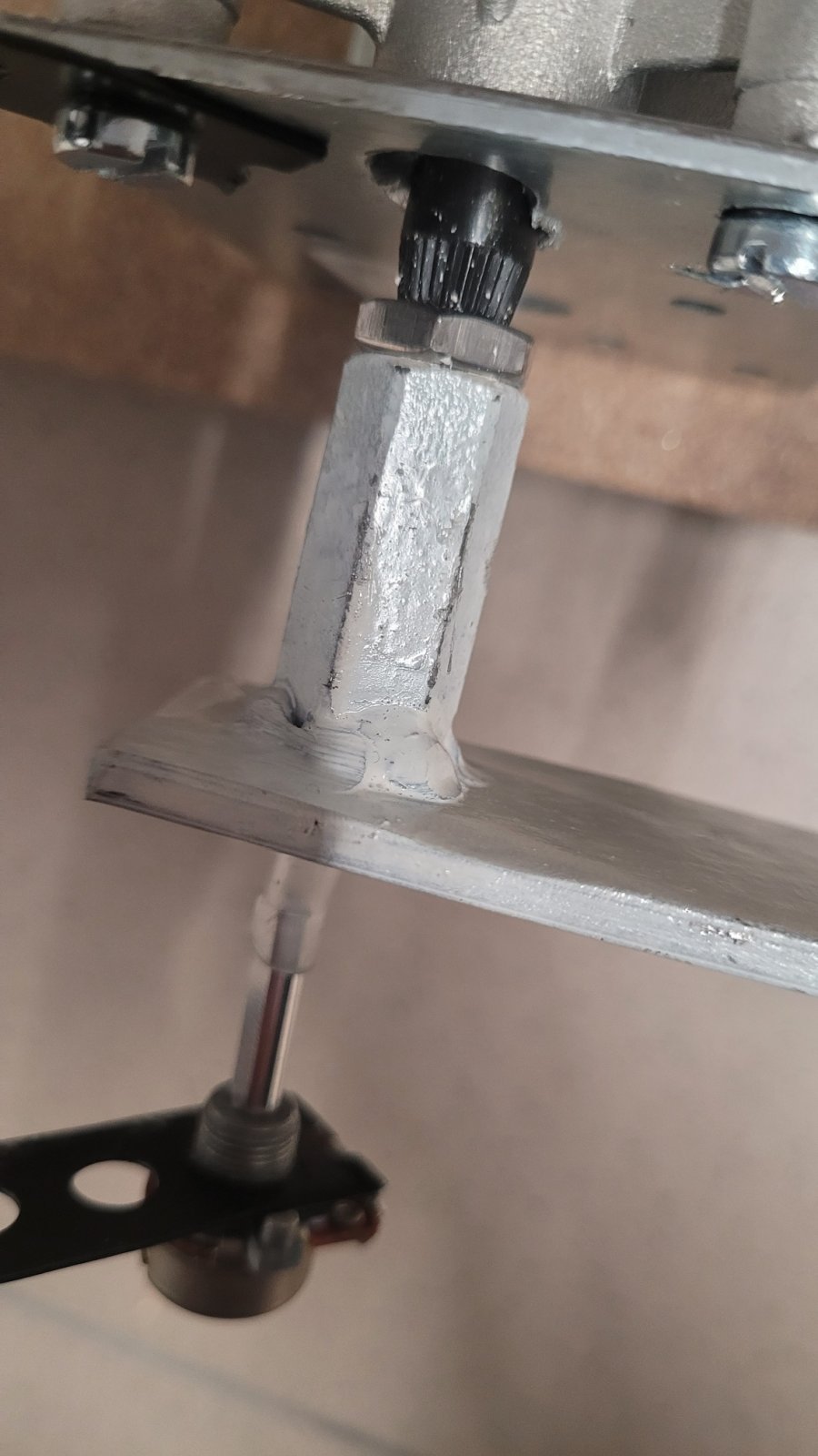

    Hello to all unfortunately from my beginning jolt because of my bracket I had to wait until my friend had time that he builds me a complete new me together
    the bracket is 2 mm thicker than the old one and the M8 nut was welded on it so it can't loosen anymore unfortunately he forgot to drill a 2 hole

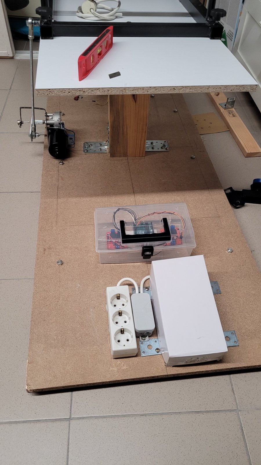

    now i have started to do the wiring and make it as unobtrusive as possible.
    My idea is to run as much cable as possible underneath the plate and lead it out at points.

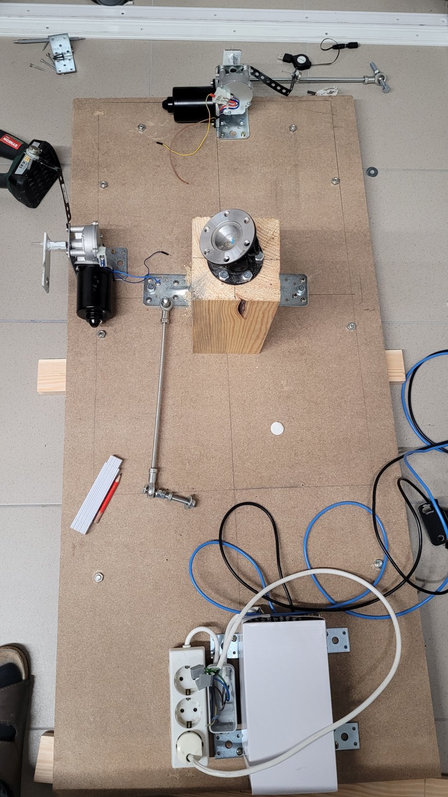

    Unfortunately I have to rethink my project after a trial with my little 10 year old son I found a couple of weak spots.
    The inclination is far too great and the motors do not manage to return to the basic position or do I have to install stronger motors?

    It is hard to get a sense of your actual design, can you please post some pictures showing the full rig and motor placement.
    You also need to consider earlier advice, as it is very pertinent to current challenges: https://www.xsimulator.net/community/threads/il2-sim-on-2-dof.16710/page-4#post-224835

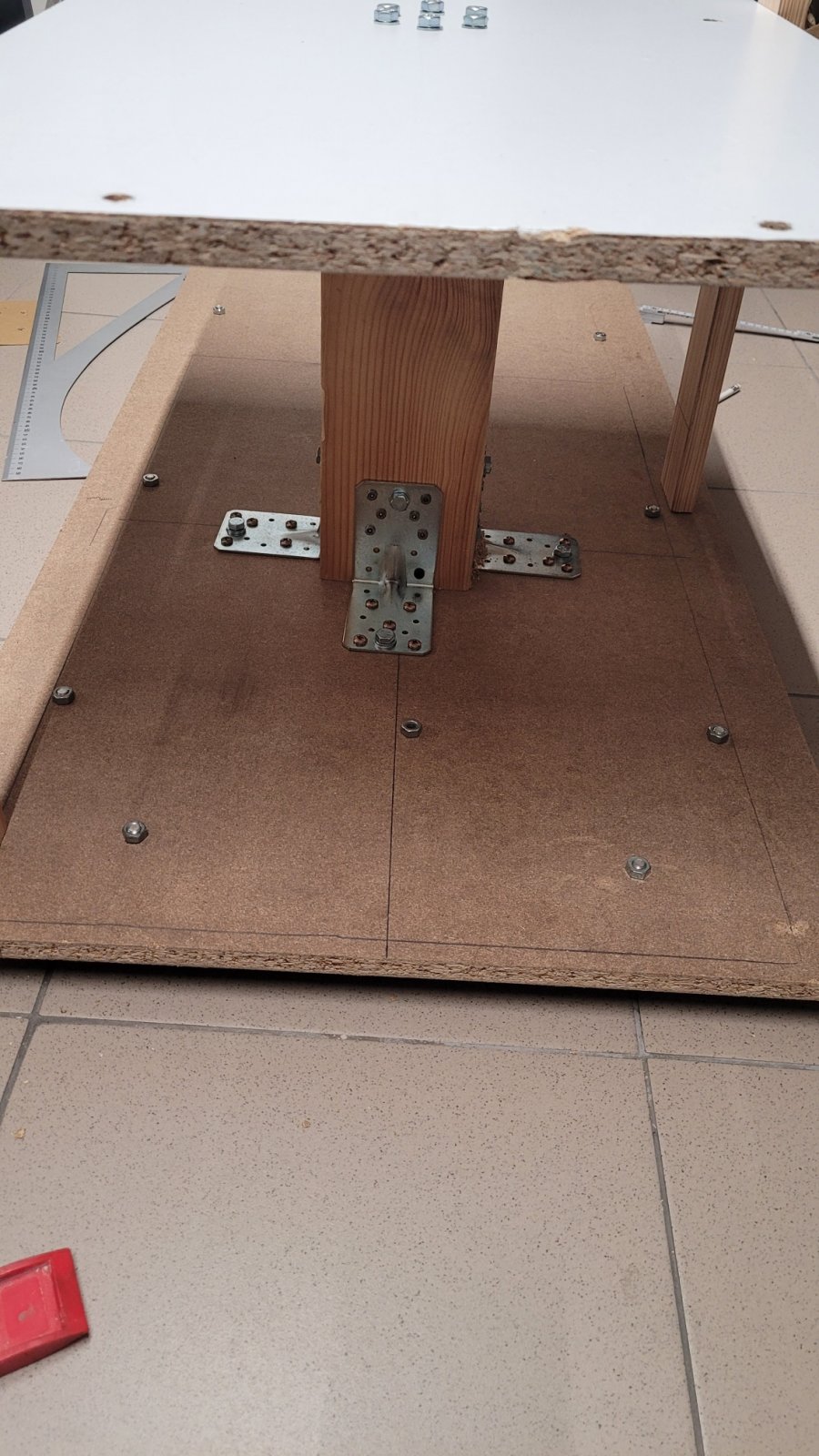

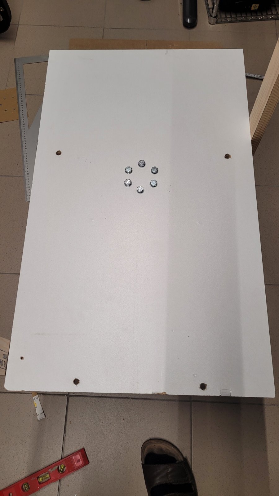

    this is my plate and since i need my sim more for flying
    I have read that if you position the motors like this they are best for movement
