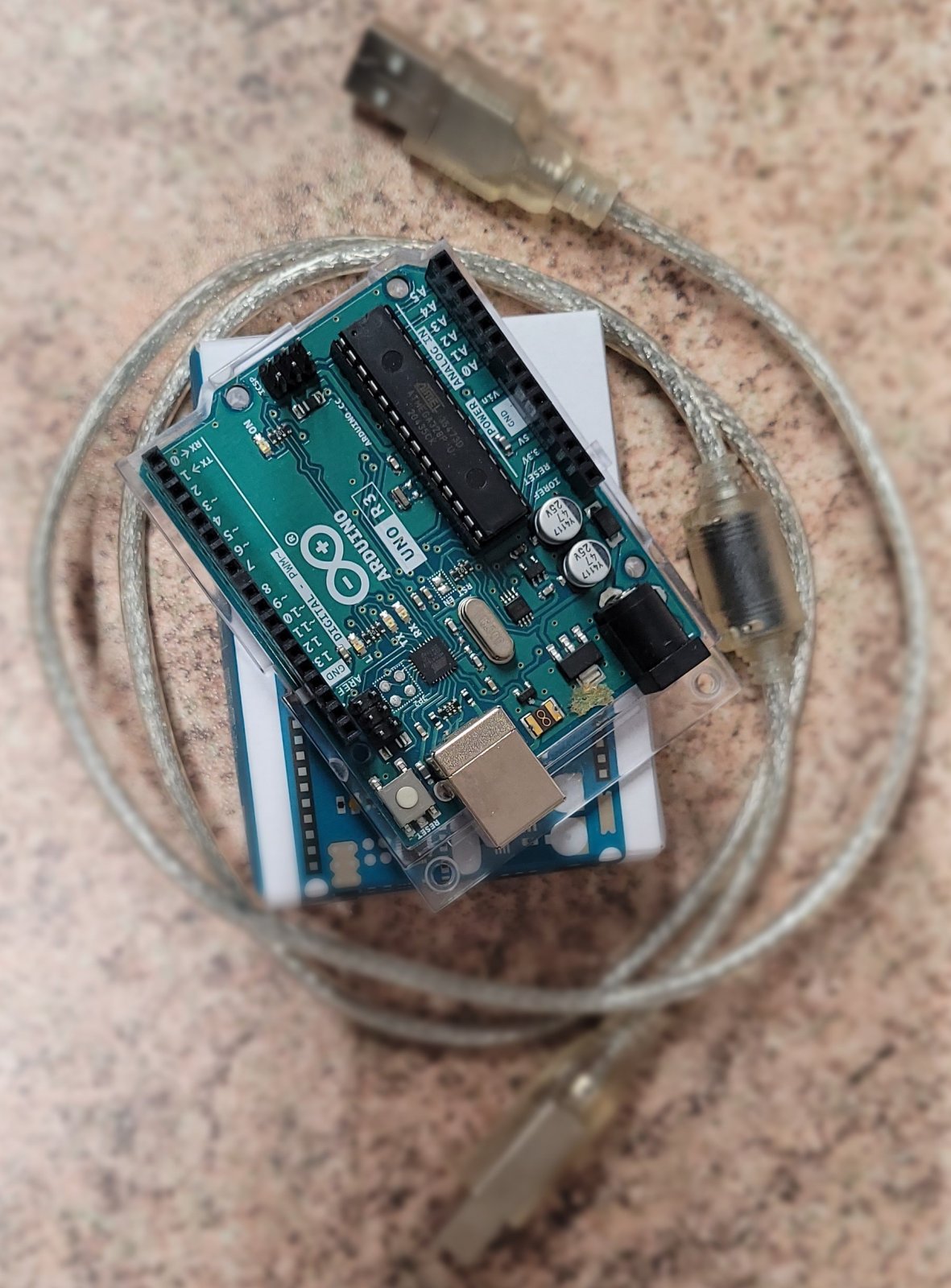

    Yesterday came Arduino uno R3

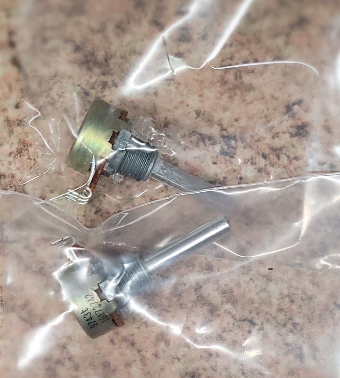

    Yesterday also the ordered potentiometers arrived 10K

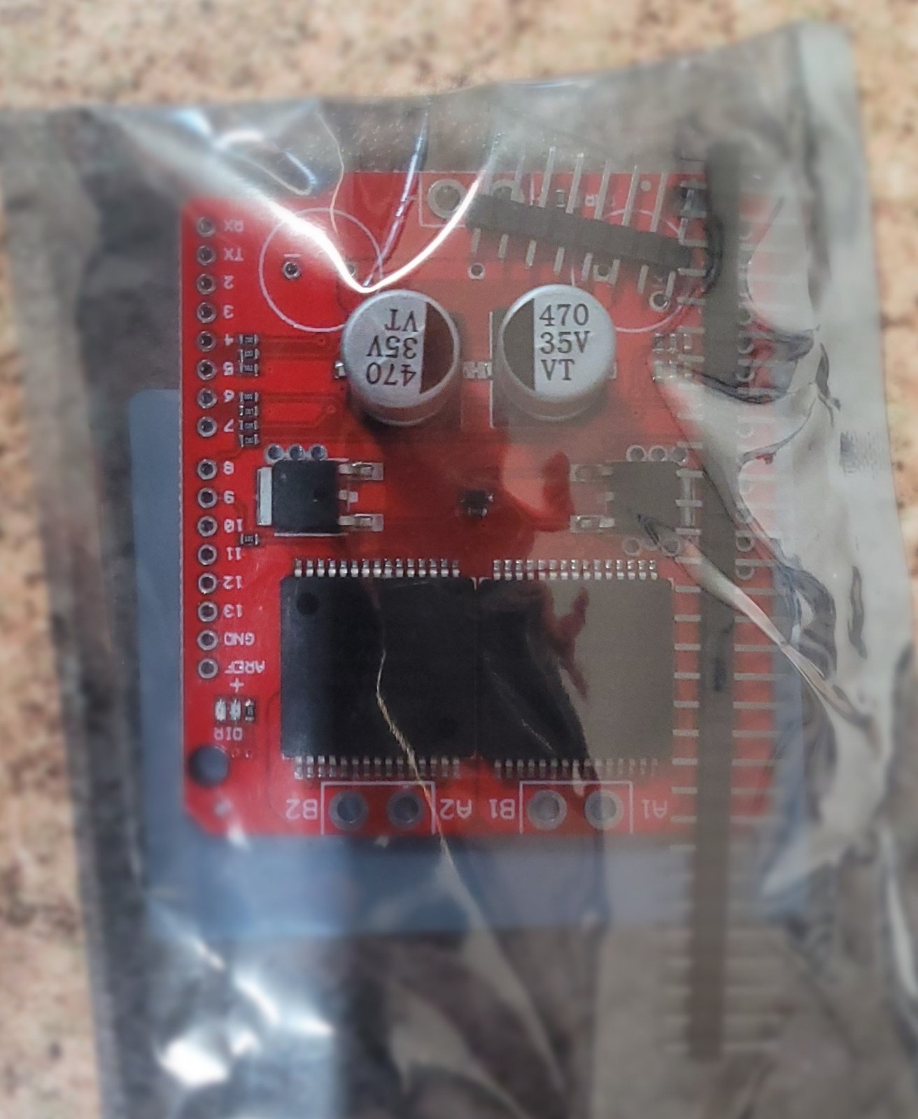

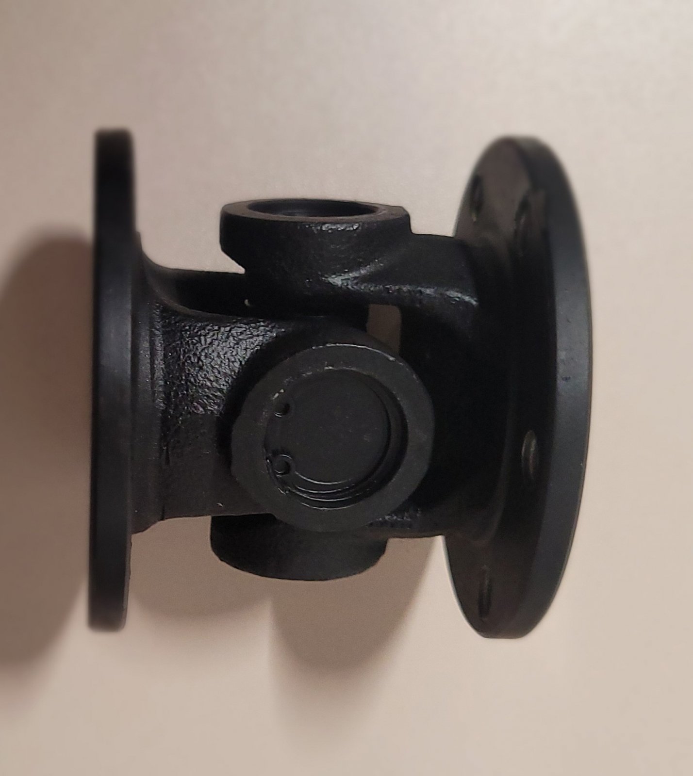

    DHL arrived early and another part arrived, the most expensive part so far and difficult to find the universal joint, and the connecting cables as well as the VNH2SP30 board.

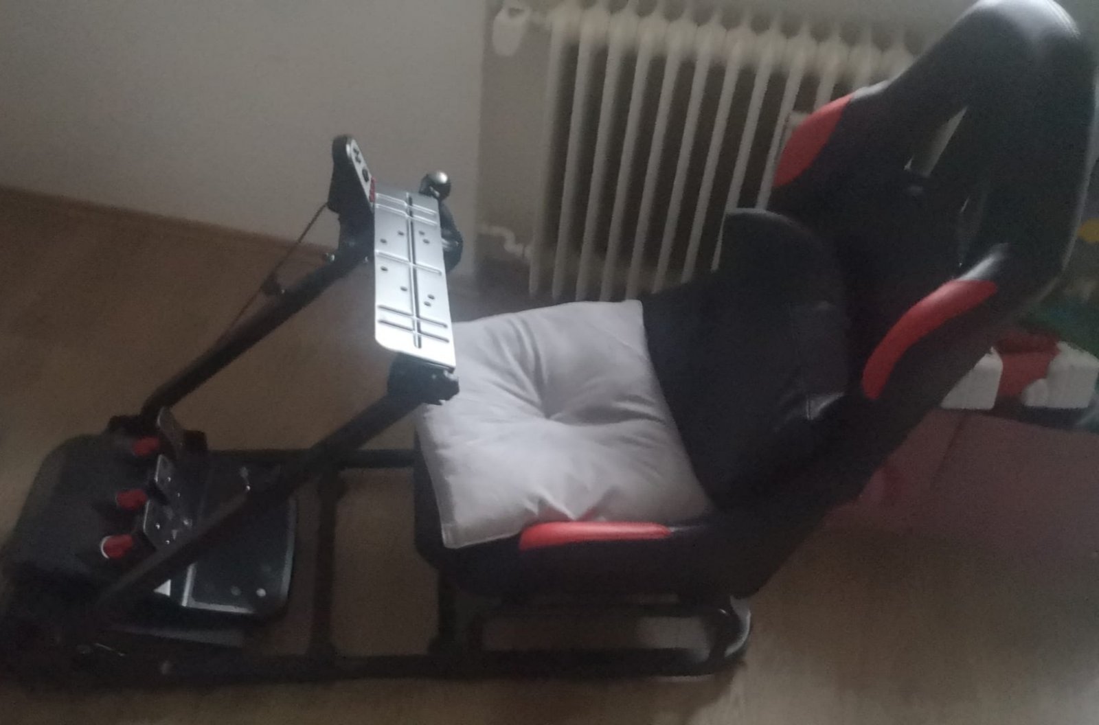

    what an unexpected turn of events, my son gives me his
    gamer chair.
    I accept it with pleasure and a big conversion awaits me to turn it into a flight simulator.

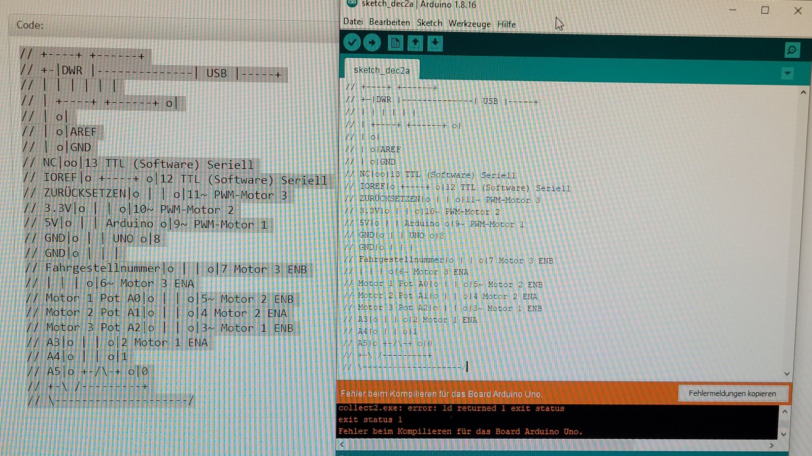

    Help when I transfer code to Arduino I get this error message.
  11. Skuldi
    Skuldi Member Gold Contributor
    Aug 16, 2020
    53
    Germany NRW
    265Coins
    +37 / 0 / -0
  12. xmcnodx
    xmcnodx IL2 Sim with 2Dof
    Sep 7, 2021
    99
    Schmelzer
    Zirndorf Deutschland
    94Coins
    +19 / 0 / -0
    Hello Skuldi thank you I have installed it on Arduino and no error message came, now I can continue, thank you again,

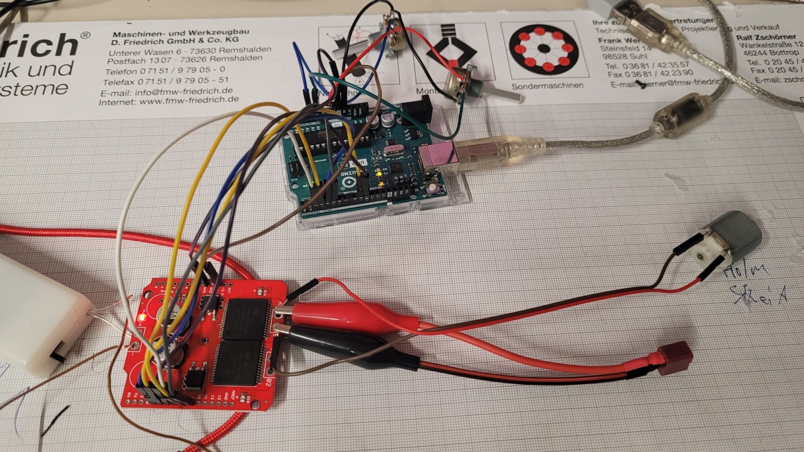

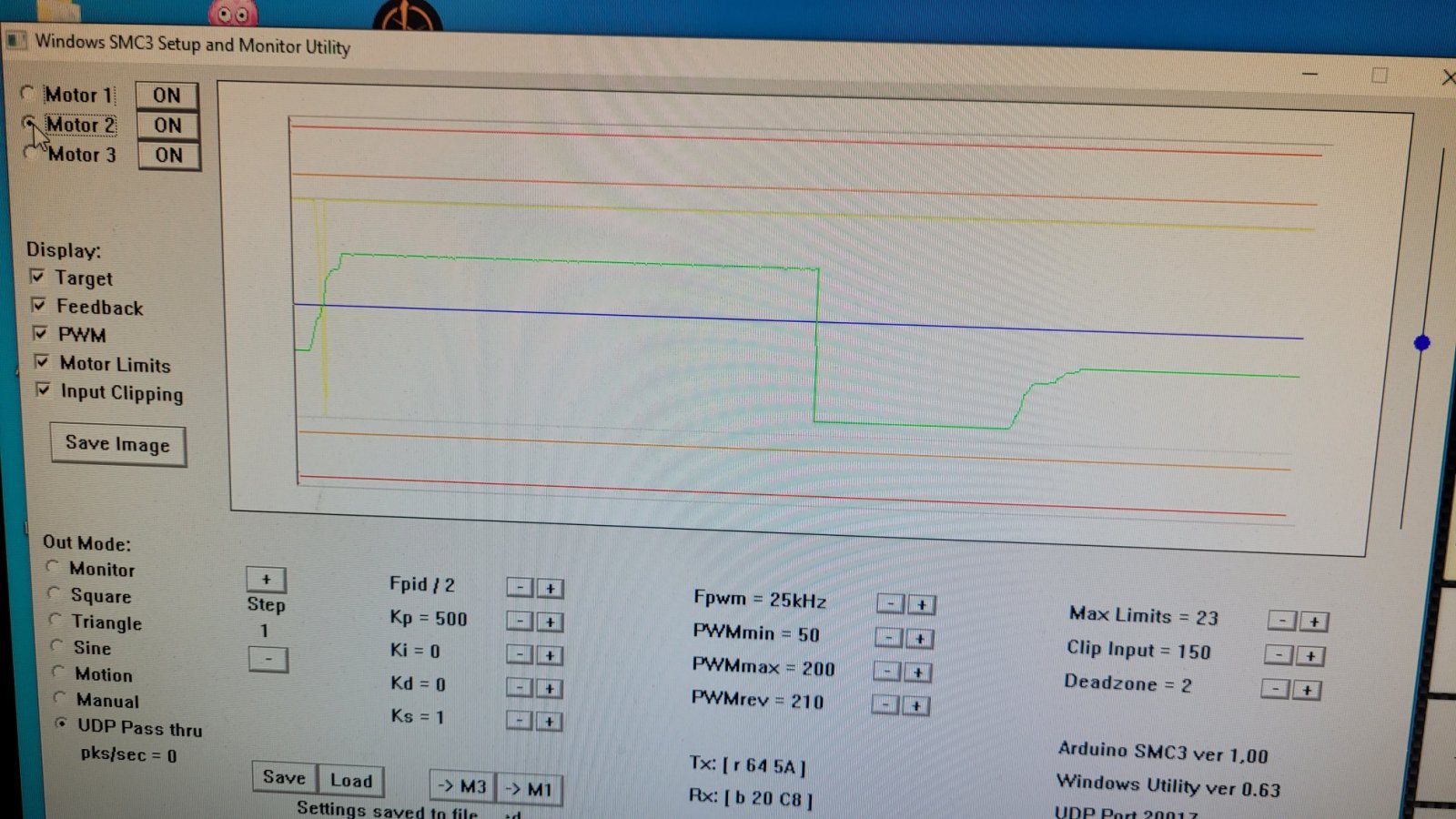

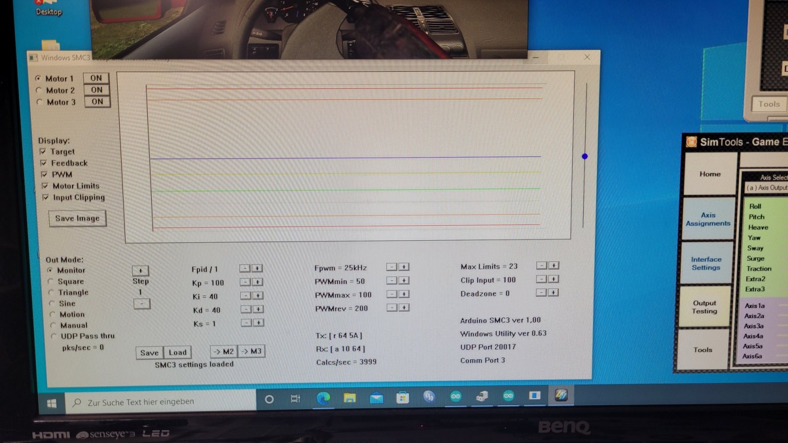

    Today I prepared the displacement to carry out a test, but unfortunately there was no movement on the motor.

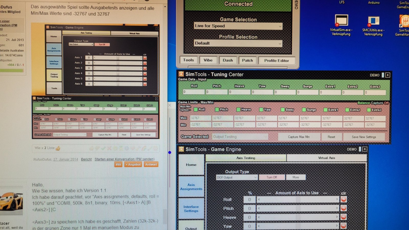

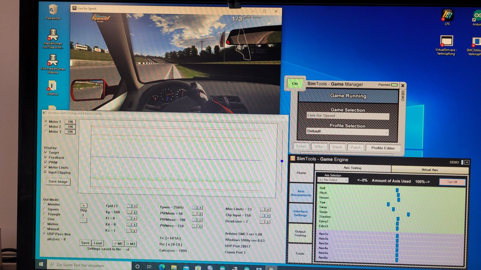

    have taken over all settings from @RufusDufus
    I also noted that Arduino Com3 and SMC3Ut. is also on Com3.

  15. xmcnodx
    Sep 7, 2021
    99
    Schmelzer
    94Coins
    +19 / 0 / -0
    I have applied all the settings as described. What I have noticed is that when I move the potentiometers of motor 1 or 2, the green lines move but the motor does not.

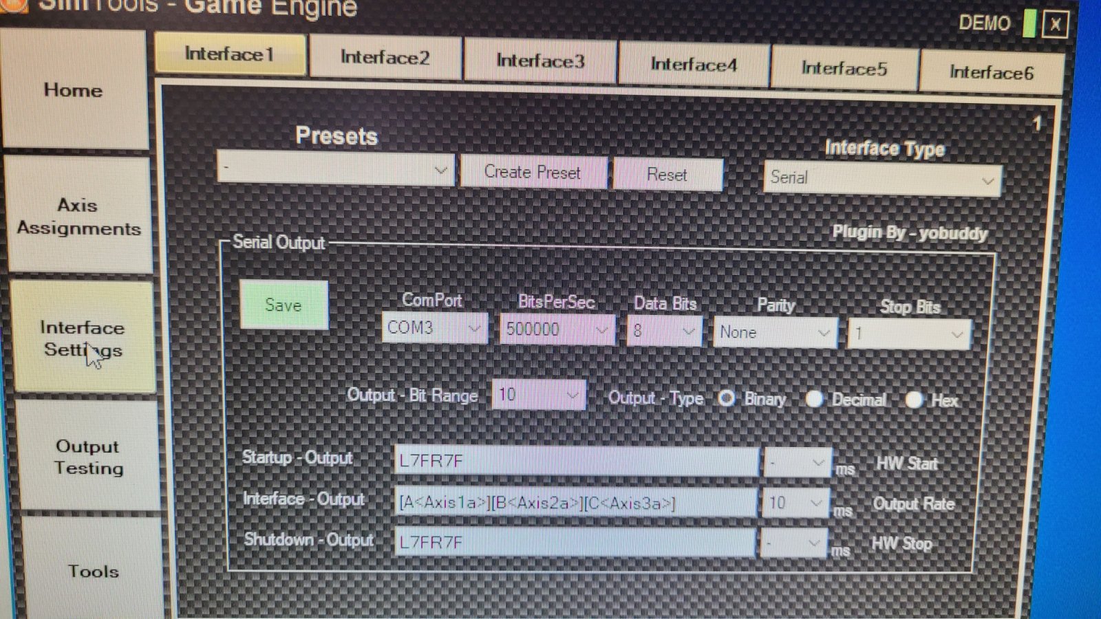

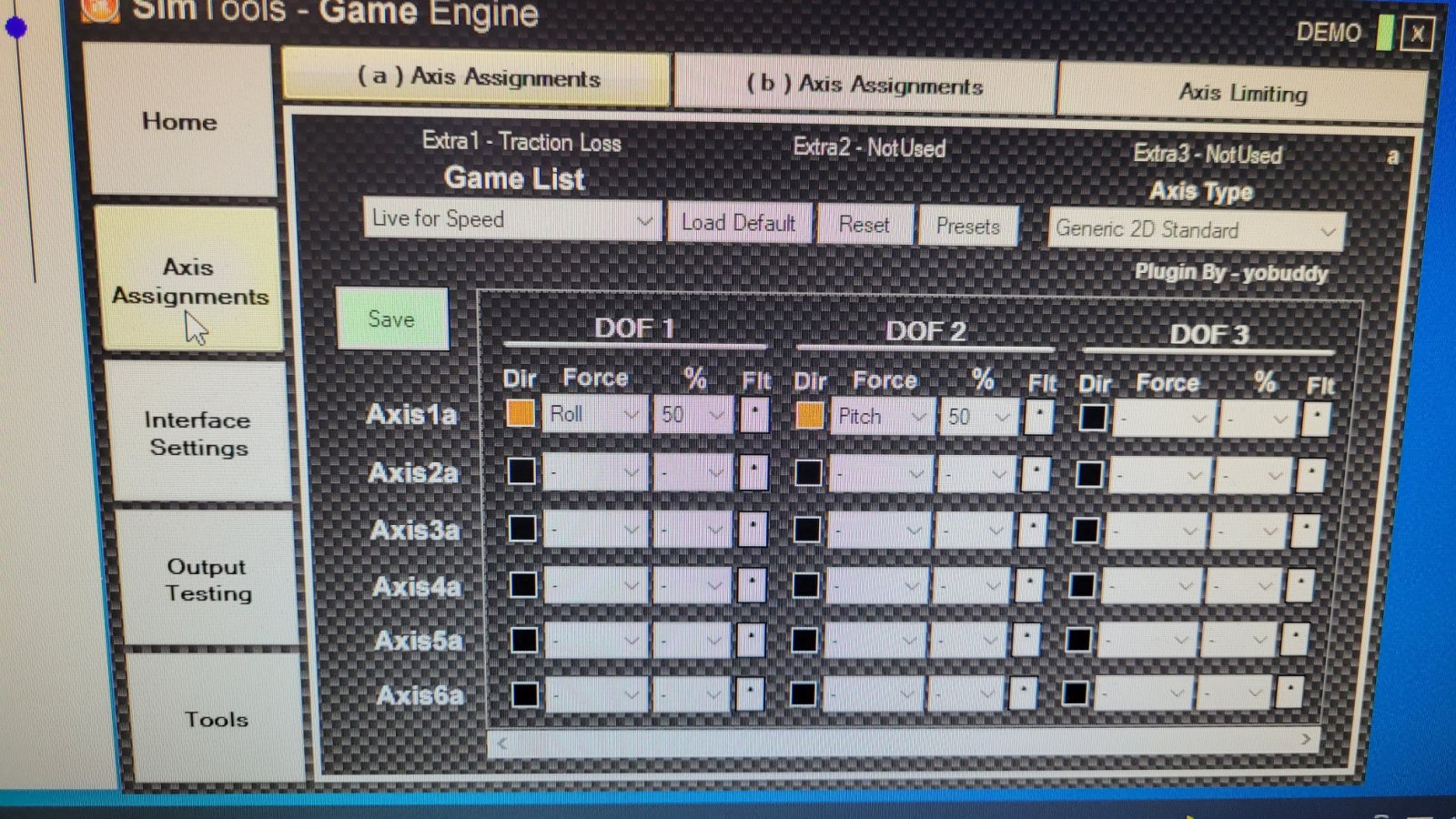

    I add a few pictures of my settings

    Where could my error be that the test engine does not move, of course the engine was checked for function.
    Please help.
  18. Skuldi
    Aug 16, 2020
    53
    Germany NRW
    265Coins
    +37 / 0 / -0
    something between the arduino and the monster shield. the monster shields are cheap and often broken. did you try the other side (B1/B2)? can you test with a multimeter?
    for the future: if you want to use your seat for flying i would suggest FlyPT instead of Simtools.
    Its a little harder to set up but you get some nice features like different profiles for on ground and in air.

  20. noorbeast
    21,597
    151,245Coins
    First test the MM, as @Skuldi notes they are often faulty: https://www.xsimulator.net/community/faq/monster-moto-testing-before-use.158/
    Make sure the pots are connected to the motors, as the pots provide positional feedback.
    Don't just copy settings, follow the SMC3 setup instructions to dial in the settings for your hardware: https://www.xsimulator.net/communit...3dof-motor-driver-and-windows-utilities.4957/
    Don't bother messing with SimTools until SNC3 is fully sorted and working as expected.
