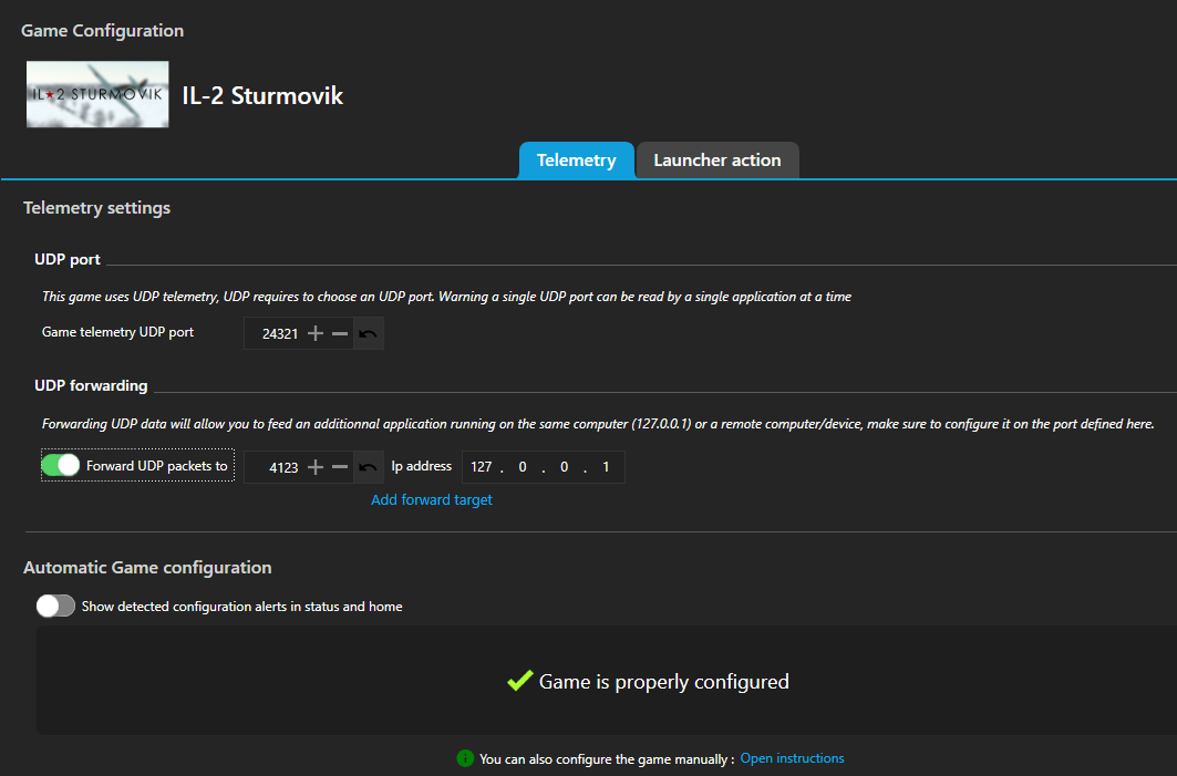

  17. noorbeast
    22,048
    153,884Coins
    +11,154 / 57 / -2
    You need to use the port forwarding functionality, please see the FAQs here:
    https://www.xsimulator.net/community/faq/simhub-port-forwarding.356/

  20. bob williams
    bob williams OSW sfx100
    Apr 18, 2012
    123
    IT
    Ermelo, Netherlands
    113Coins
    +47 / 1 / -0
    Hi so below these are the lines Simtools add to the startup.cfg without setting up simhub. This works fine.
    [KEY = motiondevice]
    addr = "127.0.0.1"
    decimation = 1
    enable = true
    port = 4123
    [END]
    When setting up Simhub these lines change the UDP ports as chosen in the game setup (see screenshot) and puts in extra lines for telemetrydevice:
    [KEY = telemetrydevice]
    addr = "127.0.0.1"
    decimation = 1
    enable = true
    port = 24321
    [END]
    addr = "127.0.0.1"
    decimation = 1
    enable = true
    port = 24321
    [END]
    With the UDP forwarding enabled, Simtools v3 crashes as soon you enter flight in IL2.
