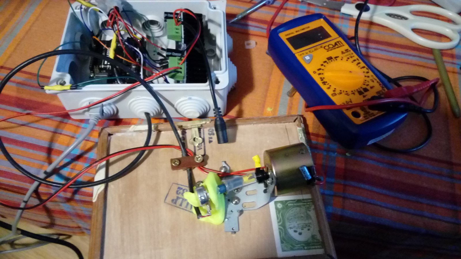

    Thanks! Where is your cooler?

  13. susocalfail39

    I have the fan placed in the lid of that box, but it is not seen in the photo, I made a hole with a crown, and I screwed the fan and put a grid on it.
    When I have more time I will upload another photo, with the box closed,
    those electrical registration boxes are ideal.
