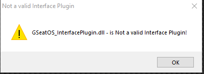

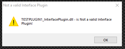

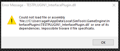

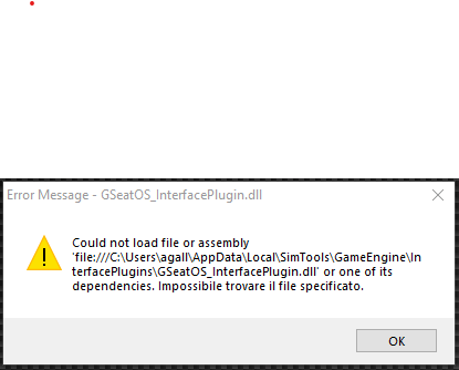

  15. Alessio Galliazzo
    Alessio Galliazzo New Member
    Jan 8, 2021
    5Coins
    Hi guys,
    I'm a developer working on a custom interface. I actually cannot make any "build" interface works properly. PluginValiator tell me that the plugin is a valid plugin but once loaded in game engine it fail to load the plugin telling me that it is invalid and that it cannot find a file. Firstly I was supposing that was due to my developed plugin (I use C#) but the same happen also with the 3 examples in the first post.
    You can see in the attachment the 4 errors:
    - Error 1: My developed plugin in C# - first message error
    - Error 2: My developed plugin in C# - It's saying that it cannot find a dependence or a file
    - Error 3 and 4: Same as before but compiling the NetworkInterface plugin downloaded from here (changing only author and plugin name)
    Anyone can help in some way?
    Running Win10, VS2019 and compiling using .NET Framework 4.0 (as the example)
    Best
    Alessio
  16. yobuddy
    51,770Coins
    +5,206 / 19 / -0
    I can help.
    It's probably just a naming convention problem.
    If you change the plugin name, then you need to change the compiled name.
    I may be wrong, but try taking a look at the bottom of my post where it says
    https://www.xsimulator.net/communit...ugin-for-simtools-2-0-api-documentation.8813/
    I think it may be the problem.
    (btw, this naming step has been removed from v3)
    Chat soon,
  17. Alessio Galliazzo
    Jan 8, 2021
    5Coins
    Of course, that solved the problem... I miss that part... I'm sorry!
    Best
    Alessio

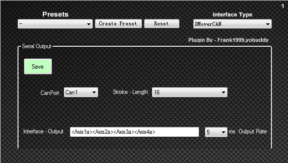

  19. Frank1999
    Frank1999 New Member Gold Contributor
    May 16, 2020
    19
    48Coins
    4DOF
    Hello @yobuddy,
    I have previously re-written a RS485 serial interface plugin using "Serial - Example Interface Plugin" and it works fine. But recently I tried to upgrade my interface hardware to a CANBUS device, I encountered a problem: the rewrite plugin can be installed normally and the new hardware can be started normally, but when I test, simtool will automatically detect the serial port,since the new hardware (CANBUS) is not transmitted through the serial port, the new plugin cannot work .
    It seems that there is no way to fix this inside the plugin, could you please help me with this problem? Or can you provide a new "Example Interface Plugin" for reference, similar to the JRK plugin.
  20. yobuddy
    51,770Coins
    +5,206 / 19 / -0
    I don't understand buddy.
    How does it detect a port if it does not use serial?
    Feel free to PM me and we can discuss a fix to the problem.
