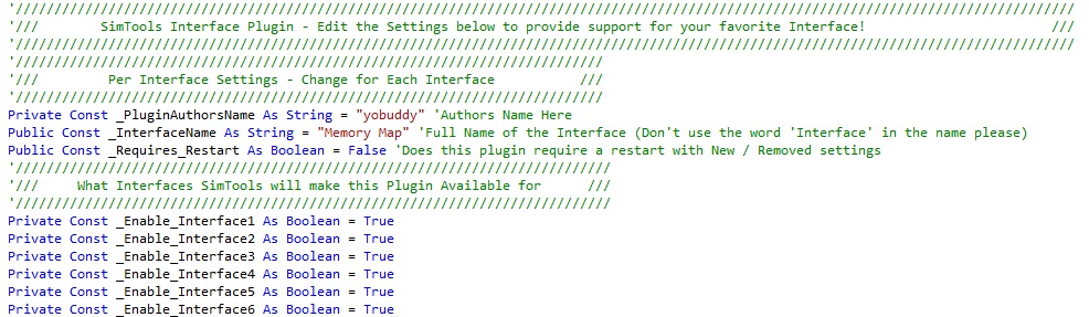

    Step 1) Basic settings for the new Interface Plugin
    _PluginAuthorsName - The name, or names of people that have worked on the plugin.
    If someone sends you a plugin to edit/add-on too, please just add your name with a coma like this “Original Author, Your Name”.
    _InterfaceName – The Name of the Interface (Please don't use the word 'Interface' in the name)
    _Requires_Restart - Does this plugin require a restart with New or Removed settings?
    For example: to run a startup routine on the actuator (with an optical encoder usually) in order to find home.
    What Interfaces are we enabling this plugin for?
    _Enable_Interface1 - Is this plugin enabled for Interface 1 in Game Engine?
    _Enable_Interface2 - Is this plugin enabled for Interface 2 in Game Engine?
    _Enable_Interface3 - Is this plugin enabled for Interface 3 in Game Engine?
    _Enable_Interface4 - Is this plugin enabled for Interface 4 in Game Engine?
    _Enable_Interface5 - Is this plugin enabled for Interface 5 in Game Engine?
    _Enable_Interface6 - Is this plugin enabled for Interface 6 in Game Engine?
    In most cases you can leave these all set to True. But if you find a need, you can tell Game Engine what Interfaces you plugin will be enabled for.

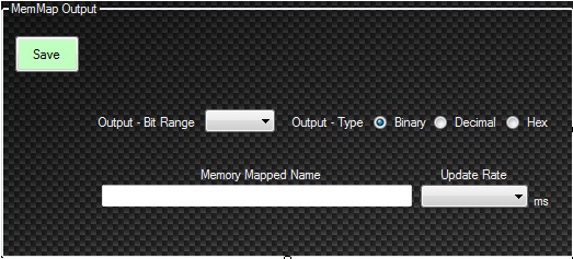

    Step 2) The Form
    A) Double Click on “UserControl_Settings.vb” in solution explorer.
    We are now going to build our form for this Interface Plugin. Place the needed controls on the form for your Interface plugin. (Do not remove the Save Button)
    (Here is a pic of the Example plugins GUI.)

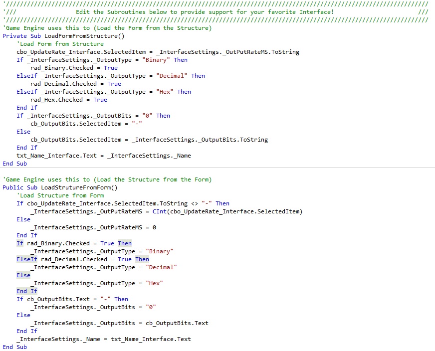

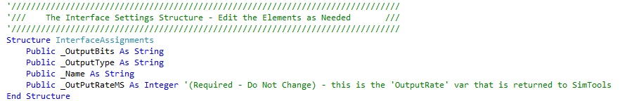

    B) Now let’s setup our Structure for this form. (Double click on “InterfacePlugin.vb” in solution explorer)
    We need to add ‘1’ variable to the structure for each control on the form.
    Notice there are ‘6’ controls on the form, but I’m going to just keep track of the ‘Output – Type’ selected, so I will only need one variable for the 3 radio button controls. So I’m going to need 4 variables in my structure.
    This is what I did.
    C) Now let’s teach the form a few tricks! – (Right Click on “UserControl_Settings.vb” in solution explore and select View Code).
    LoadFormFromStructure()
    Teach the Form how to fill itself from the Structure data.
    (See example plugin for more detail)
    Example
    txt_Name_interface.txt = _InterfaceSettings._Name
    And so on for all controls on the form…
    LoadStrutureFromForm()
    Teach the Structure how to read the Form data.
    (Just the opposite from the sub above) (See example plugin for more detail)
    Example
    _InterfaceSettings._Name = txt_Name_interface.txt
    And so on for all variables in the Structure…

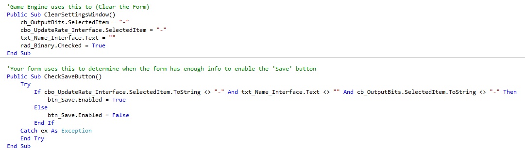

    Clear_AxisAssignments()
    Teach the Form how to reset itself.
    (Resetting the structure is not needed – just the form)
    Example
    txt_Name_interface.txt = “”

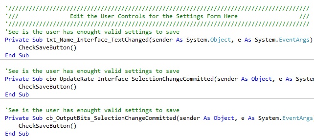

    CheckSaveButton()
    Let’s teach our Interface Plugin how to tell when there is enough data on the form to successfully startup and run our Plugin.
    Since one radio button is always selected, we only need to make sure the other 3 controls contain valid data for saving and running out interface. Here you can see than I am checking that they have valid data for Update Rate, Interface Name and the Output bits. Only when the user selects or enters data for all 3 of these controls can they save there settings.
    Simply call the CheckSaveButton() routine when ever the value changes for all the controls that are used in then CheckSaveButton() routine. (I had 3 in this interface)

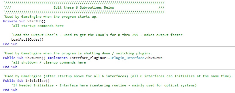

    Step 3) Interface Subs – 6 subroutines / functions to control interface
    StartUp()
    If you need to do anything before you interface plugin can startup, you can do so here. In the example I am loading the Ascii chart into a variable array for faster output when the engine is running.
    ShutDown()
    If you need to do anything when the interface shuts down, you can do so here.
    Initialize()
    If you using optical encoders, or anything that needs to ‘find home’, you can have it do that during the startup of Game Engine here

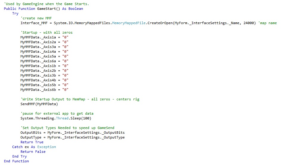

    GameStart()
    The tells game engine what to do when the game starts up. Here I am making sure that all values are set to default values and setting it into a memory space.
    I also load the user’s settings for the engine to run.

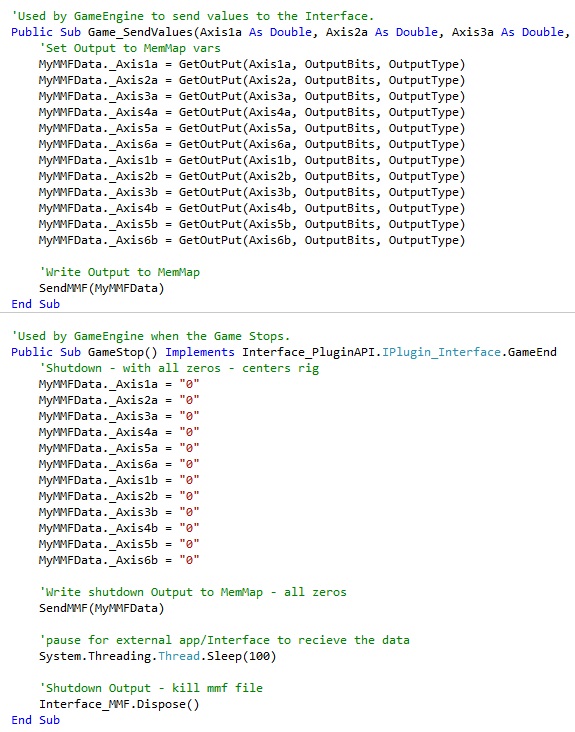

    Game_SendValues()
    Here you get access to the SimTools RAW values. You will receive a number between -1 and 1 (with 0 being the center). This makes scaling the output values to whatever you need very easy! That’s all I’m doing here, re-formatting the RAW output values from Game Engine to the selected output type & bit-range. And then I send the values to the memory mapped file.
    Game Engine automatically throttles the output rate the mandatory _OutputRateMs in the structure you built earlier. We have this values tied to a control on the form. If you didn’t want this to be user editable, you could set the value of the output rate with GameStart() above. (Like this “MyForm._InterfaceSettings._OutPutRateMS = 10”)
    GameStop()
    Here you can teach Game Engine how to shutdown your Interface Plugin. In this example I am an essentially sending a centering command to the interface, waiting to make sure the external device gets the data, and then disposing of the memory mapped file.

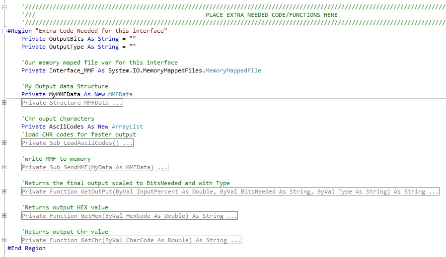

    Place any extra code need that makes this Interface plugin work in this next section. This way if you ever have to work on the plugin again, you know where everything is located at! I simple copy and paste all the extra code I made into here for a little cleanup and the end of the build.
    You do not need to edit sections that look like this:
    Doing so will probably only make things not work as they should

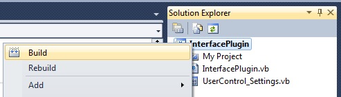

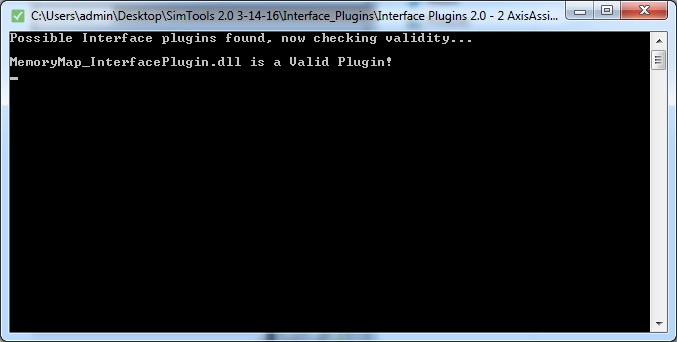

    How to Compile the Plugin

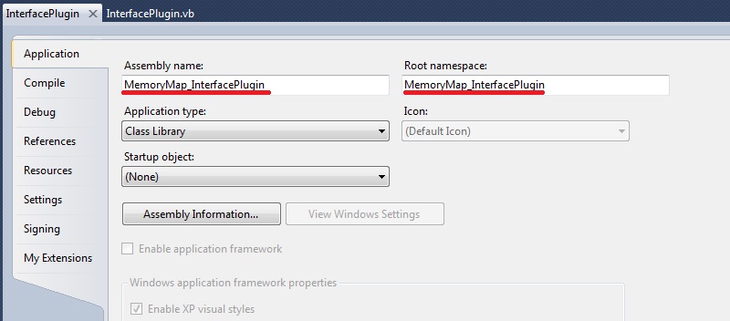

    Double Click on “My Project”
    Make sure the “application” tab is selected. Now name the Interface DLL as follows: InterfaceName (without spaces) + _ InterfacePlugin. So for this example we get ‘MemoryMap_InterfacePlugin. Use this name for both the ‘Assembly Name’ and the ‘Root Namespace’ as in the picture below.
    Right click on InterfacePlugin in the solution explorer and select Build!
    Your new Interface plugin can now be found in the folder;
    ExamplePluginFolder\InterfacePlugin\InterfacePlugin\bin\Release\MyPlugin_InterfacePlugin.dll
    Run ‘PluginValidator.exe’ in the same folder to validate your new plugin.
    Congratulations!!
    Your new Interface Plugin is complete!
