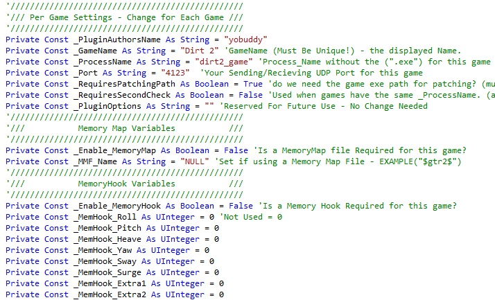

    Section 1) Game Plugin Settings
    This is what you should be looking at: refer to this picture for the settings below.
    Per Game Settings
    _PluginAuthorsName - The name, or names, of people that have worked on the plugin.
    _GameName - This is name displayed in Game Managers list of available games.
    _ProcessName – The name that SimTools looks for in the windows processes list in order to tell if the game has started or stopped. You can have multiple comma delimited exe names if needed. Like this (dirt2_game, drt_fungame), you do not need to add the “.exe” to the name. This name is also not case sensitive.
    _Port – The Port used for sending and receiving information, plugins default to 4123 if the game does not otherwise state a port to use.
    _RequiresPatchingPath – Do we need to make any alterations to the game files? (If False, ValidatePathPath, PatchGame and UnpatchGame never get called, but the game is still marked as Patched.) (Must be True if _RequiresSecondCheck = True). Memory hook games don’t require file patching for example.
    _RequiresSecondCheck – 'Used when games have the same _ProcessName. (All plugins with the same _ProcessName must use this for it to work correctly!)
    _PluginOptions – Reserved for Future Use - No Change Needed

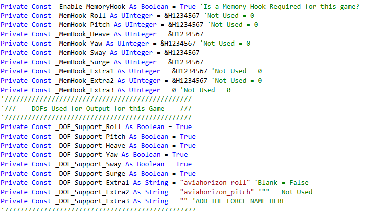

    Memory Map Variables
    _Enable_MemoryMap – if your plugin is a memory map game, set this to true. (See example plugin)
    _MMF_Name - if your plugin is a memory map game, enter the memory map file name here
    Memory Hook Variables
    _Enable_MemoryHook – if it is a memory hook game set to true. (See example plugin)
    _MemoryHook_Roll – if it is a memory hook game; enter the memory location for roll.
    _MemoryHook_Pitch – if it is a memory hook game; enter the memory location for pitch.
    _MemoryHook_Heave – if it is a memory hook game; enter the memory location for heave.
    _MemoryHook_Yaw – if it is a memory hook game; enter the memory location for yaw.
    _MemoryHook_Sway – if it is a memory hook game; enter the memory location for sway.
    _MemoryHook_Surge – if it is a memory hook game; enter the memory location for surge.
    _MemoryHook_Extra1 – if it is a memory hook game; enter the memory location for surge.
    _MemoryHook_Extra2 – if it is a memory hook game; enter the memory location for surge.
    _MemoryHook_Extra3 – if it is a memory hook game; enter the memory location for surge.

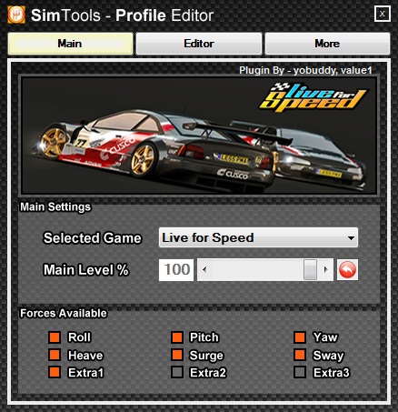

    DOF’s used for this game
    These values are used to control the red dots on the Profiles Page. (See pic below).
    They tell the user what DOF outputs are supported by the plugin.
    _DOF_Supported_Roll – set to true or false accordingly.
    _DOF_Supported_Pitch – set to true or false accordingly.
    _DOF_Supported_Heave – set to true or false accordingly.
    _DOF_Supported_Yaw – set to true or false accordingly.
    _DOF_Supported_Sway – set to true or false accordingly.
    _DOF_Supported_Surge – set to true or false accordingly.
    _DOF_Supported_Extra1 – “Traction Loss" Add a Force name here to set it to true.
    _DOF_Supported_Extra2 – "" Not Used set to blank.
    _DOF_Supported_Extra3 – "" Blank equals False.

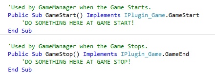

    Game Start and Game Stop
    If your game plugin requires any extra commands to start or stop the collection of data, it can be entered here.

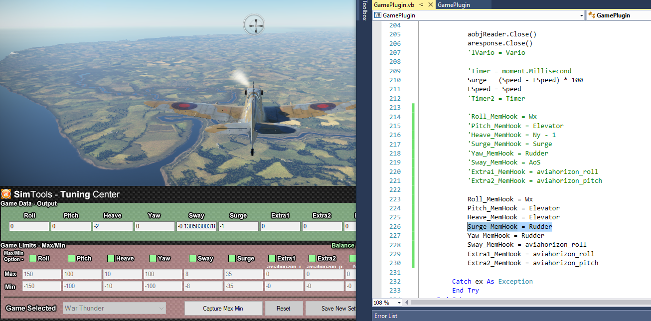

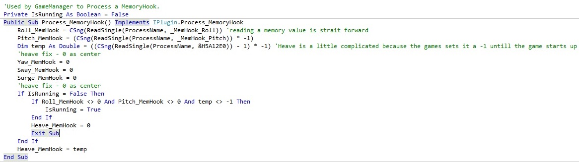

    Process a Memory Hook
    Place your end results in the output variables, Roll_MemHook, Pitch_MemHook, Etc...
    NoLimitsCoasters – Example shown - Roll, Pitch etc... Memory readings are strait forward.
    No need to alter the Process_PacketsReceived subroutine when using a memory hooked game.

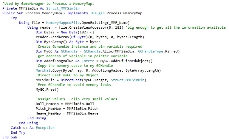

    Process a Memory Map
    Place your end results in the output variables, Roll_MemMap, Pitch_MemMap, Etc...
    GTR2 – Example Plugin - The data structure is copied from memory and then outputs are assigned to the MemMap variables.
    No need to alter the Process_PacketsReceived subroutine when using a memory mapped game.

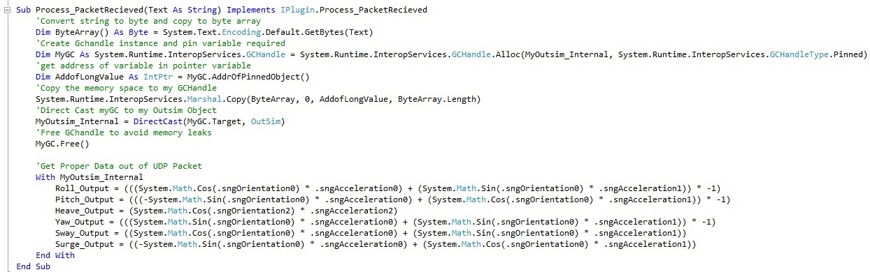

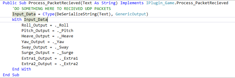

    Process the Packets Received

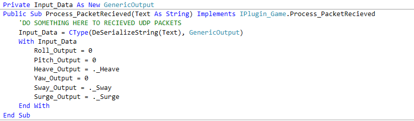

    Decipher the incoming UDP packets from the Game or Game Manager into Game Engine. The following is an example of deciphering the outsim udp packet captured directly from the game. See the Live for Speed example plugin for more info. Simply place the end results in the output variables, Roll_Output, Pitch_Output, etc... (There is no need to alter this subroutine if you are using a memory mapped or memory hooked game) (Used by GameEngine)

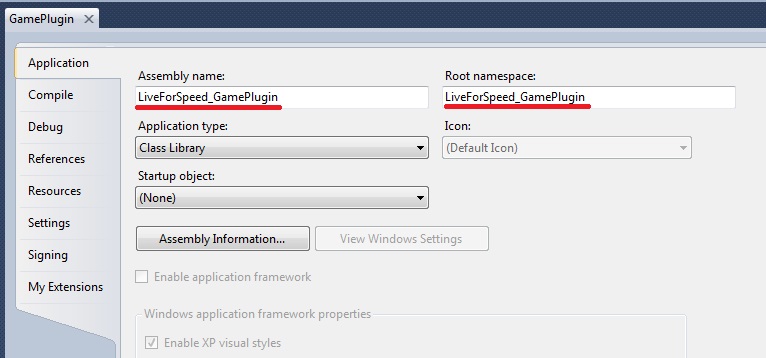

    Make sure the “application” tab is selected. Now name the Game Plugin DLL as follows: GameName (without spaces) + _GamePlugin.
    So for this example we get ‘LiveForSpeed_GamePlugin’. Use this name for both the ‘Assembly Name’ and the ‘Root Namespace’ as in the picture below

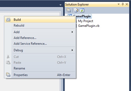

    Right click on GamePlugin in the solution explorer and select Build!
    Your new Game plugin can now be found in the folder;
    ExamplePluginFolder\ GamePlugin\GamePlugin\bin\Release\MyPlugin_GamePlugin.dll

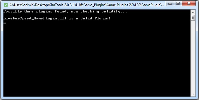

    Run ‘PluginValidator.exe’ in the same folder to validate your new plugin.
    Congratulations!!
    Your new Game Plugin is complete!
    Now install it into SimTools 2.0 and test out your work!

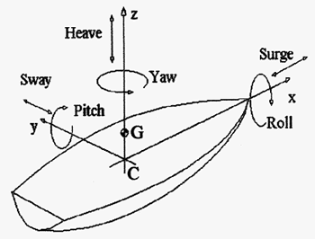

    Nomenclature of movements in SimTools
    Pitch is the tilt of the car forwards or backwards in [°]
    Roll is how much the car is dipped to the left or right in [°]
    Yaw is the heading of the car (north, east, south, west) in [°]
    Surge means the acceleration of the car in longitudinal direction [g]
    Sway means the acceleration of the car in lateral direction [g]
    Heave means the acceleration up and down [g]

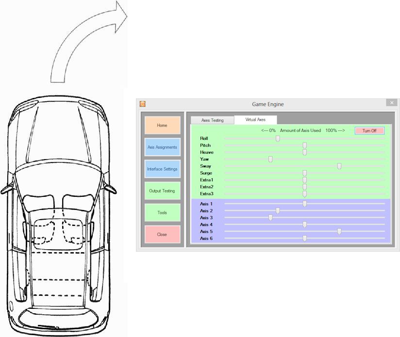

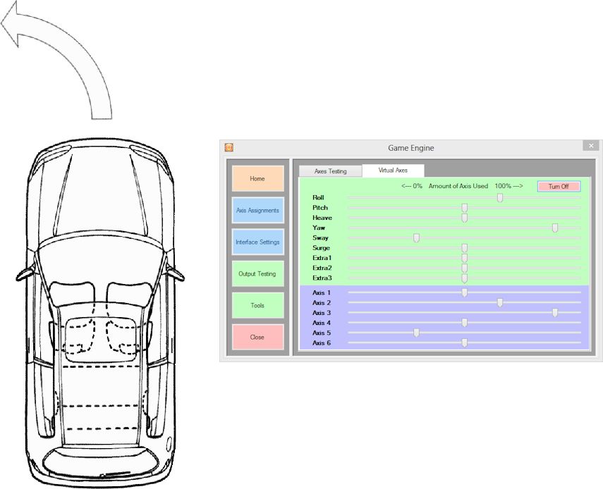

    Direction of movements in SimTools
    Acceleration → pitch slider moves to left, surge slider moves to right
    Deceleration (braking) → pitch slider moves to right, surge slider moves to left
    Right turn → roll slider moves to left, sway slider moves to right, yaw slider moves to left
    Left turn → roll slider moves to right, sway slider moves to left, yaw slider moves to right

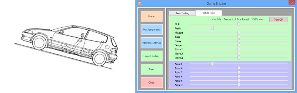

    Driving downhill → pitch slider moves to right

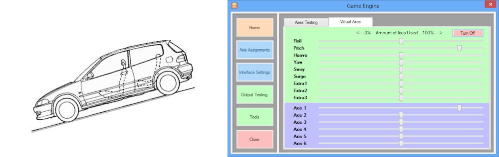

    Driving uphill → pitch slider moves to left

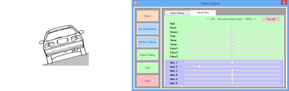

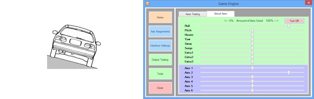

    Tilted to the left → roll slider moves to left
    Tilted to the right → roll slider moves to right

    I am having some problems writing a plugin for War Thunder. I am using the Example 3 for memory hooks as a basis for the plugin.
    I only get motion data out to Simtools in the Public Sub Process_MemoryHook() by assigning values to these:
    Heave_MemHook
    Surge_MemHook
    Sway_MemHook
    When I add values to the other variables (Roll_MemHook,Pitch_MemHook,Yaw_MemHook,Extra1/2_MemHook), they output 0 to the Simtools.
    I've enabled the DOFS in the beginning of the plugin code:
    the memory locations are not valid as the plugin gets the values via TCP from the game.
    I've tried to put the values that I use for Roll/Pitch/Yaw/extra1/extra2 through the Heave, Surge and Sway Memhook variables and they work.
    Here's an example of the problem. I assign variable "Elevator" to the Pitch_Memhook and Heave_Memhook and Tuning manager only shows the value in Heave, not in pitch. The same problem happens with Surge_Memhook and Yaw_Memhook with the variable Rudder. and then with Sway_Memhook/Extra1_Memhook with the variable aviahorizon_roll
    EDIT:
    got it to work... the problem was in the Public Sub Process_PacketRecieved
    It had some 0 in it so I fixed it. Took me a while to find the problem.
    Public Sub Process_PacketRecieved(Text As String) Implements IPlugin_Game.Process_PacketRecieved
    'DO SOMETHING HERE TO RECIEVED UDP PACKETS
    Input_Data = CType(DeSerializeString(Text), GenericOutput)
    With Input_Data
    Roll_Output = 0
    Pitch_Output = ._Pitch
    Heave_Output = ._Heave
    Yaw_Output = ._Yaw
    Sway_Output = ._Sway
    Surge_Output = ._Surge
    Extra1_Output = ._Extra1
    Extra2_Output = ._Extra2
    End With
    End Sub
  17. yobuddy
    5,411
    50,723Coins
    +5,168 / 19 / -0
    @Ville Pesonen,
    Is this error in the example itself buddy?
    I'd like to update it if it is.
    Also as we go along, if there is anything I need to add to any of the examples to make them easier, let me know guys.
  18. Ville Pesonen
    Ville Pesonen Active Member
    Jan 13, 2015
    136
    855Coins
    +200 / 0 / -0
    I just checked and the error is in the example plugin itslef:
    It started to work when I modified it to look like this:
  19. value1
    Jan 9, 2011
    2,184
    Zug, Switzerland
    14,992Coins
    +3,335 / 11 / -1
    Sorry, but this is not an error in the plugin. If you read the source code of the plugin carefully, NoLimits V1.8 only provides surge, sway and heave. Therefore the other values must be 0.
    In your case – where you also provide other data – you must indeed add these values in the subroutine!
  20. noorbeast
    21,611
    151,323Coins
    +11,034 / 56 / -2
    Is SimTools in demo mode...it has to be licensed to load plugins other than LFS.
