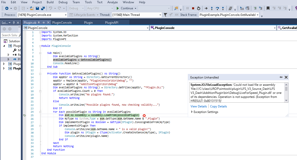

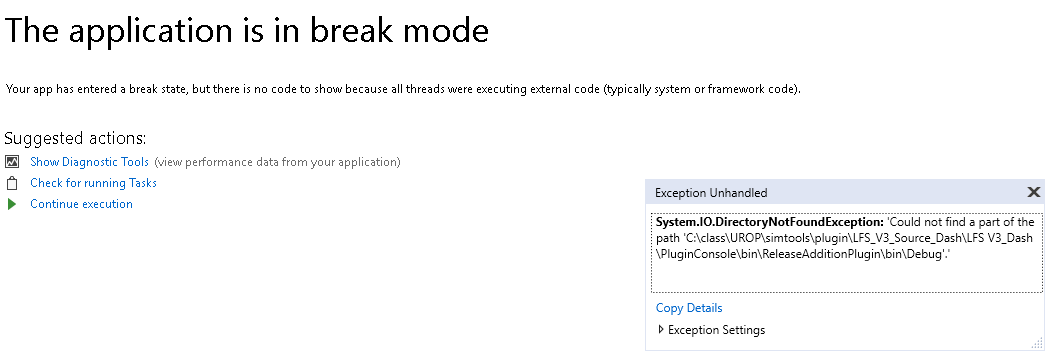

    Hello @yobuddy ,
    Thank you so much for the tutorial. I downloaded then compile the source code you provided for LFS just to see how it works. However, I am not able to compile the program because of the path error. I try both debug and release mode, but both of them don't work. Could you tell me what's wrong?
    Thanks!
  5. yobuddy
    51,660Coins
    +5,204 / 19 / -0
    @Andrew Li,
    First buddy, your using the old outdated version, you can get the new version here.
    https://www.xsimulator.net/communit...ugin-for-simtools-2-0-api-documentation.9107/
    All of the info you need to build a plugin is available on this page.
    Please note, that building a plugin loader is against the EULA.
    (So it was not meant to be easy to implement as the SimTools API's are for use only with SimTools.)
    The plugin you compiled thou will work with SimTools v1.

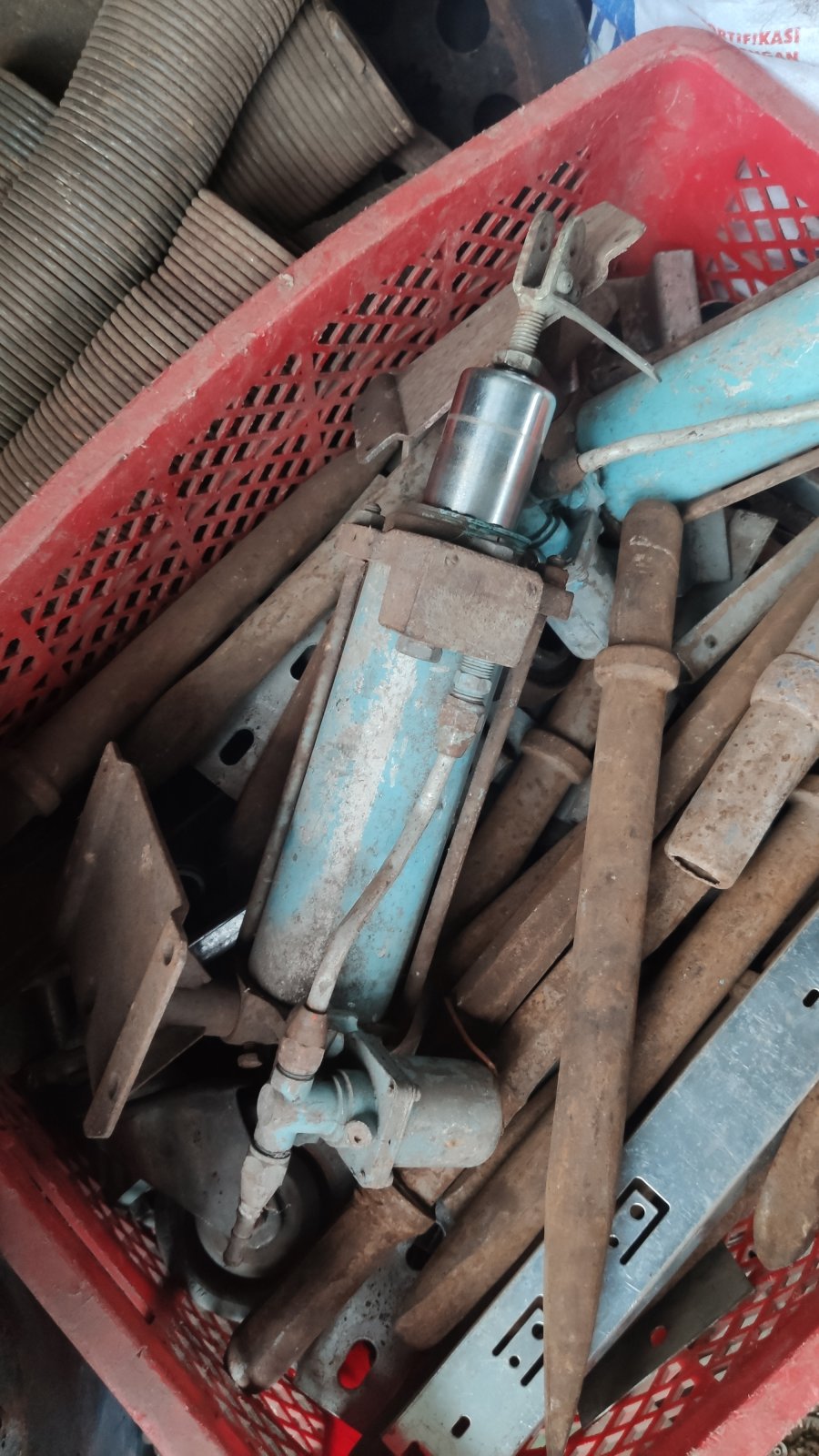

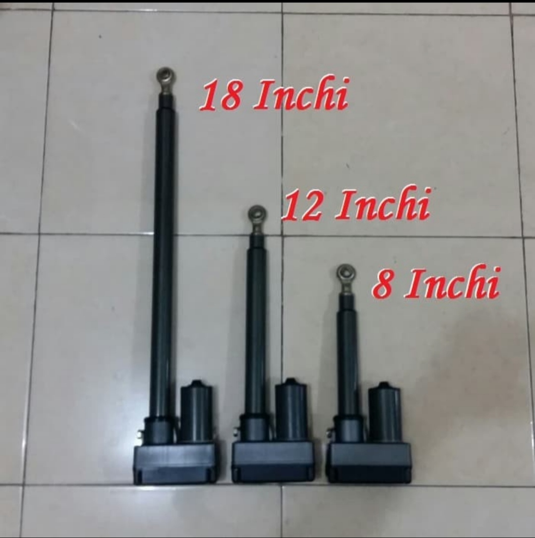

    I am going to start making 2 dof, I am still confused about the driving motor, whether I recommend using a motor wiper, or the actuactor as drawn (the actuactor belongs to a parabolic, maybe someone has tried it). or with a pneumatic like the picture, I happen to find a used one, but I want to build 2 dof with little cost. please correct and suggest
