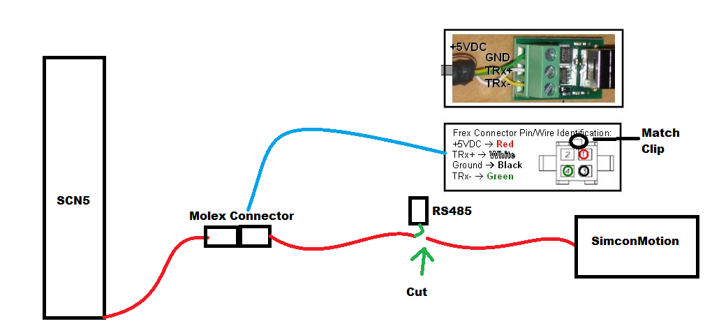

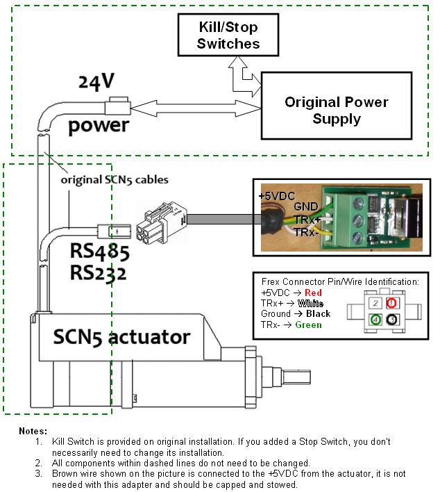

  17. Mif
    Mif Member
    Oct 18, 2011
    30
    Seattle, WA USA
    - 8Coins
    +21 / 0 / -0
    2DOF, SCN5
    Use the diagram on the first post. I have included it again here for reference. SCN5_X-Sim2_Diagram.JPG
  18. Mif
    Mif Member
    Oct 18, 2011
    30
    Seattle, WA USA
    - 8Coins
    +21 / 0 / -0
    2DOF, SCN5
    I do not understand unfortunately. Can you take a photo of your connections? I may be able to help.
  19. Mif
    Mif Member
    Oct 18, 2011
    30
    Seattle, WA USA
    - 8Coins
    +21 / 0 / -0
    2DOF, SCN5
    You should not have to modify the connector, use the other end that would usually go to the Simcon Motion box. You have to cut the wire, then strip and connect to the rs485 connector using the diagram. the Molex connector will still connect to the SCN5. Your colors may be different, just make sure it matches. I had a photo but I deleted it from my phone and my connector is buried inside my simulator.
  20. Mif
    Mif Member
    Oct 18, 2011
    30
    Seattle, WA USA
    - 8Coins
    +21 / 0 / -0
    2DOF, SCN5
