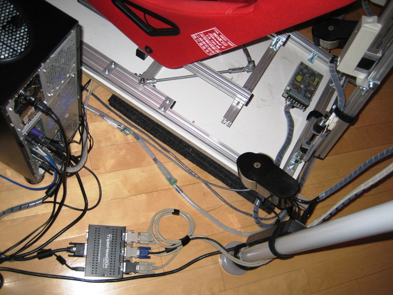

    I decided to write down this quick howto to show other users how simple and fast it is to convert your simulator and take advantage on all amazing and powerful features of SimTools software. Not to mention the great support and friendship this community offers.
    Conversion overview:
    As most of the people know, Frex SimConMotion are build around Dyadic SCN5 100mm actuators. Although you see a Frex sticker over the original manufacturer label, Frex does not manufacture them. These actuators require power DC +24V+/-10% (Max. 2A Amps) and proper control through a RS485 port.
    The control can be made by SimTool software if you have a compatible USB <-> RS485 adapter.

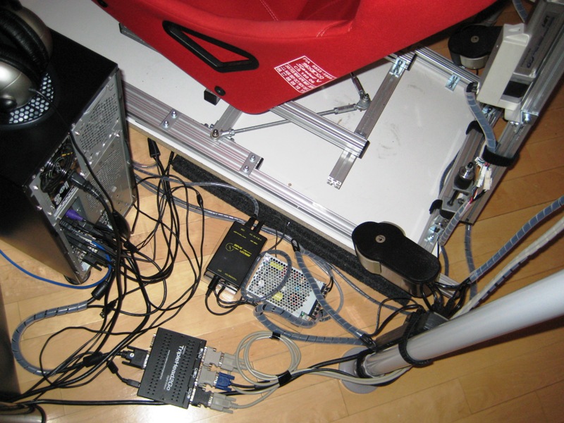

    Given that, you simply need to replace the SimConBase and the Actuator Controller Box (I will call by this name) by a USB <-> RS485 converter. You will still save and use your already installed Power Supply, Emergency and Stop Switches.
    Pictures showing cables configuration before and after the conversion (it even cleaned up some of the cables cluttering)! :thbup:

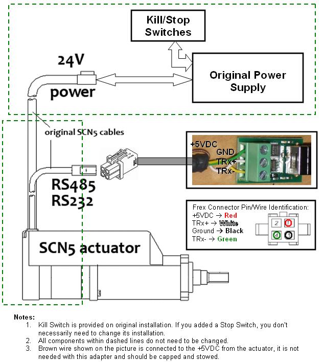

    3. Build two cables to connect the actuators to your USB <-> RS485 adapters (see diagram attached).
    Note: You can use cut the cables from the Frex Actuator Controller Box, but in the future if you want to reverse your conversion (not likely to happen), you will have to fix it back.
    In my case I was helped by Egoexpress who assembled some of these cable. He provided two cable to me.

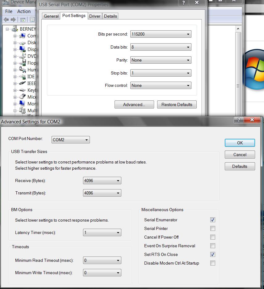

    5. Configure your COM ports:

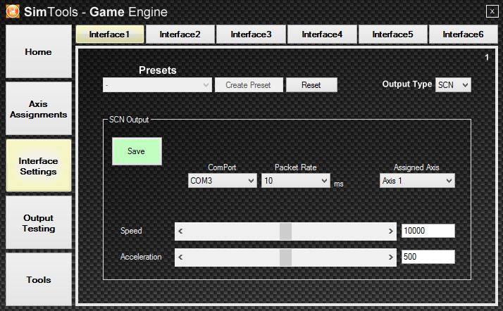

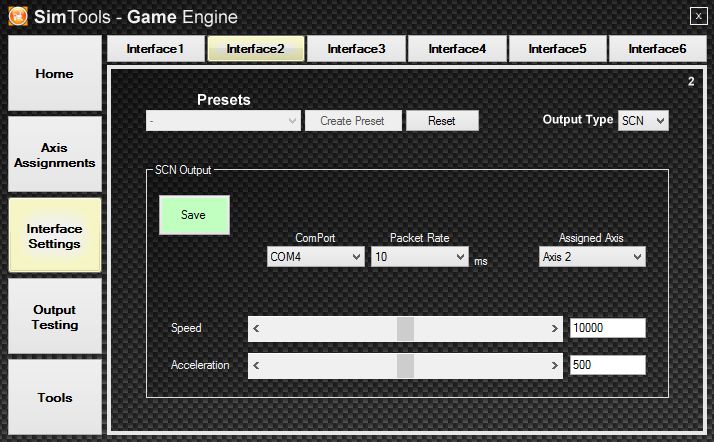

    I configured my SCN5 interface and axis assignments as follows, these settings should be a good start point, but there might be better options out there.

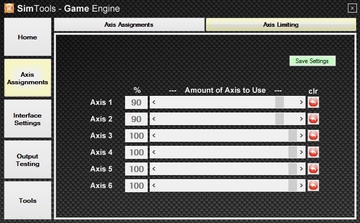

    Axis assignments:
    Notes:
    1. You may need to change the direction of some of your axis if they are not moving correctly. But, if you read the Quick Start Tutorial you know how to fix it. Right? ;-)
    2. Make sure each SCN5 axis has a limiter of 90% or less (move slider to the left, never to the right), as per screen shot above. This will help prevent damages to your actuator if it bottoms out.
    3. Don't go crazy installing lots of plugins before you have a good basic Default profile. Every time you install a plugin the SimTools will copy the default profile to create the basic profile for that game. So, if you install lots of plugins, it will be more work to you later to fix one by one, even if you use presets.
    4. Avoid changing forces intensity in the axis assignments, instead, use the Game Manager editor as explained here:
    http://www.xsimulator.net/simtools-game-manager/#Editor
    SCN5 interface:
    Note: ComPort will change depending on which port your adapter where installed. Make sure to set each actuator to their correct Comports.

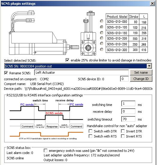

    T/S Tip:
    If only one of your actuators is moving after the conversion, it is probably a problem with their ID configuration. They need both to be set to ID #0.
    To check and correct that, you can use an old x-Sim version or try to use the SCN PC tool:
    http://www.automation4less.com/servact1.htm
    More info here: http://www.xsimulator.net/community...cm-to-simtools-updated.1412/page-9#post-48329
    The following screen shot shows how the SCN5 Devide ID is shown on x-Sim interface settings. If it is set to 1 or another number which is not zero, you can type 0 in the box and click on Change ID button:

    Please be careful. High speed with low accelleration may harm your actuators, as accelleration is as well BRAKING!
    We should open a new thread for FSX, to keep on topic in this one.
