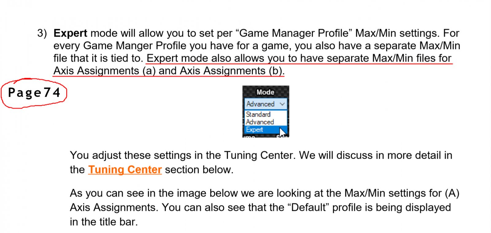

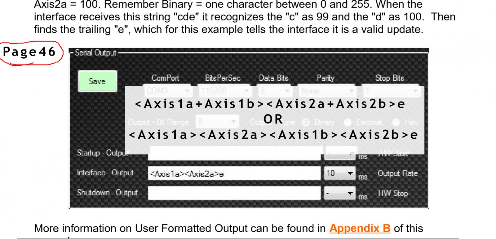

    I'm reading the Simtools documentation and I'm not sure how to add multiple forces on the same motor (axis).
    I would like, for example, to place "a little bit of Pitch with Game Limits Min/Max 10" and another "Pitch with Game Limits Min/Max 1000" added together.
    Is it possible?
    I am new to this software so please forgive me if its a silly question oK!

    I get what you mean @SeatTime and to an extent more detailed tuning options are useful, but do tend to overwhelm new members, who already struggle with the functionality SimTools already provides.
    For now @rafael_design if that is the use case, presuming a 2DOF within the existing SimTools functionality you could run a larger Min than Max in the Tuning Center for the gear shift effect and tune pitch for the undulation and heave for the degree of road effect, following the tips and tricks in the earlier link.
