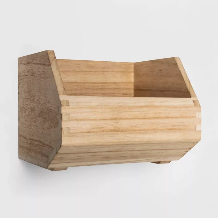

    At first I thought a 4 person ride vehicle would be great and I would love to build a 4 person vehicle, but all that comes to mind is weight. The amount of weight that would be on the platform for motors would be too much for a home build. So, I thought a 3 person ride bench would suffice. Ideally I would like the ride bench to hold 3 adults. If each adult is 200 lbs then 600 lbs would be the weight capacity. As I stated before, the car would be a bench with walls on either side to block vision. I found this little wooden crate at target which is similar for how I want the car to look.
    An effective design indeed, however this means the actual base would have to be a rectangle. Could that work?

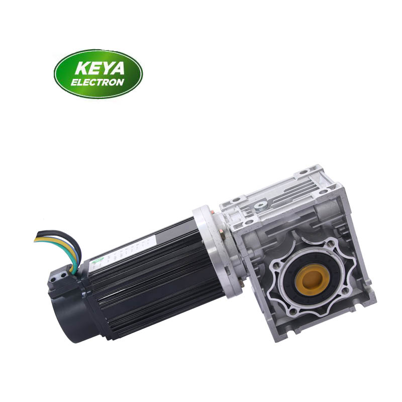

    Would you say something like this:
    this particular motor has a torque of 19N.m.

    None of these servos, or previous AC motors with VFD inverters you linked will connect directly to simtools...
    You need a motion controller that sits between your PC and these servos and interprets the motion commands from simtools to digital pulses for the servo drives...
