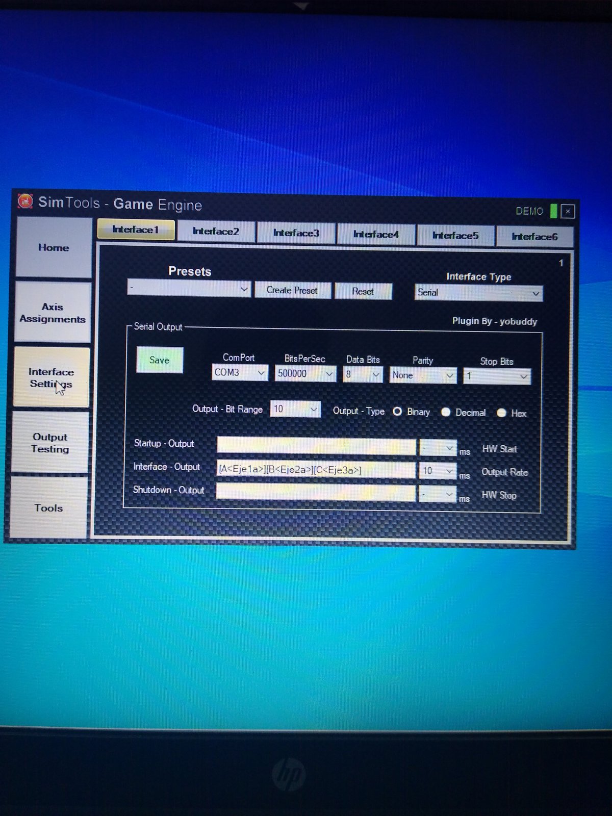

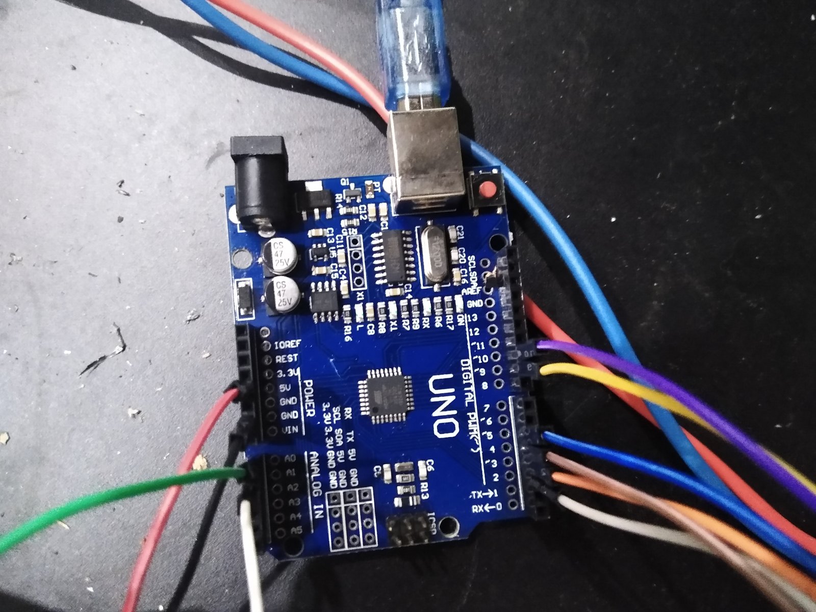

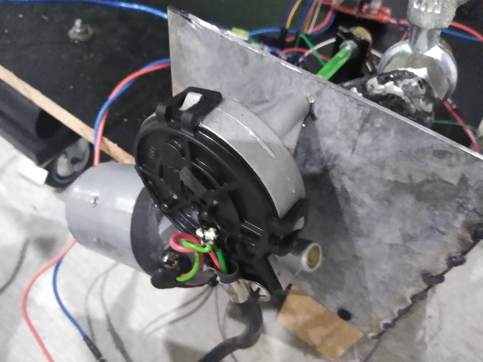

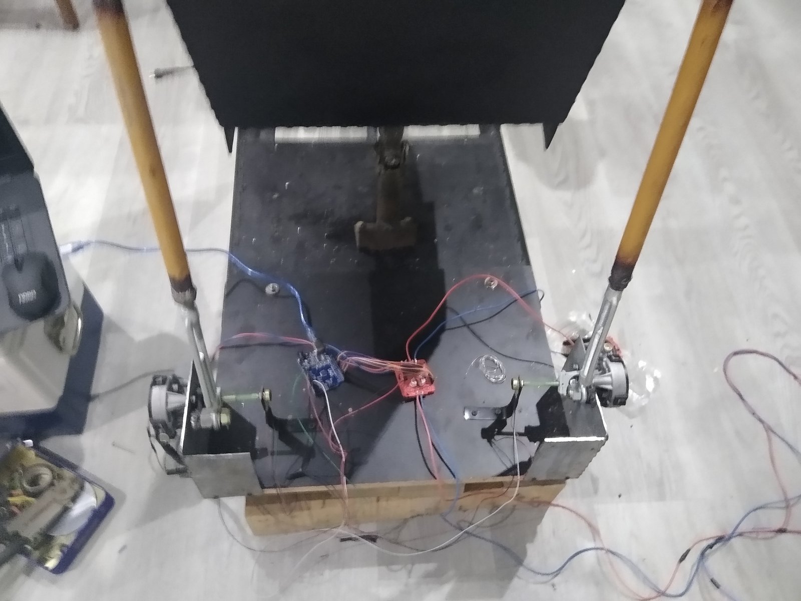

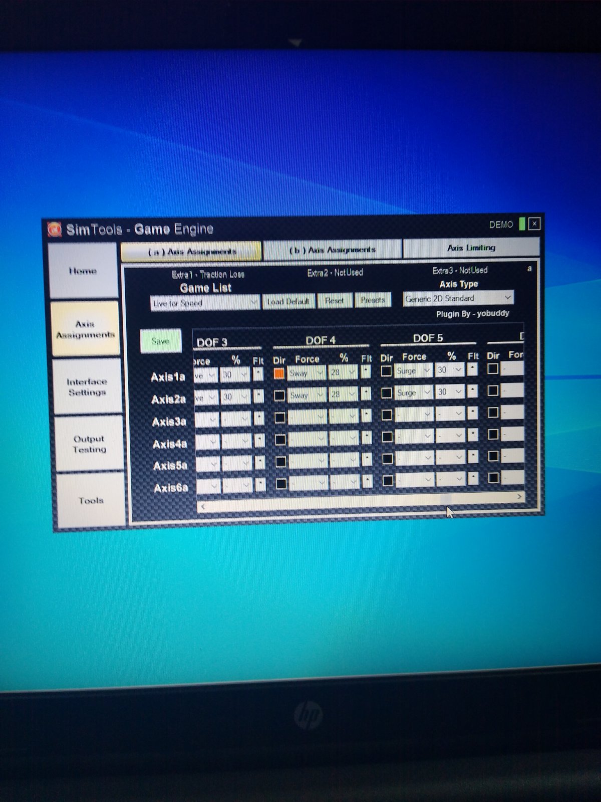

    Hello, I am trying to make a simulator with scrap metal, Arduino uno and moto shield, using the smc3 program I was able to make the used windshield wiper motors work, but I cannot make the simtools move it, please help me to do it

    if the smc3 works properly and makes the motors move

    Interface settings should be exactly like this:
  8. CAI_77
    CAI_77 Member
    Jun 30, 2022
    88
    67Coins
    +25 / 0 / -0
    2DOF, DC motor, AC motor, Arduino, Motion platform
    thank you sir you are a genius

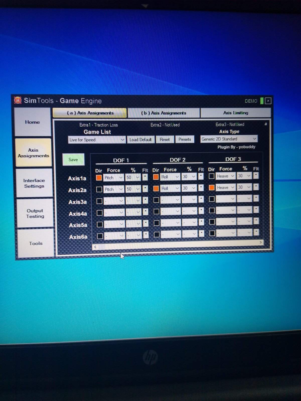

    simtools already works, thank you very much, I thought I would go crazy, now how do I play live for speed and make the simulator work??
    21,493
    150,578Coins
    +11,017 / 55 / -2
    LFS must be run before patching it for motion: https://www.xsimulator.net/communit...run-in-first-person-mode-before-patching.365/
    Make sure you grab a copy of the SimTools manual and keep it handy for reference: https://www.xsimulator.net/community/faq/rtfm-start-with-the-official-simtools-documentation.117/
    Then see the motion profile tuning tips in the FAQs: https://www.xsimulator.net/community/faq/steps-to-create-a-motion-profile.228/

    thanks again for the information, I will read the manual and follow the steps you have indicated, have a great day!

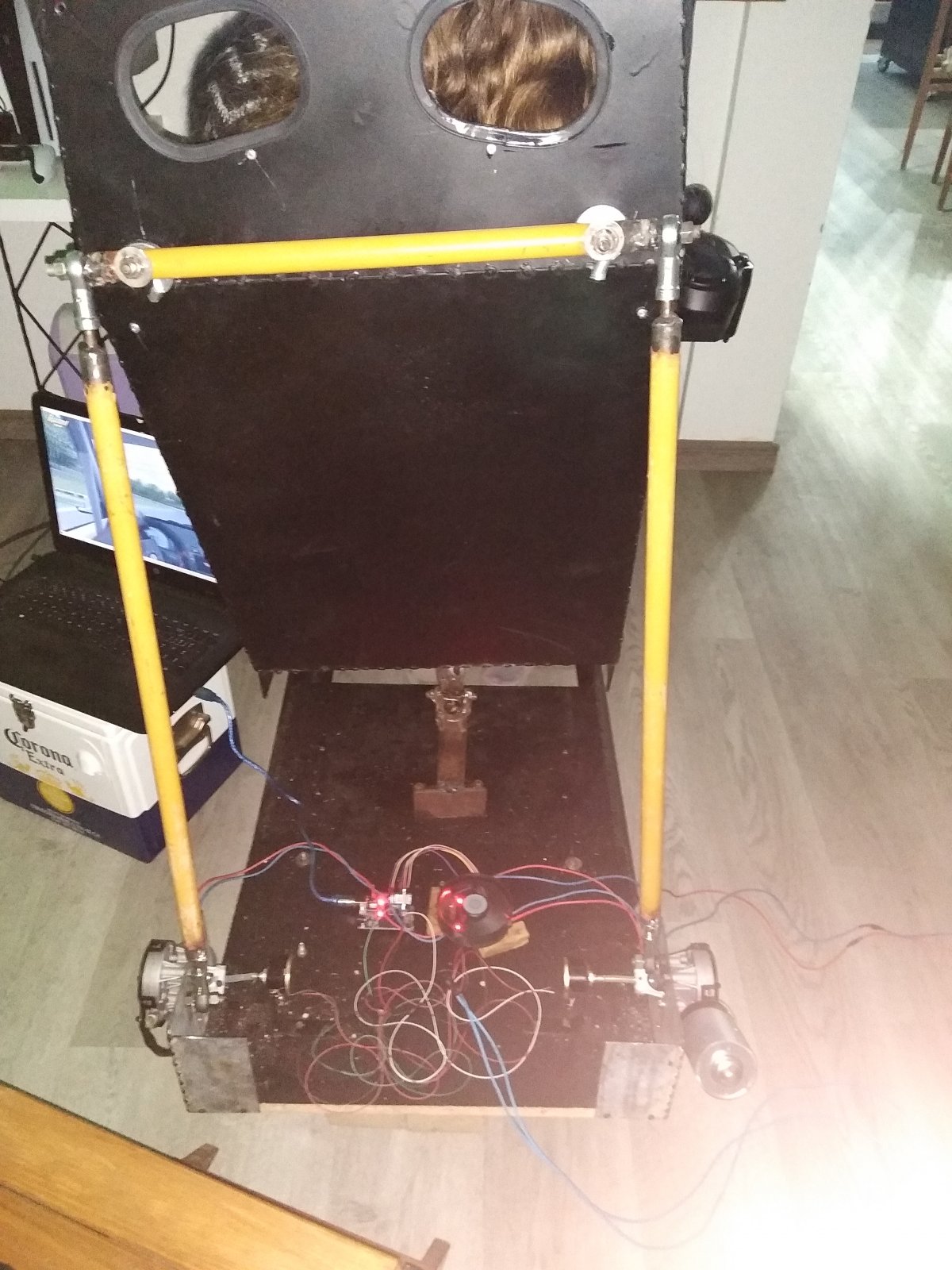

    good evening!! I made it, thanks to your help sir, you were step by step indicating everything I had to do, you are a teacher, sorry for so many questions, it is a pleasure for me to belong to a community like this with people with such kindness and dedication, thanks again infinite

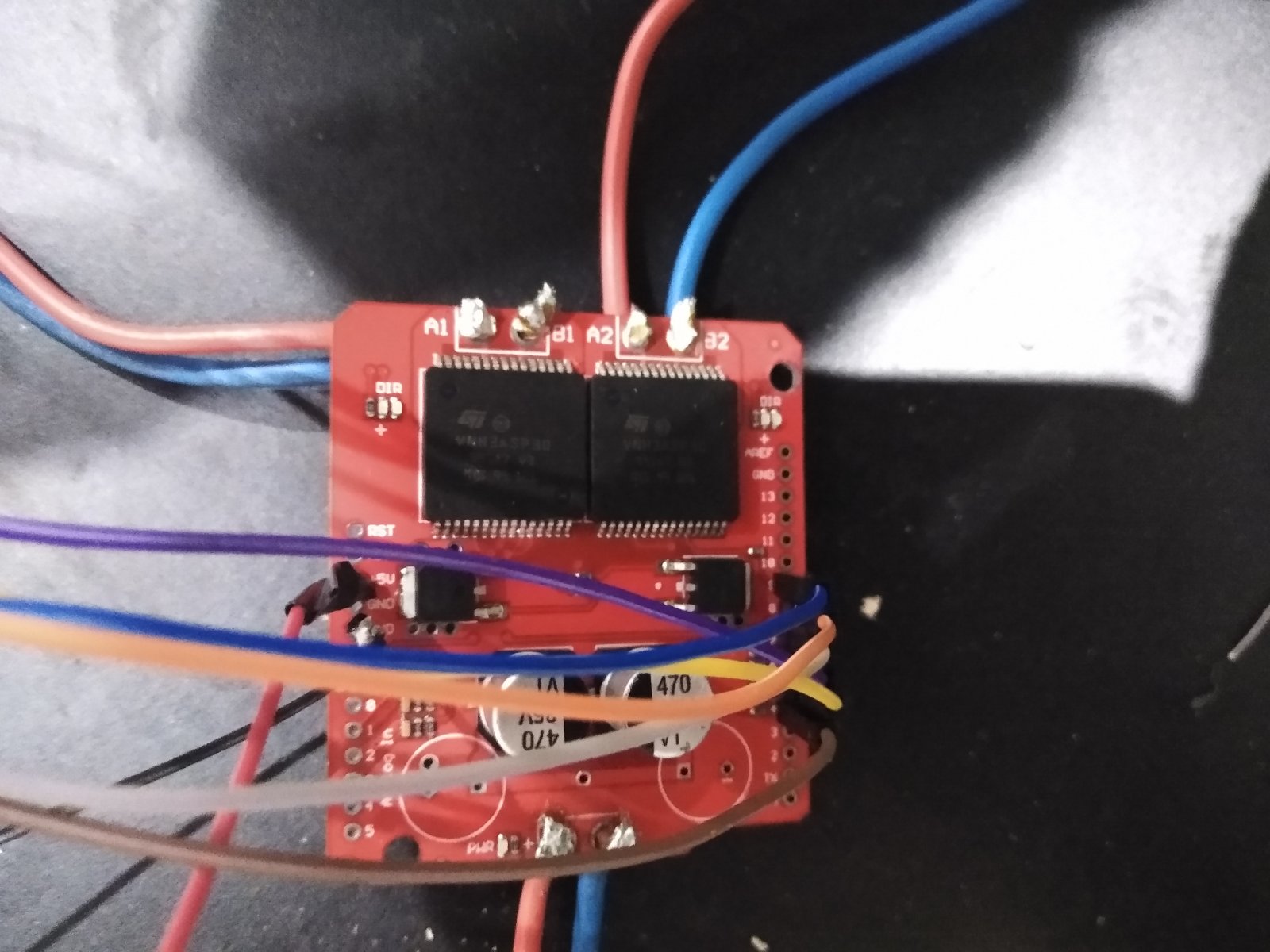

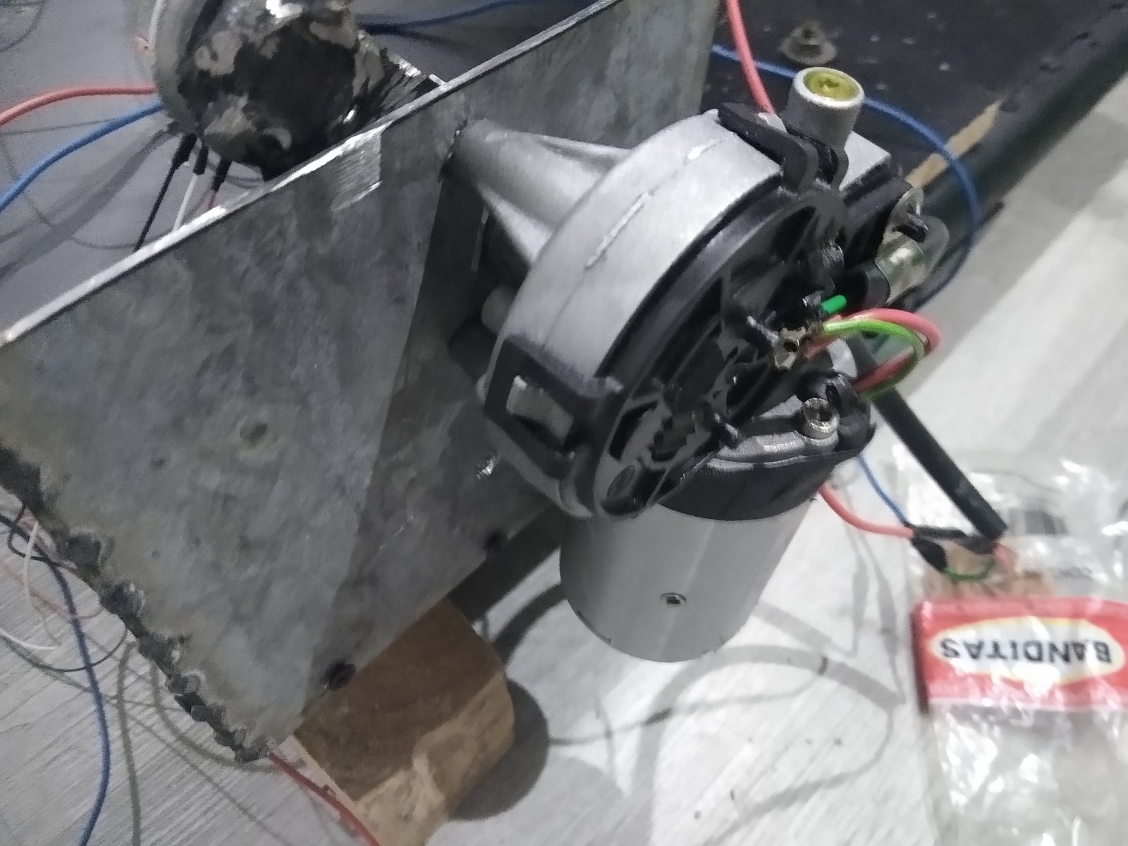

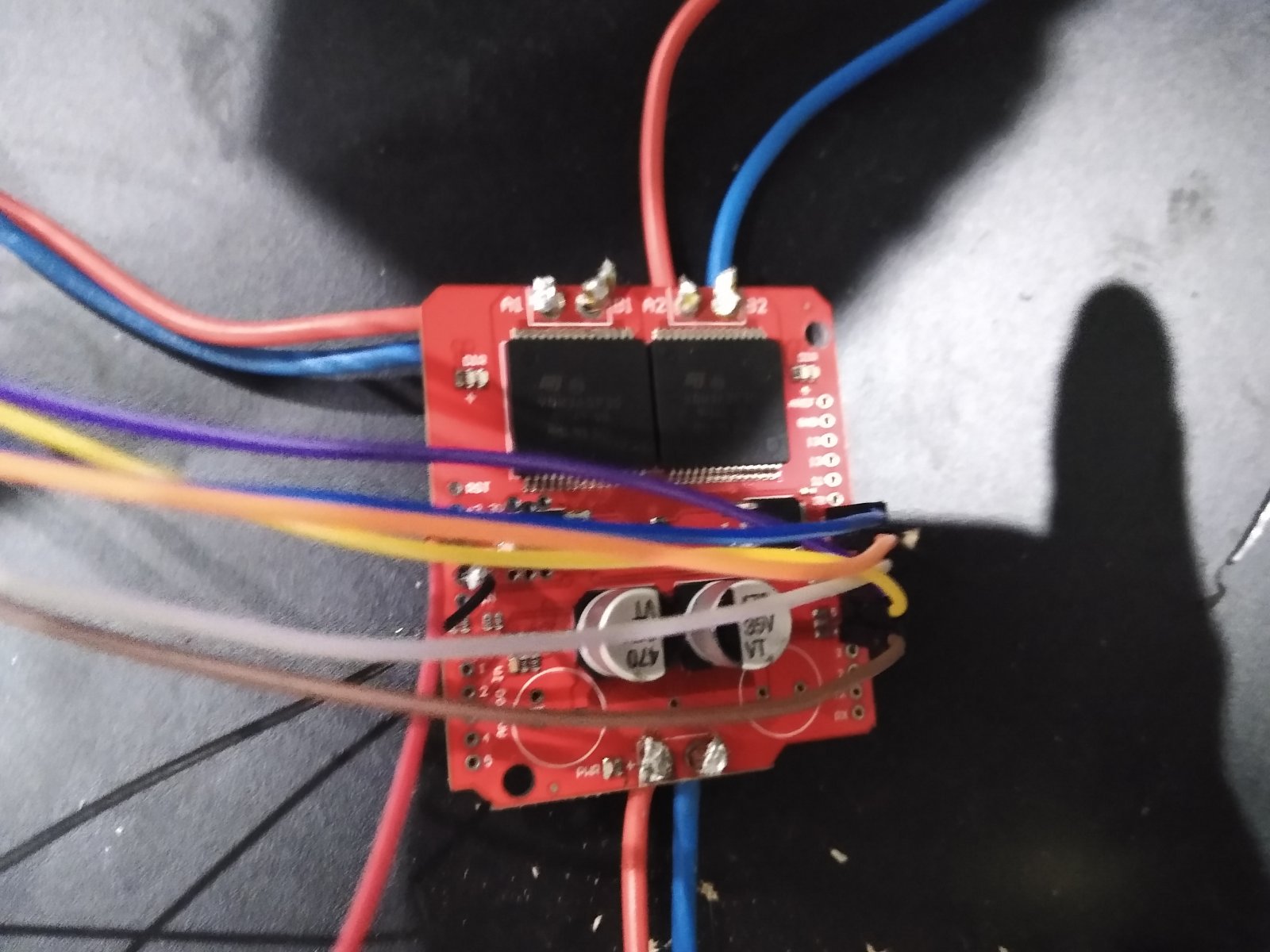

    Just a further observation, MMs require heat sinks and fans to remain adequately cooled under load.

    you are very kind and attentive, thank you once again, I continue studying and trying to improve my simulator, I already put a fan to keep the motoshield at a low temperature, I still can't get heatsinks for it

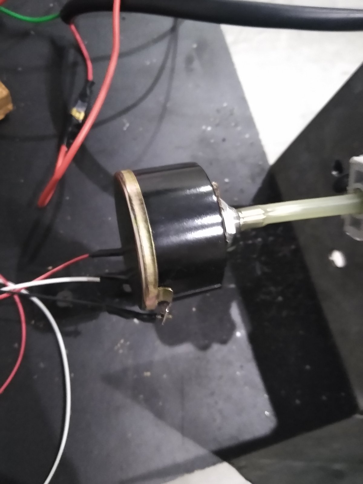

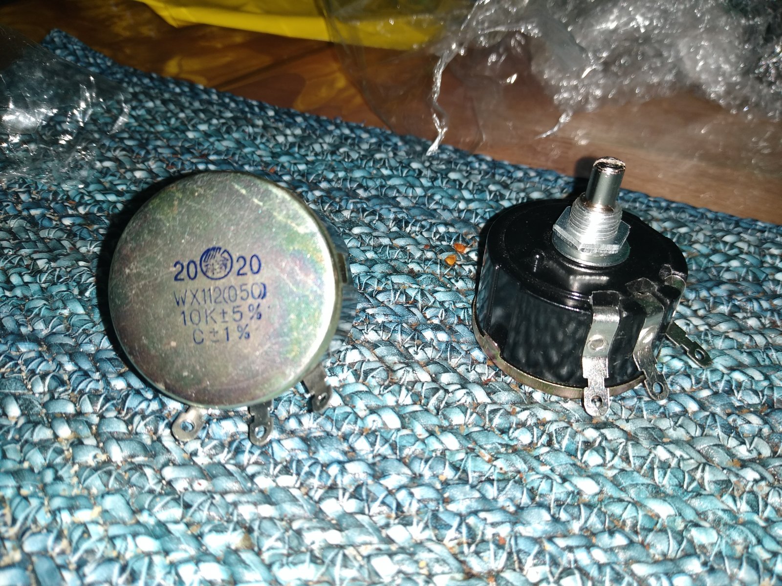

    new potentiometers to make it work better

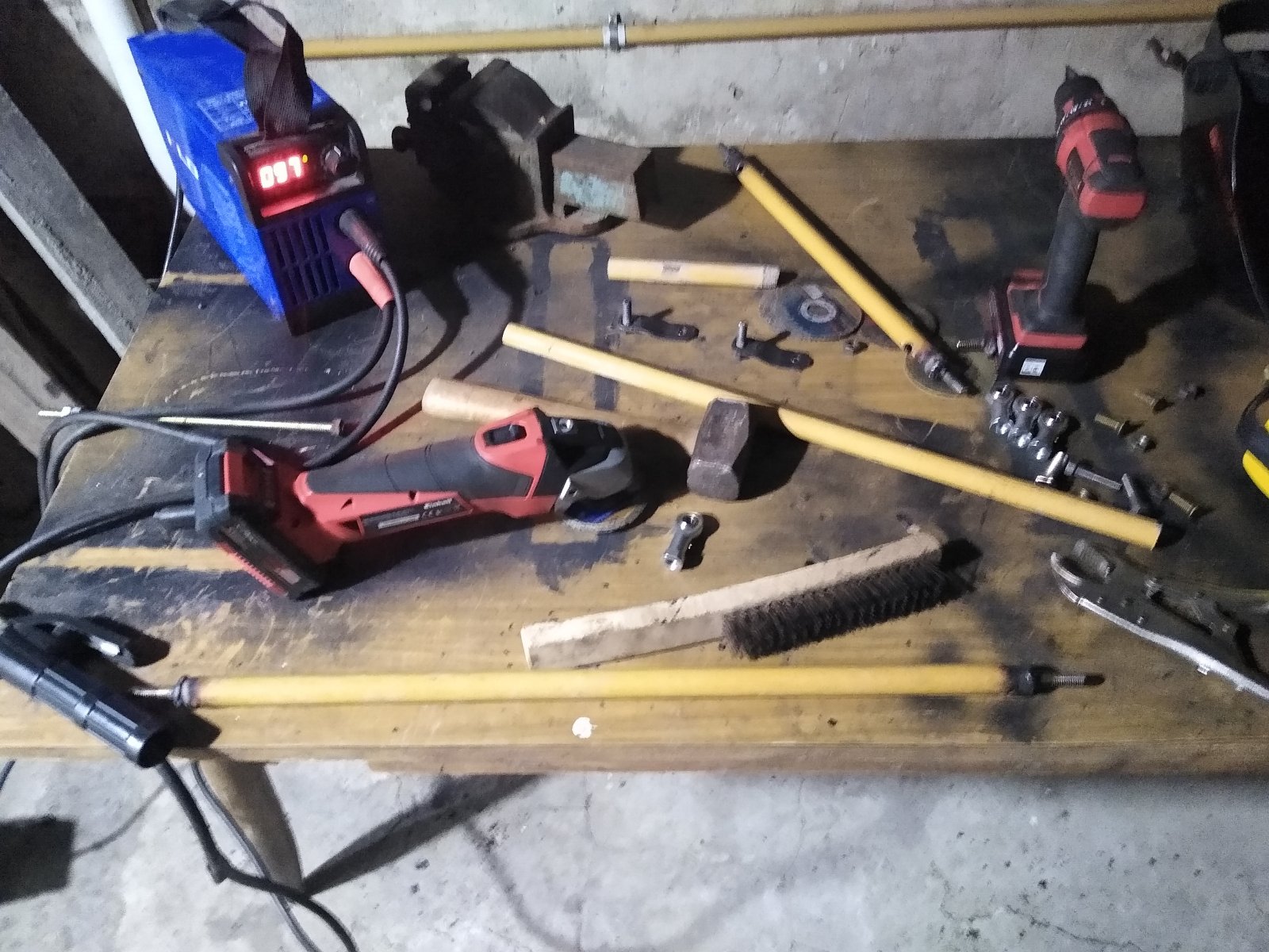

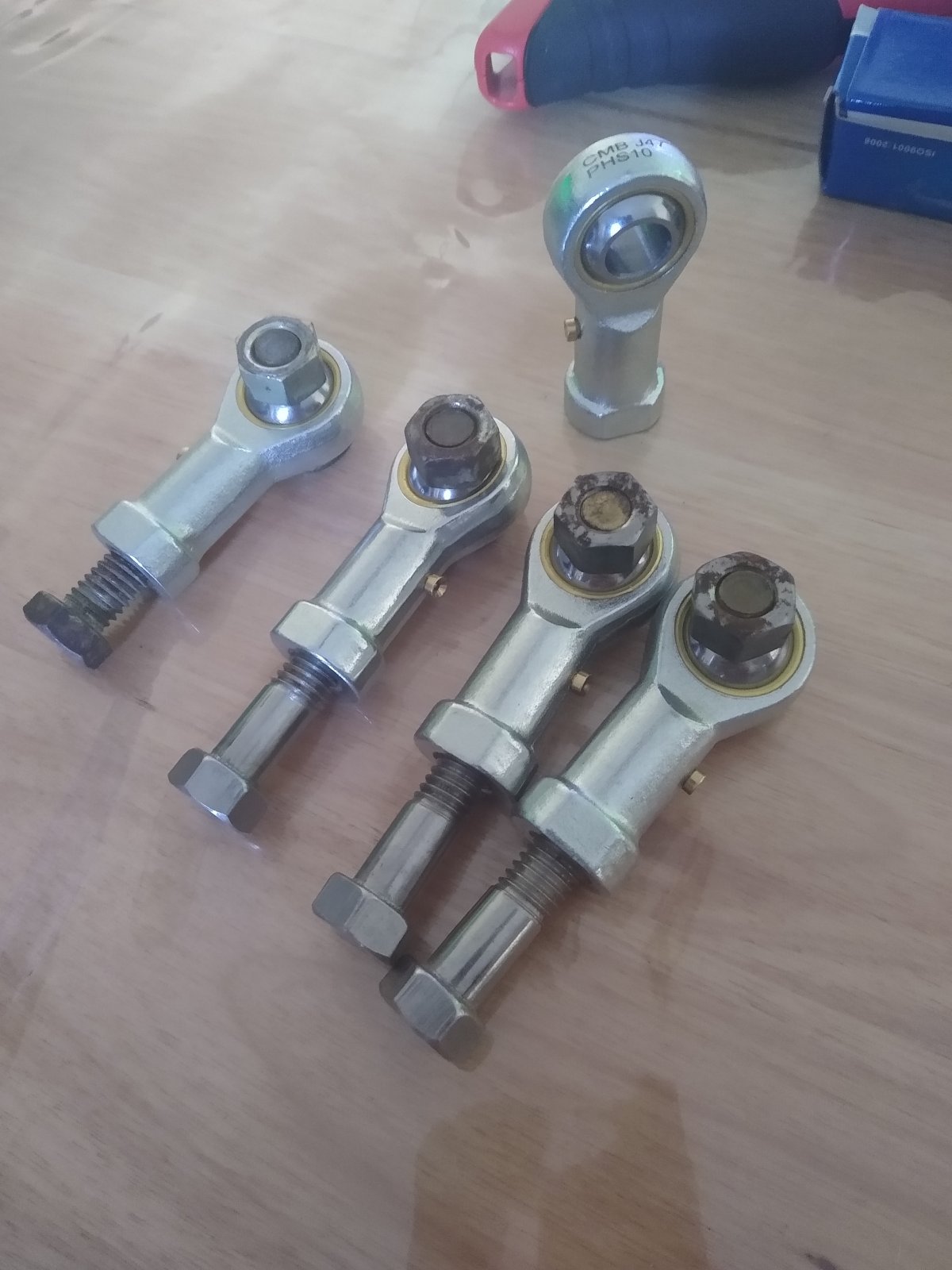

    ball joints donated by some friends to improve my simulator

    here manufacturing the new tensors with the ball joints IMG_20220718_191936827.jpg

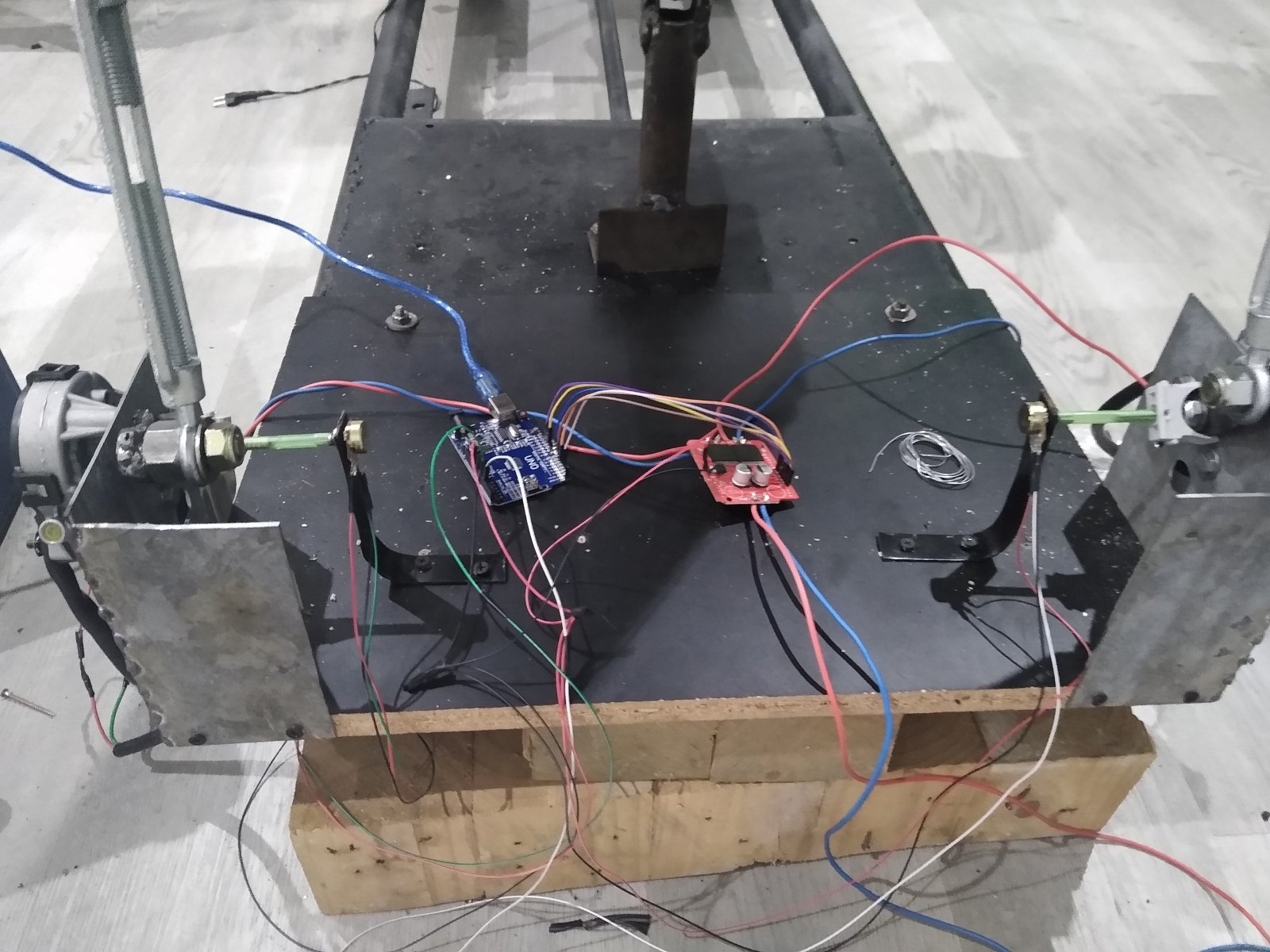

    the new tensors work very well, they greatly improve the movement and sensations of the simulator
