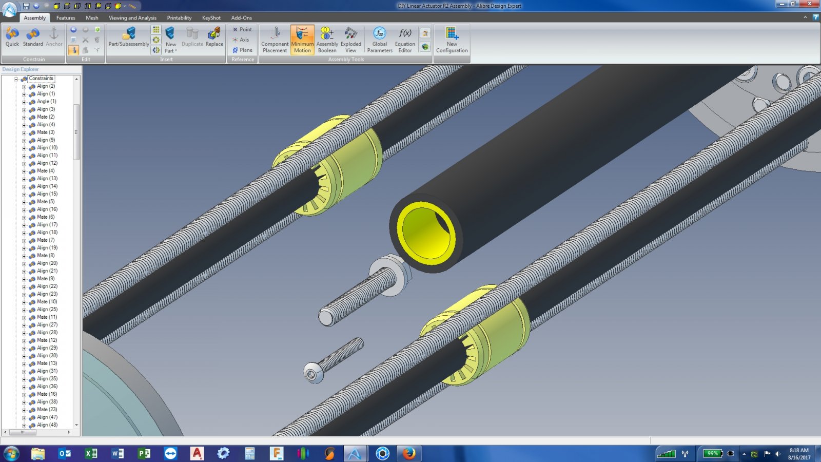

    OK, So it was a little after midnight when I finished bolting everything together and taking a few pictures so I didn't have time to add comments.
    Assembly was easier then I thought it would be, but It definitely takes some coordination to get everything put together. Assembly jigs would be very helpful, especially to hold the actuator vertically at different phases of assembly.
    I actually assembled the whole thing and then had to disassemble it because I couldn't get it to rotate. Turns out that the 25mm shaft clamp is capable of compressing the carbon fiber tube and the 20mm brass bushing to the point that it actually pinches the ball screw. The reason I added the bushing was to give some extra strength in this area, I may have to see if I can find a different bushing or even use an additional piece of carbon fiber tubing. I don't know that it will even be a problem, but I had to be careful not to over-tighten the clamp. This wont be a problem when the actuator is pushing, only when it is pulling.

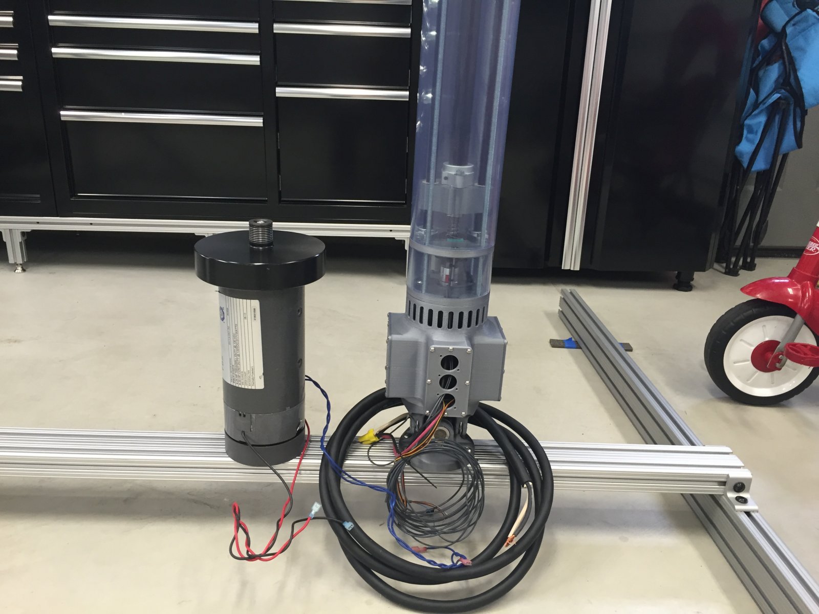

    I built up the test stand tonight, It went together pretty quick. I made a couple of videos of some testing I did, no loads yet as I'm still jamming wires into my kids powerwheel battery. If you listen closely you can actually hear the spark when I make contact.
    I ordered my 4 power supplies today and the parts to finish up the wiring. I wont have the power supplies until next week, but hopefully next week I can have the sabertooth controller running and start doing some load and speed tests. I'm hoping to write some arduino code that will put the actuator into a loop and just let it run under load to see what happens, if anyone has experience with that id gladly take the help.
    It is louder then I expected it would be, but I suppose that is what you get with home built. I am also hoping things will wear in as I run it, I could feel some tight spots along the length of the ball-screw as I ran it up and down by hand before assembly. I believe that is variation in the OD of the ball-screw or wobble in the ball-screw hitting the bushing inside the 25mm carbon fiber shaft, the motor didn't even seem to notice though.

    this is very laud indeat, much lauder than my current setup. i think the noise comes from the gear to the encoder.
    i cannot imagine this comes from the ball screw. is it possible that the motor itself make this noise ?

    i don't think the noise is from the encoder gear, I think it's coming from the ball screw.
    headphones would eliminate the problem, but with 6 going at once I fear I would only get one late night session in before I'm kicked out of the house for good.
    there isn't that many moving parts so it should be fairly easy to find the source.
    It could be the bushing riding on the ball screw, so I may need to find a different solution the that problem.

    I could remove the bushing and I may try that if I can find a good alternative. I don't know that I even need it, but I now know that the carbon fiber tube compresses a fair amount in the shaft clamps so I feel like it is a good idea to have something where the bushing is. I might try to drill it out, but that might be more effort then its worth.
    I can't really test it without the pvc because the pvc is holding everything together. I suppose I could add a bunch of nuts at each section and just use the threaded rods, but it wouldn't have much strength.
    before I tear anything apart though I want to get my electronics finished up and see how it acts at different speeds.

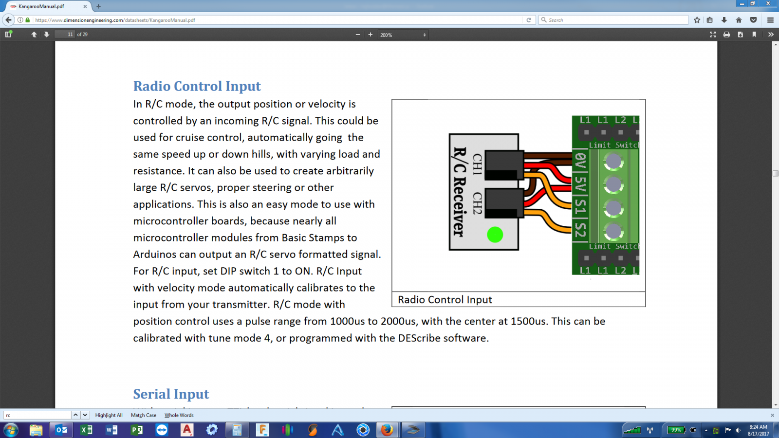

    Awesome, that looks like exactly what I would want. Thank you for the help
    I was also thinking that for initial testing without setting up a computer I could use the RC input mode on the sabertooth and the actuator will be just like an oversized servo motor. Then I can control it with my RC remote which would be pretty cool and very simple to setup.

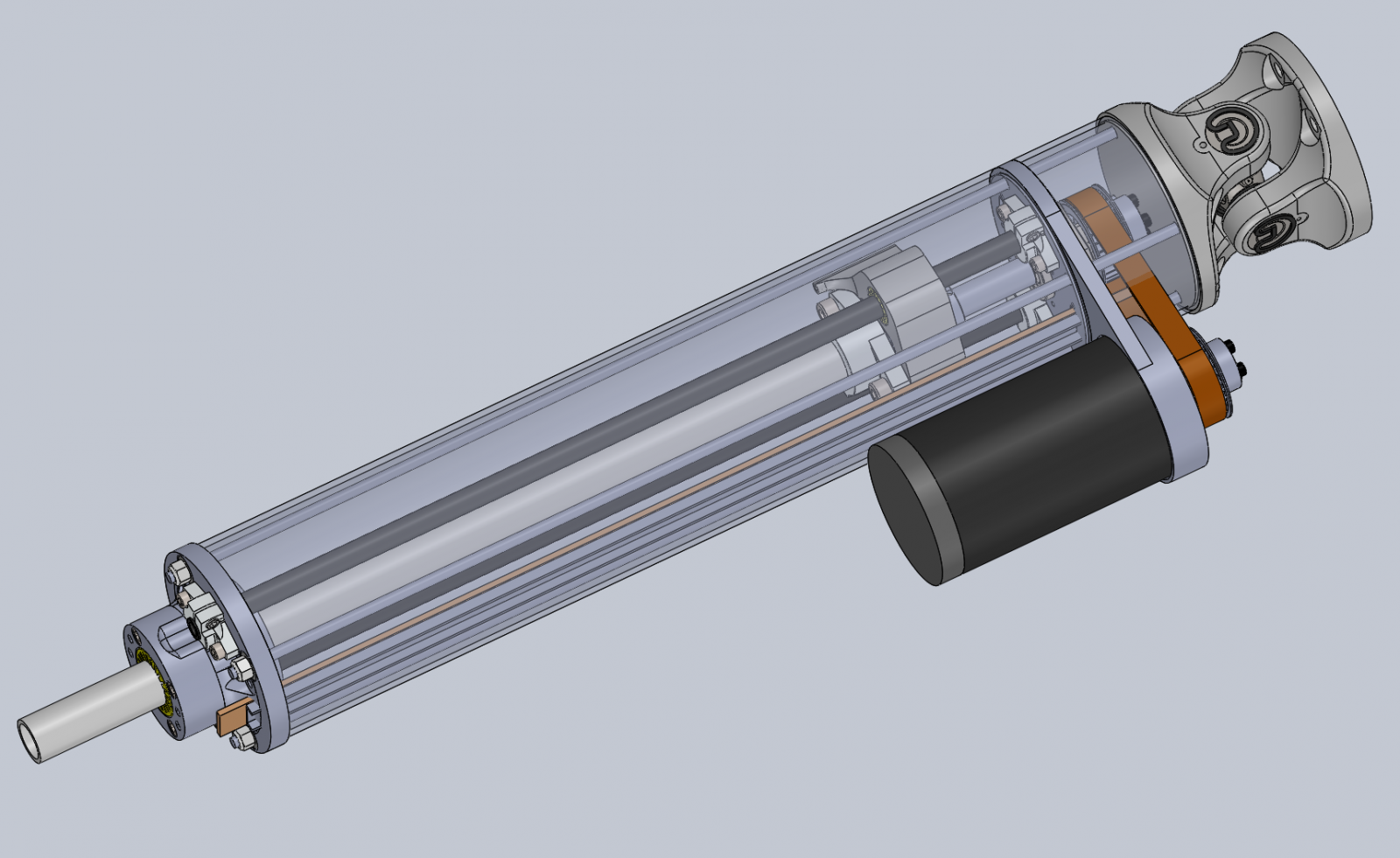

    as i really like this actuator i modified it for my usecase.
    I used different type of tube materials with different diameters. also changed the mounting plate to an aluminum type.
    The Main Shaft is made of polished steanless steel, the position sensor is an magnetic position sensor instead of an encoder type sensor.

    Nice, I originally wanted to do a belt drive motor like that, but I figured I would try to keep it simple for the first go around. Seeing how tall this thing is I think that will be the way to go if I can keep it cost effective.

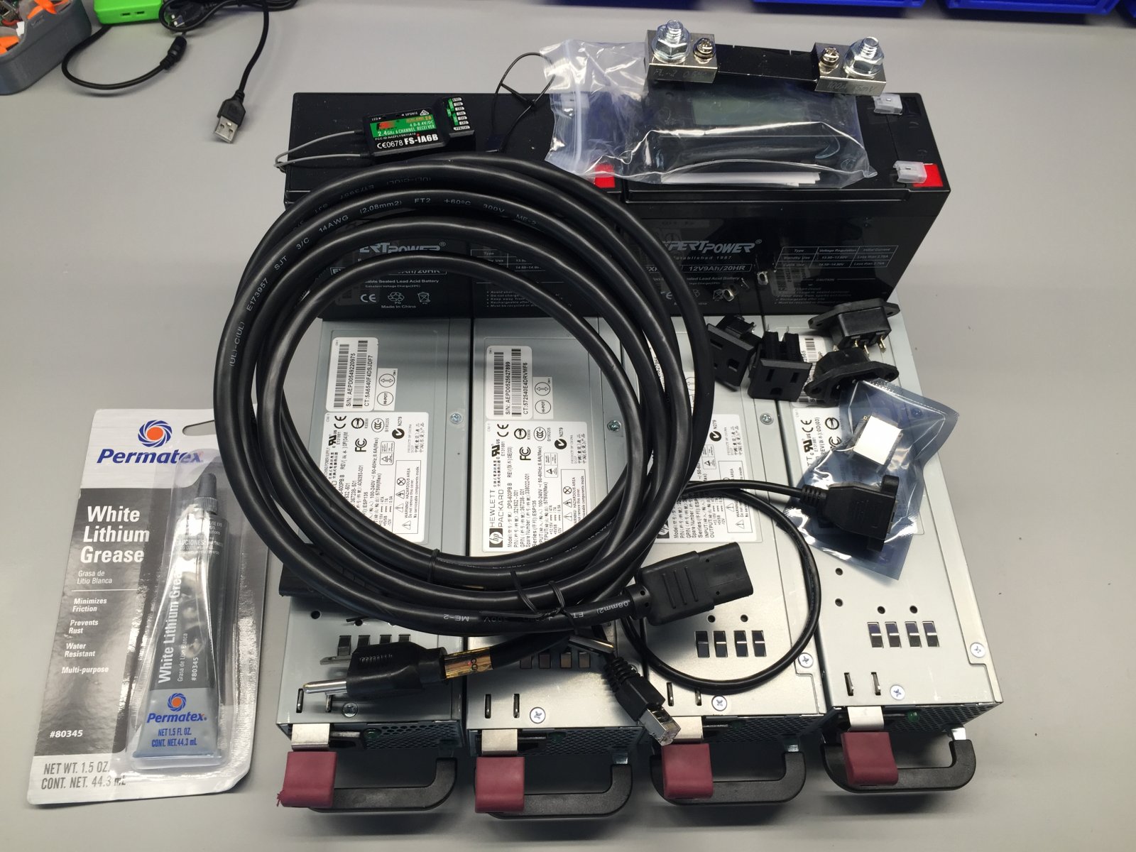

    Amazon and eBay left a few packages today. It should be everything I need to get the power system all setup.
    I don't think I will have time this weekend, but maybe I will pull a few late nights this week.

    Hey @Hoddem - is that a shunt in that photo? If so, you measuring total current or on an actuator by actuator basis?
    Looking damn fine, btw!
  19. Hoddem
    Hoddem Well-Known Member
    Sep 27, 2016
    404
    Engineer
    Minnesota, USA
    3,343Coins
    +717 / 2 / -0
    @Zed, you have a good eye. I didn't know if anyone would look close enough to see that. It's a shunt for a 100a current meter. It's a digital system so I'm not sure how fast it can react, hopefully fast enough to see the peaks. It also tracks total power so I can see on average what my power output needs to be. I'm planning on using it for the one actuator to get an idea of how much power I need and verify if my wiring is ok to handle the current.
