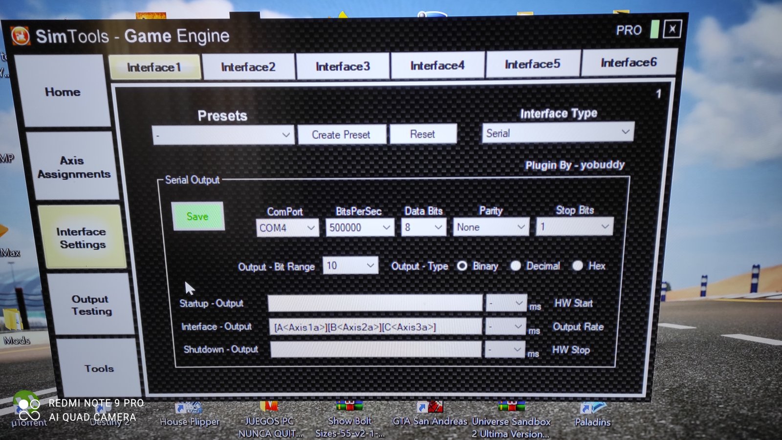

    Hello well I have a problem in SimTools GameEngine, and I tried all kinds of configurations and when I go to Output Testing Nothing works for me or the engines And with the Windows Utility if it works correctly, if you know something to try I will read your answers greetings thanks.

    Please post picture of your Interface and all other settings.

    IMG_20210131_102023.jpg IMG_20210131_102023.jpg IMG_20210131_102003.jpg IMG_20210131_102003.jpg
    Hello good morning these are my parameters
    I hope it works
    Thanks a lot

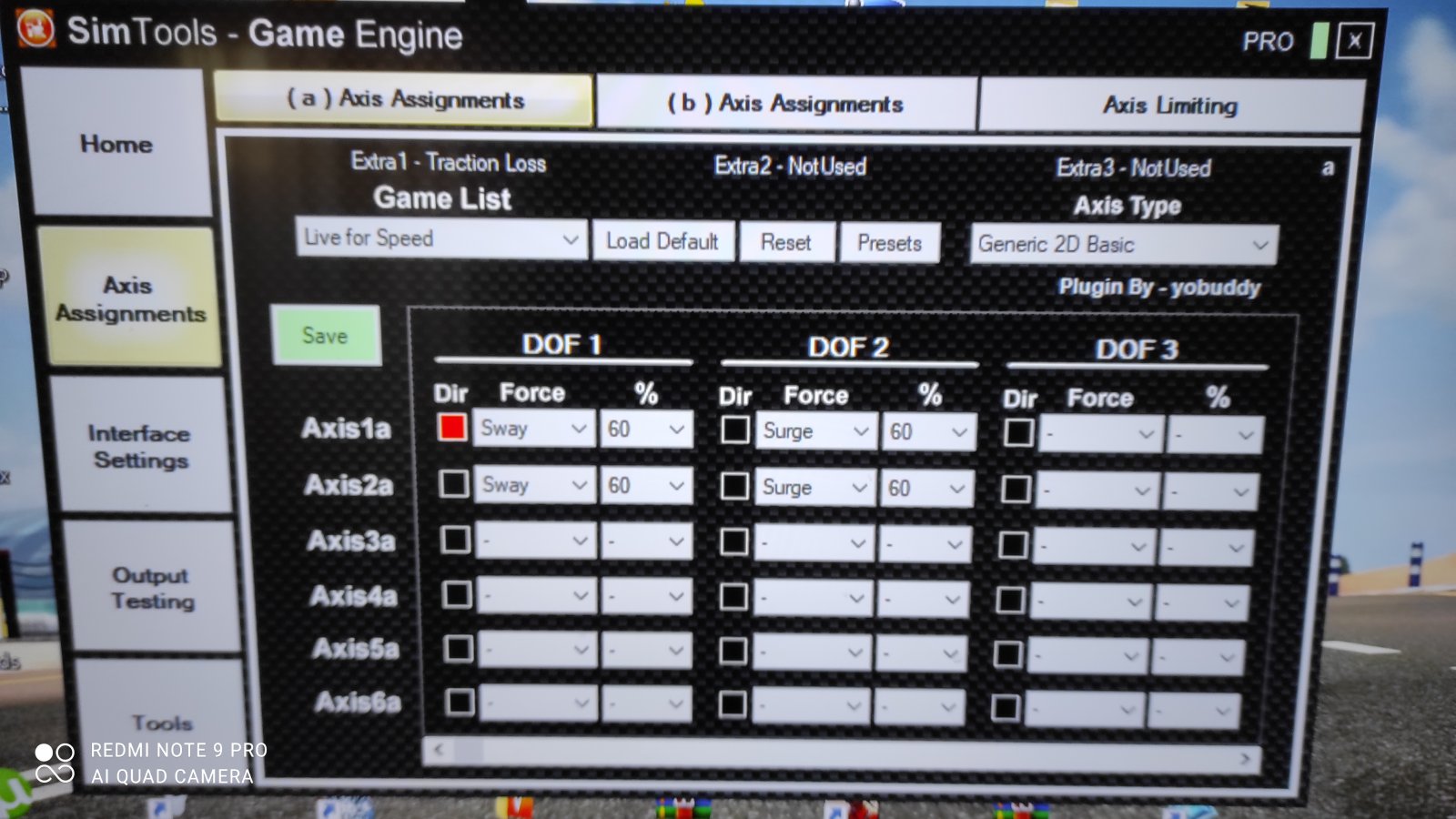

    @lulo340 I believe for output testing to work you need to set the default profile in the game list.

    Hello, well, the live for speed works for me with the engines correctly, but I have a problem, when accelerating the car goes forward and when braking backwards (backwards) if someone knows why, please write it to me. greeting

    Grab a copy of the SimTools manual and keep it handy for reference: https://www.xsimulator.net/community/faq/rtfm-start-with-the-official-simtools-documentation.117/
    In Axis Assignments the DIR box being checked orange or not determines which way each axis moves, in your case it sounds like they are reversed for surge.
    This is how SimTools expects axis to be configured: https://www.xsimulator.net/community/faq/which-way-to-set-simtool-axis-movements.230/

    hello i solved it by starting game manager and engine as administrator and disabling firewal and antivirus.
    and it worked for me.
