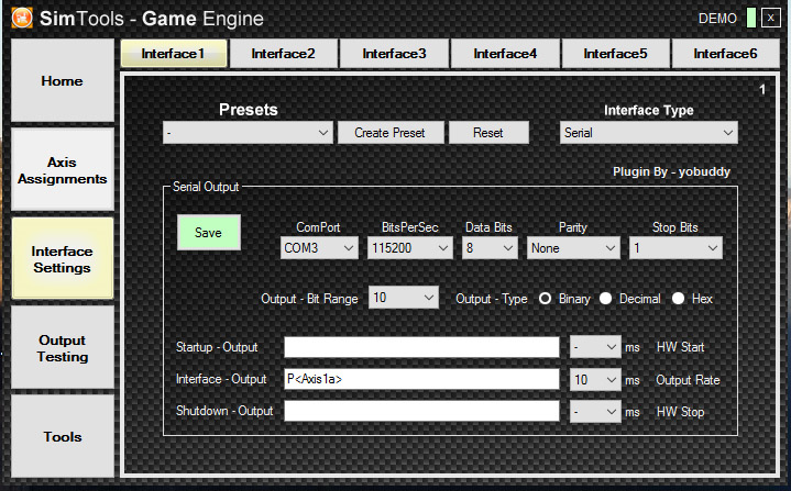

    Hi everyone, I'm wondering if anyone can provide me with some guidance on setting up Game Engine for an Arduino?
    I've started with the RCModel code by EAOROBBIE from here which I've modified to work with only 1 axis (P for pitch) and to drive a stepper motor (code below if it helps).

    The code seems to be doing what it needs to, using the fomat that EAOROBBIE uses in his code, if I enter PXXX~ in the Arduino Serial Moniotor then the stepper will drive to the position determined by the value of XXX. I had assumed then that all I needed then was to have the interface output setting as P<Axis1a> to get me up and running with testing.

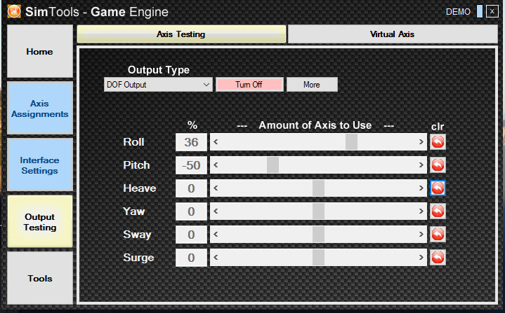

    So then I tried to drive the stepper using the output testing of Game Engine, but I'm not seeing any signs of data being sent between SimTools and the Arduino, so any help in getting my settings right would be greatly appreciated.
    My settings are:
    Default Axis assignments:
    Interface settings:
    What should BitsPerSec be set to (I've seen all sorts of settings used in examples, shouldn't it be 9600, the rate I set in the Arduino code)?
    So then I click on Output testing, turn it on and move the axis, I'm not seeing a response from the Arduino, either in the serial monitor or in the motor.
    I'm guessing my problems stem from getting my information of correct setups from a number of sources and guides, most of whaich are for older versions of Simtools (or am I totally off track and have made a fundamental error in how this should all work), can anyone see what I might need to change here to get me up and running? Any help would be much appreciated, thanks!

    Just a quick update, I hadn't been able to load the interface cfg file that EAOROBBIE posted with his code (I assume cause it was for SimTools 1) but just realised that it'd be a simple text file, so I've now setup the interface settings as for that file:
    Com: COM3 (which is my Arduino)
    BPS: 9600
    Data Bits: 8
    Parity: None
    StopBits:1
    Output Bit Range: 8
    Output Type: Decimal
    Interface Output: P<Axis1a>~
    Still no response in Output Testing, any suggestions on what I'm doing wrong would be apprecaited.

    OK, some progress, I installed some USB sniffing softwae which reset the usb ports and rebooted the machine, and I'm now seeing some response from the motor.
    The only issue now is that it's a very much delayed response, when I move the testing slider the motor turns about 5 to 8 seconds later, has anyone else seen bahaviour like that before?

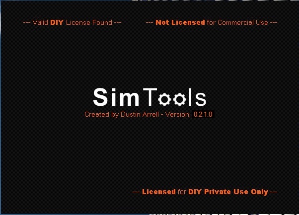

  6. speedy
    speedy Well-Known Member
    Feb 1, 2012
    1,193
    Alexandria , Egypt
    7,941Coins
    +1,287 / 10 / -0
    SimTools version displayed on the GM startup screen ...

  8. yobuddy
    5,375
    50,303Coins
    +5,149 / 18 / -0
    It's on the splash screen of game manager when you startup buddy.
