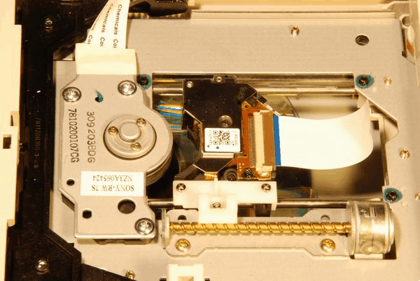

  11. speedy
    speedy Well-Known Member
    Feb 1, 2012
    1,193
    Alexandria , Egypt
    7,942Coins
    +1,287 / 10 / -0
    That's easy I guess ...
    Look at this Floppy/CD-ROM mechanism ...
    you need to get one of these high pitch motor shaft as it advances the mechanism by let's say 0.5cm per motor revolution ...
    then design/print a corresponding gear that meshes with it that has a perimeter length of 10 times that shaft pitch ...
    so when the shaft revolves 10 ... the gear will have a complete 1 revolution .
    Unfortunately I have this confirmed idea but I don't have a 3D printer :grin

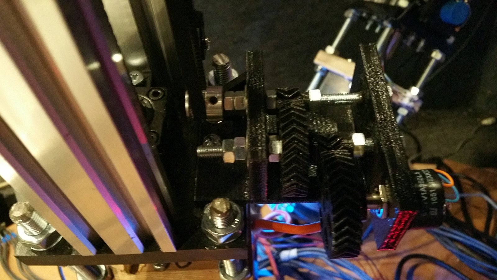

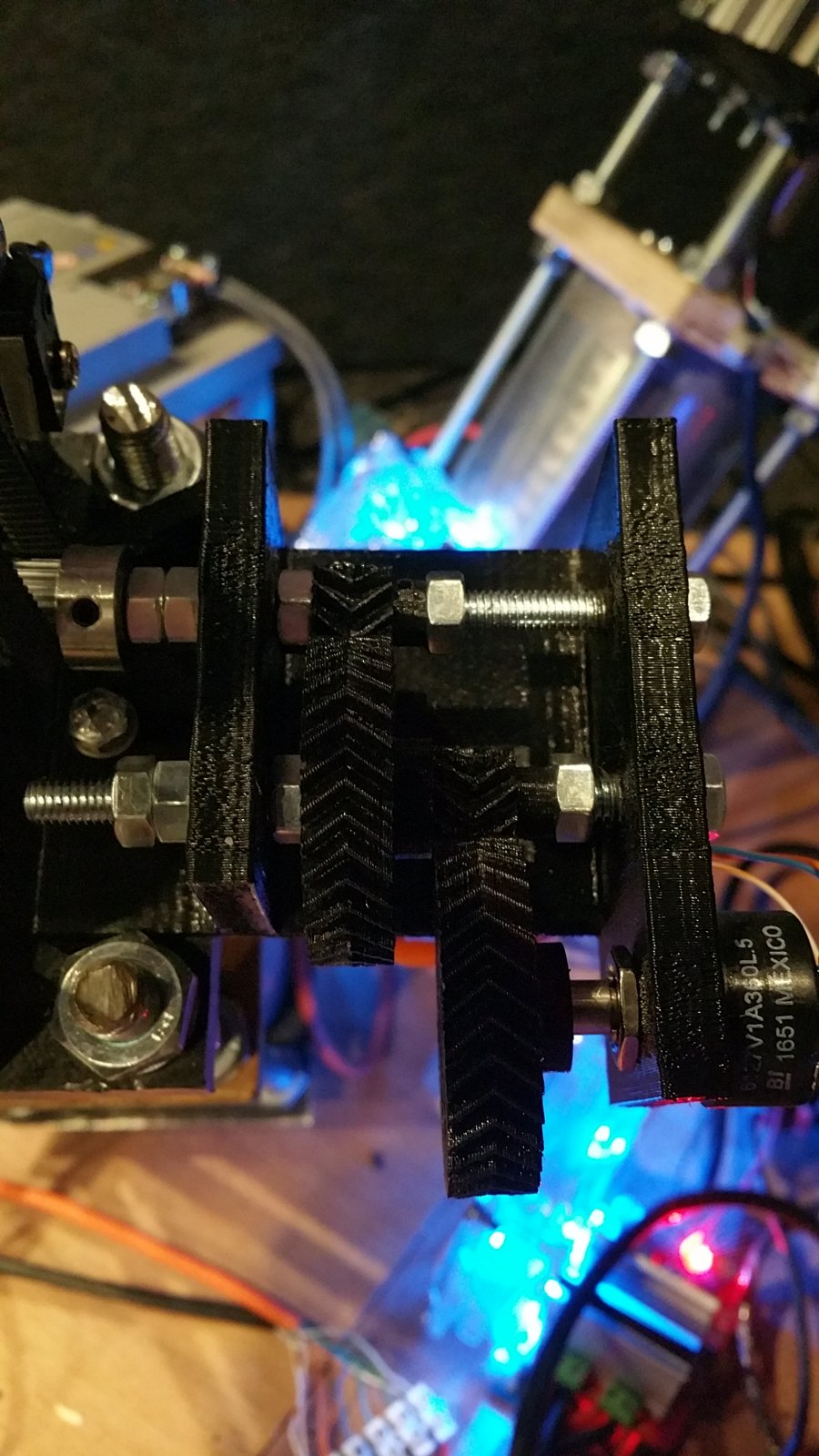

  12. SilentChill
    2,645
    20,584Coins
    +3,566 / 34 / -0
    Bearings finally came and I put my first little gearbox together, really not so little lol but it works and the reduction is exactly the same rotation for my 10turn pots I did not need to change any limits in Simtools. Maybe a fluke but hey ho.
    I just need to make it more compact

  16. SilentChill
    2,645
    20,584Coins
    +3,566 / 34 / -0
    Hah no probs, it's big and crude, I really need something smaller. One good thing there is no slack at all with the herring tooth gears.
