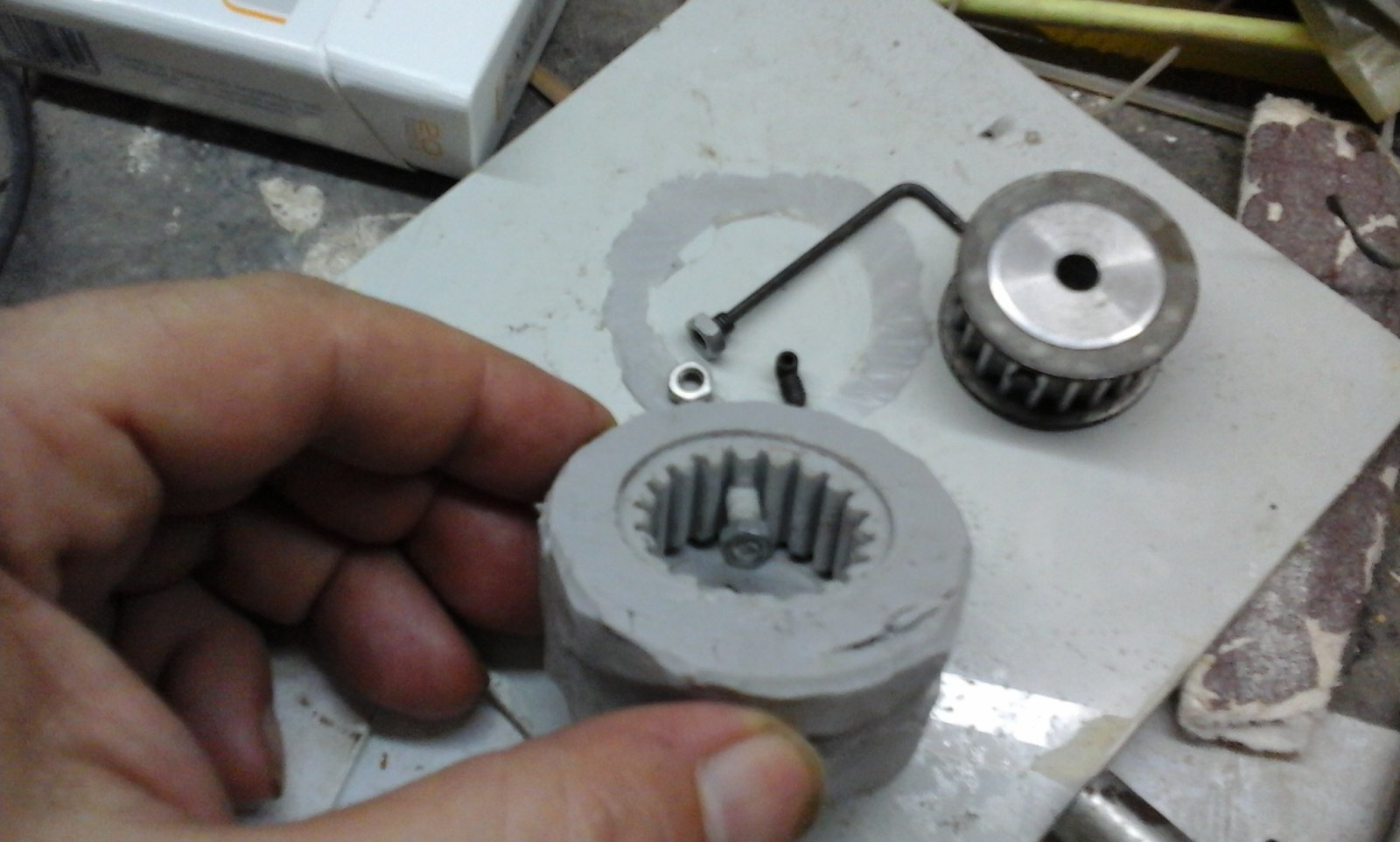

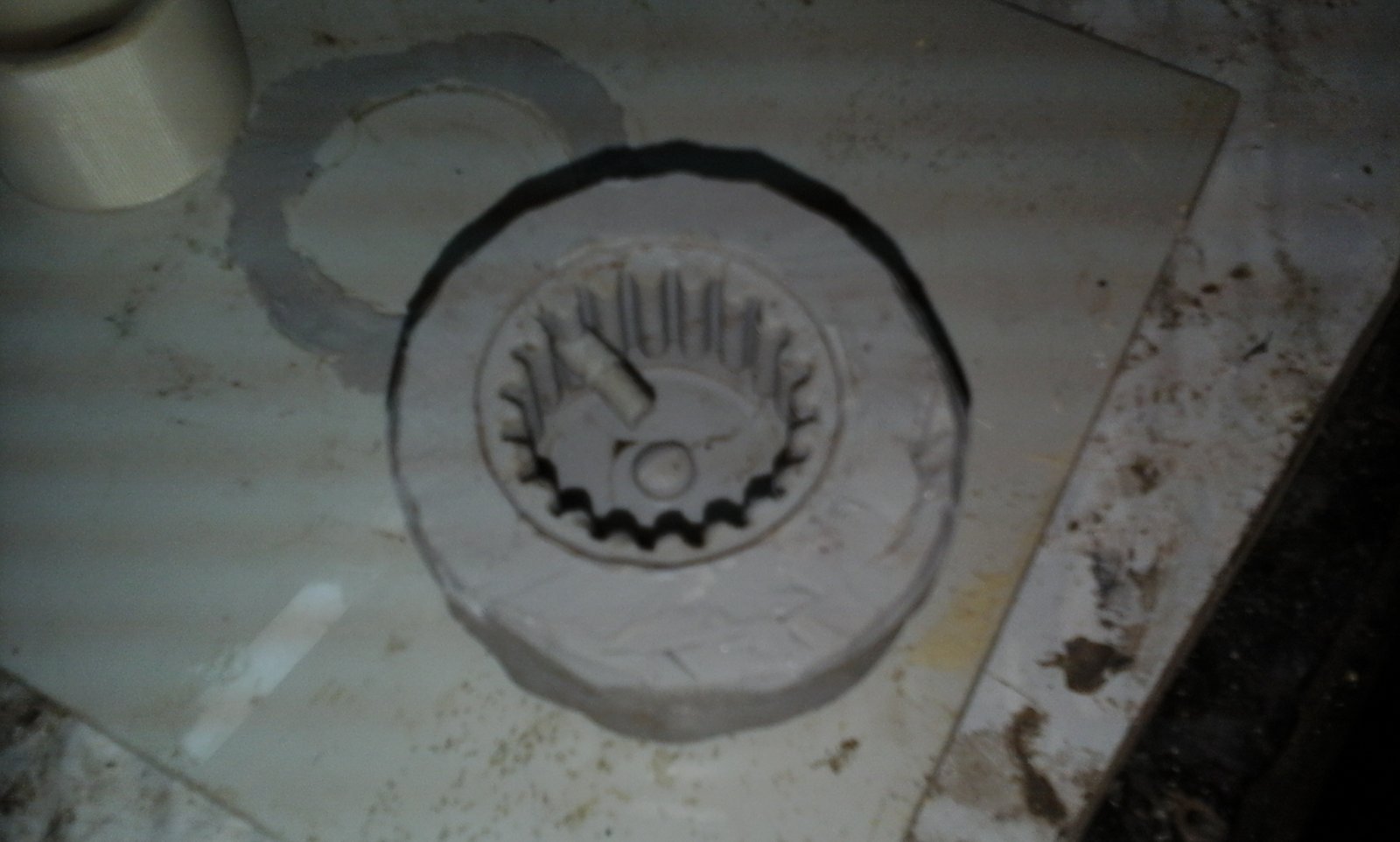

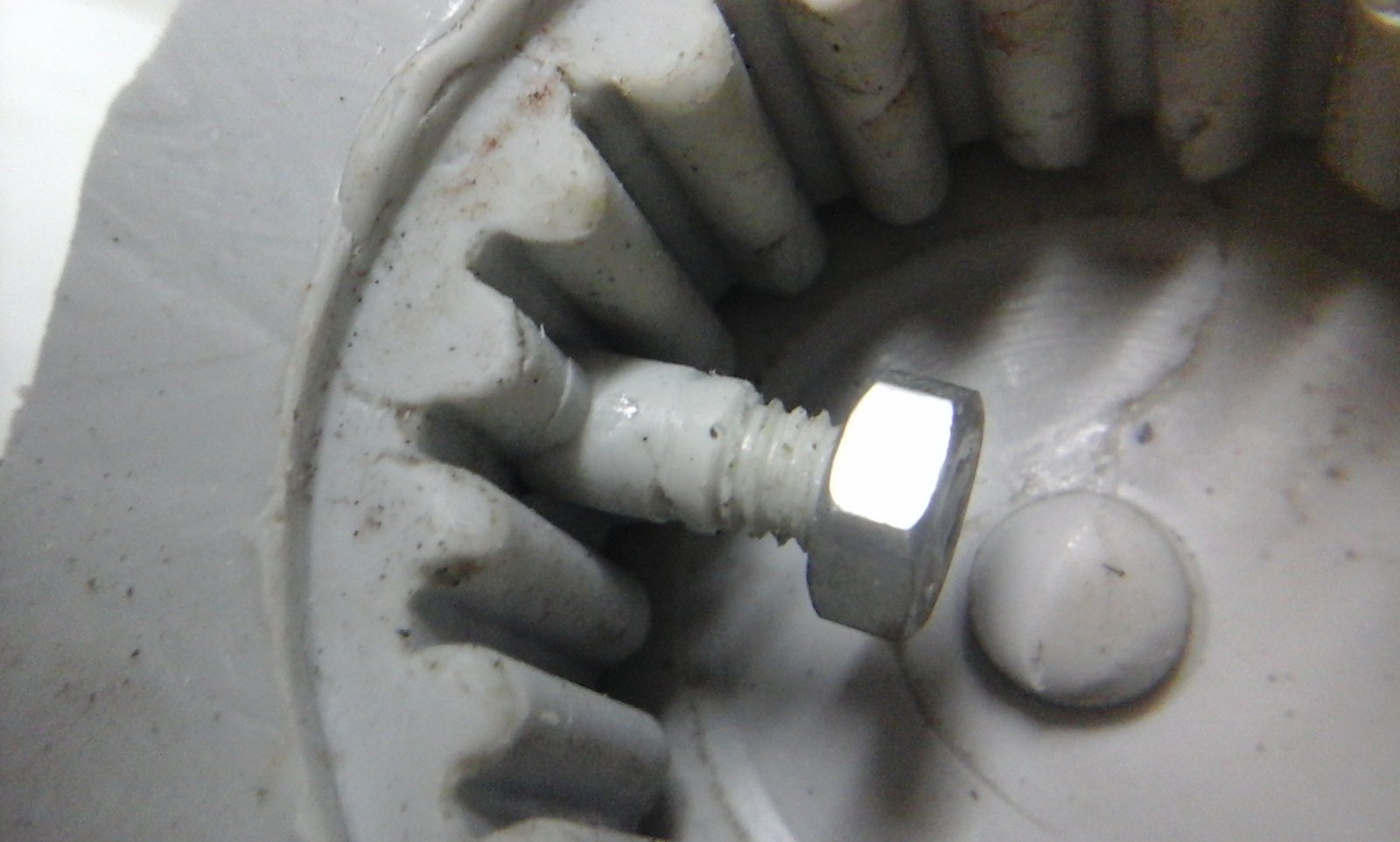

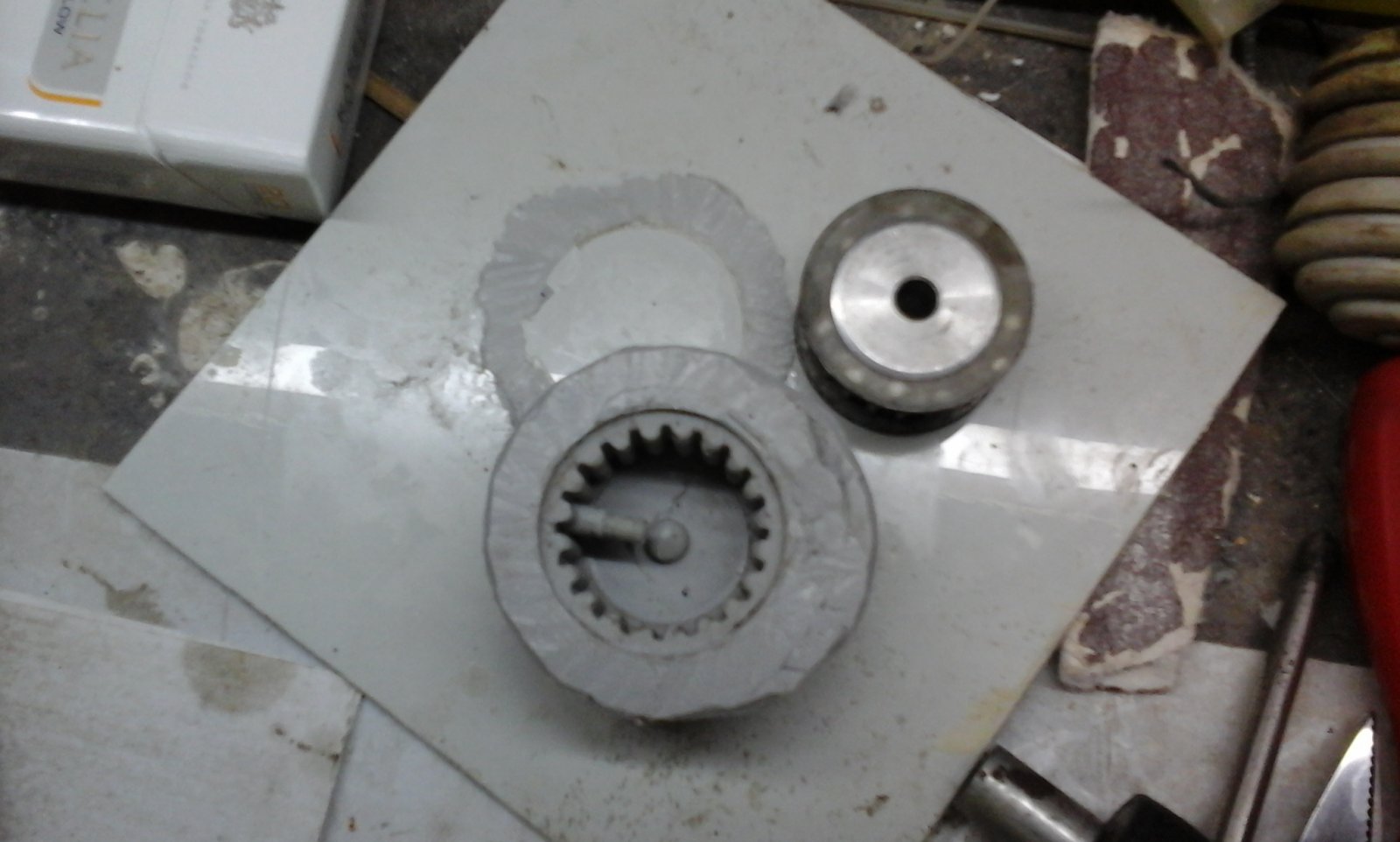

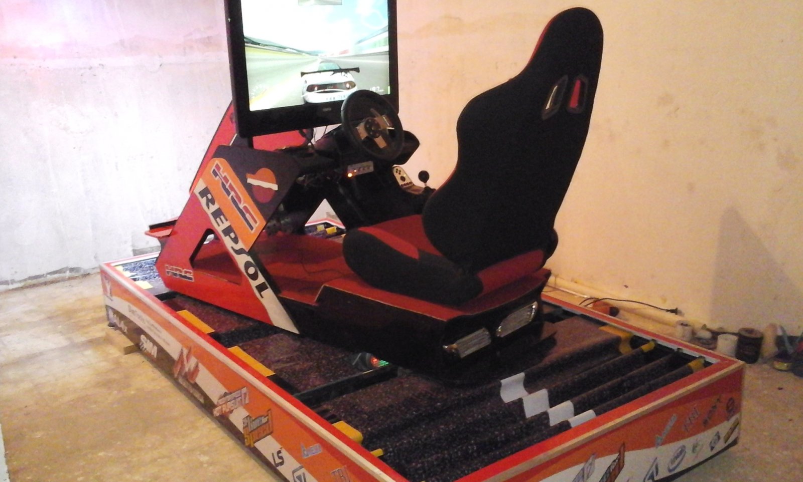

    OK ... here is how it came out and how I'm going to use a nut while casting the polyester ...
    By oiling all the internals of the mold " as a release agent " and carefully screw a clean nut to its center holder " ... the oiled silicon will later slip out of the nut and just leave it there ...
    Notice the center guide for the drill bit on the bottom ...

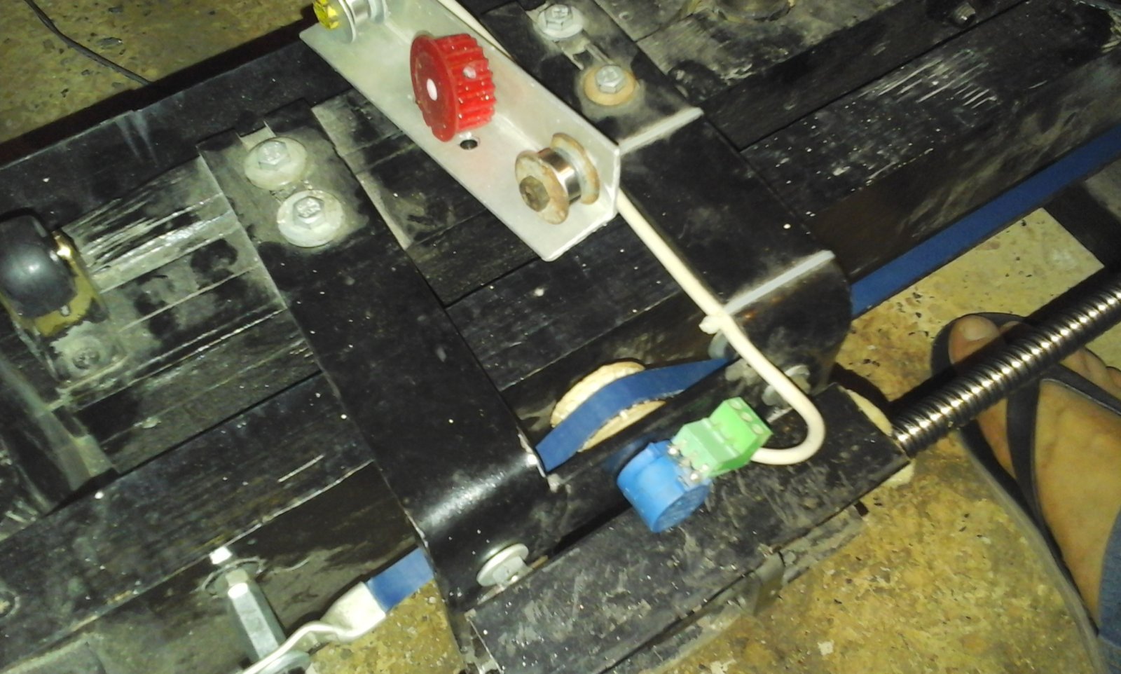

    The casted pulleys installed and the built back side is running on a 626zz bearings ...

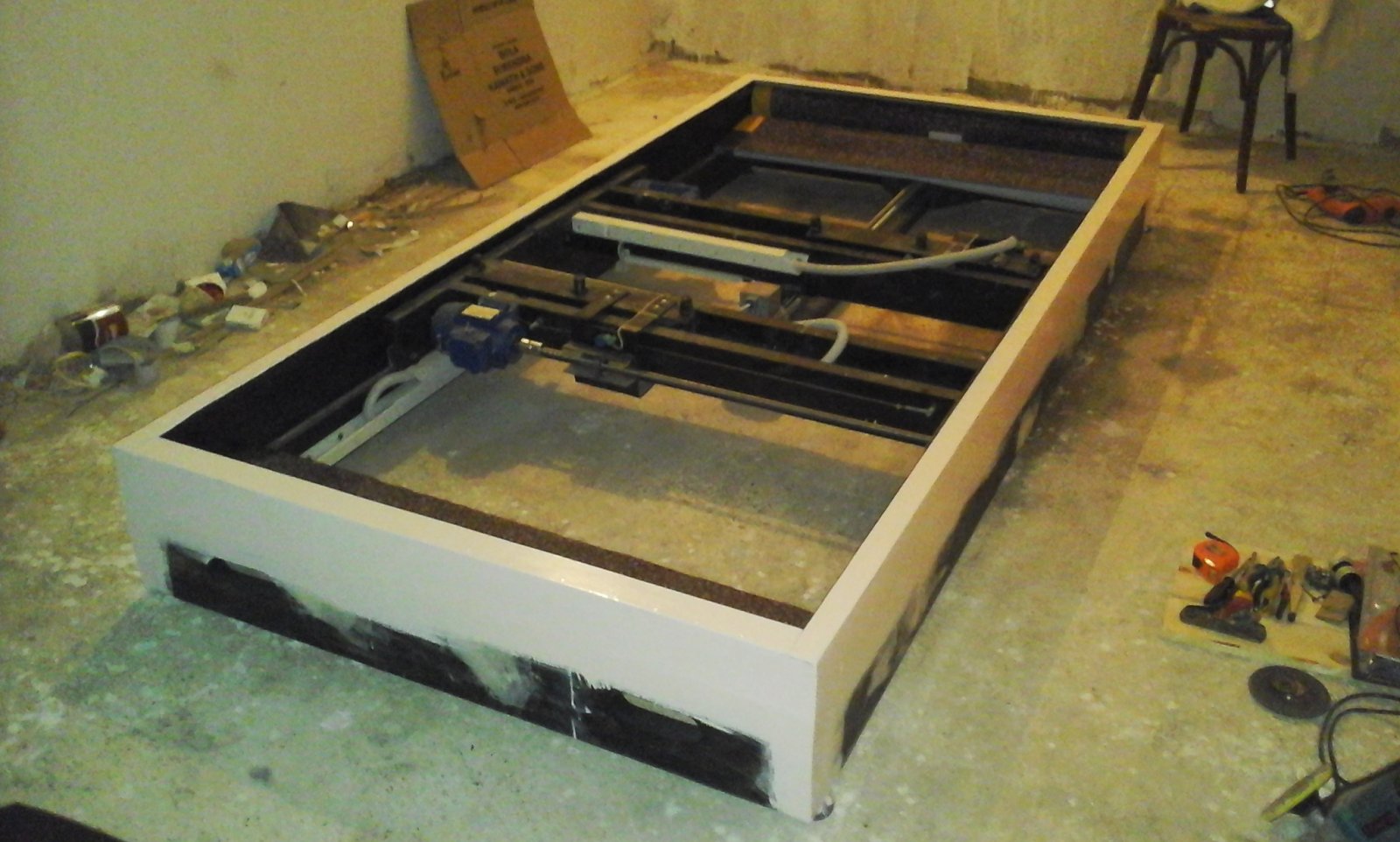

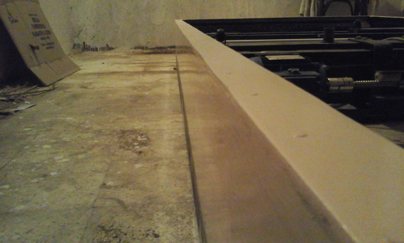

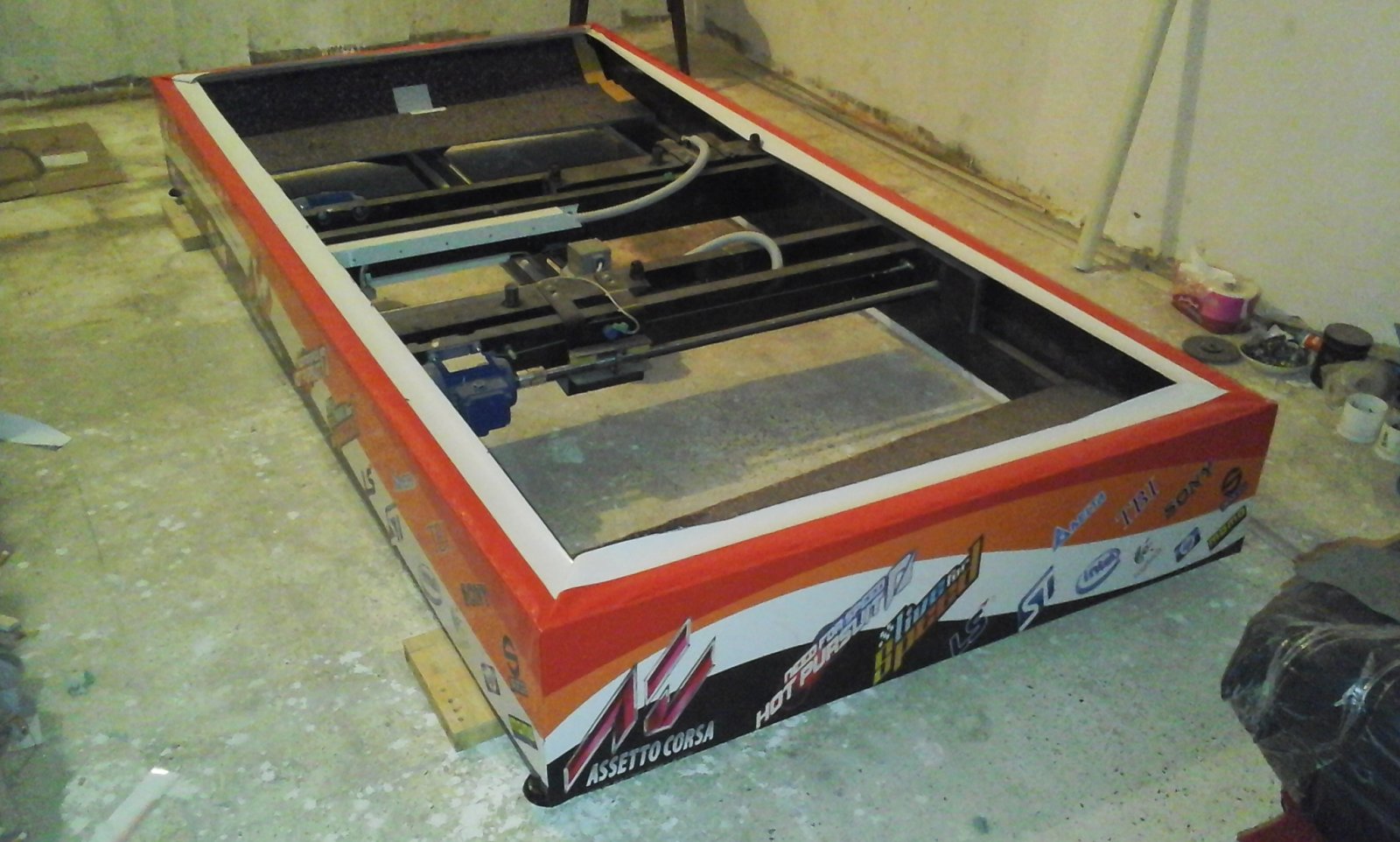

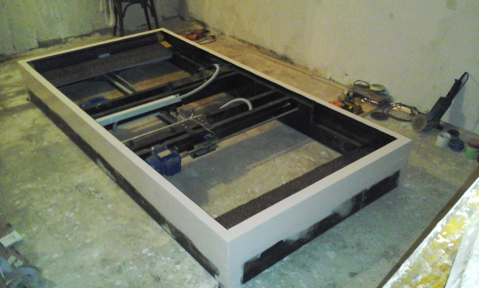

    prepared the base to receive the outfit flex cover ...

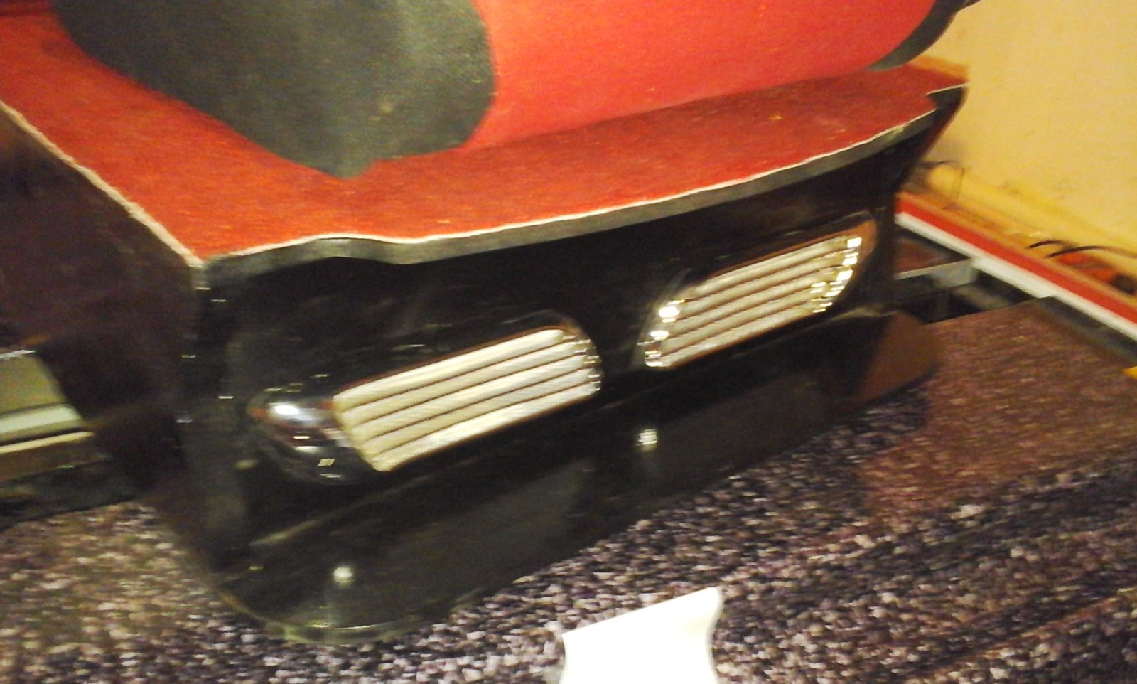

  4. speedy
    speedy Well-Known Member
    Feb 1, 2012
    1,193
    Alexandria , Egypt
    7,951Coins
    +1,288 / 10 / -0

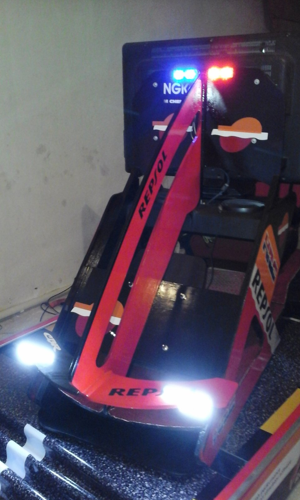

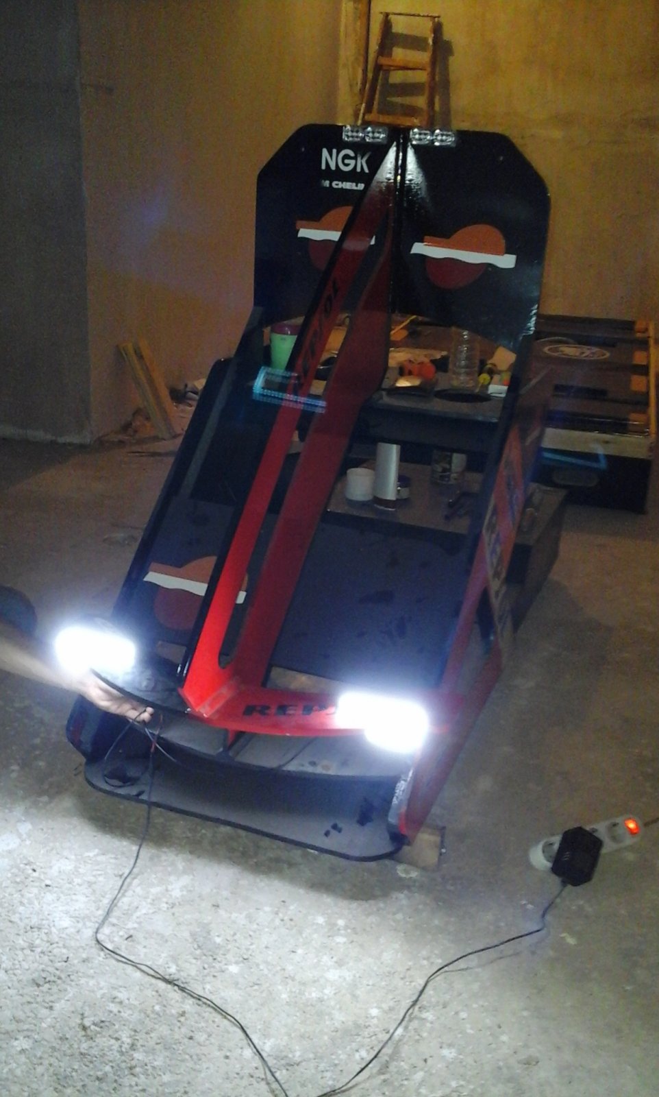

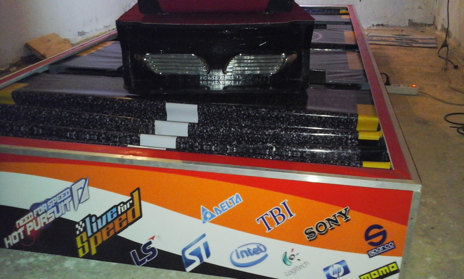

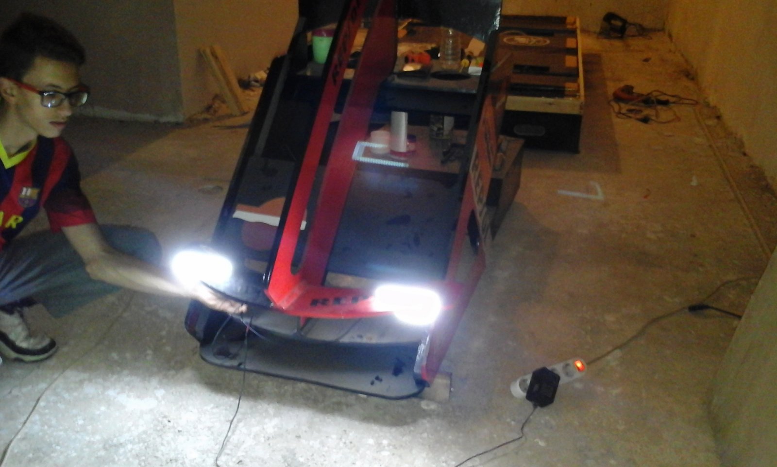

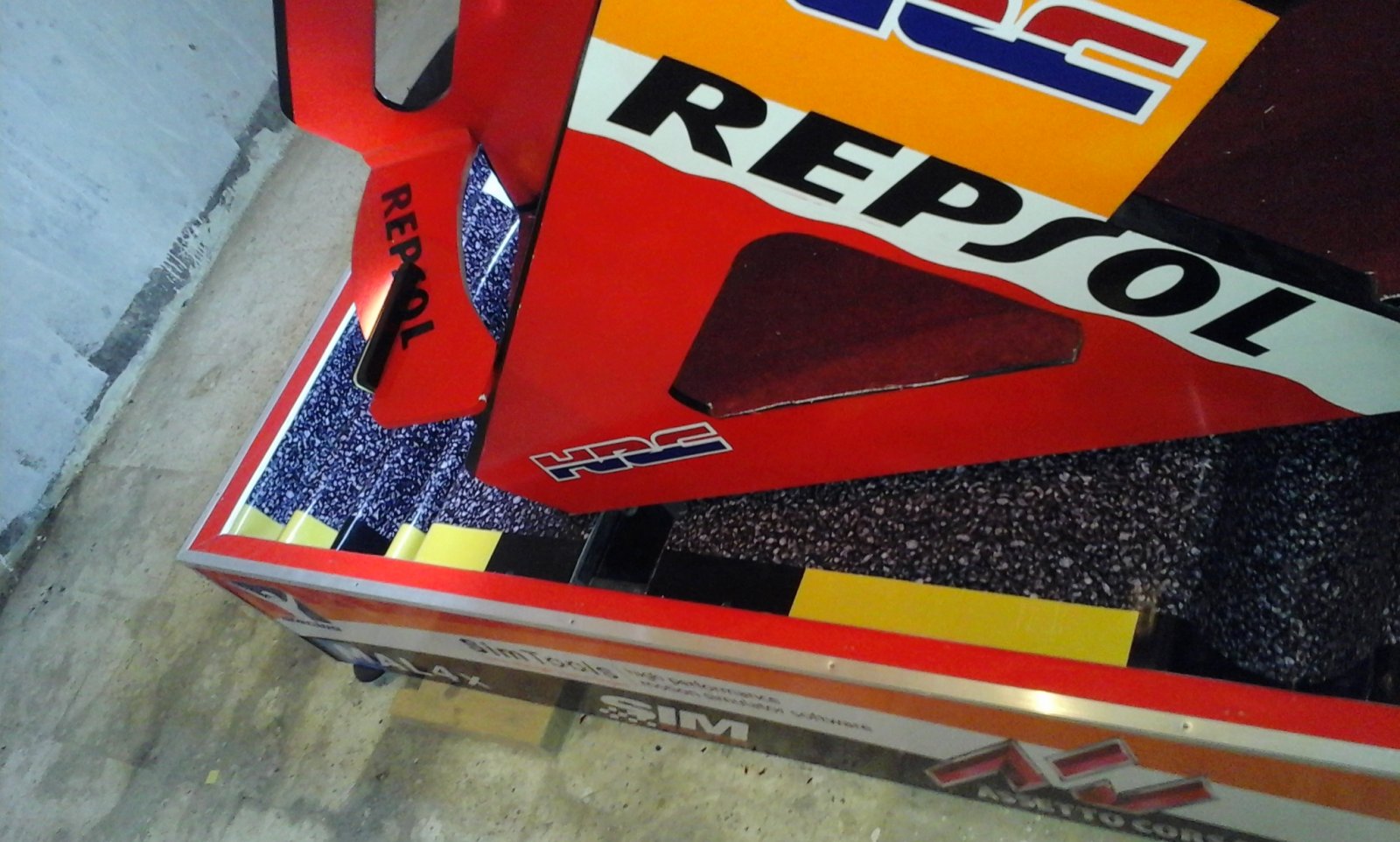

    installed the base top cover ...
    my son wanted it to have a front headlights ...

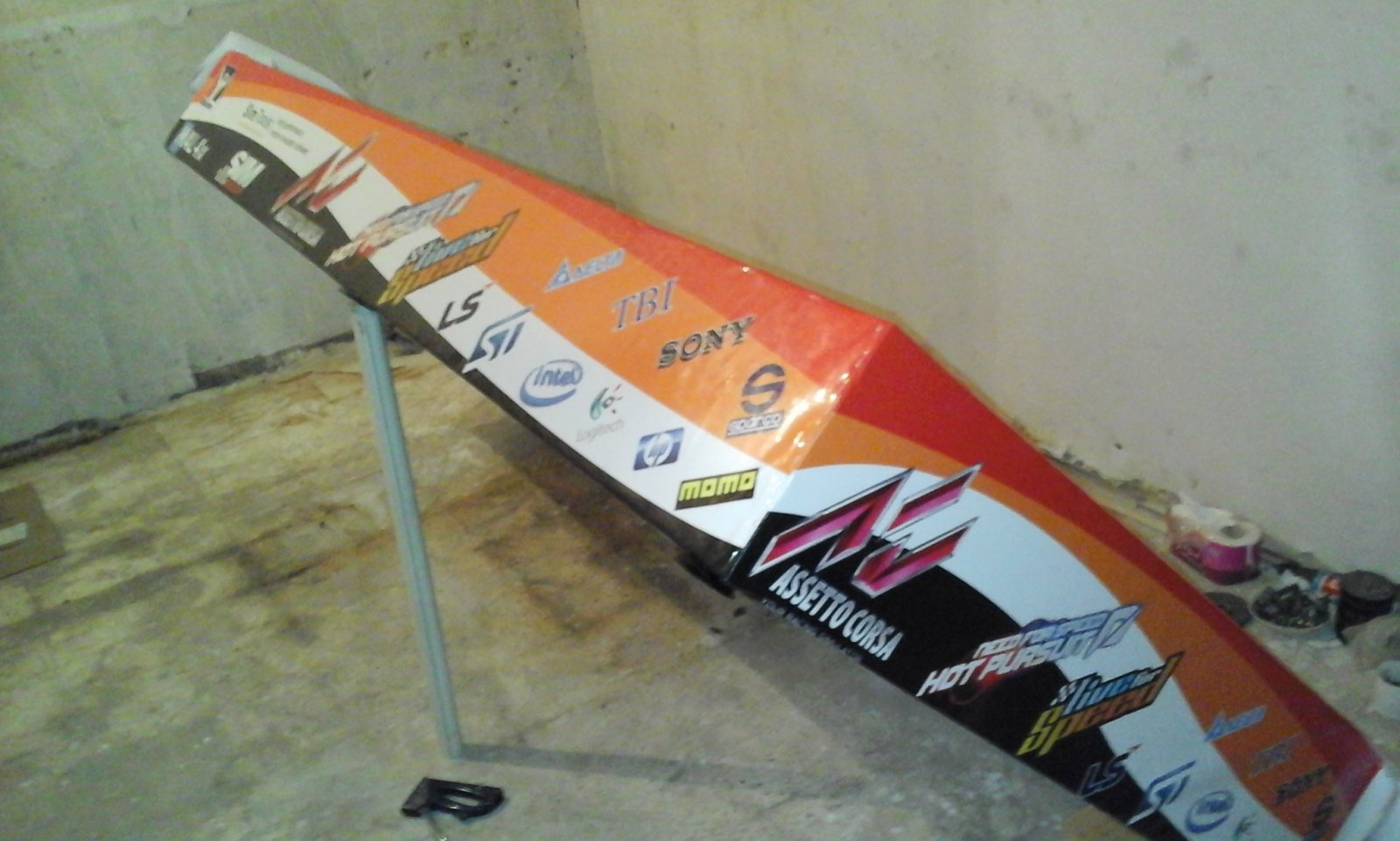

  5. speedy
    Feb 1, 2012
    1,193
    Alexandria , Egypt
    7,951Coins
    +1,288 / 10 / -0

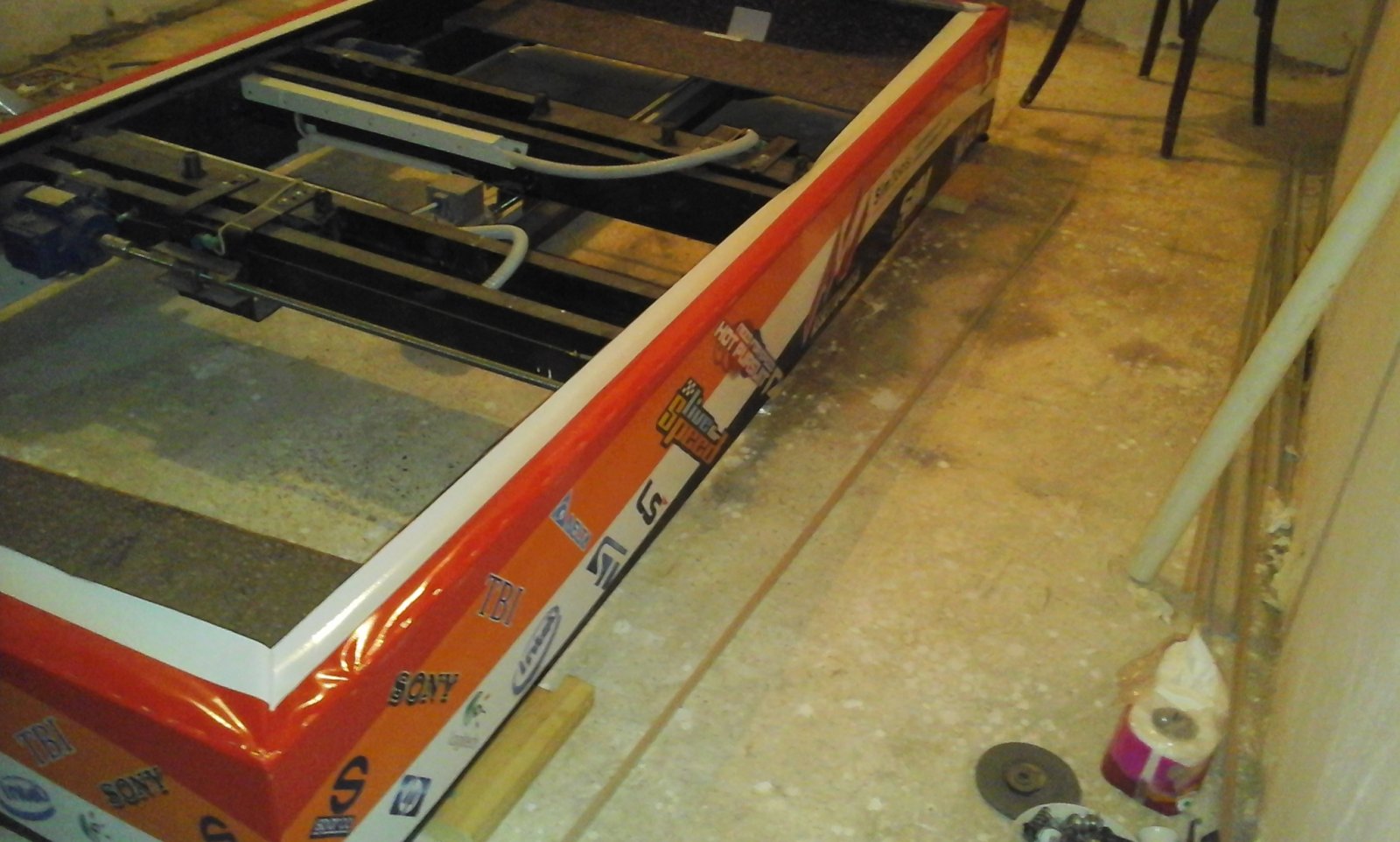

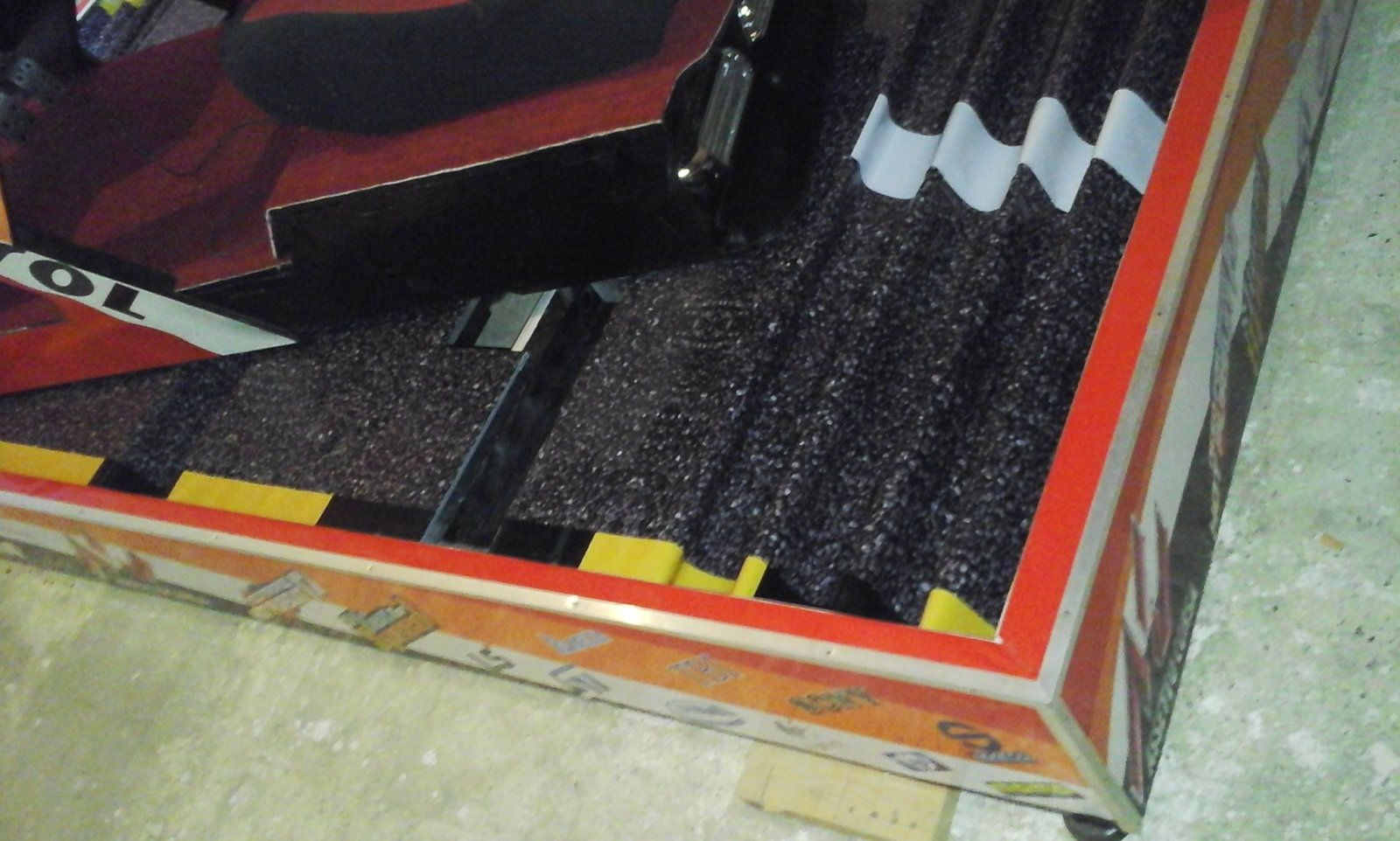

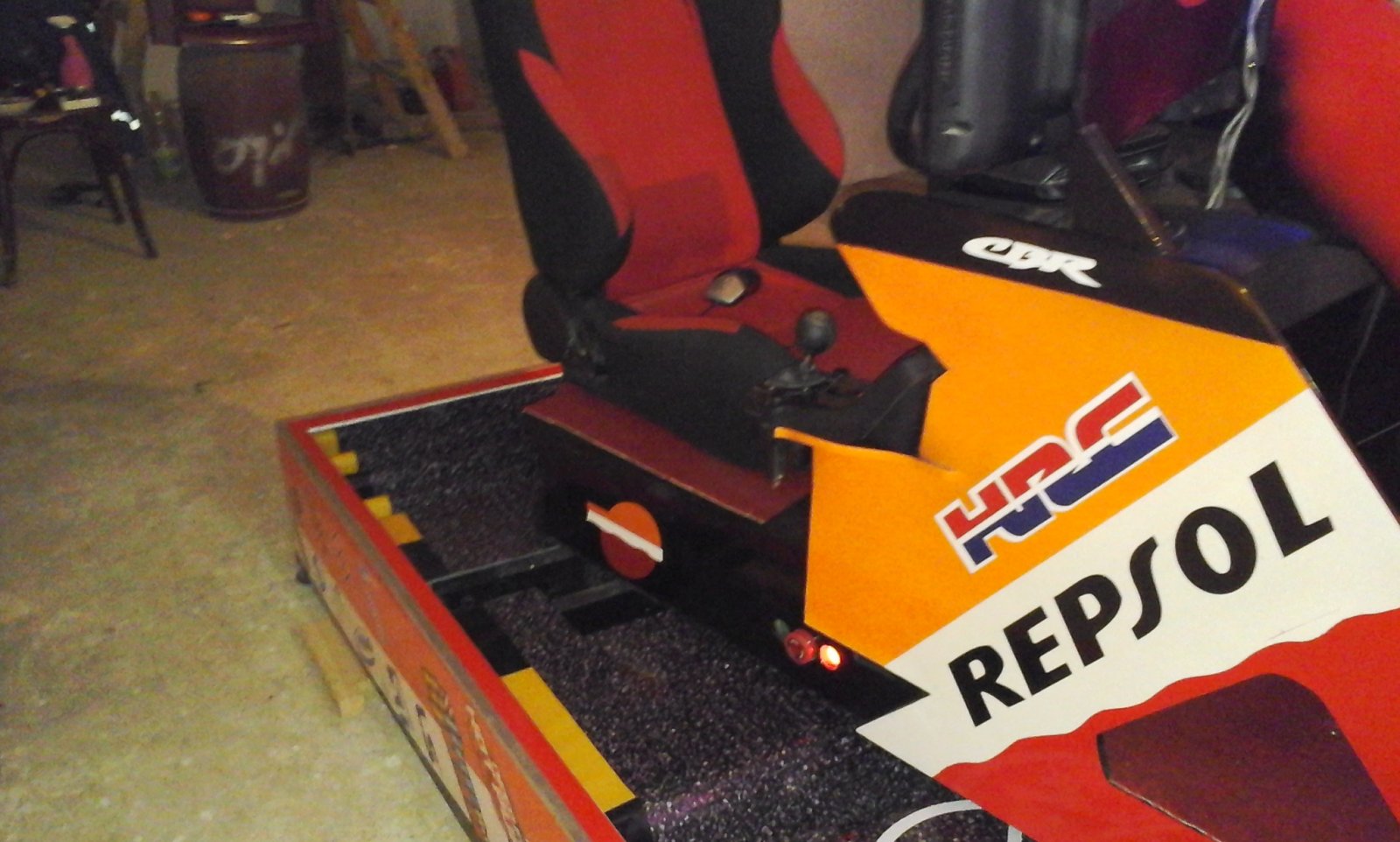

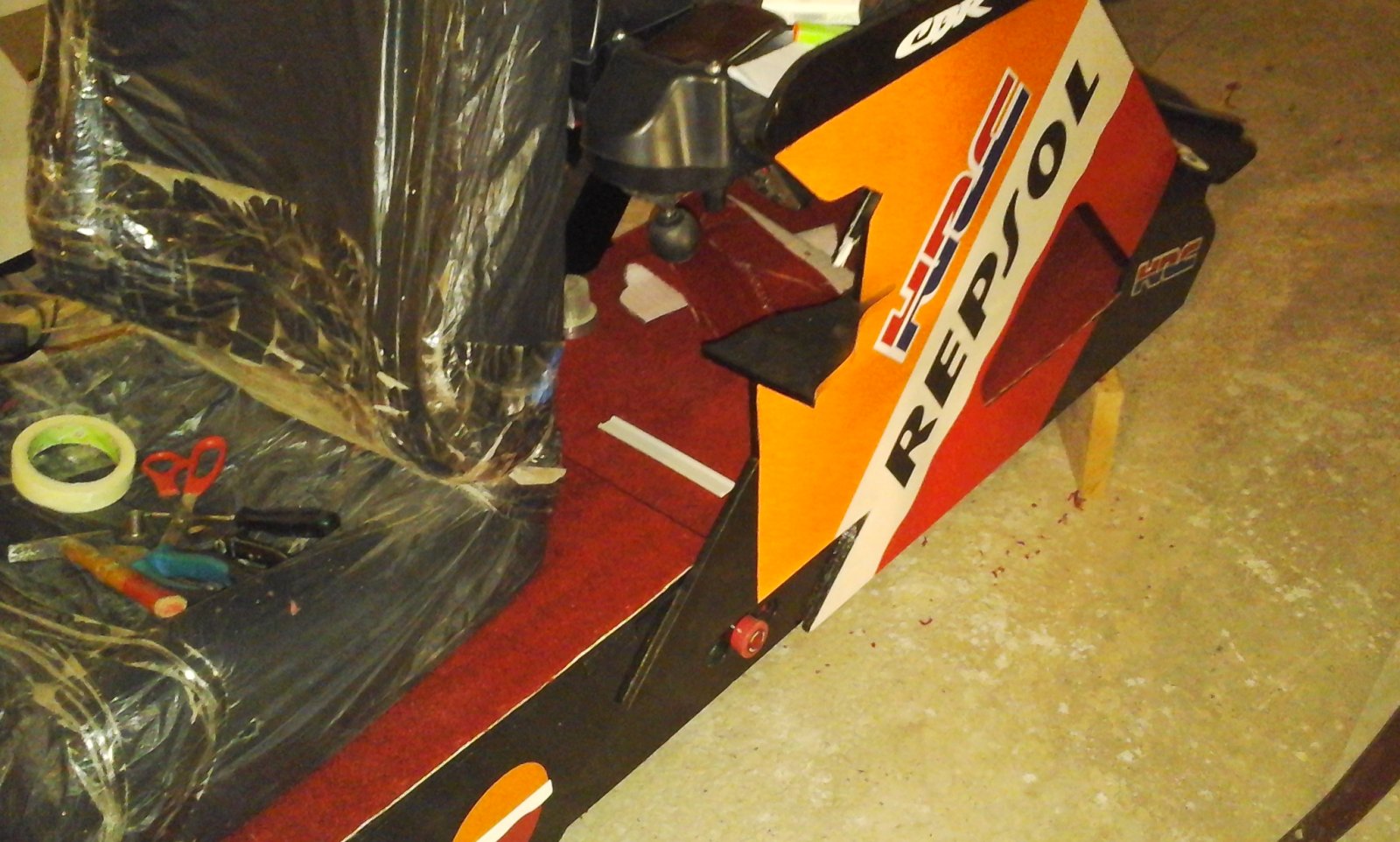

    base logos has arrived and installed ..
    • Like Like x 5
  6. speedy
    Feb 1, 2012
    1,193
    Alexandria , Egypt
    7,951Coins
    +1,288 / 10 / -0

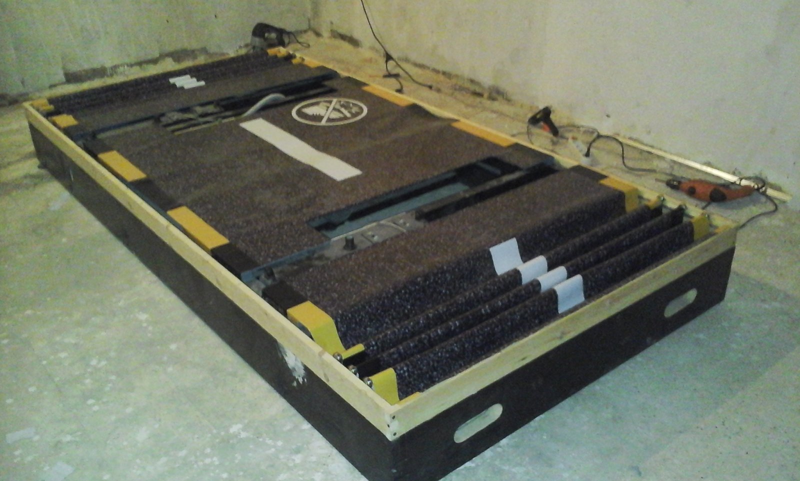

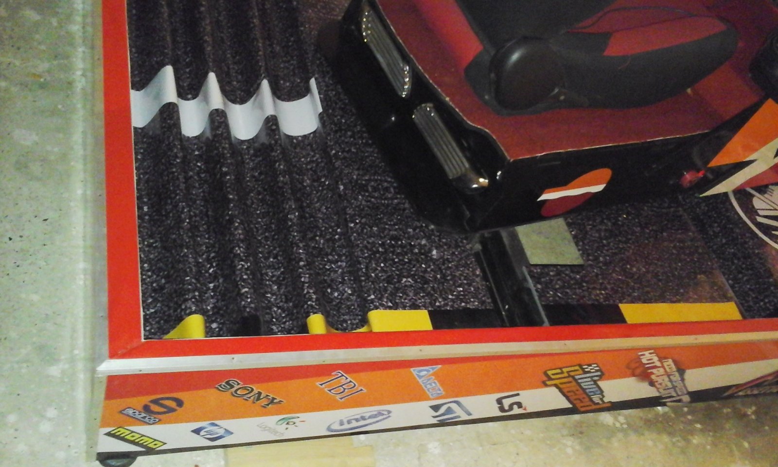

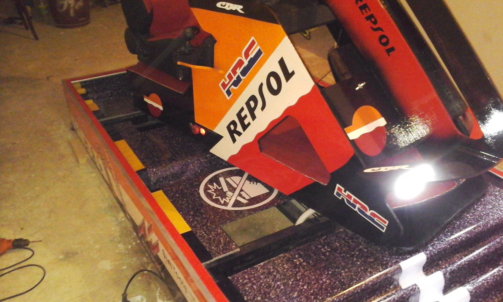

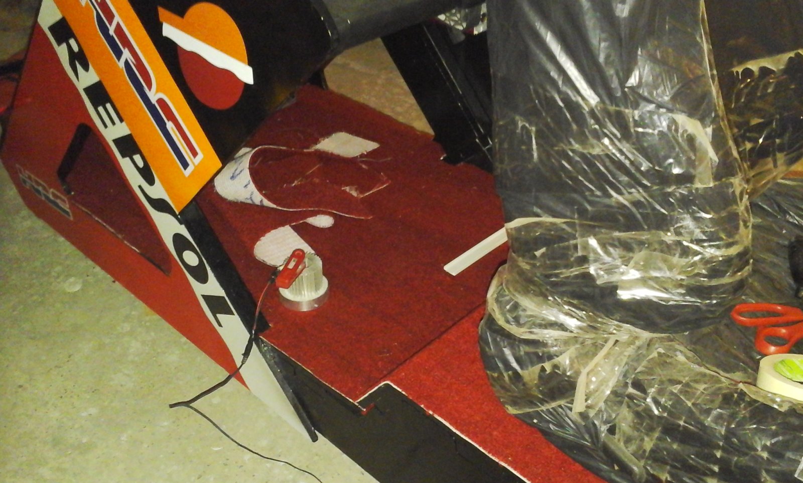

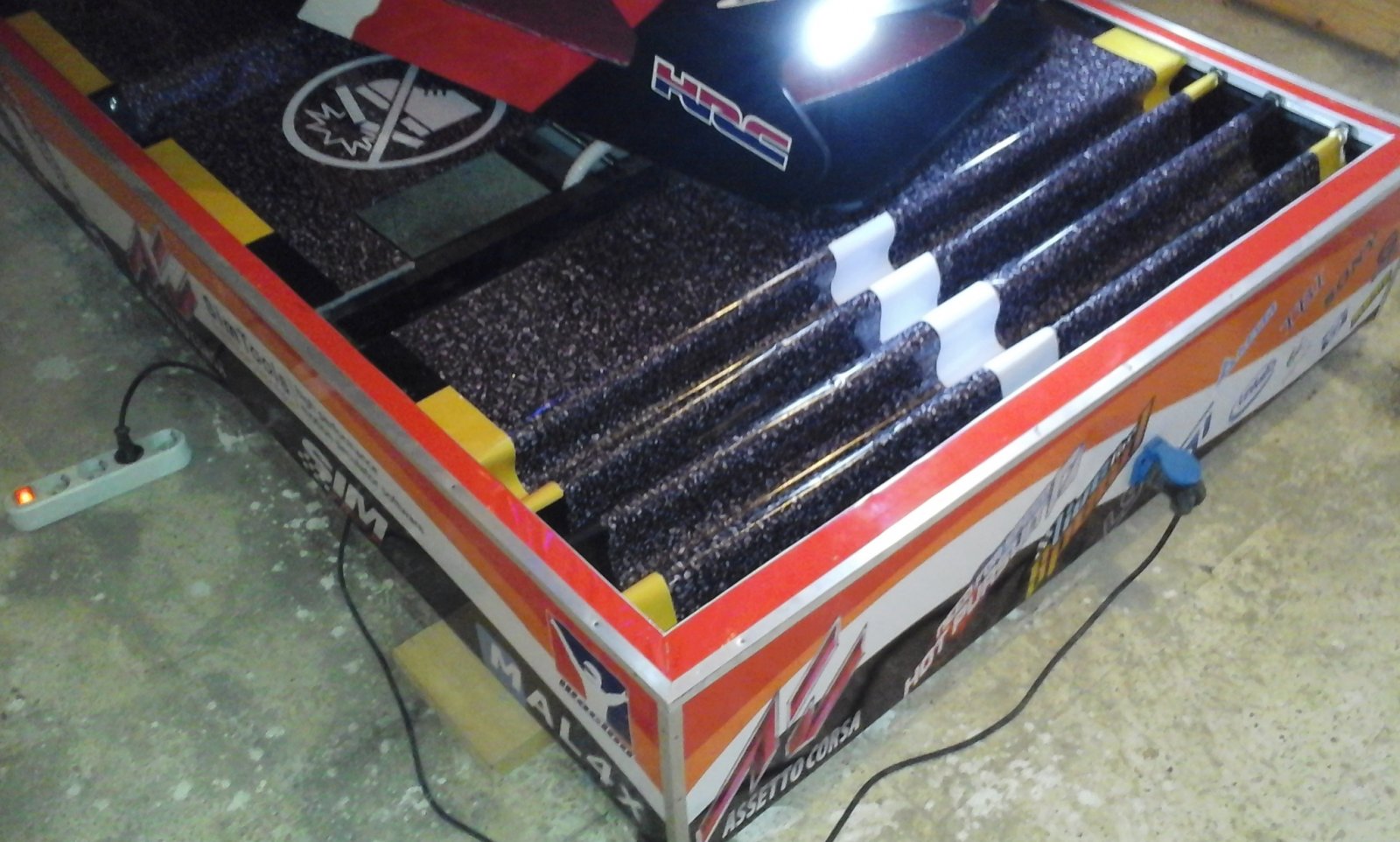

    carpet flooring installed ...
    • Like Like x 5

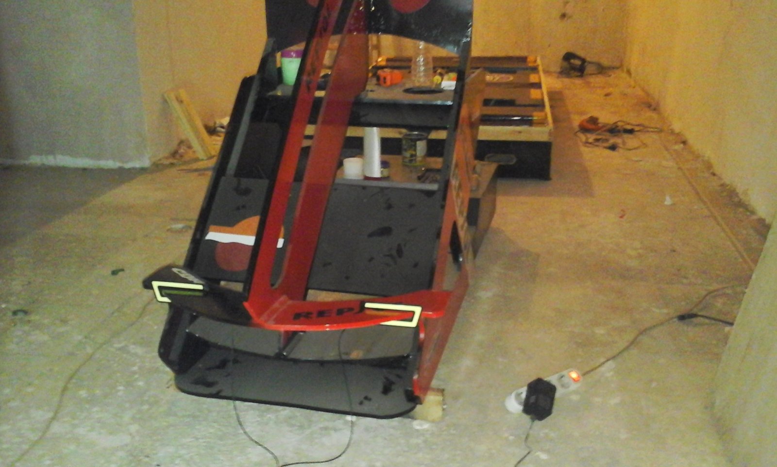

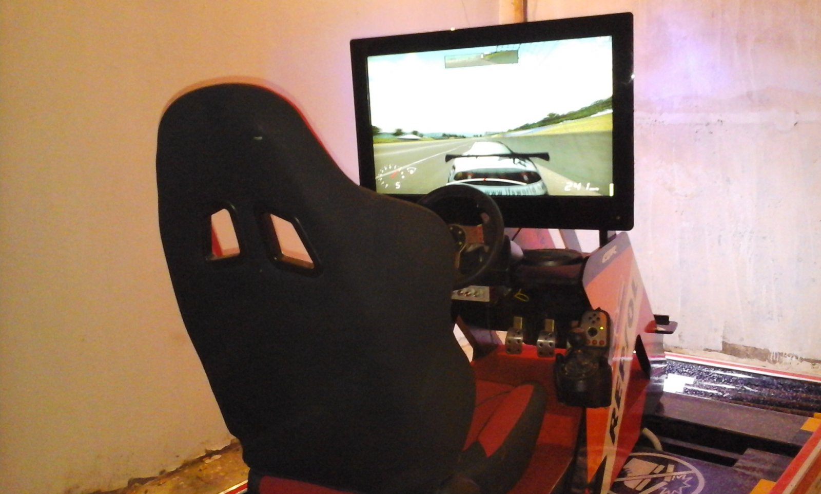

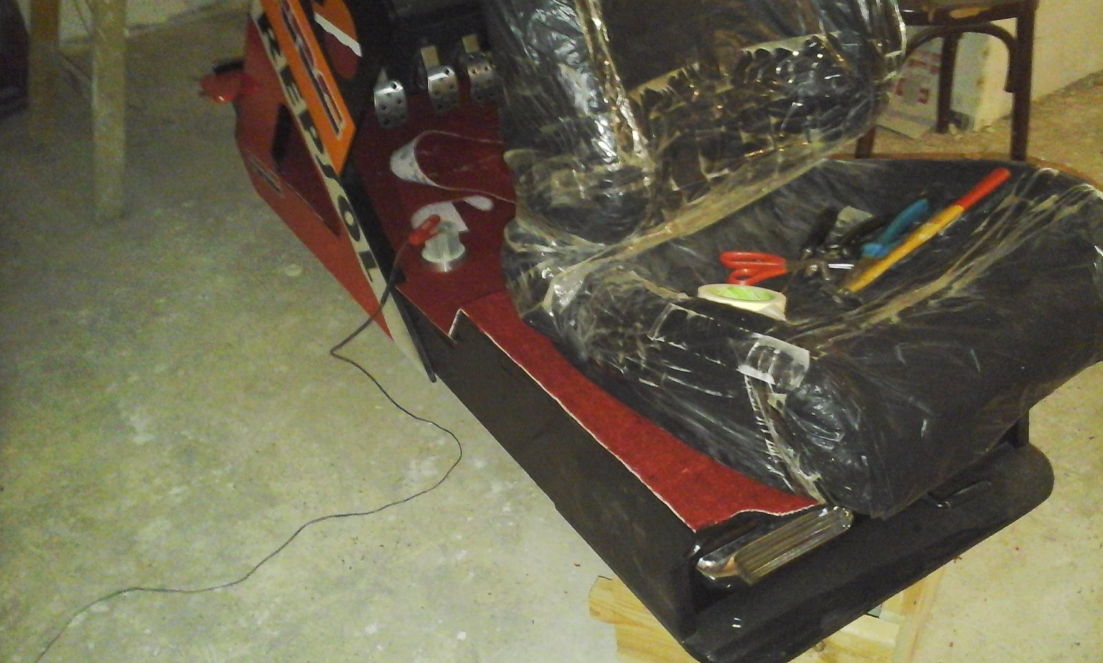

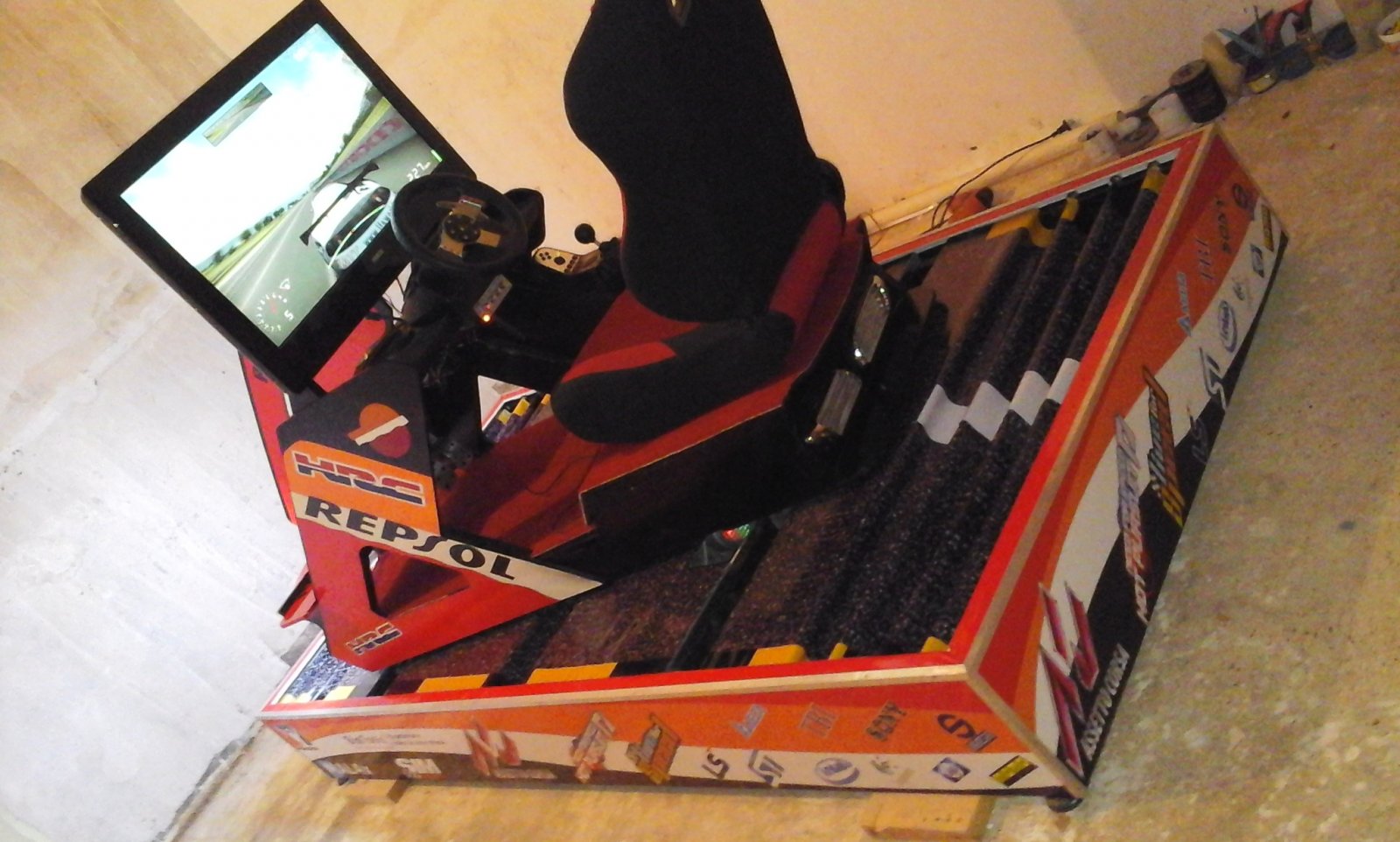

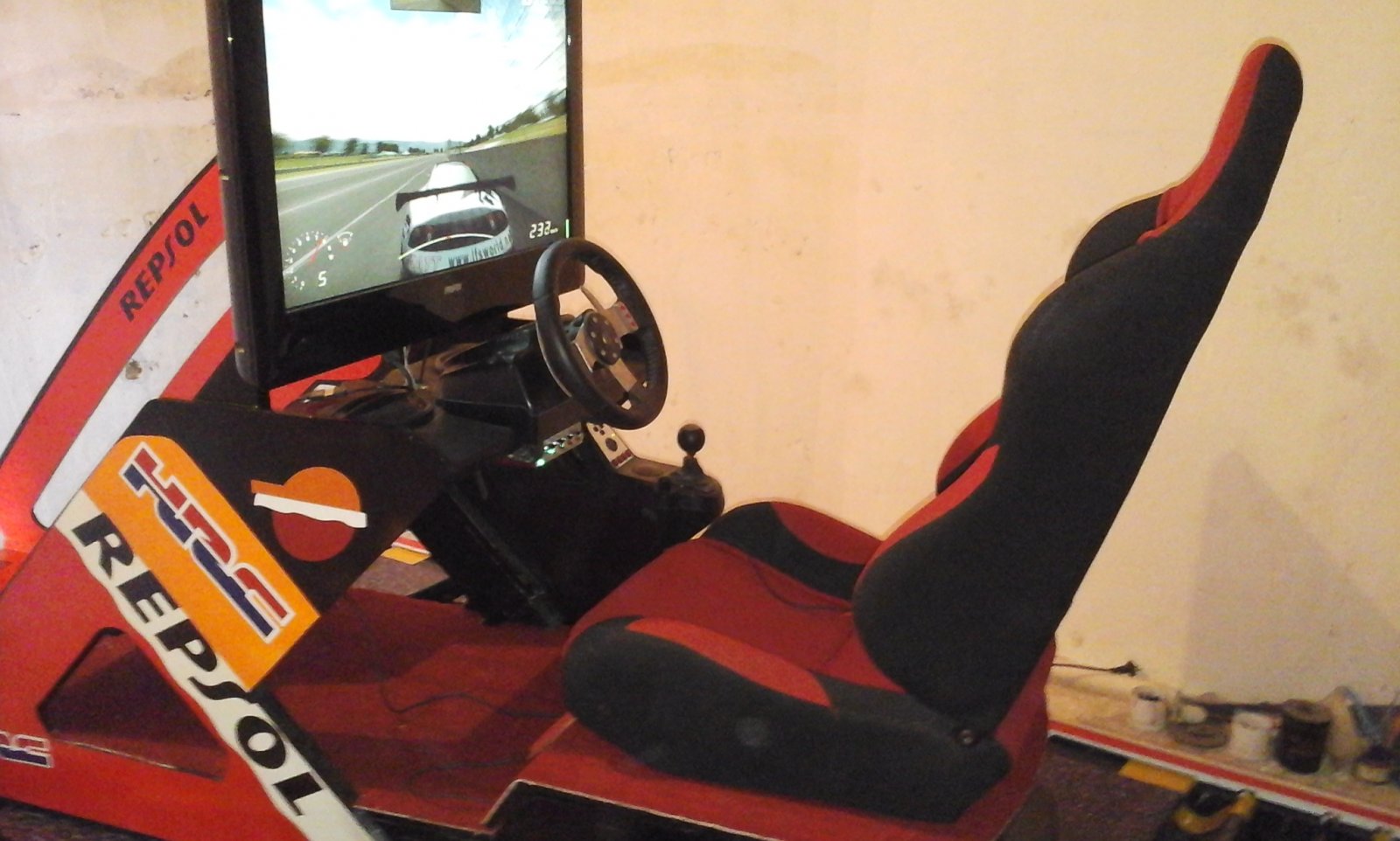

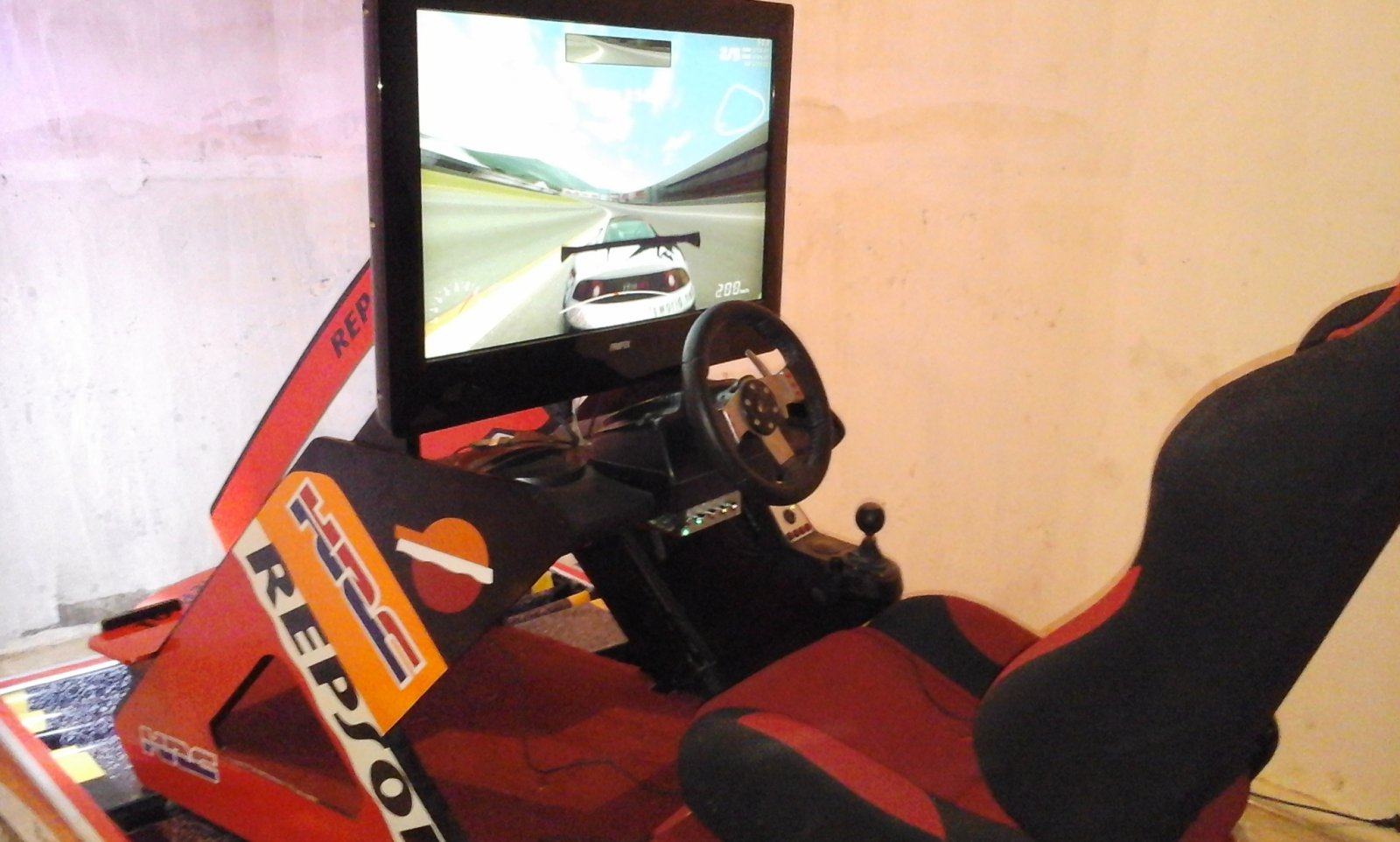

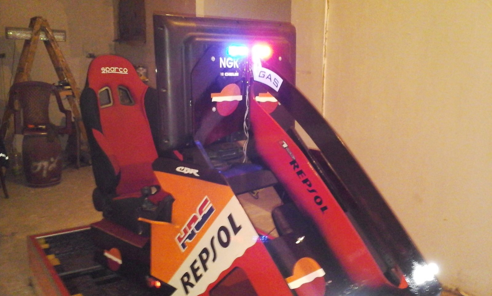

    leather dashboard and speakers ...
    exhaust computer cooling fans decoration ...
    enjoy these photos too ...
    • Like Like x 5

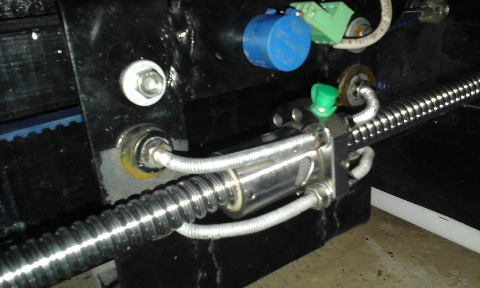

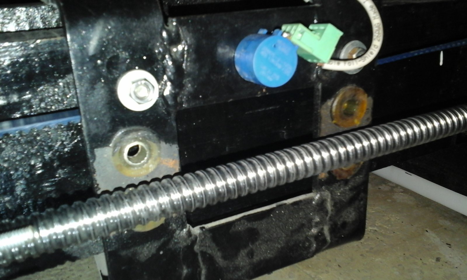

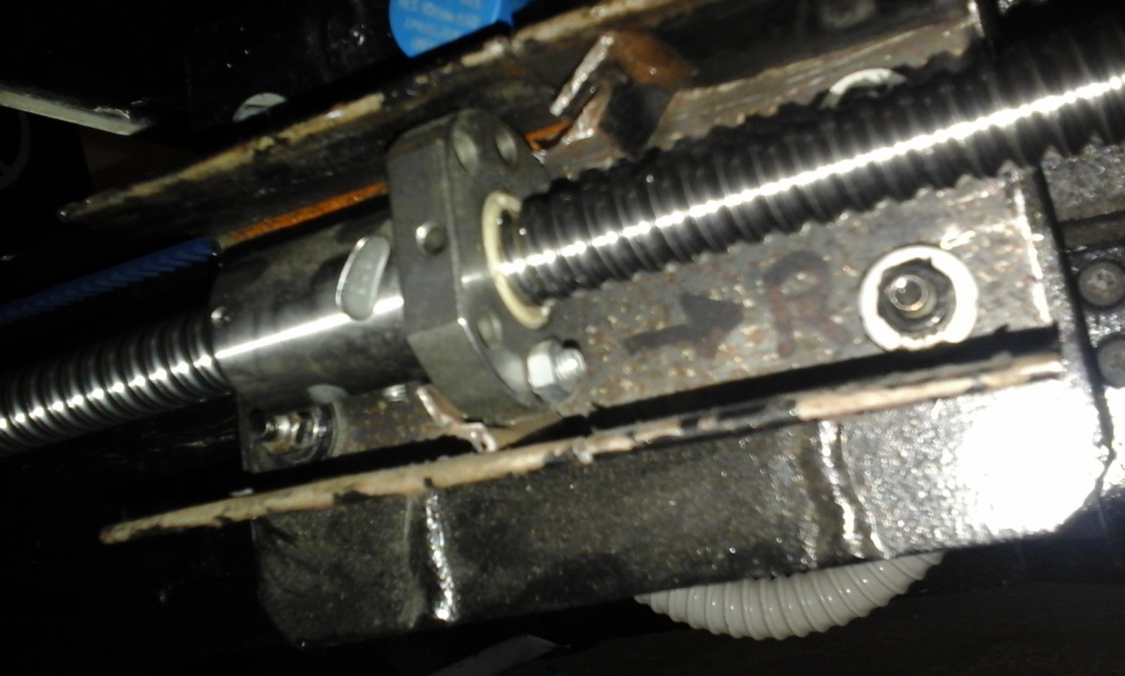

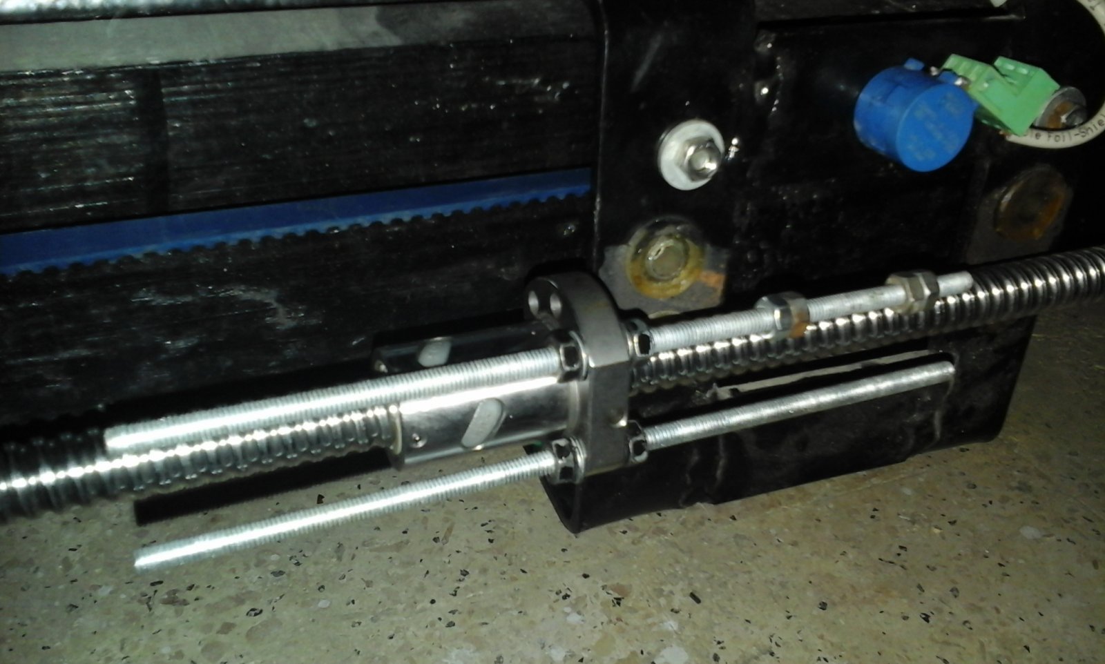

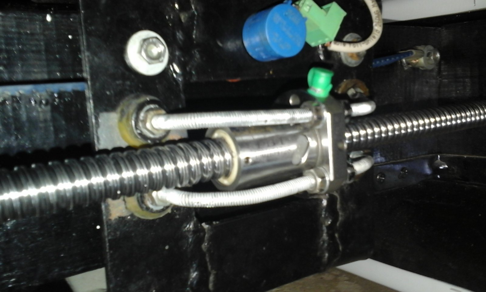

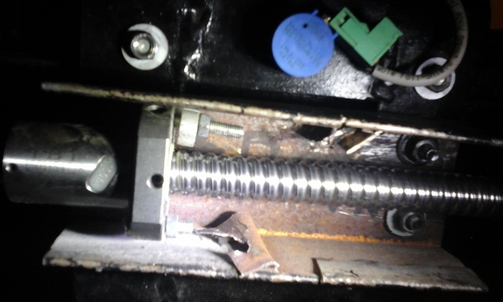

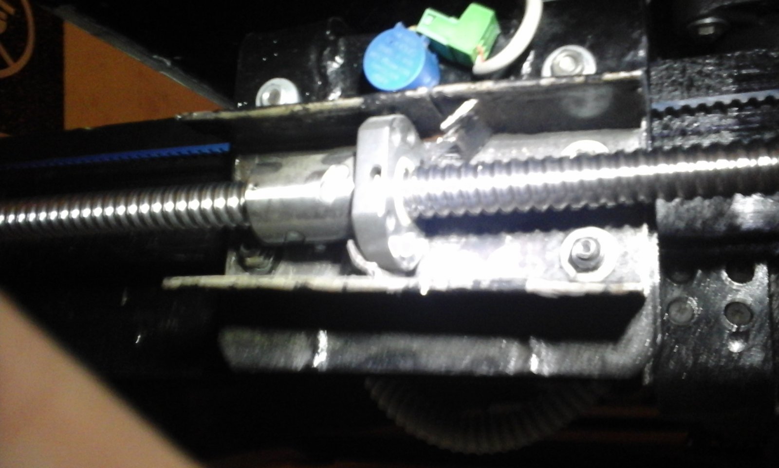

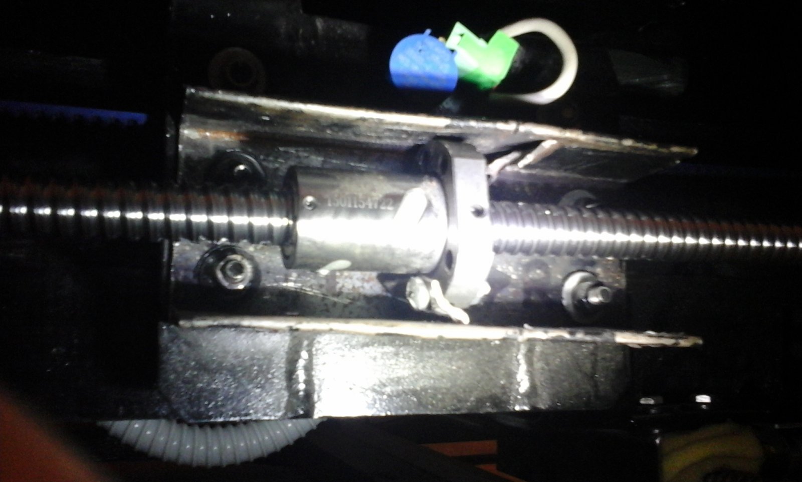

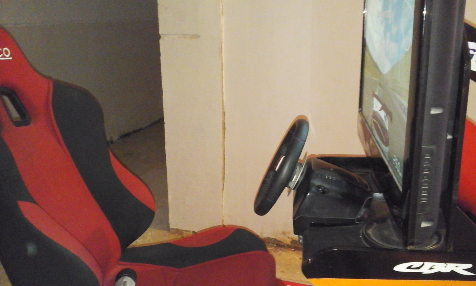

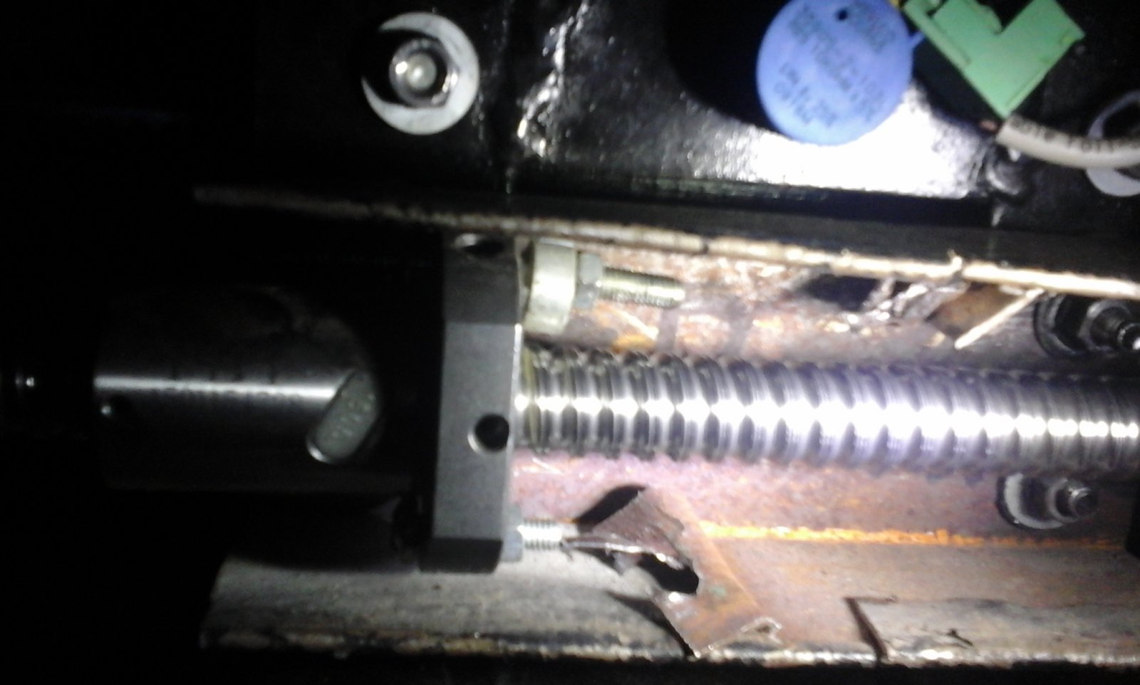

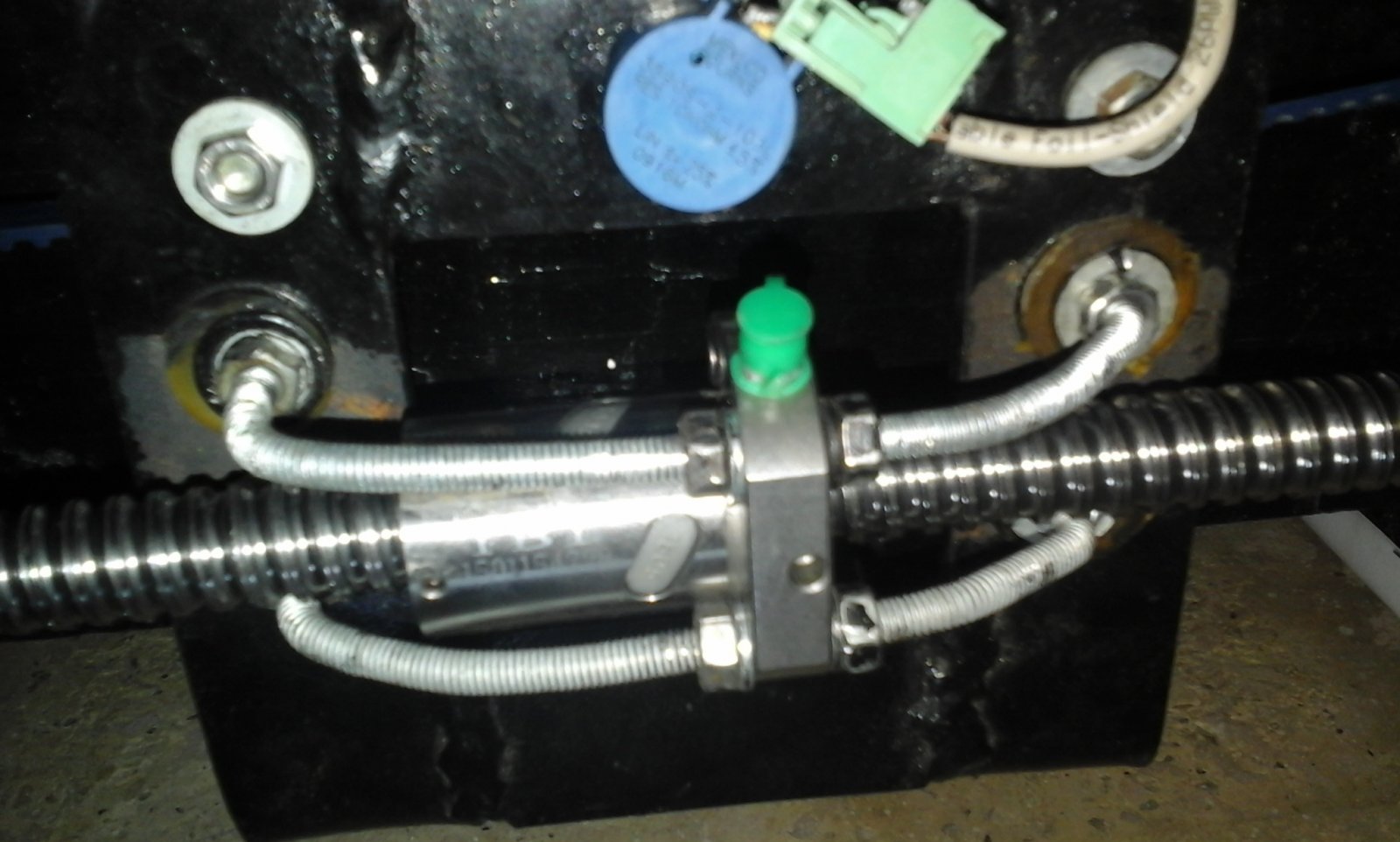

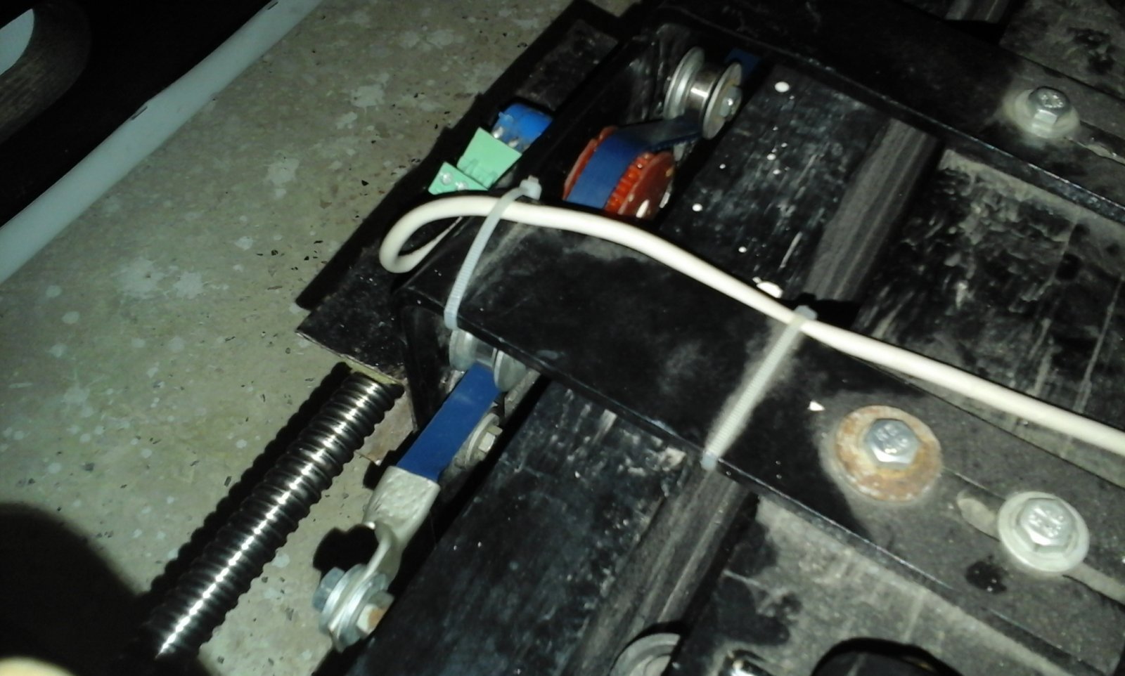

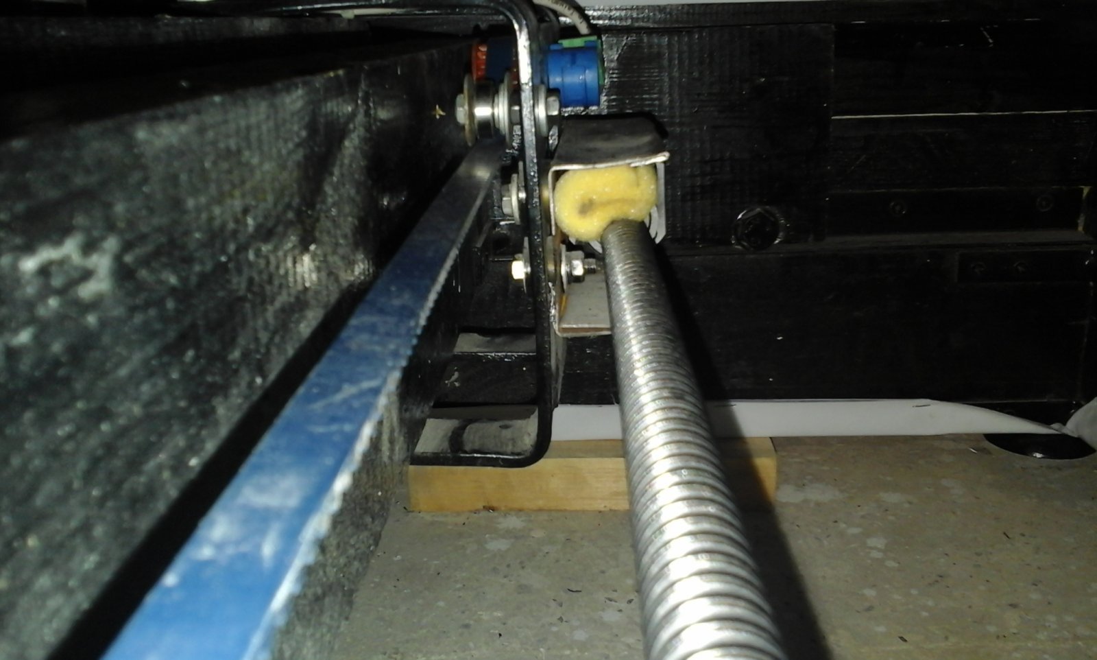

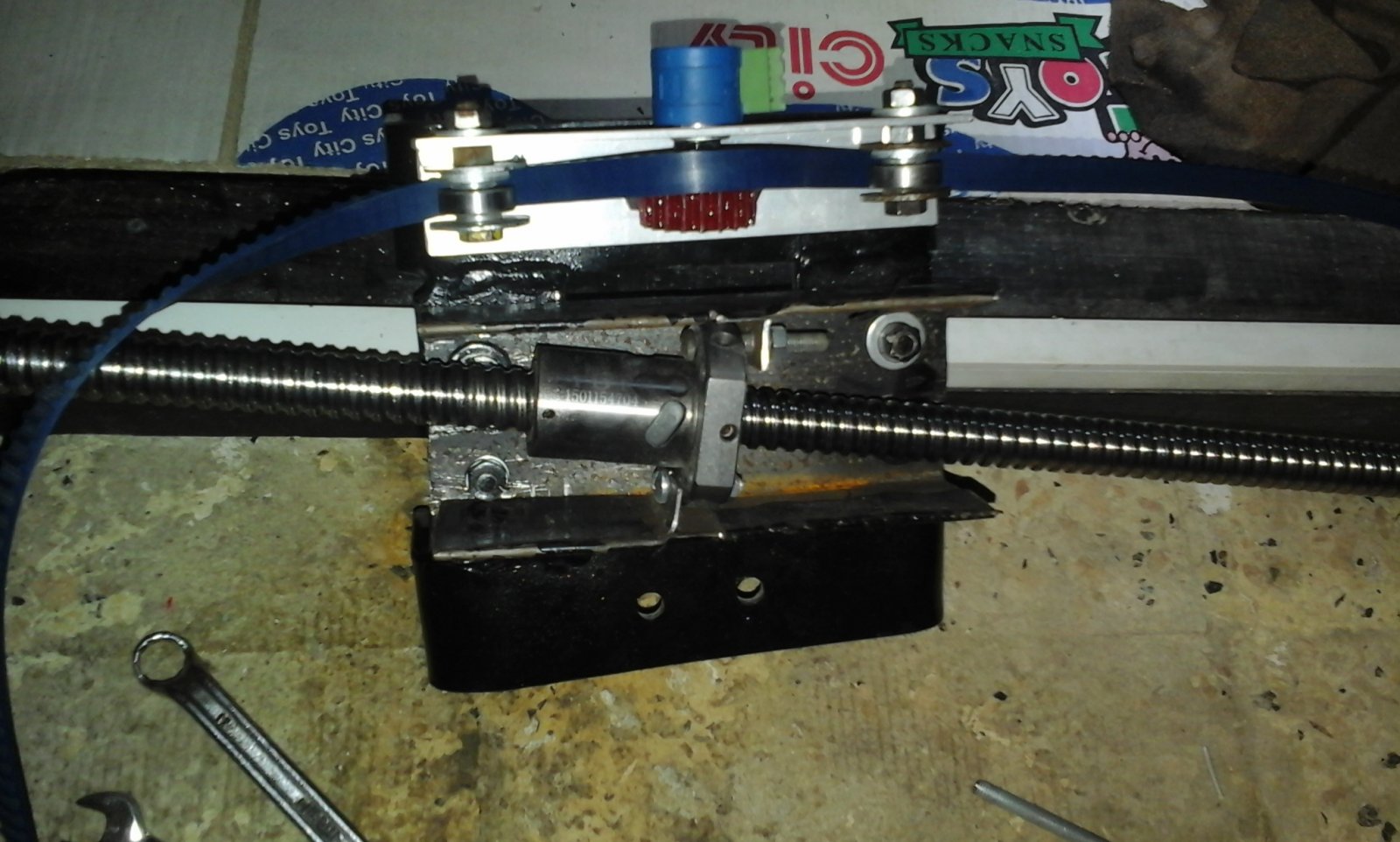

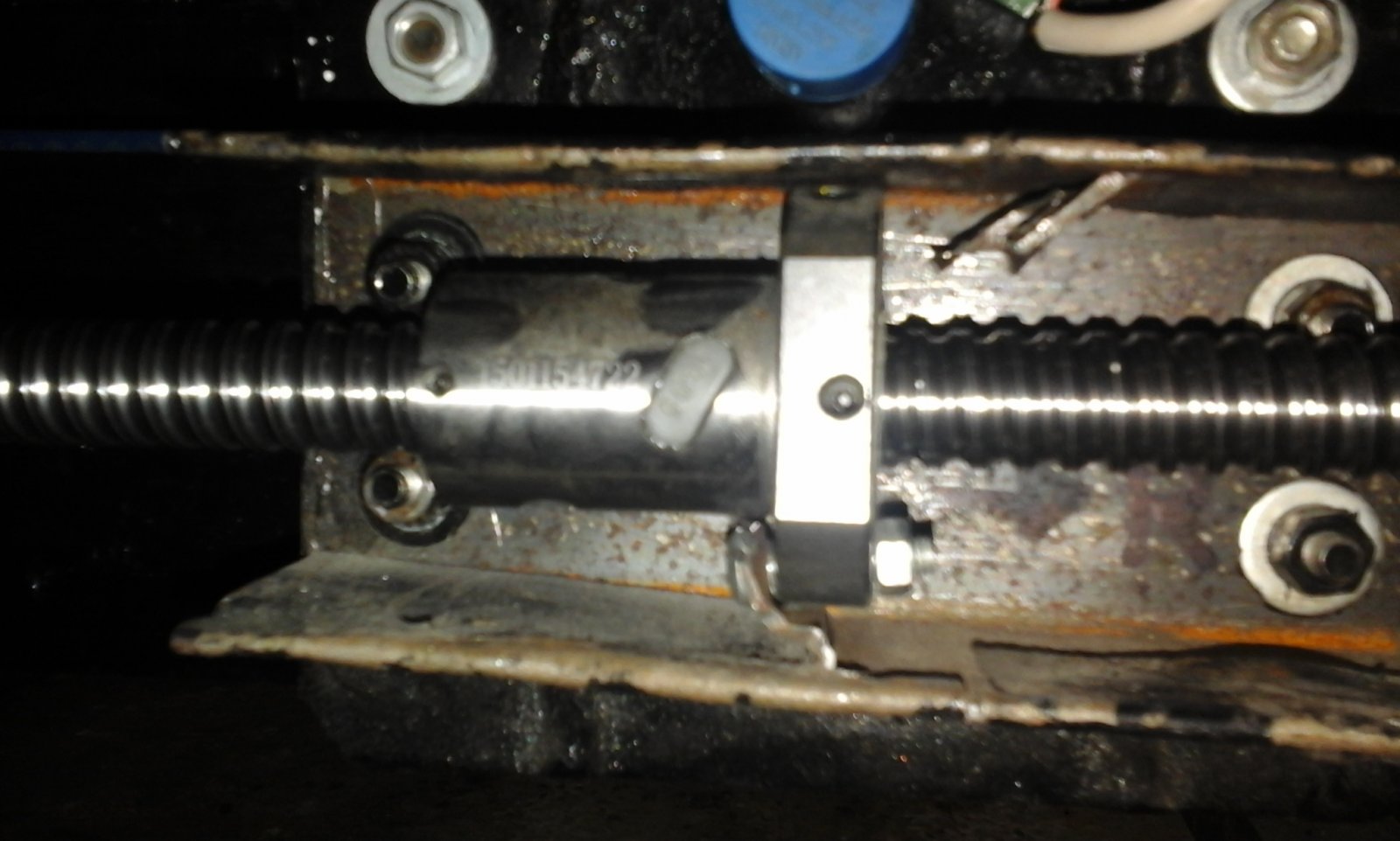

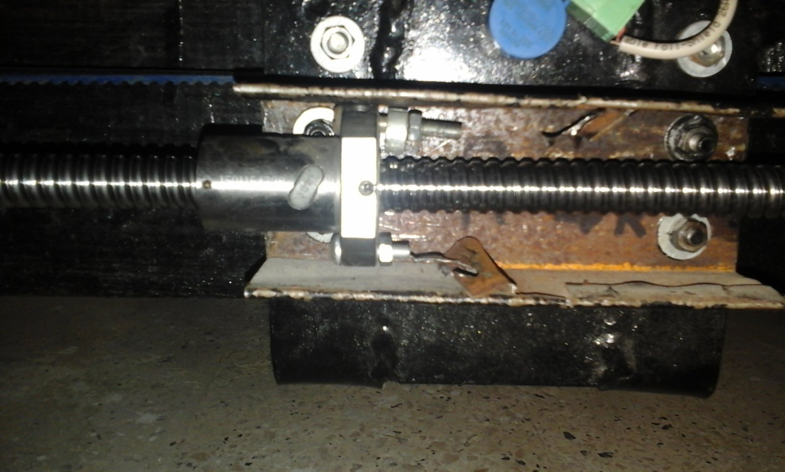

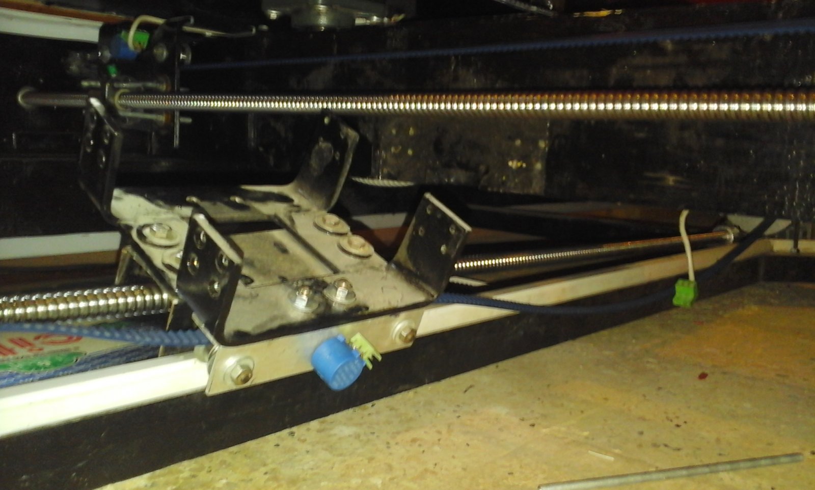

    And when I just wanted to shoot a video ... I hit the wall and the ball screw came out of it's mounting bracket ... :confused: .
    20160704_070435.jpg 20160704_070503.jpg 20160704_070717.jpg 20160704_070757.jpg 20160704_070512.jpg 20160704_070818.jpg 20160704_070956.jpg 20160704_070939.jpg 20160704_070848.jpg

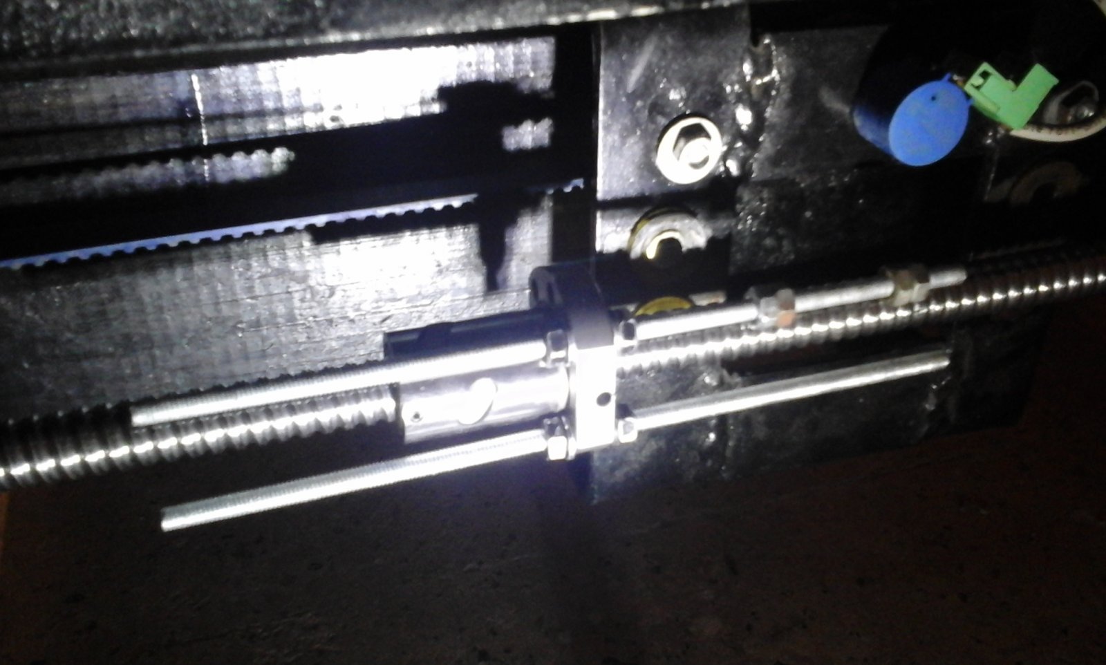

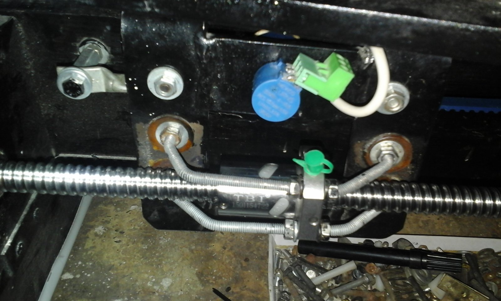

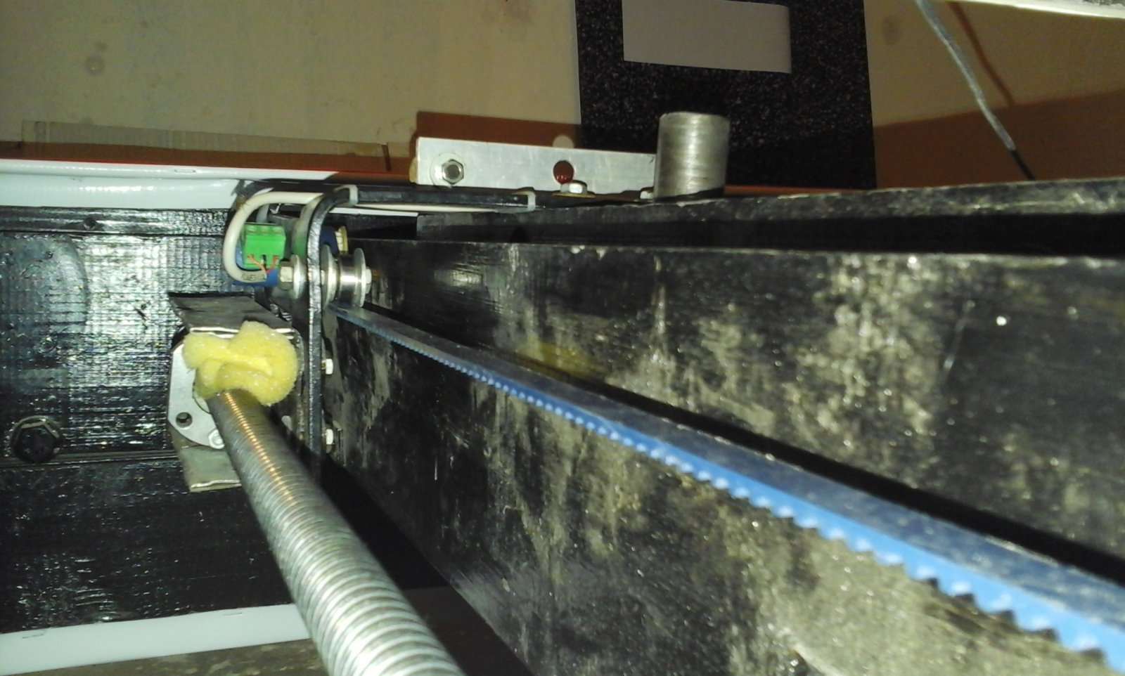

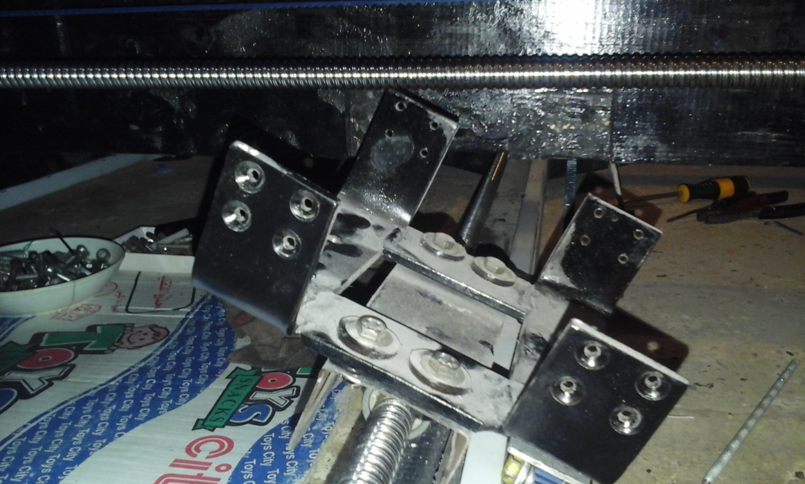

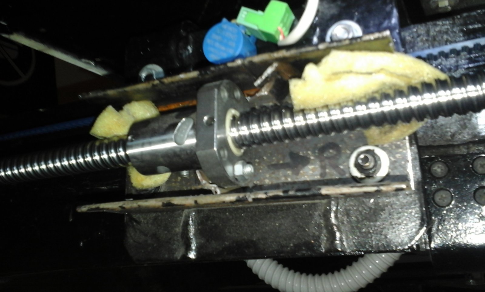

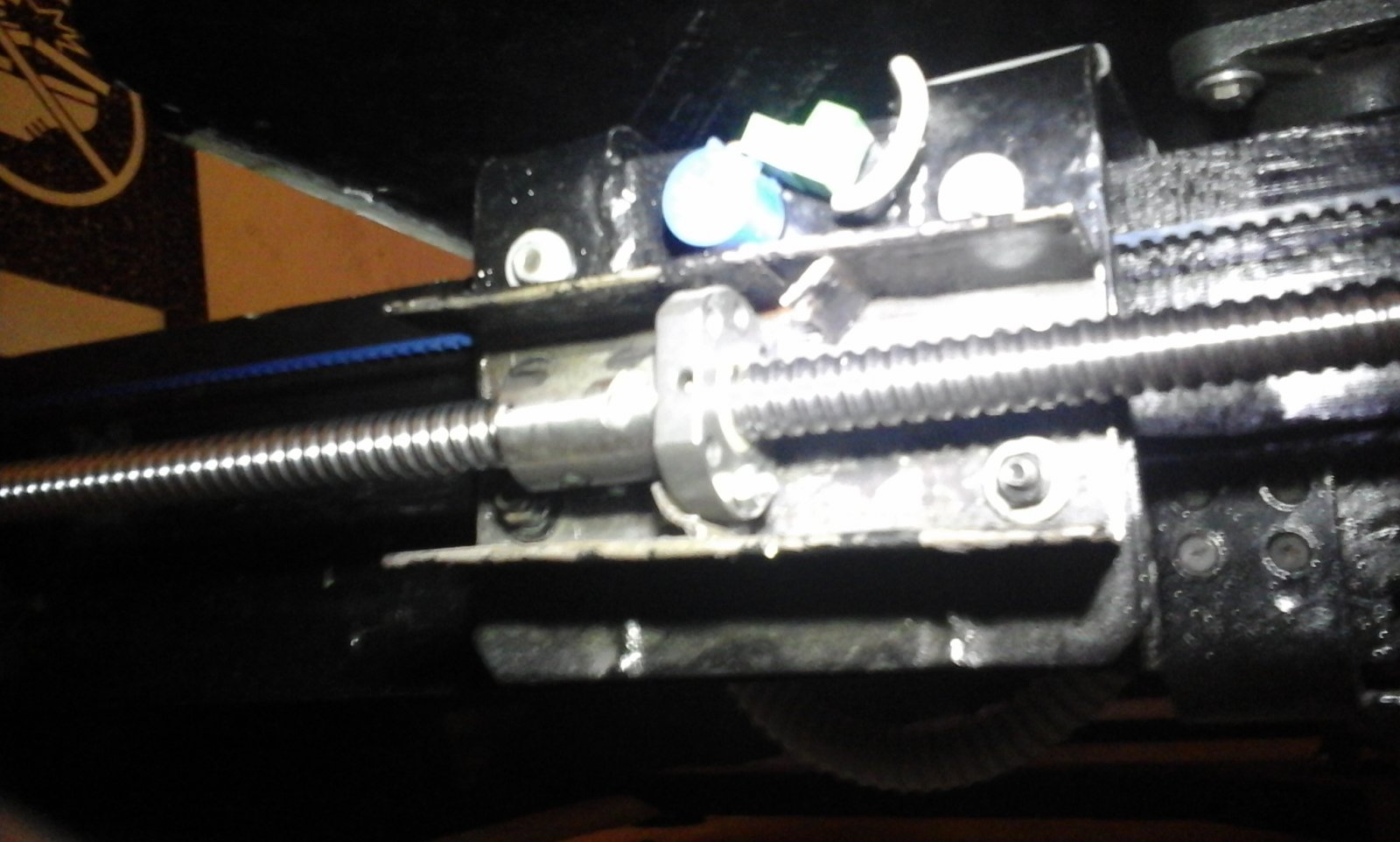

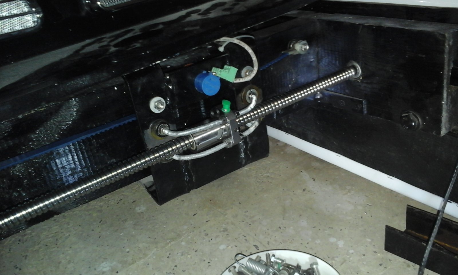

    removed these thin brackets ...
    and used a 6mm threaded rod bent to fet with well tightened nuts and washers ...
    this allowed me to use the green cab oiling valve back again ...
    20160704_082332.jpg 20160704_082353.jpg 20160704_095522.jpg 20160704_095528.jpg 20160704_095548.jpg 20160704_095611.jpg 20160704_125650.jpg
    this is the center motor fest ... removed from downside .
    everything under testing again ...
    patience guys I know what you need :popcorn

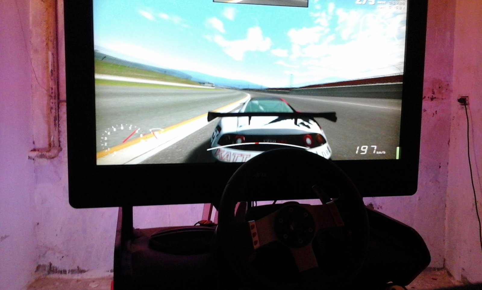

    Now it is really smooth and the bearings are well aligned ...
    Calibrating the PID again ...
    test drive with the old settings of game engine ...

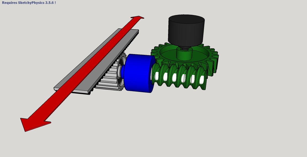

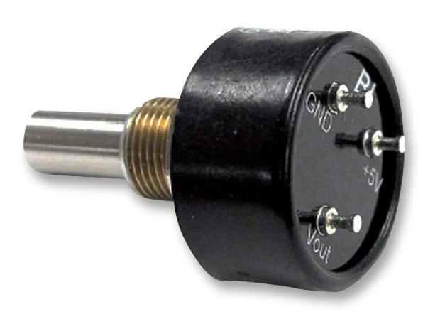

    It seems like we all have to taste the failure of the ordinary 10 turns pot ... me too started to have some erratic spots and decided to move on to the 180 degree hall effect pot ...
    So I think this idea might be good ... a worm gear 10:1 reduction gear ratio setup
    Any suggestions How this could be done ?
    A 3D printer maybe ?
