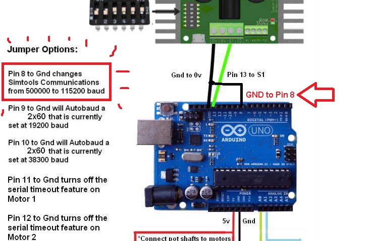

    is this what you did?

    Oh thank you for this wiring diagram.
    Now I understand how i have to ground pin 8.
    No, at the end i havent done it till now.
    It seems to work correct by then, because i changed the settings. My directions ( orange ) were the problem. With this settings on the pictures it is working well with baudrate 500000

    how do I change that? pin 8 on the ardunio R3 to groud and than reset button on the ardunio board?

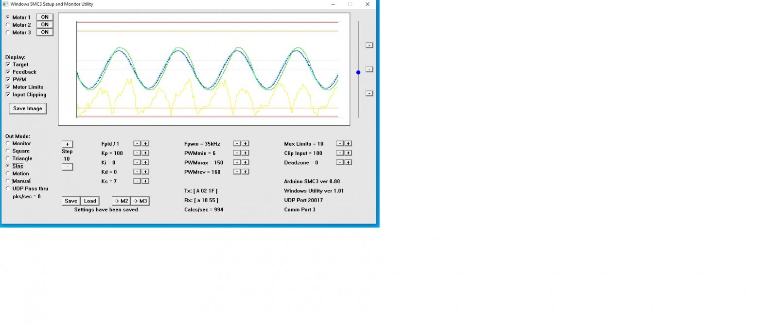

    I know this is an old post but im new here. Had my chair working reasonably well but it was under powered. Upgraded to the sabertooth from the ibt-2 and now i get a constant jitter. My smc settings are far different just to get it to boot up and now it goes crazy 5 min into a race. I tried the solution you noted and maybe im missing something. Setting simtools to 115200 it stops responding all together. I put a jumper on pin 8 to ground and smc will no longer boot. What am i missing?

    Can you please post pictures of your SMC3 settings running the Sine test.

    I have a screen shot with the sine.

    issue is a small crunching noise all of the time from the motors, like the motors are never sitting still or parking. The issues is worst if i increase pwmin or kp.
    Current screen shot shows a semi working setup however recently and for no reason at all, one of the motors will go to max and lock up or it begins to occilate like crazy. Reseting the motors only does not work and I have to reboot the entire ardino.

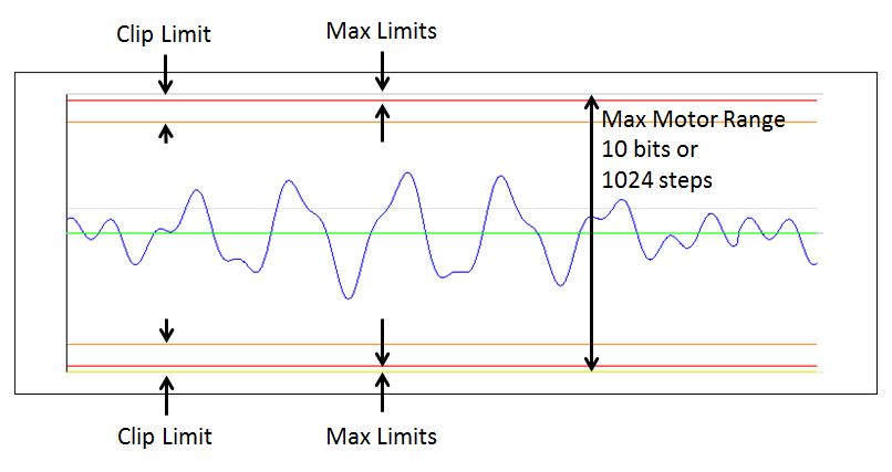

    The SMC3 settings suggest considerable overshoot and need for refinement.
    It is always hard to judge from a photo but your Fpwm seems high and your Kp unusually low. Similarly MaxLimits seems set pretty low:
    Max Limits Used to create a band at either limit of the feedback range beyond which if the motors move (typically through inertia) the SMC3 will automatically shutdown the drivers and keep them disabled until reset. This is essentially a safety mechanism if something goes wrong. The value can be between 0-255 (however can’t be greater than the current clip setting).

    As posted above, there is some way to force a different bald rate by grounding pin 8, so I ran a wire from pin 8 to a ground on the aurdino - No longer would boot. I also tried to change the bald rate in simtools 3 from 50k to 215000 as suggested earlier in this thread - motion no longer worked in testing...
