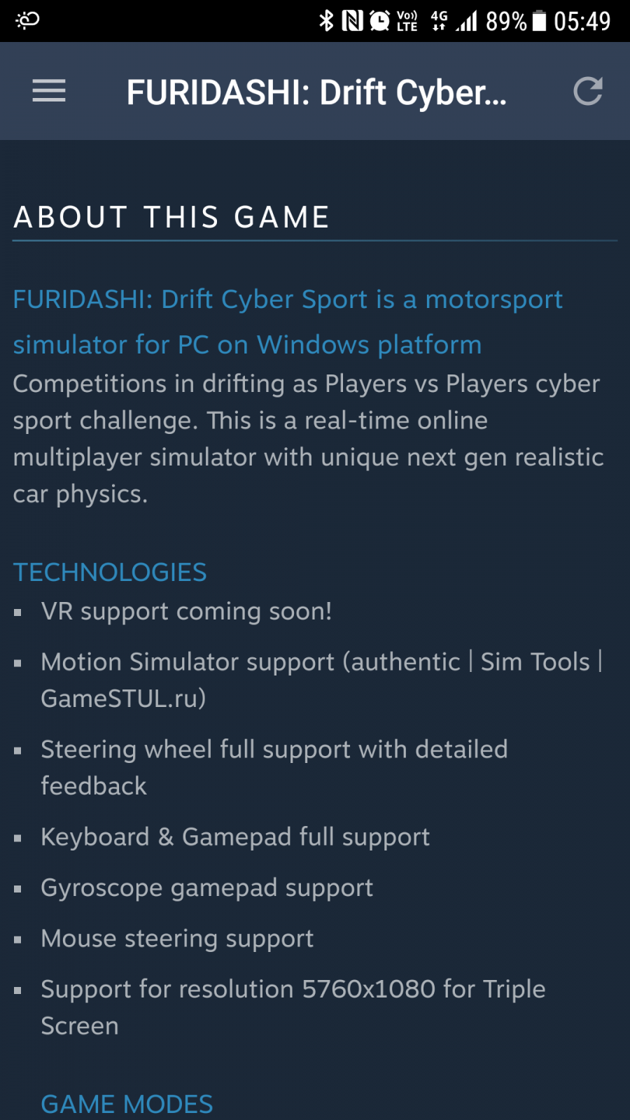

    Hey,
    Thanks to yobuddy for Professional License!
    I have tried the plugin and test with Output Testing>Virtual Axis.
    It seems that everything works OK. But I do not have the equipment to check in action.
    Can someone test and leave a review?
    We can add the necessary data such as speed, RPM, gear and the position of the four suspensions. But let's define their format.

    Hey!
    We have updater version on Steam!
    Now available 2 formats of telemetry data. Please see below.

    Please modify the plugin and test it. Is everything OK?
    Can someone record a video of how the game works on the simulator - we would be happy to add this video as a trailer to Steam.

    Here we go: Updated with the additional data structure.
    The plugin works with Format A and B.
    Feedback welcome!

    Please add FURIDASHI: Drift Cyber Sport to plugin list.
    Can I get plugin source for internal testing?
    And can I get SimTools logo to use it in the game to show our players that FURIDASHI supports by SimTools?
  14. value1
    Jan 9, 2011
    2,184
    Zug, Switzerland
    15,007Coins
    +3,336 / 11 / -1
    Hi Anton
    I've added the plugin to the resources and in the plugin thread.
    Attached you also find the source for the plugin.
    Thank you so much for your support. A pleasure working with you :cheers
