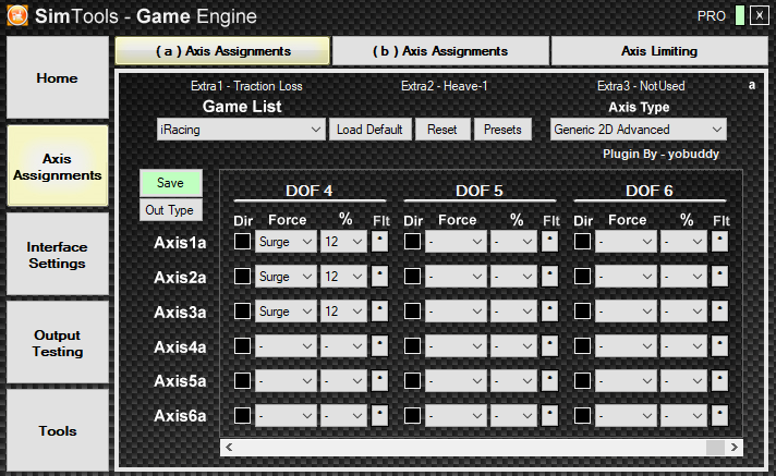

    Please post a picture that includes your surge settings.

    Hey noorbeast!
    Had to take 2 clips to show everything:

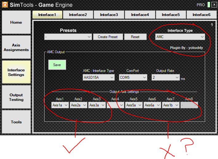

    In regard to the SimTools 'Axis Limiting' parameter can you clarify based on the following:
    I followed Barry Rowlands SRG review of his 5DOF system.
    In the setup menus of the AMC-AASD motion controller (what I use), he suggests limiting the stroke of each actuator to just below it's rated total movement. So for 150mm stroke actuators, select 130-140mm to avoid banging off the physical limits.
    Is this the same as the 'Axis Limiting' function in SimTools? If so, which one should I use?

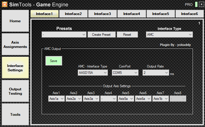

    Additionally, in the 'Interface Settings' I chose the correct 'interface type' of AMC, but it shows more axis than I have, if an axis is defined as a motor?
    Should I only have Axis1a, Axis2a and Axis3a for a 3x Actuator setup?

    First a warning, wait until you have the fundamentals correct in your motion profile before using VR, as conflicting cues can make you ill. With VR it is more important tat the motion profile be fast an accurate, rather than use large axis movements. Once you have a base profile that is pretty good on a screen then refine it further in VR.
    At a guess I would suggest switching your heave and surge axis allocation % around. You also need to add sway, try 30% as a start point.
    It is important to initially test Axis Allocations individually, adjust them as needed, then when you are happy with each then turn them all on and tweak from there.
    Axis Limiting is covered on p.39 of the SimTools manual and yes a bit less than the full range is a good idea.
    Yes you only need Axis1a, Axis2a and Axis3a for a 3x Actuator setup.
