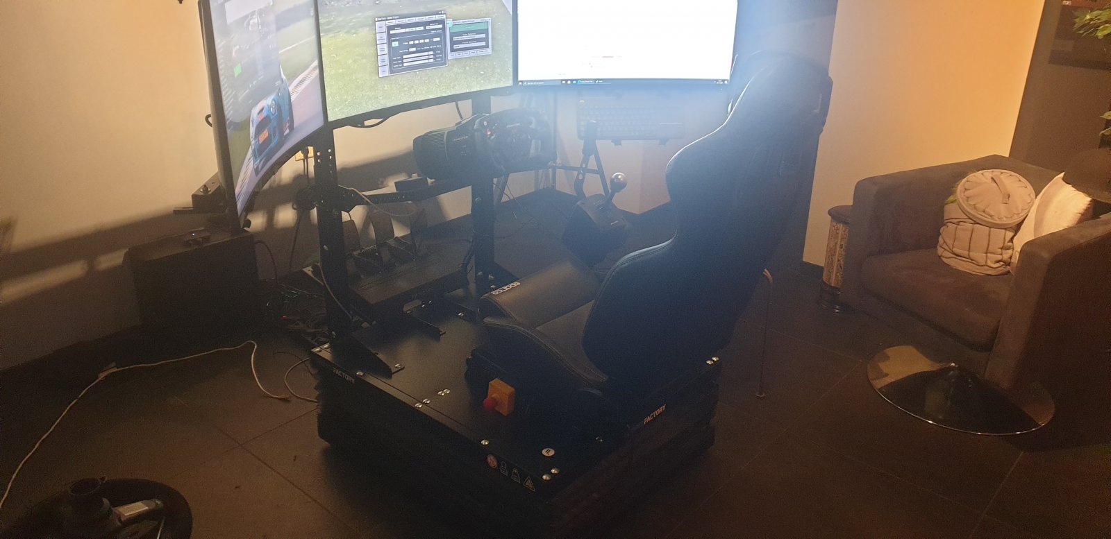

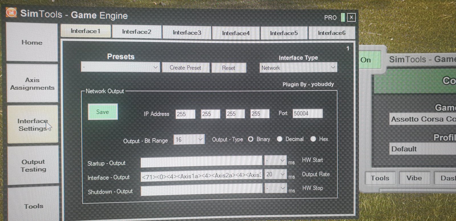

    i have an Edge 6d motion platform (6 DOF motion platform stuart) and use simtools latest version for a couple of simgames. like dirt rally 2.0 and project cars 2 are working without simtools but iracing and assetto corsa competizione do not. I racing works fine with simtools, i just have to fine tune my Axis assignments but motion works. Now i have the Assetto corsa comp. plugin installed and use the same settings for interface. Output testing moves the edge6d. Game manager says game running when game is running so no problem there but when i am in the game and want to drive there is no motion at all.

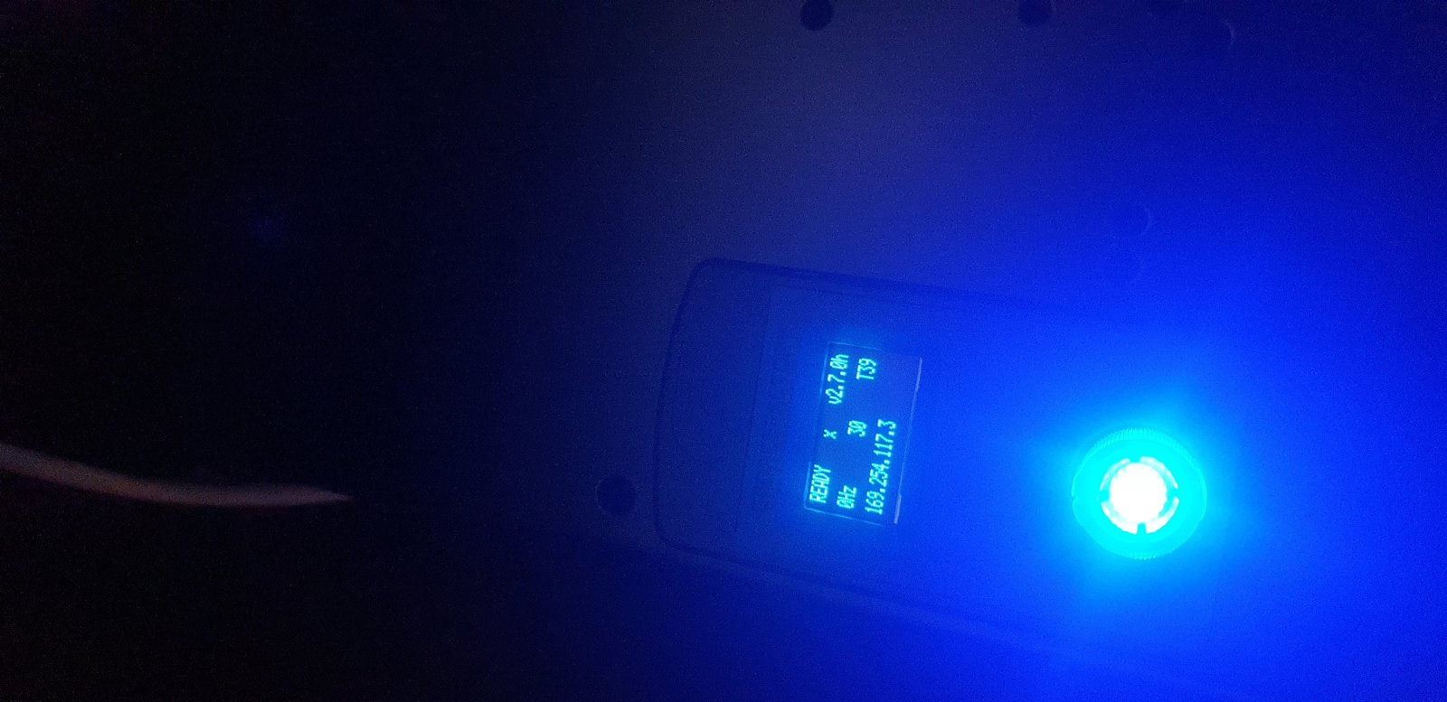

    The company puts a little box on the rig so you can adjust the intensivity when in the game (i never saw that before) you can see on the photo there is on the left a HZ value and it is on 0 hz, when it works it will go up and down depending the input of the game but when it is not working it is steady on 32hz so nothing happens. I can not find an ingame setting i need to change.
    i hope someone can help me with this?

    If Output Testing and other games work as expected, then in all likelihood either something like the firewall and antivirus are interfering with communications, or you possibly need to capture the Tuning Center Max/Min values, as a starting point.
    Try temporarily disabling your firewall and antivirus, unpatch and then repatch the game, then check and post pictures of all settings, including the Tuning Center.

    thank you @noorbeast i think it had to do something with the tuning center it works now
