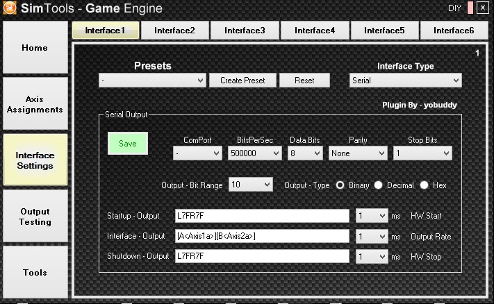

    What do I have to modify if I would drive arduino from a serial port instead of CH340 USB?
    The working and now jumpy settings arre on the picture, with the actual COM port of course.
    Speed is 500000, there is no such choice of on the PC but it works only at that speed.
    Somebody said with other, non -sim programs that CH340 was working well only with 7 bits. Screenshot (128)_cr.jpg

    the previous picture shows the necessary settings for the axis testing, there is a working axis assignment as well but with or without that, the axis testing is the same jumpy one.
    Tried 7 bits both in the serial port settings and in simtools, but it only works with 8 bits.
    My only hope is a real RS232 communication, what settings do i have to apply in that case?

    During testing sometimes Game Engine stopped, i don't know if it has any relevance, but event viewer says
    Faulting application name: SimTools_GameEngine.exe, version: 0.2.3.1, time stamp: 0x5c1445f5
    Faulting module name: KERNELBASE.dll, version: 6.3.9600.17055, time stamp: 0x532943a3
    Exception code: 0xe0434352
    Fault offset: 0x00011d4d
    Faulting process id: 0xc04
    Faulting application start time: 0x01d5c0a7071b09b3
    Faulting application path: C:\Program Files (x86)\SimTools\SimTools_GameEngine.exe
    Faulting module path: C:\Windows\SYSTEM32\KERNELBASE.dll
    and with v2.4
    Faulting application name: SimTools_GameEngine.exe, version: 0.2.4.0, time stamp: 0x5d118216
    Faulting process id: 0x2c0
    Faulting application start time: 0x01d5c0e046785e1f
    made a .net runtime error
    Application: SimTools_GameEngine.exe
    Framework Version: v4.0.30319
    Description: The process was terminated due to an unhandled exception.
    Exception Info: System.IO.IOException
    at System.IO.Ports.InternalResources.WinIOError(Int32, System.String)
    at System.IO.Ports.SerialStream..ctor(System.String, Int32, System.IO.Ports.Parity, Int32, System.IO.Ports.StopBits, Int32, Int32, System.IO.Ports.Handshake, Boolean, Boolean, Boolean, Byte)
    at System.IO.Ports.SerialPort.Open()
    at Serial_InterfacePlugin.ComWorker.WriteData(System.String)
    at Serial_InterfacePlugin.InterfacePlugin.Game_SendValues(Double, Double, Double, Double, Double, Double, Double, Double, Double, Double, Double, Double)
    at SimTools_GameEngine.Mod_Calc.‪‎‍‌‪‬‫‌‎‍‪‬‏‌‌‬‫‮(Interface_PluginAPI.IPlugin_Interface, Double, Double, Double, Double, Double, Double, Double, Double, Double, Double, Double, Double)
    at SimTools_GameEngine.Mod_Calc.Interface1Startup()
    at System.Threading.ThreadHelper.ThreadStart_Context(System.Object)
    at System.Threading.ExecutionContext.RunInternal(System.Threading.ExecutionContext, System.Threading.ContextCallback, System.Object, Boolean)
    at System.Threading.ExecutionContext.Run(System.Threading.ExecutionContext, System.Threading.ContextCallback, System.Object, Boolean)
    at System.Threading.ExecutionContext.Run(System.Threading.ExecutionContext, System.Threading.ContextCallback, System.Object)
    at System.Threading.ThreadHelper.ThreadStart()

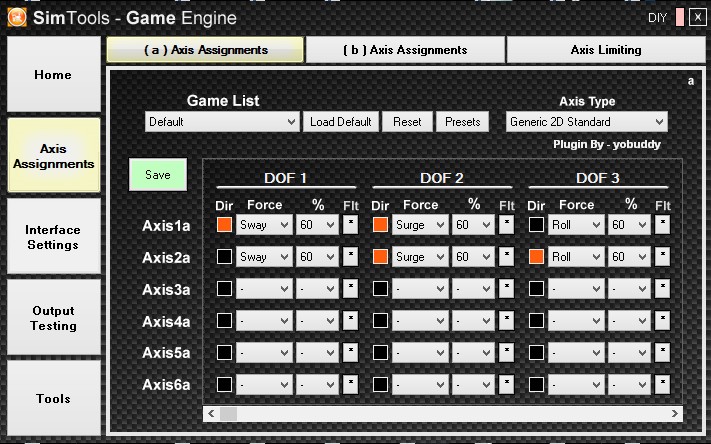

    Can you please post pictures of your Axis Assignments and it would be helpful to post a video showing the rig and issue.

    I send the pictures, but even without axis assignment, installed from zero again, i can test the axis (without any DOFs) and it does the same, turn on output testing, (a) axis output, with a very careful movement of the slide by mouse, only by one value at a time, 0 -1 -2 -3 etc. sometimes it is moving the motor fine, sometimes the motor jumps cca 30% of the whole range.
    If with home button and end button i send it to 100 and -100 and with click to clr i send it to 0, it does that fine. Only the continous change is problematic.
    Right now i have a half working rig, have to buy another H-Bridge, but if the above is ambiguous, then i can make a video.
    Thanks, Sandor
