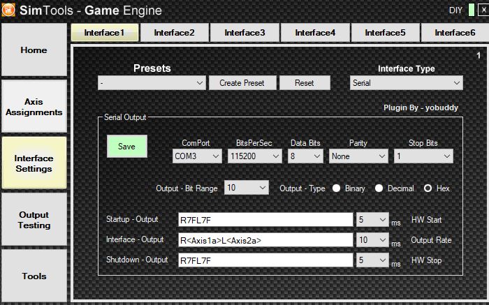

    @noorbeast I think i might have narrowed down what code is on the arduino im waiting for him to send me some picture's he had emailed to him to confirm, if so it might be the emailed guide is for 1.3 version of simtools fingers crossed its as easy as adding the letter a :thumbs
    22,227
    154,831Coins
    +11,227 / 57 / -2
    That would do it in an upgrade from 1.3 to SimTools 2. Of course if that is the case all plugins are also affected, as SimTools 2 plugins are not backward compatible.

    when i turn on output testing it automaticly goes right. it barley moves and in not the correct direction.

    it looks as if its @RacingMat code the emailed instuctions @Bob the builder was sent match racingmats instructions we have now added the "A" to make it work with simtools 2.0 and have movement in output testing but only small and side to side @noorbeast
    i have not used this code so not a clue what to try next :(ive used smc3 and jrk only

    also i know it has to be hex i change it by mistake

    I am pretty sure @RacingMat will help out when he gets a moment, or someone else who uses the code.
    As I understand it in Interface Settings the Output- Bit Range should be 8.
    And the setup instructions are here: https://www.xsimulator.net/community/threads/arduino-code-for-4dof-and-1-dirpin-hbridge-board.4614/

    these are my settings / out put testing is kinda working but going all around ranom

    if you run the test application does it show the motors going into protect? maybe the pot meter is broken or disconnected
