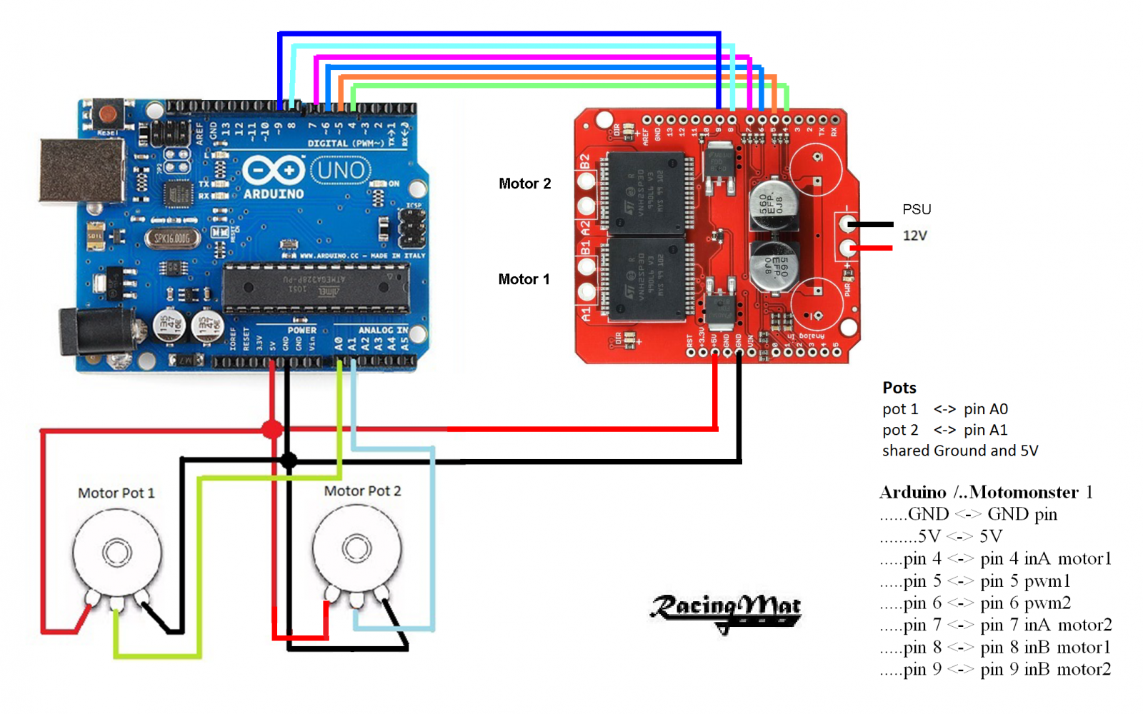

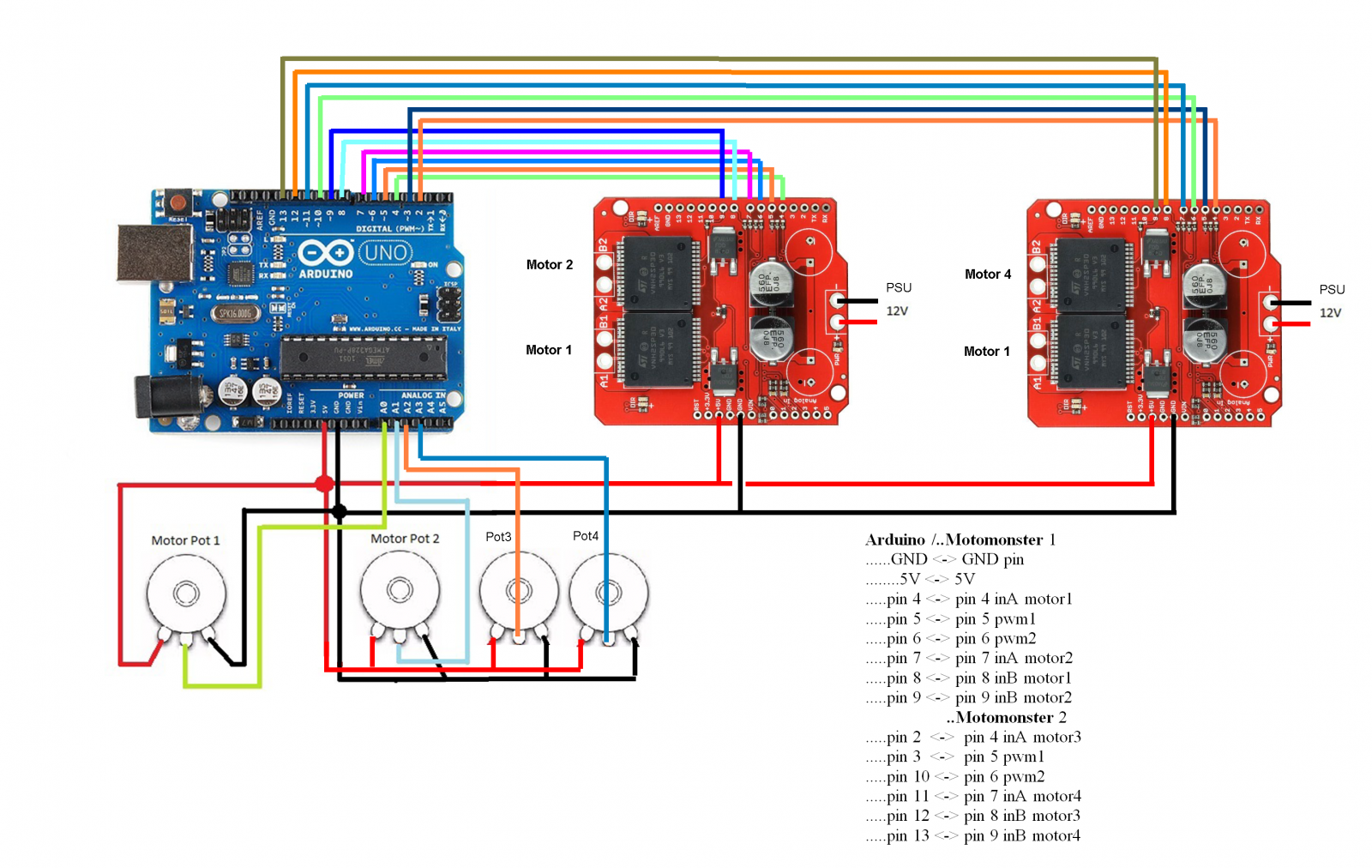

    Please find inside the .ino file, the Arduino code needed to run a 2DOF simulator with Hbridge having 2 pins for direction.
    you could use Motomonster
    or Pololu - VNH2SP30 Motor Driver Carrier MD01B
    https://www.pololu.com/product/706
    or
    VNH5019 Motor Driver Carrier https://www.pololu.com/product/1451
    it's the same wiring than motomonster InA and InB for Direction and 1 pin for PWM
    Arduino /..Motomonster1
    ....GND <-> GND pin
    .........5V <-> 5V
    .....pin 4 <-> pin 4 inA motor1
    .....pin 5 <-> pin 5 pwm1
    .....pin 6 <-> pin 6 pwm2
    .....pin 7 <-> pin 7 inA motor2
    .....pin 8 <-> pin 8 inB motor1
    .....pin 9 <-> pin 9 inB motor2
    .....pinA0 <-> center pin of pot 1
    .....pinA1 <-> center pin of pot 2
    .....pinGND <-> 0 ohm's pin potentiometer 1 & 2
    .....pin 5V <-> 10k ohm's pin potentiometer 1 & 2

    you intent to use 2 motomonsters? it's possible:
    Looking forward driving stronger motors?
    follow Pit's tutorial to use a single Motomonster per motor: this allows twice more current!
    http://www.xsimulator.net/community...cts-as-a-single-motor-driver-more-power.5482/

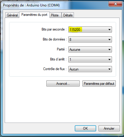

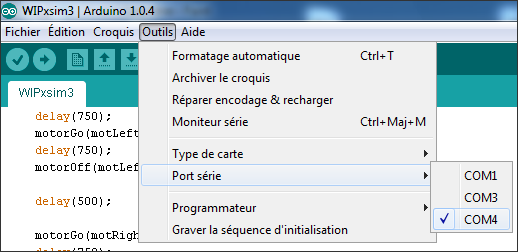

    Arduino setup

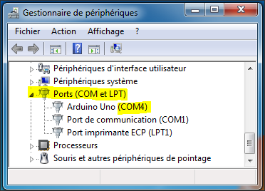

    - install manually the drivers (see the Arduino's specific documentation for Windows Seven installation).
    - After complete installation, find in the Windows system on which COM Port it has been installed : you will need to put this information in SimTools / Interface Settings.
    - Double clic on Arduino's line and adjust the default speed :
    - In the Arduino plateform, put the right COM Port : if not, you won't be able to upload your program into the Arduino...

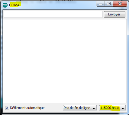

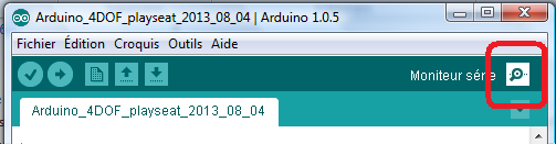

    - Open the Serial Monitor (magnifying lens on top right ).
    - Adjust here as well the same default speed :
    Don't mess within the code ;-) or make everything coherent everywhere

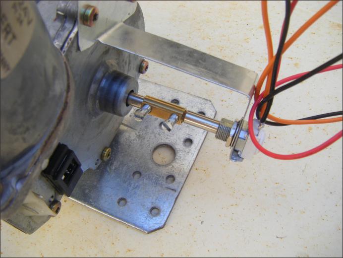

    First : pot are not mounted onto the motor
    you can see the expected behaviour in this video
    and please find the explanation of the code here :

    Second : now checked the wiring
    Once you have played in this manner, now checked the wiring
    simulate the pot mounted onto the motor (back to back or alongside with gears...)
    reduce the speed (pwmMax) to see the direction of motor rotation
    and check if Arduino will behave as expected when you turn the pot
    if your pot is mounted this way :
    when you turn in a direction, motor has to go the opposite way.
    If not, invert motor wiring or pot wiring.
    Warning ! if you have gears between pot and motor, you'll have to twist your mind :eek: to check the correct behaviour.
    Third : mount the pot onto the motor, the behaviour will be the following :
    - motor goes to middle position and stop
    - if you send order to Arduino via Serial Monitor (say R7FLAE) the left motor will move and stop at his new position ! right motor didn't move.
    - etc...

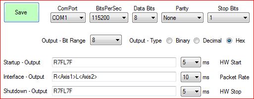

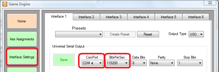

    SimTools Setup
    - In SimTools : set the same ComPort and same Speed
    - my Arduino code needs 8bits Hex data : just setup like this for 1 bridge and 2 motors
    the only change needed for SimTools2.0 is the a designation: Axis1 -> Axis1a
    Ignore the axis b tab, you are not using it.
    - startup and stop just send the instructions to come to middle
    - and 7F in hex equals 127 in dec
