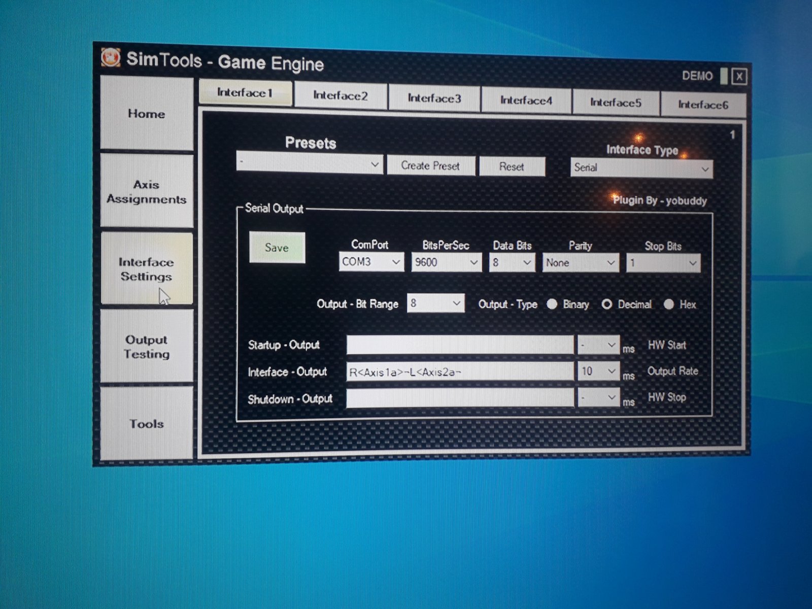

    Help 2dof rc servos just keeps going nuts .what am I doing wrong I download the 2dof rc zip file
    21,592
    151,215Coins
    You have missed the closing bracket in your Axis2a Interface Settings: R<Axis1a>~L<Axis2a>~

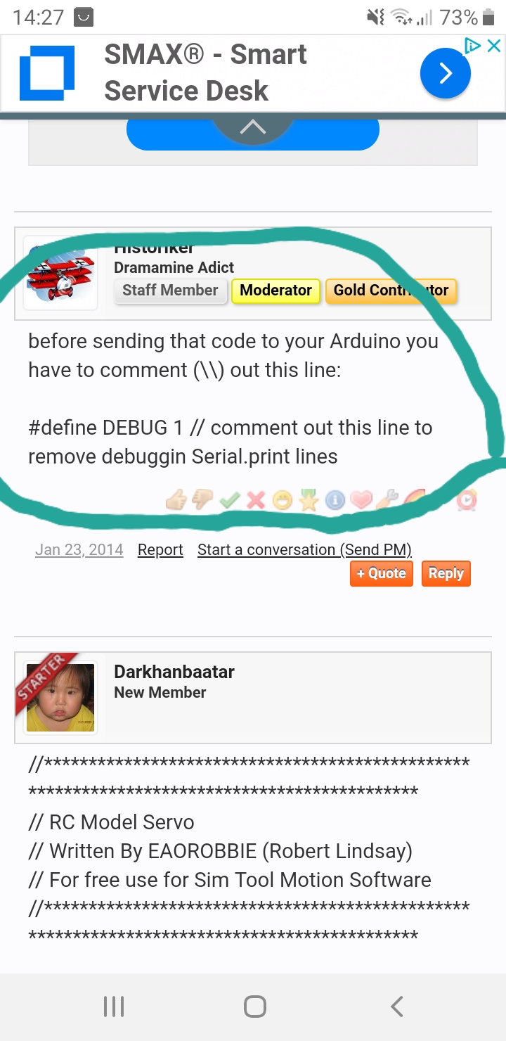

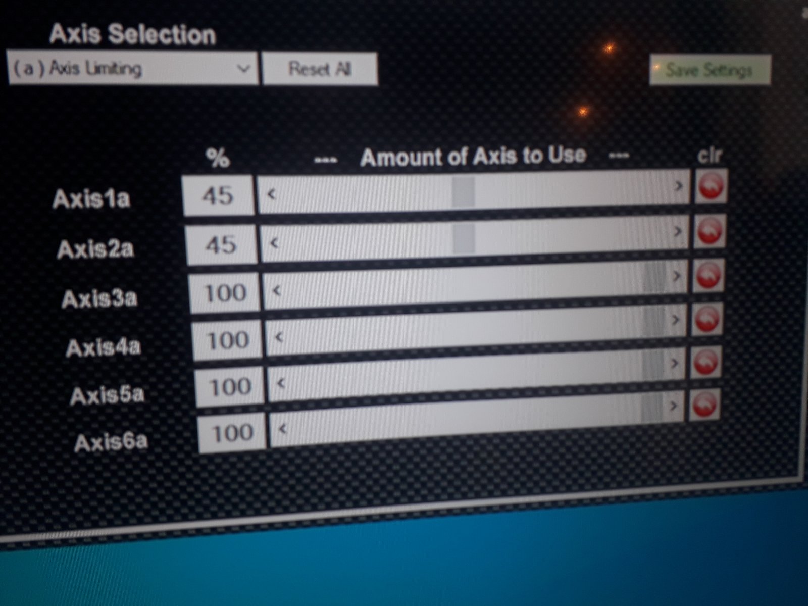

    Hi thanks noorbeast . All up and running . 1 problem is when I use in LFS the axis movement is very slow. Any tips on how to get more of a snappy movement. Thanks again for the help
