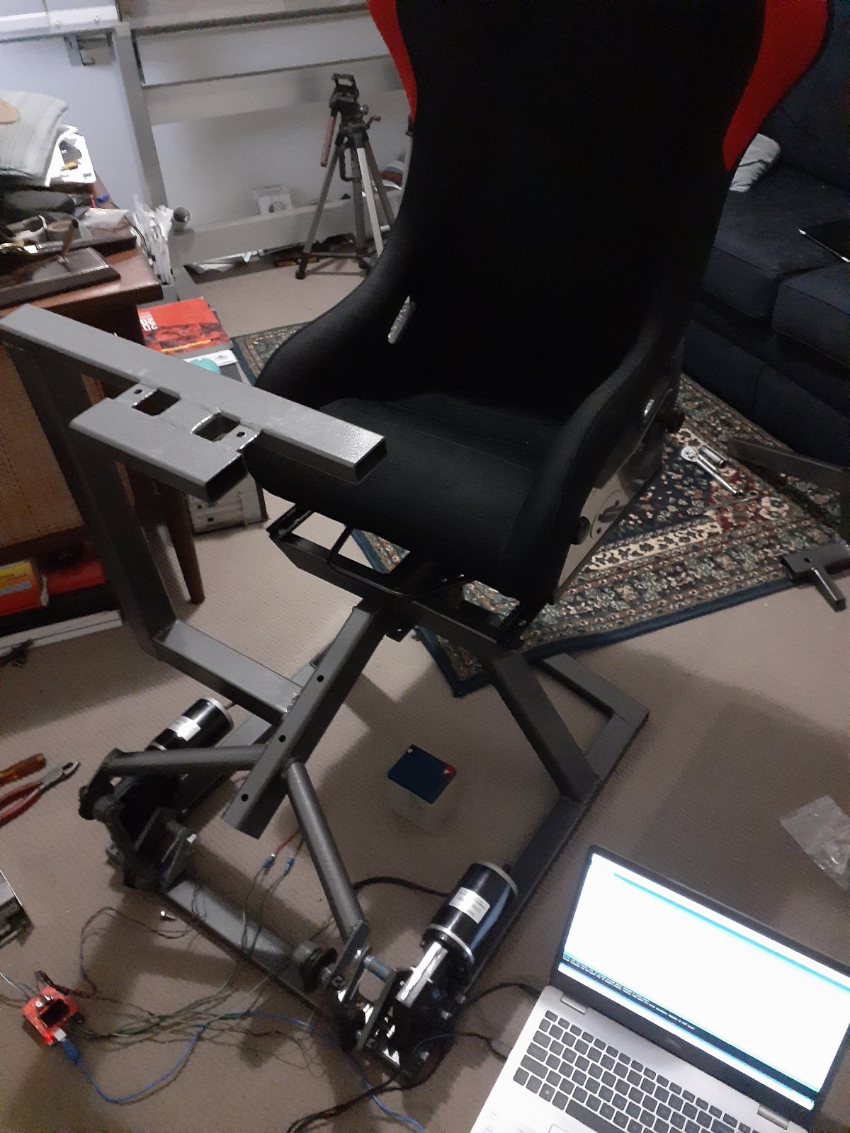

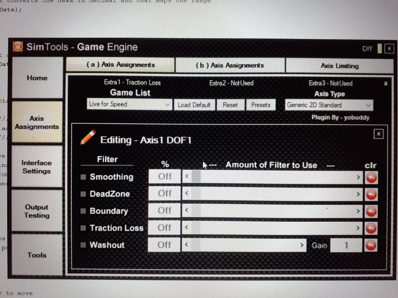

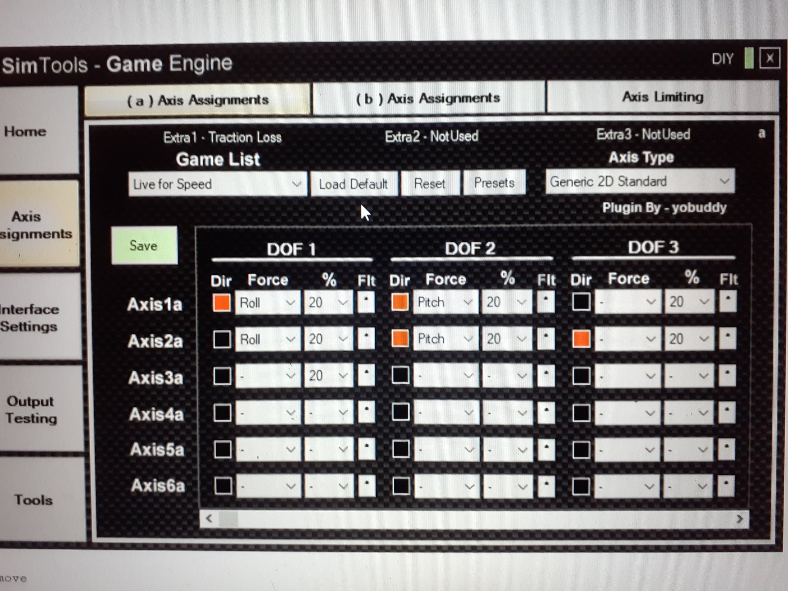

    Hello everyone, this is my first post here. I've built a 2dof machine using 12v motion dynamic 200w worm drive motors, 12v 50amp psu, motomonster driver and Arduino uno with racingmat's code. After a rather steep learning curve, I've eventually got everything talking to each other and getting movement where and when it's needed. My problem is as you'll see in the video that the motors have an awefull jittery sound and action when holding position with any amount of load on them. Also you'll note when a bit of force by hand is applied to those jittery motors, the power is cut allowing the motor to become idle and drop.[​IMG]

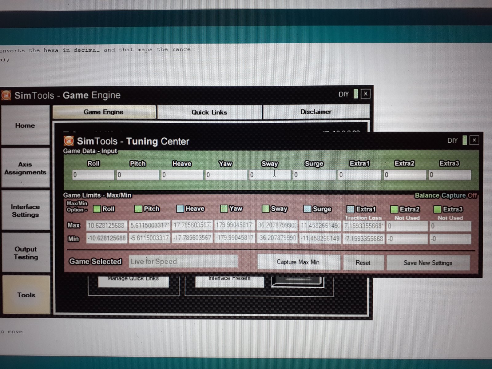

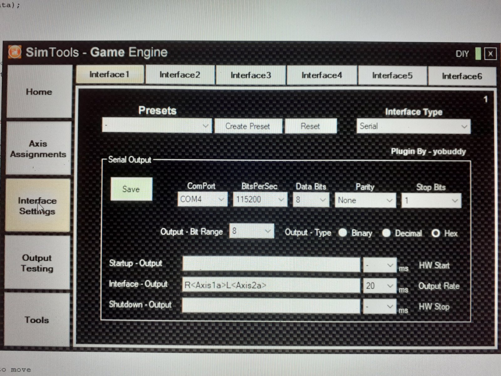

    Thanks so much for your response, it’s greatly appreciated! Over the past few days I’ve done a lot of reading of other posts to try and come to a solution on this. I’ve read everything from increasing PWM to cheap and nasty pots to motor/gearbox backlash to PID to every other conceivable setting. I have noted when the pots are not attached to the motors and I slowly turn them, either side of the centre position has the MM power indicator led flashing rapidly rapidly as in too many calcs as you say.
    I tried racingmats “ultrasonic pwm code” at 20khz and that just didn’t work at all. Apart from that I’m not sure how to change pwm in his original 2dof code, nor do I know how to change pid in his code. Code can be found here.
    https://www.xsimulator.net/communit...-and-2-pins-direction-hbridge-motomonster.67/
    I’ve played with all the settings in SimTools to no avail.

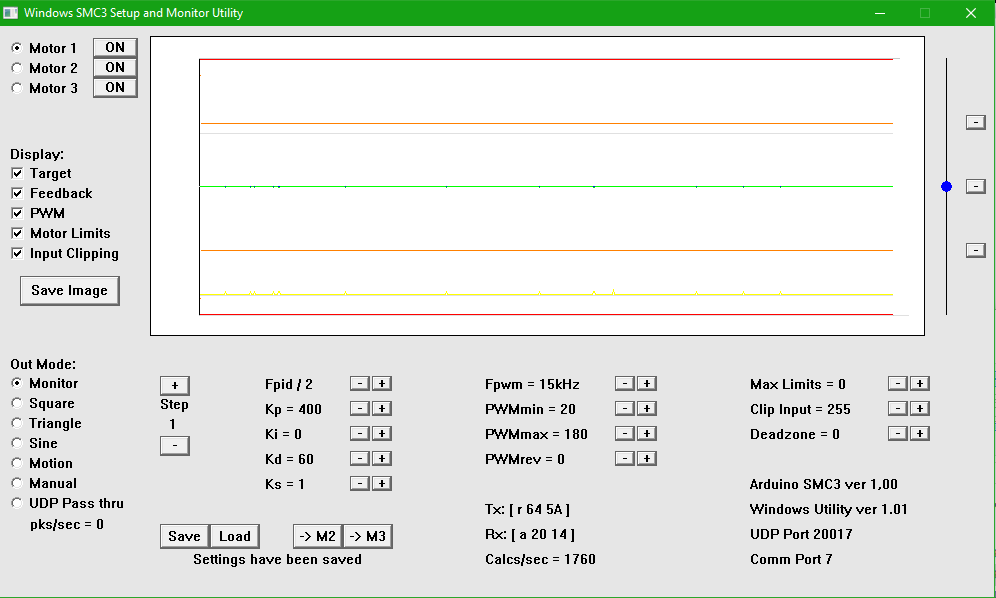

    Hi, I had this problem mainly because the motors were not ground isolated so the current made it's way trough a bolt I have conecting the two motors and drove the monster crazy. This is a common problem for this motors as they are built this way from the factory. I ground isolated one of them and then they became less noisy but were still making some noise.
    Another problem I had wich was fixed too when I isolated the motor were the power supply turning off when the motor had to work harder.
    At this point my sim worked perfectly except for the noise it made, I think this is the step where you are at.
    So if you go for SMC3, that should work for you, you have a parameter in the SMC3 utils program that is Fpid/x where as you increase x it will reduce slightly the calculations per second.
    You can find a complete guide to install SMC3 here https://www.xsimulator.net/communit...3dof-motor-driver-and-windows-utilities.4957/
    In this guide are explained all the parameters in smc3.
    After I made some adjustments in SMC3 the noise dissapeared so I think this could work for you.
    I'll attach a photo of the smc3 utils program, as soon as I can I'll make one with the parameters I have at the moment so you can compare them and see if they work for you.[​IMG] [​IMG]

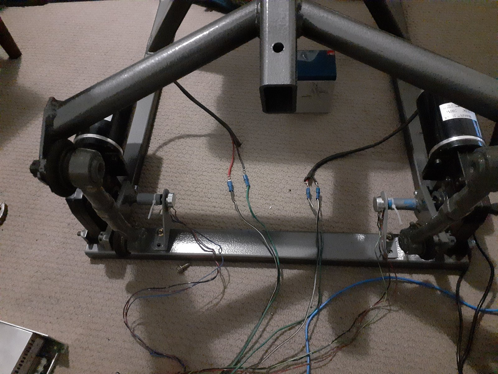

    Thanks again for getting back to me, I have checked continuity between chassis and motor leads and there’s no continuity so I don’t think there’s an issue there with grounding. I believe it’s mainly an issue with wiper motors. Tell me if I’m doing it wrong! Electronics ain’t my forte! I think I’ll try SMC3 and see where that takes me, I think the wiring of the Arduino and MM are a little different, so I’ll check that first and go from there, thanks and I’ll let you know how it goes, cheers!

    one thing I did with the motors is opening them and cleaning them properly as they were from a junkjard. This made them drive better but yours look new and clean.
    Yeah, the wiring is different and you have to be cautious with that, just follow the diagram included in the post and all should work right from the start. One change I made was connecting the 5V input from the MM directly to the 5V output from the power supply but should work the other way too.
    I'll try to attach a photo of the configuration I have in SMC3 in case this helps you.
    Let me now how does this works with your build and I´ll try to help as much as possible

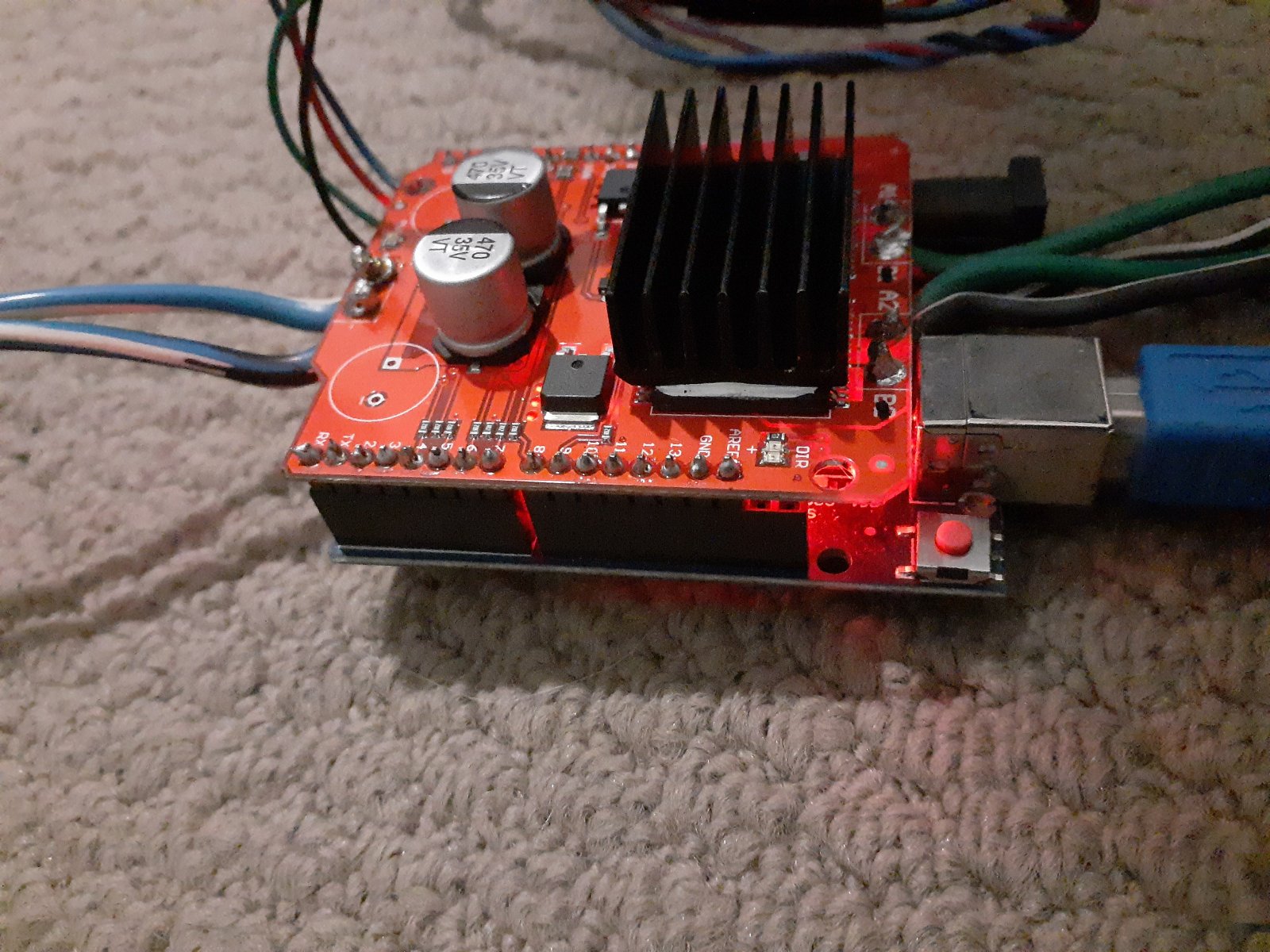

    Thanks mate, I’m a little further ahead now, I rewired everything to suit SMC3, loaded the code and utilities. Motors sound a lot healthier now, but MM keep cutting out. Did some maths and given MM’s only handle a continuous load of around 15amps per side, I’m pushing the limit with 200w motors (16.6amps each). So I’m hoping the answer is to use the 2 MM outputs to power one motor and fit another MM for the 2nd motor. I’ll give it go tomorrow and let you know how it goes, thanks again!

    Great! This is exactly what I did because of the same problem, the MM cutting out. After that they are working perfectly and now what limits me is the power suplly.

    Update, think one of the MM are playing up, so everything is on hold till I get some new ones.

    Update, ok! Well I got the new MM’s redid all the wiring nice and neat, mounted everything in an enclosure hooked up to laptop (from which I’ve been doing all testing and set up) all appears to be working fine. It was always intended on running the sim from my desktop pc, so I pulled the Usb from the laptop and plugged into pc and immediately my ground wires from arduino fried. I repaired the wiring and plugged USB back into laptop, everything ran fine again so plugged USB into pc again and bang, the ground wires fried again. Tried several other ports on the pc and the same thing happens. This is only happening with the motors power supply turned on. The system connects to the pc fine until the power supply is turned on and then bang! (Not when connected to the laptop though). I don’t get how plugging into a different computer can do this, all other USB devices are running fine from the pc. Anyone have any clues?
