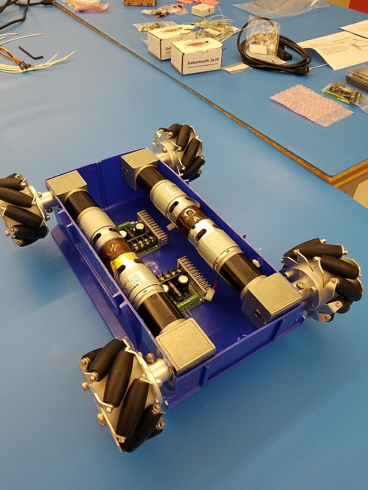

    Building anything with DC motors or lower voltage doesn't necessary making it cheaper.
    It can well end up more expensive than ready actuator solutions out there...
    I have been assigned to build a prototype robot at my workplace to deal with a very specific and tedious task, and had to be complete autonomous and easy to maneuver around, so I went with a 4WD Mecanum wheels (Omni-directional motion). Of course, to be able to handle the load its supposed to be carrying around, I had to go with 24v DC motors, Sabetooths 2x32, Kangaroos x2 for cruise control and encoder tracking for home triangulation. Include the 24v battery and sensors and SDR wifi controller, it costs in materials only, $4000 so far !!! I estimate even higher, after camera and rest of sensors are added.
    Anyway, see how it looks still on its temporary plastic bin chassis, will build a metal chassis for it soon... more money spend there...
    Fun stuff doesn't come cheap, that's for sure!

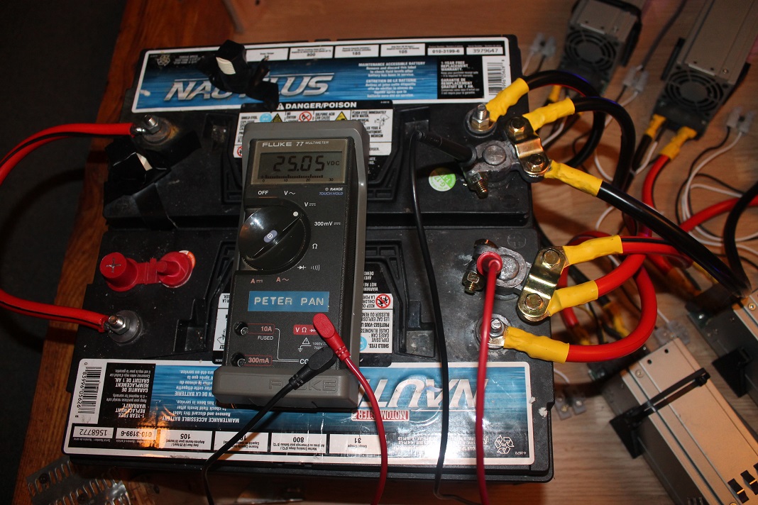

    after talking to some coworkers about my plans for power... he suggested that i go for a high capacity amp hour batteries, and one power supply.
    Looks like im going for (2x) car batteries, and (1x) 24V power supply for charging purposes.
    since i only have (2x) 115VAC @ 15A circuits
    i have other equipment that i plan to use, (i.e. gaming PC, audio amp for bass shakers), i dont want to overload the few circuits that i have...
    What do you guys think?
    i havent calculated the battery size yet.. but after following sixdegreesoffligh's build.. he planned around (6x) 24V - 450W motors...

    I would go for more than one power supply. I am using my three LED on one single 120 volt / 15 amps wall socket and all is good. The batteries take the heavy duty load. But maybe you're good with only one. To tell the true, I don't know.

    my tech guy is good with theory, for a 10 min chat he analyzed my sketch wiring and broke down. i wish i was able to talk to him more, hopefully next week.
    basically he said i can run my platform off the batteries, but only one power supply has to be on at all times to charge the batteries.
    what your battery spec if i may ask!

    I don't know there spec exactly. They are deep charging boat's batteries.
    This is the closest picture I have of them. It says 105A and hour.
    If your tech says your okay, then listen to him. I have the tendency to be over the top. (Still, I would use more than one LED psu :) )
