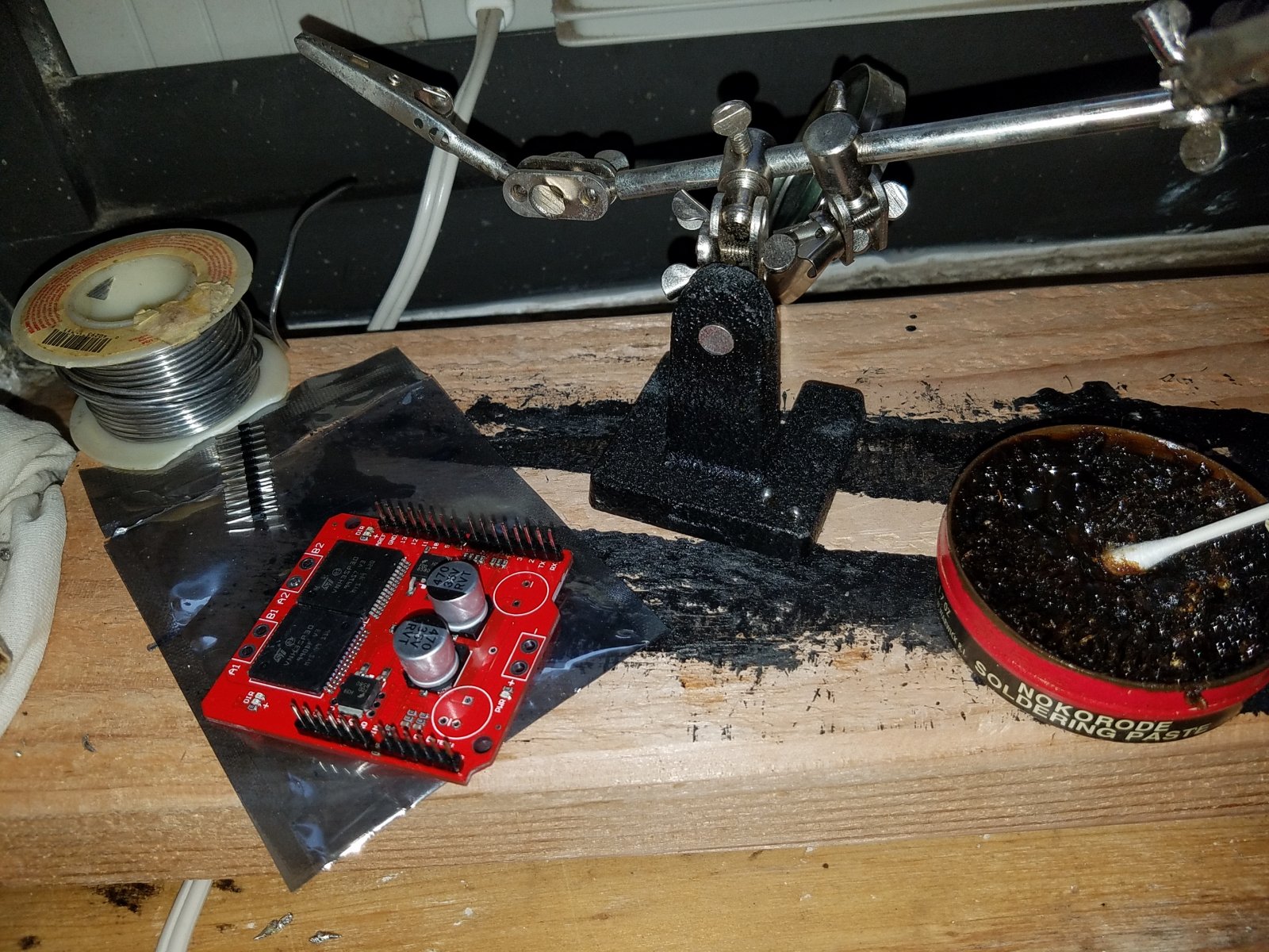

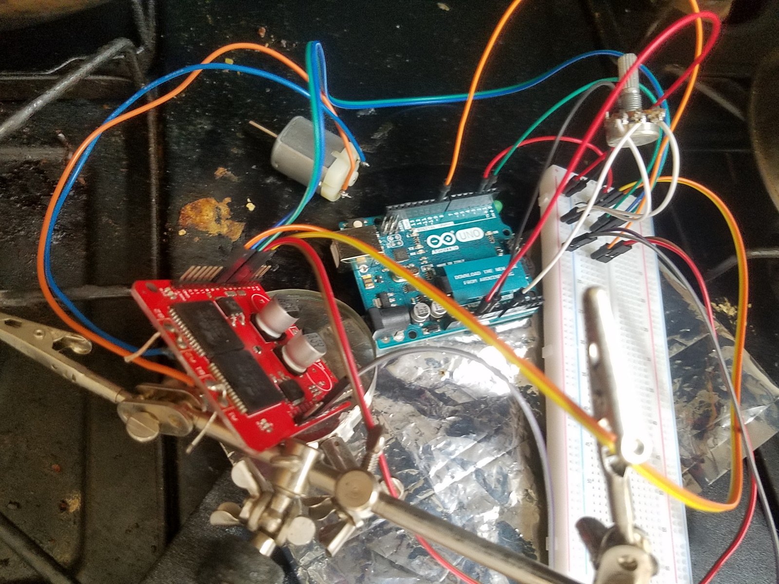

    2/23
    Monster Moto Shield acts as a single motor driver tutorial didnt work so well for me... seem like the drivers got hot.. im just using hobby motors!
    trying to share photos... small step! just getting test parts wired up!
    i hope the 100K pot will be ok for test.
    today i:
    1. Wire up the Arduino with MM and connect to your computer via USB (Motor Power left disconnected)
    2. Installed the Arduino IDE tools
    3. Download the SMC3 software attached to this post (SMC3.ino) v1.0
    4. Open the SMC3.ino with the Arduino IDE
    5. Used Mode 1 for the monster moto shield
    6. Compile and Uploaded the SMC3.ino program to Arduino UNO R3
    7. Run the Windows SMC3 Utility software and established communication with the Arduino
    8. Set the Kp, Ki, Kd, PWMmin, PWMmax, PWMrev to 0 for ALL motors on SMC3 utility
    9. Set Clip to 255 (you need to do this first) and Limit to 255 on SMC3 utility
    10. Plugged in motor power supply
    11. Set Kp to about 400 in SMC3 utility
    12. TURN ON motors on the SMC3 utility
    13. Now slowly, increase PWMmax and watch the motor move...
    IS THIS A NORMAL THING THAT THE MONSTER MOTO SHIELD GETS HOT???
    No... perhaps if you used original MM ...
    Or Sabertooth...
  13. Joeri
    Joeri Member
    Feb 18, 2019
    61
    car body repair shop
    The Netherlands
    106Coins
    +23 / 0 / -0
    Is the motor Moving ?
  14. hannibal
    hannibal Active Member
    Sep 29, 2018
    677
    4,492Coins
    +298 / 4 / -0
    it moved in one direction..
    but not the other.
    i guess i am victim of the fake MM's!!!

    *** update***
    as i was getting ready to wire up the second MM, i discovered that i wired the motors wrong..:eek:
    i was so concerned with the polarity, i was following the board contact designations instead of the diagram...
    once i wired the motors as per @RufusDufus diagram, it worked!!! i can turn the pot CW and CCW, and the motor rotation goes FWD and REV!!
    the only thing is that the MM gets hot...
    thank you for suggestion about 3x arduino + 3x sabertooth!
    now i have to debate if to go Arduino/Sabertooth or JRK...
    in the mean time, i just want to complete the tutorial, try the other MM, and get it to work with LFS!

  18. noorbeast
    22,184
    154,726Coins
    +11,194 / 57 / -2
    You will want some sort of cooling before you burn an MM out, here is an example: https://www.xsimulator.net/community/faq/xilence-cooler-for-moto-monster-sparkfun.211/
