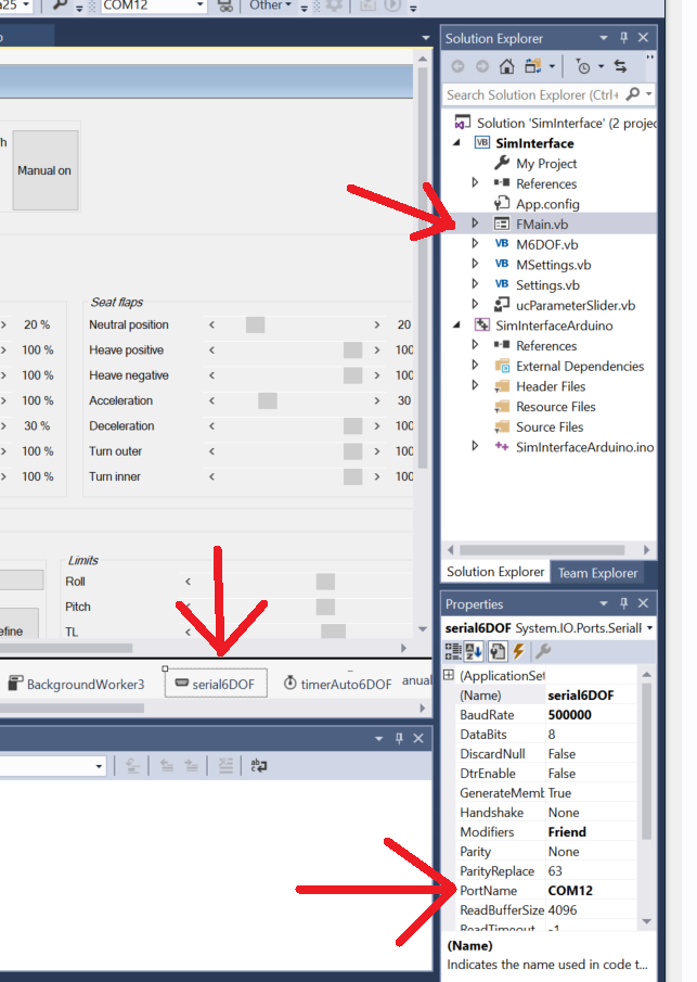

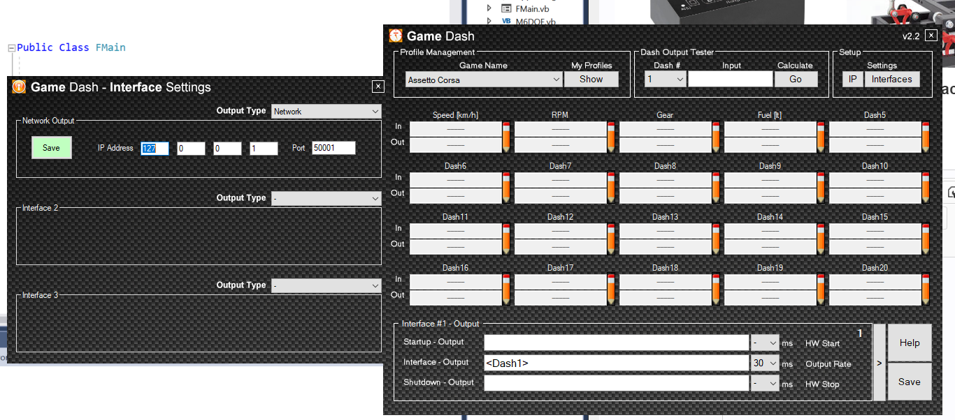

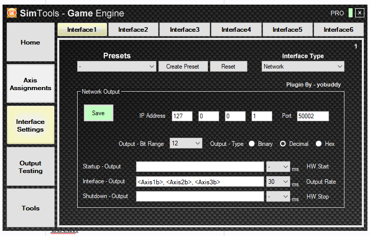

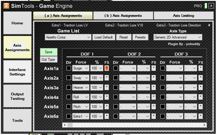

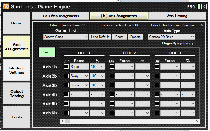

    Here is the VB.net application.
    It expects that software and hardware connections are as follows:
    Simulated wind:
    Game Dash interface settings:

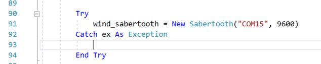

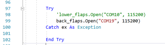

    My fans are controlled by a Sabertooth 2x60 connected to COM15.
    Port name can be changed in the code (FMain.vb):
    GSeat:
    My GSeat now only has two back flaps which are controlled by a single Kangaroo/Sabertooth at COM19.
    Software can control two more lower flaps:

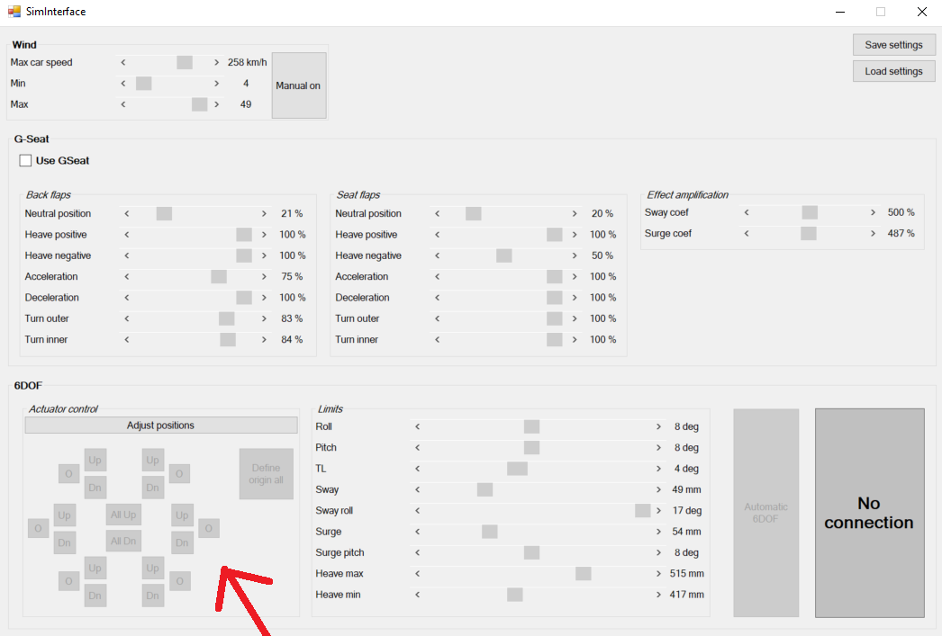

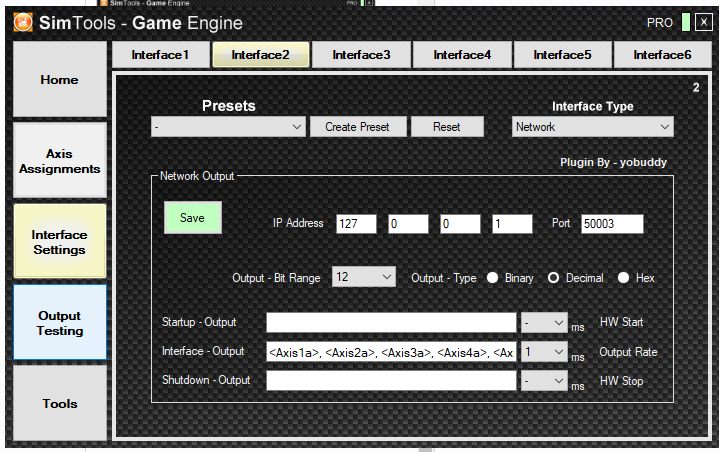

    6DOF:
    My Arduino Mega running the sketch is connected to COM12.
    This can be changed here:
    My rig does not have limit switches and so I need to manually set lever origins when turning it on.
    I use actuator control buttons to manually move the levers so that they are all horizontal and then click "Define origin all" button to record this position as origin. Then I click "Automatic 6DOF" to start listening for commands from SimTools.

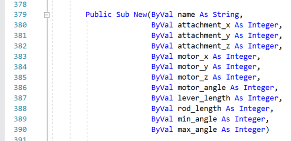

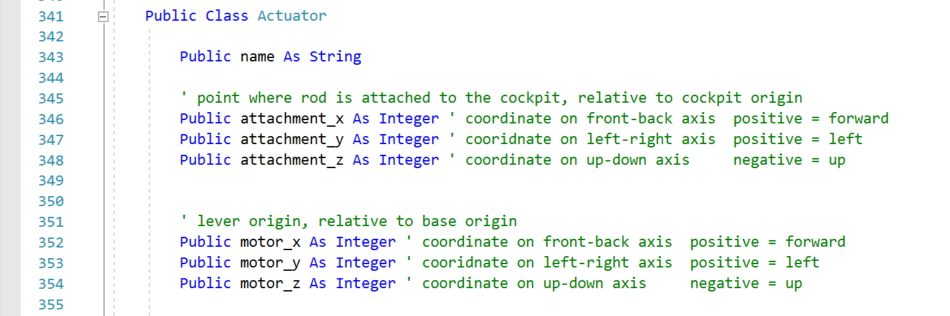

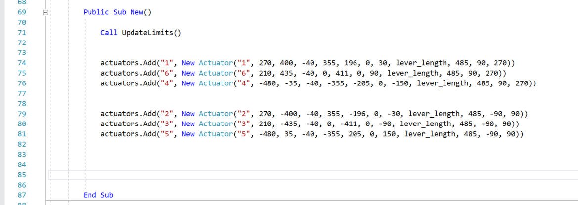

    The app calculates correct lever angles using proper 6DOF model in M6DOF.vb file. For this to work, it is required to fill the geometrical parameters of the rig here:
    (tl_dx is how far forward the traction loss rotation axis is shifted from the cockpit origin)
    and here:
    The order in which parameters are listed is here:
    X-Y-Z axes are defined like this:

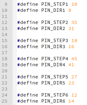

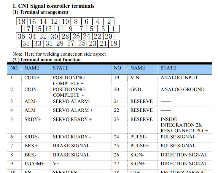

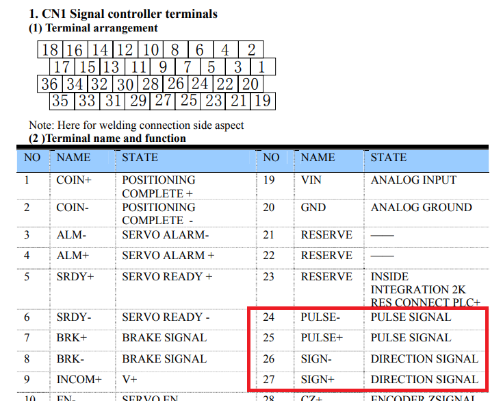

    Here is some further information to explain how my Arduino is controlling the servos.
    I'm using QS7AA030M servo drivers that can be controlled by STEP and DIR signals.
    These drivers have a setting that allows adjusting by how much servos should move when a single STEP signal arrives. My setting is such that 180° arc corresponds to a total of 10000 STEP signals, or +/- 5000 STEP signals from horizontal lever position.
    CN1 port of the servo driver has four pins that are used for STEP/DIR communications:
    PULSE- and SIGN- pins of all six servo drivers are either connected to Arduino GND pins or to the digital pins that are set to permanent LOW state. Here are such "low" pin numbers in my setup:
    PULSE+ and SIGN+ pins of all servo drivers are connected to Arduino pin numbers like this:
    I additionally have ESTOP switch connected between Arduino GND and this pin:
    If switch is open, Arduino stops sending step signals to the drivers.
    Arduino stores lever positions as integers, with 5000 being the "neutral" position. I initially move all levers to make them horizontal and then tell Arduino that such pose is neutral.
    Arduino listens to its serial port for one of the following packet types:
    <tgt1,tgt2,tgt3,tgt4,tgt5,tgt6> -- where tgtN is the integer between 0 and 10000 specifying the target position for each of the six levers
    <S,0,0,0010> -- set delay between STEP signals to 10 microseconds. This delay determines the speed of movement
    <M,1,U,0025> - move motor 1 up by 25 STEP pulses
    <N,0,0,5000> - record that current position of all motors is 5000
    <N,2,0,5000> - record that current position of motor 2 is 5000
    <R,0,0,0000> - report back the motor positions
    <E,0,0,0000> - report back e-stop state
