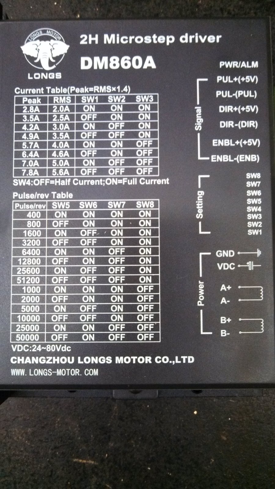

    I am using stepper motors for my sim and was wondering if anyone had a code that could run 2-4 steppers on arduino. I am new to this so i have no clue how to make code that would work. so if you all are knowledgeable I'd appreciate help with a code for arduino.
    I am using an arduino uno r3, and i have nema 34 steppers 3.5a.
    this is the driver that comes with them.

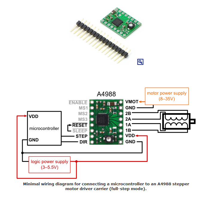

    As for the driver above.
    Here is where I got my idea started from.

    it needs only a 2 wires connected from the driver to the ard and all 5v and Gnds link to one spot.
    So to drive 4 motors we need 4 pwm pins and 4 digital outputs and all will use the 5v and GND from the Ard. Without checking the specs, Im sure a uno would be able.
    But in turn , 2 or even 4 Ard Uno can be run from SimTools to make all things simpler. They pretty cheap to add on. Sorry thinking out loud.

    alright, do you think you could make me a wiring schematic to make this more understanding for me. I get what you're saying but it would be a lot easier to have a schematic to go off of.

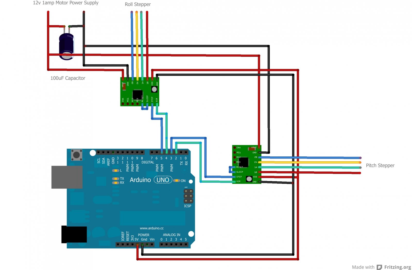

    Here is something I have been slowly working on, this is not driven by any lib like AccelStepper as the library has a blocking function in it, basically it pauses the code until the stepper has finished moving before the code continues and if another block of data hits the serial port and the stepper is moving the data will be ignored , a lot stepper dashes I have seen in the past don't achieve smooth movements or seem to lag or suddenly a gauge works then doesn't work, this is why.
    Please note this was designed to run a model only but you can upscale the schem by using the right bigger stepper driver , ie One that's compatible with a 5v input command, then we can drive them with an Ard.

  9. markus
    markus New Member
    Oct 29, 2014
    328Coins
    +23 / 0 / -0
    Hi eaorobbie, thanks for helping.
    This is what i'm searching for.
    Do you have the Arduino sketch for this?
    Thanks a lot
