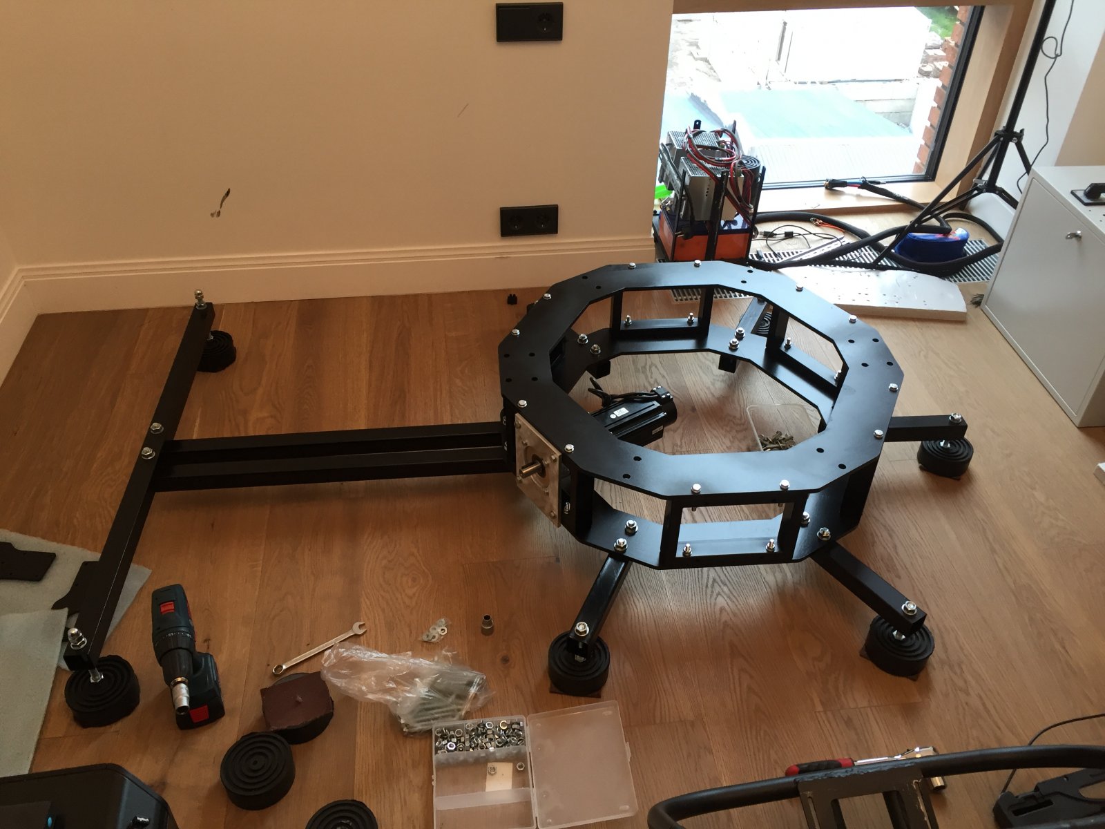

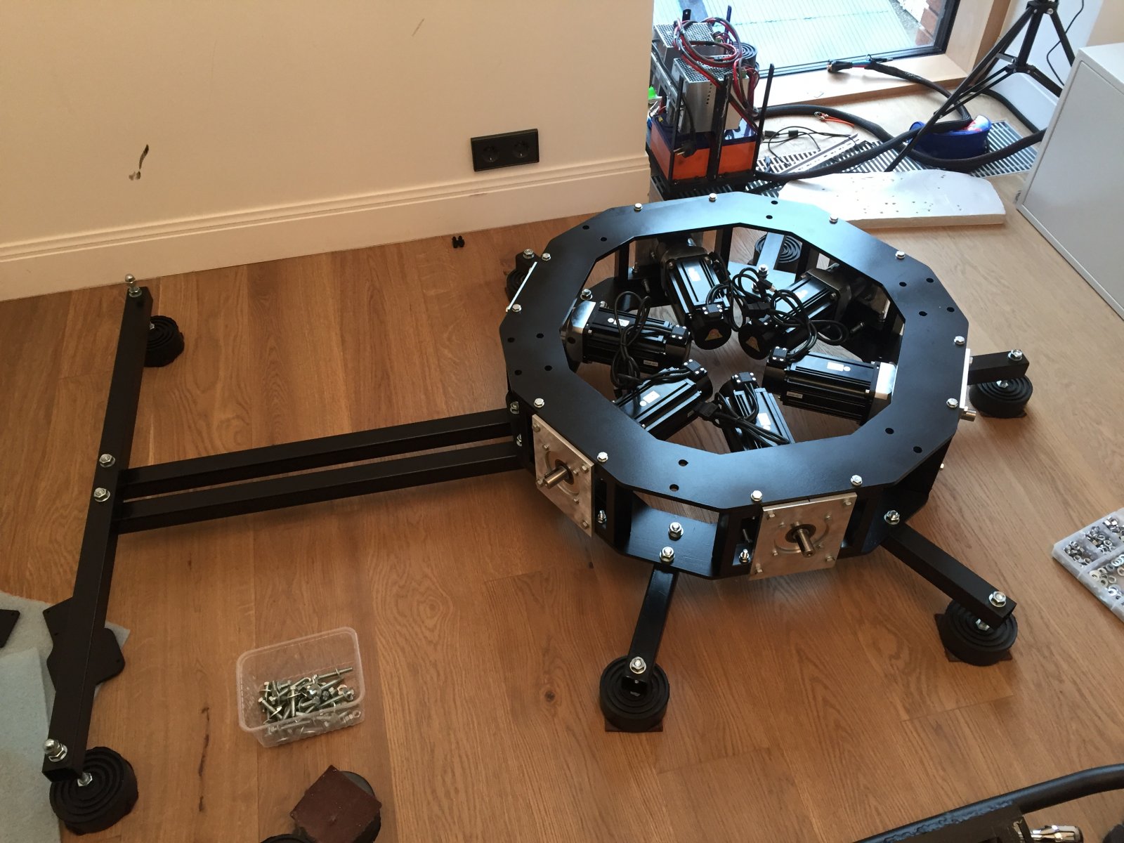

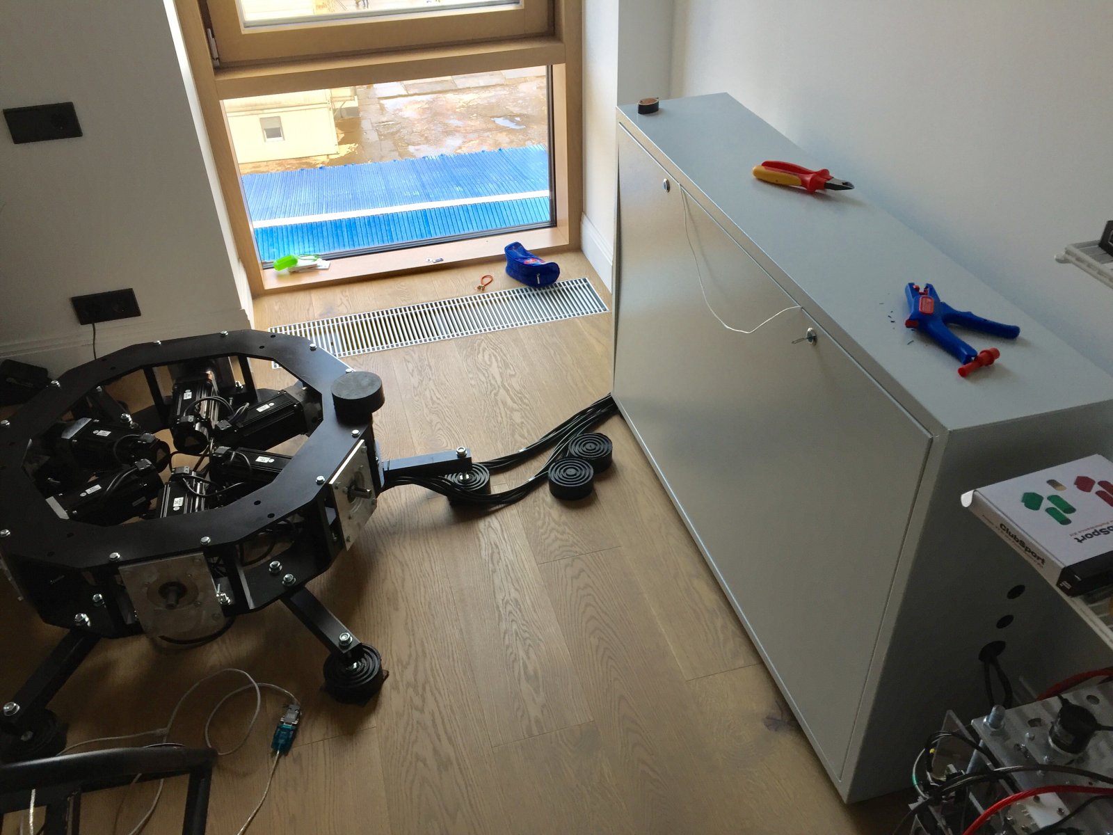

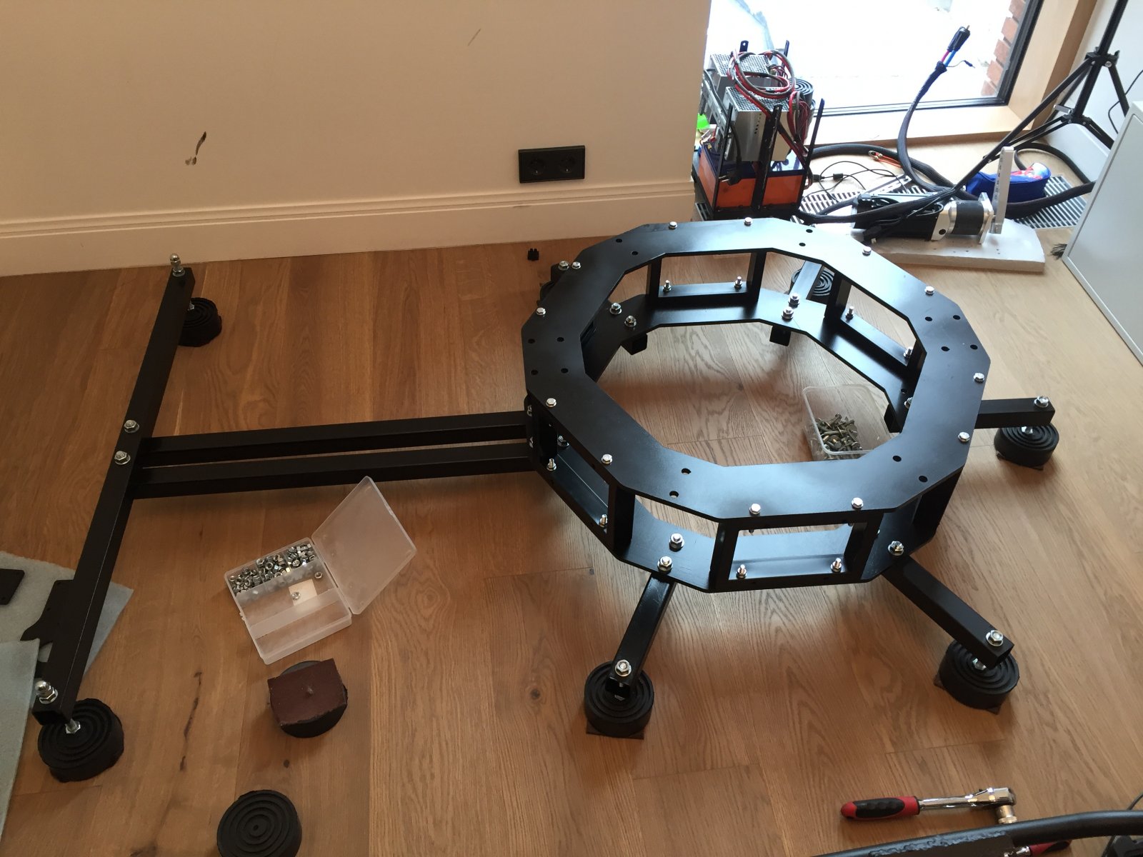

    Base is complete, motors installed.
    7BB9A4C9-673B-46DA-BB1F-D259193A83B3.jpeg 92854982-2753-4AC0-AF12-89F91A1485CD.jpeg 1262002A-BC85-4572-8A5A-BB669ED22F14.jpeg
    I have also connected the servo drivers and did some initial tests yesterday.

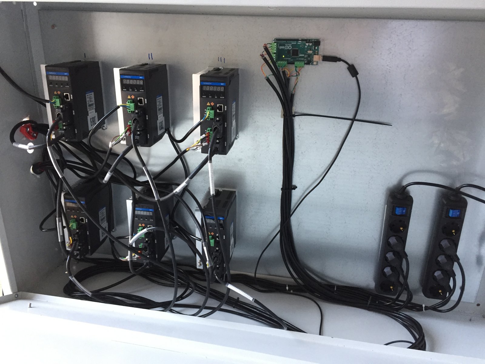

    I made a small mistake when ordering a box for the servo drivers and had quite a surprise when this monster was delivered:
    Anyway, now I have plenty of space to store the electrics. Probably, this can also accommodate all the 24V stuff, including the two batteries.

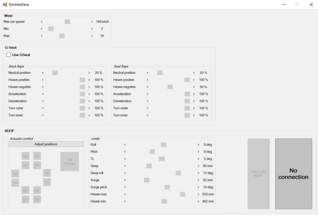

    I have a vb.net app sitting between Simtools and the servos. That app knows the limits of movement for each DOF, gets 12 bit values for each DOF from Simtools and can convert that to offsets in mm for sway, surge and heave and degrees for roll, pitch and traction loss. Then I apply 3D transforms to the coordinates of rod attachment points to understand where these points should be in the target cockpit position/orientation. Finally, I apply the method that I explained in the post for my first 6dof to get the required lever angles.
    With such approach, I can really have all my lever and rod lengths different, motors placed not in a perfectly symmetrical manner — and still have correct cockpit movements.

    I modified the software that I use to convert 6DOF values from Simtools to the cockpit pose, so that to be able to adjust the ranges of movement for each DOF. Now the software also allows to adjust the balance between linear movement and tilting in surge and sway. Combination of the settings available in Simtools and the ones that I now have in my software provide quite a lot of flexibility.
    I have not yet spent much time refining the settings, but I already see that only very limited movement ranges are needed when using VR. This would be even more so when g-seat is re-connected and takes care of longer-lasting sway and surge forces. As can be seen, I limited the heave range to less than 100mm or just about 50 mm each way from neutral. Even with that, I truly regretted having a bit excessive vertical speed when touching down a Cessna.
