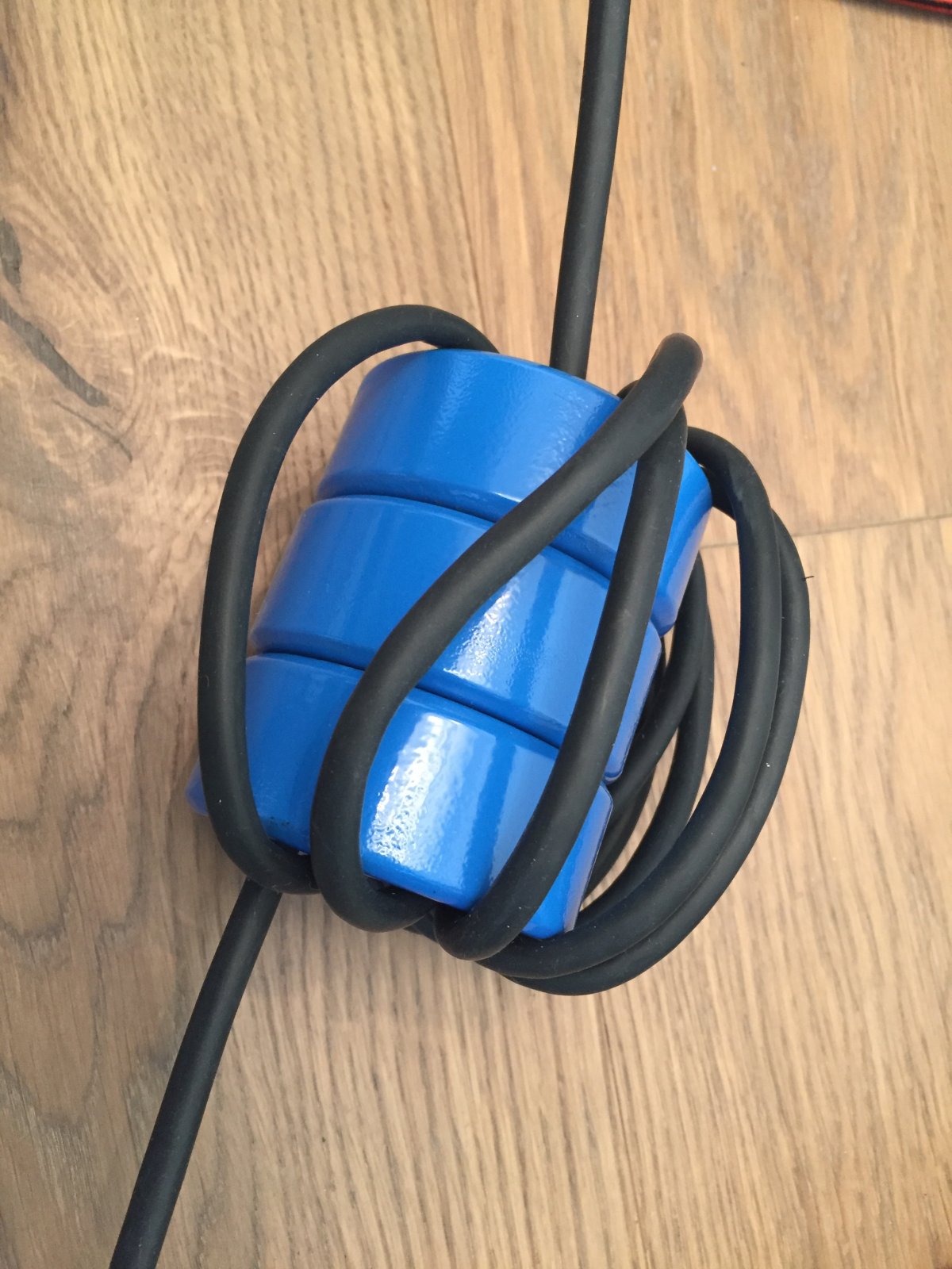

    I am having a strange problem trying to get my Vive Pro work with my new AC servo 6dof setup: immediately after I power up my motors the Vive starts loosing tracking in a periodic manner: three seconds with tracking and then five seconds off.
    Tracking works when I walk away from the rig and it works if I take the headset off and hold it in a stretched hand when sitting in the cockpit. Tracking gets lost if I bring the headset closer to my head or touch it with my second hand.
    Looks like some radio interference issue.
    Has anyone had a similar problem? Were you able to solve it?

    It seems that Vive is indeed susceptible to radio interference, I found several posts on reddit describing similar symptoms when there is a powerful radio transmitter nearby. The advice from one of the Vive developers is to add several large ferrite rings to the wire between the headset and the pc. I really hope that would help, it would be disappointing if I have to return to three screens setup.
  6. Grigory
    Grigory Active Member Gold Contributor
    Jul 6, 2016
    202
    Moscow
    212Coins
    +304 / 1 / -0
    3DOF, 6DOF
    It worked!
    I bought three beefy ferrite rings, passed as much wire as I could through and around them — no more tracking losses.

    Do you have a similar problem with wireless setup? I actually planned to switch to wireless if the ferrite solution did not work. My understanding is that it is that long wire that acts as an antenna picking up interference.

    Did what? You wrote that you had a poorly soldered ground connection, which is not my case. I have the whole rig, including all six servos, grounded.
    Unfortunately Vive is very sensitive to interference. People were reporting similar issues when using it close to refrigerators or air conditioners. The solution with the large ferrite rings was proposed by one of the Vive developers.
