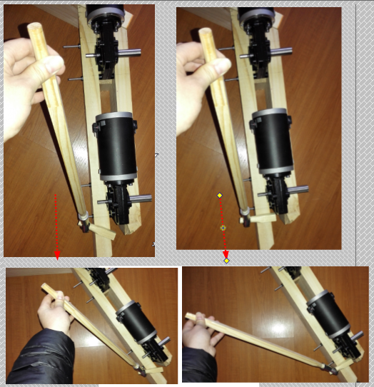

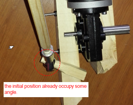

    Hi Grigory, I took some pictures, if you put the shaft as left, the angle will be limited. (maybe I understand wrongly, you have no this issue)

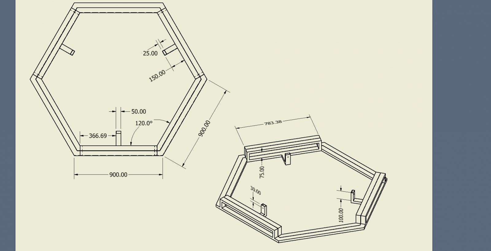

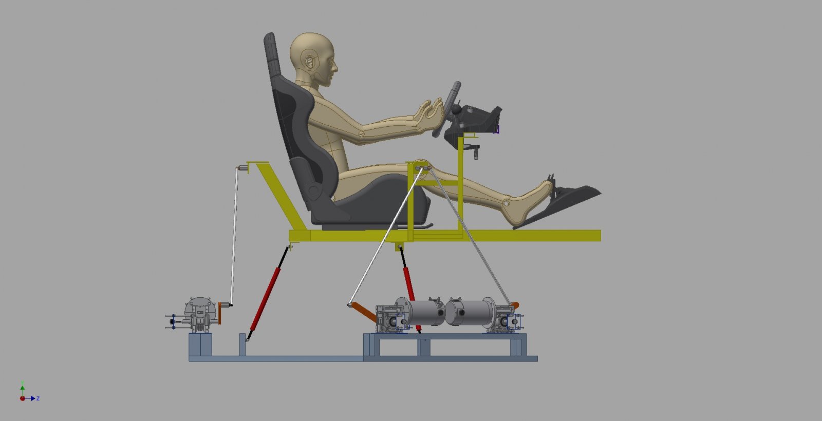

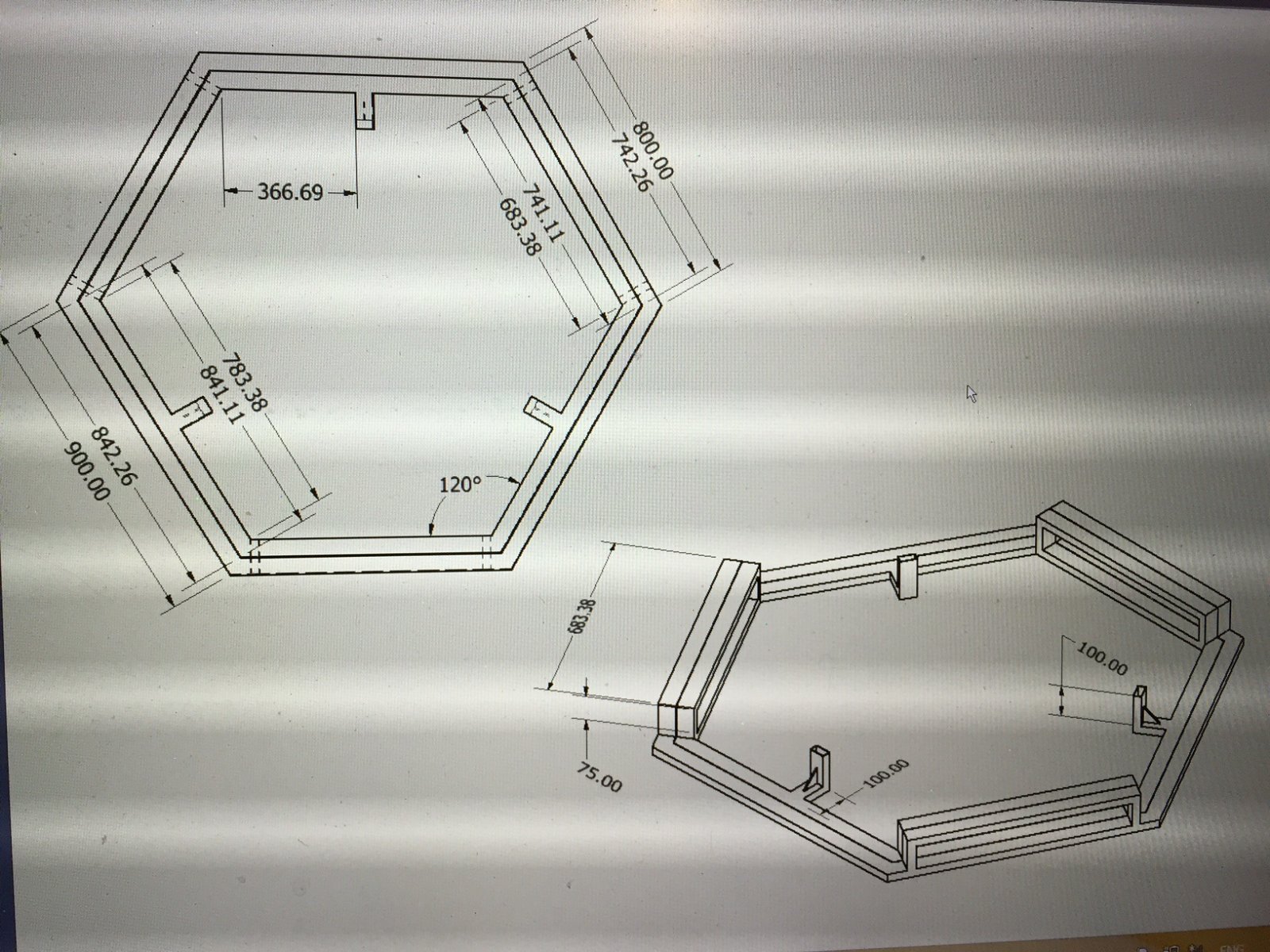

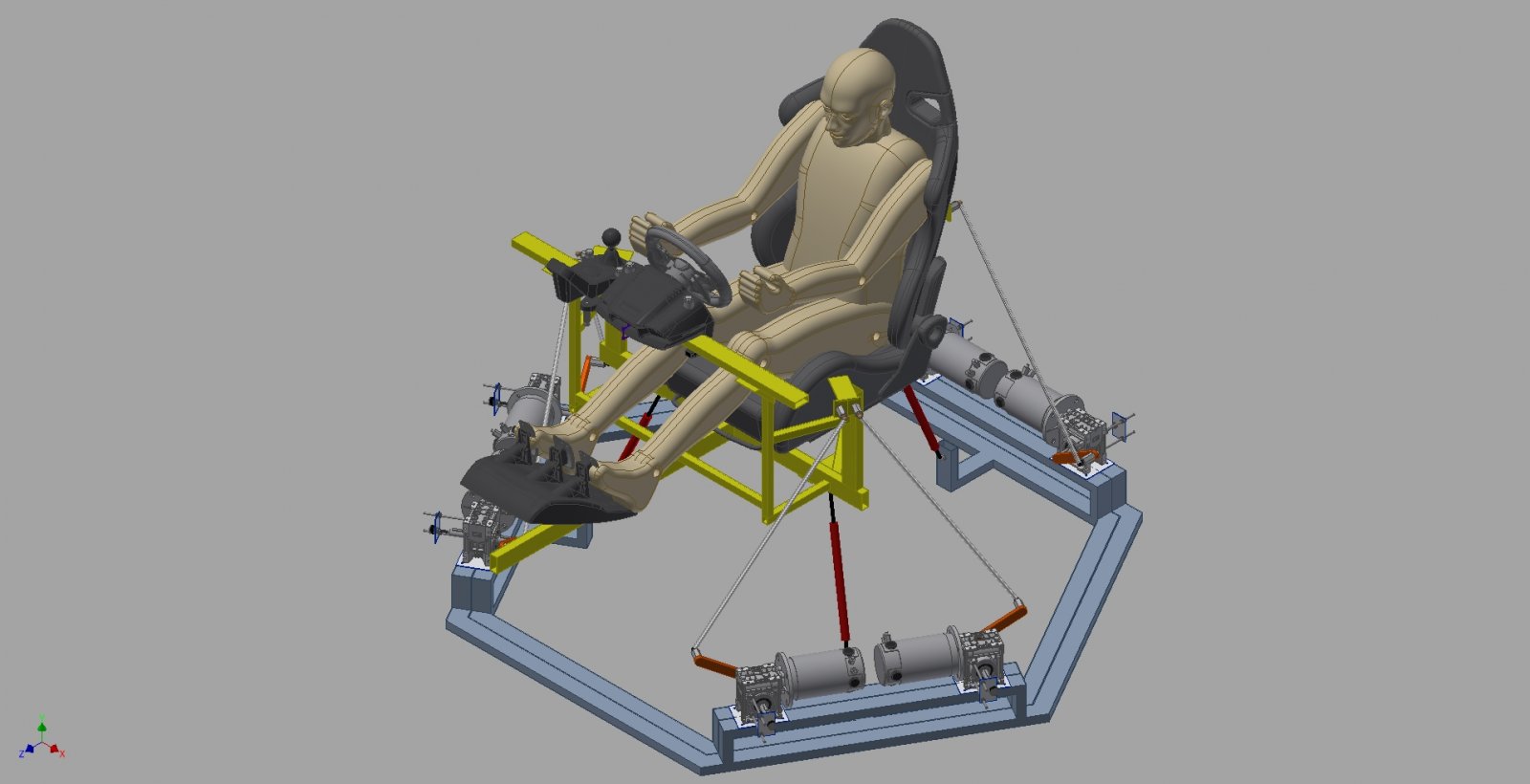

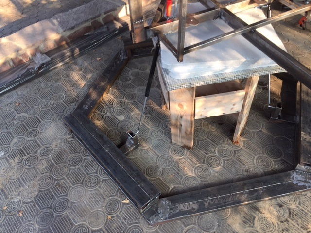

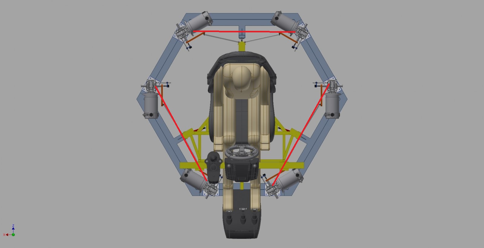

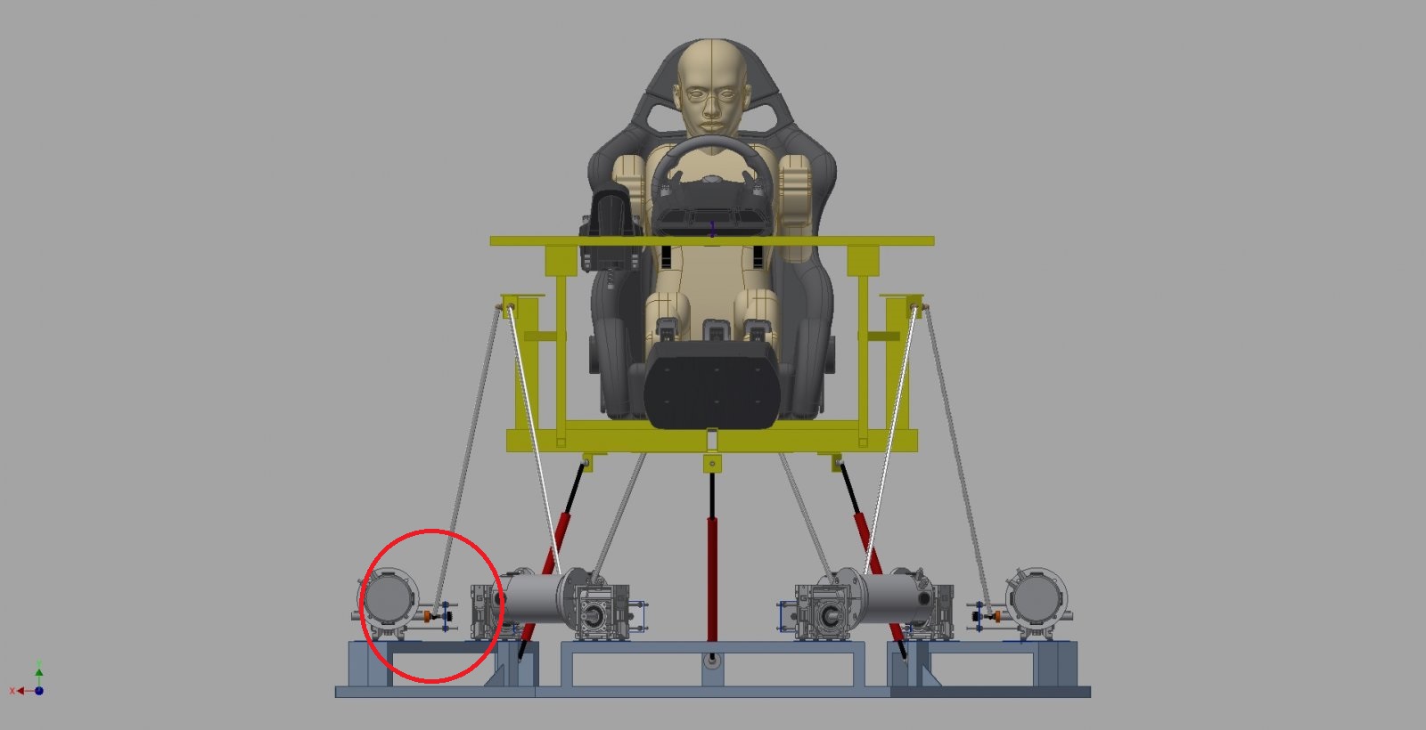

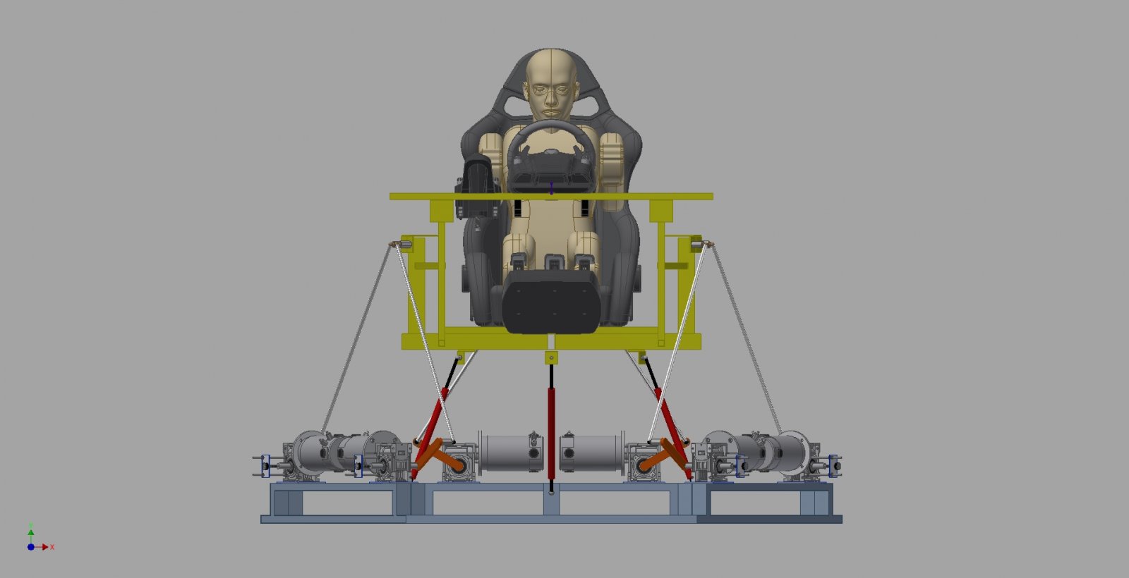

    I modified the base frame and changed orientation of the motors accordingly:
    The angle between motor lever and rod would be about 90 degrees in the neutral position: when gas sptings are in the middle of their stroke range:
    I had to increase the size of the base a little, so that to avoid rods leaning too much outwards when swaying/surging.
    I estimate that this configuration should support about ±110mm movement range on heave and sway, ±150mm on surge and about ±15° tilt.

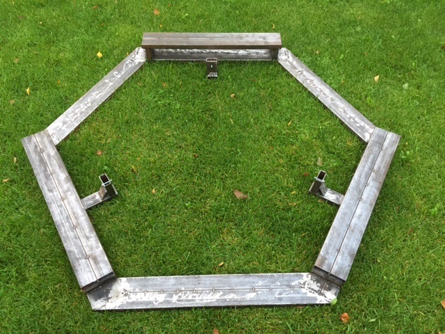

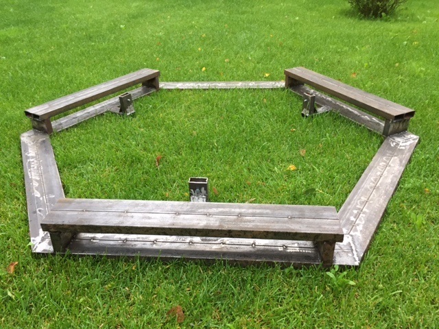

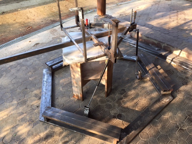

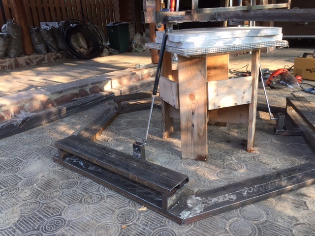

    Welded the base:
    Gas springs fit well and they do not seem to limit range of motion too much.
    I'm planning to fit the motors, levers and rods next weekend. I'll also grind and paint it, so that the whole thing resembles Mad Max props a bit less.

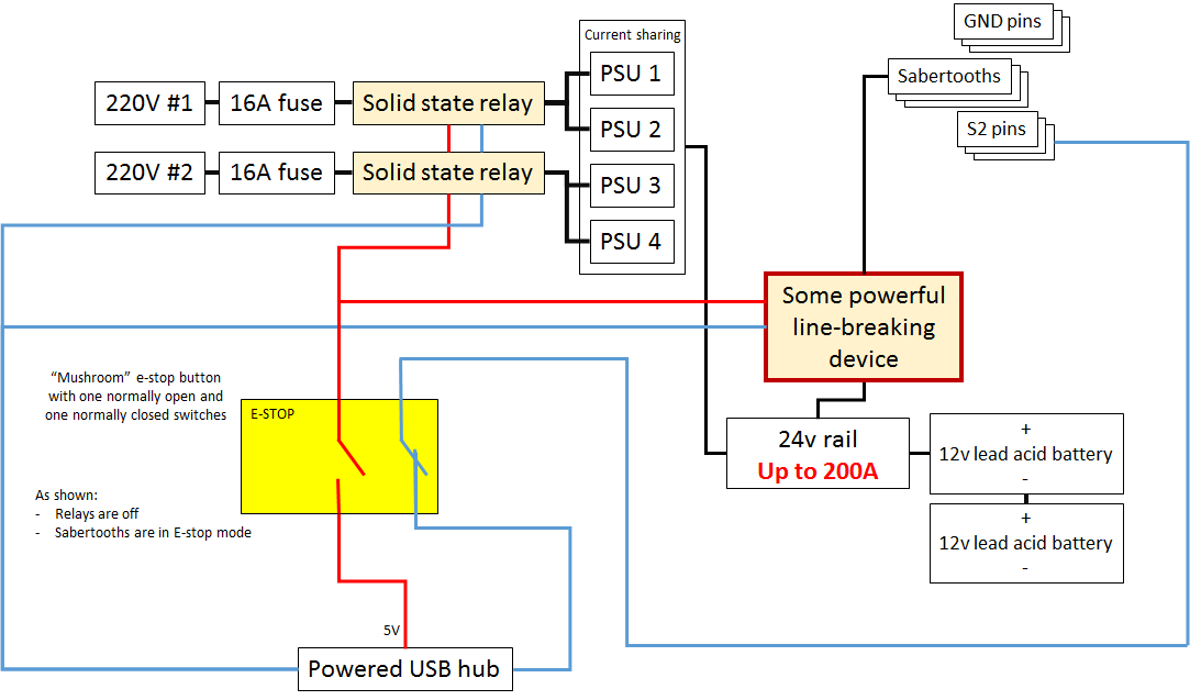

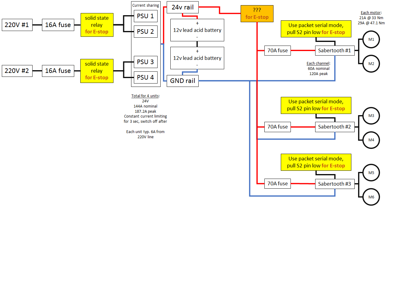

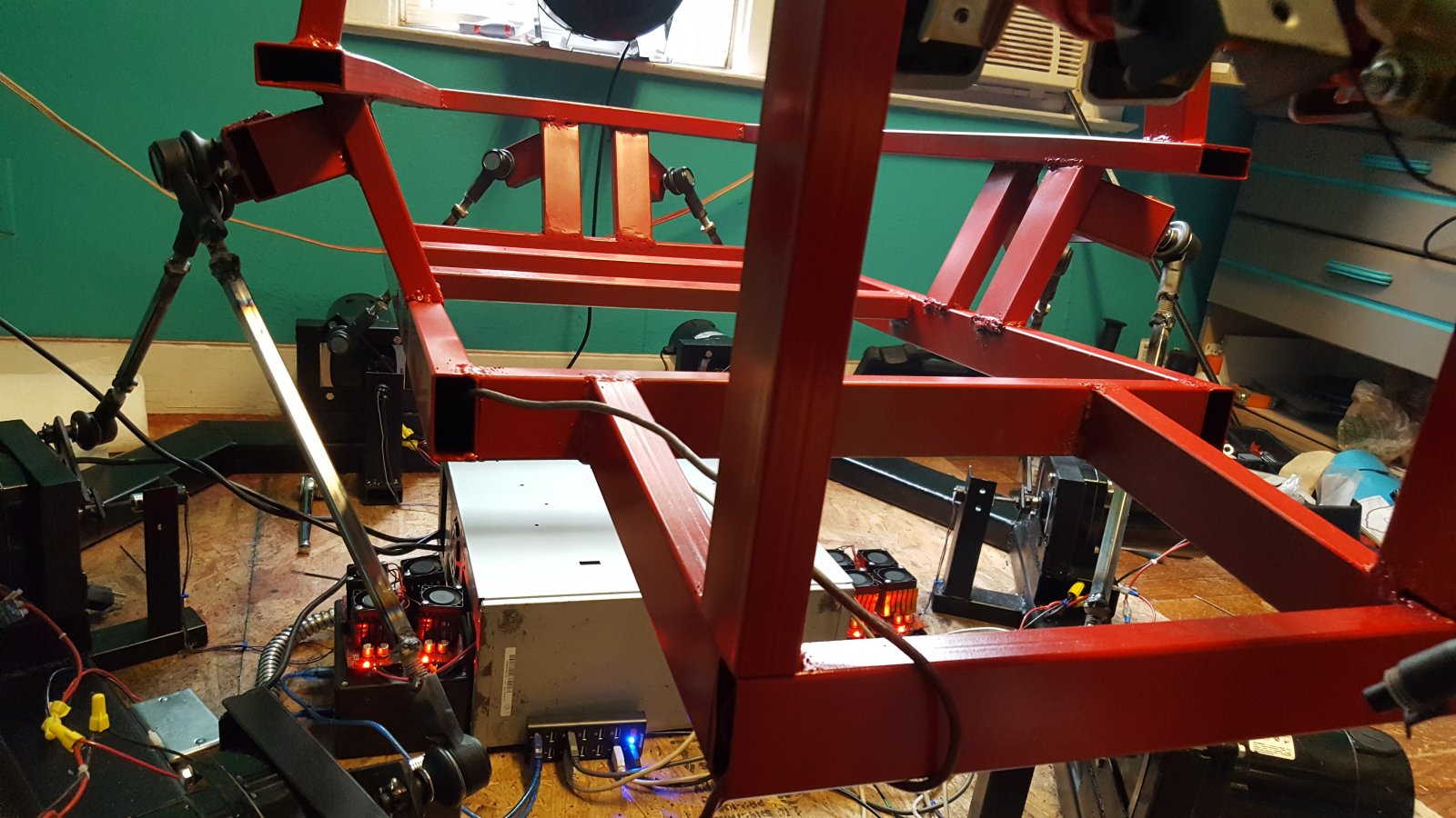

    Something is very wrong with my IBT-2's: they keep heating to over 110°C when running my motors without any load. Instead of trying to solve that I decided to upgrade to Sabertooth 2x60A.

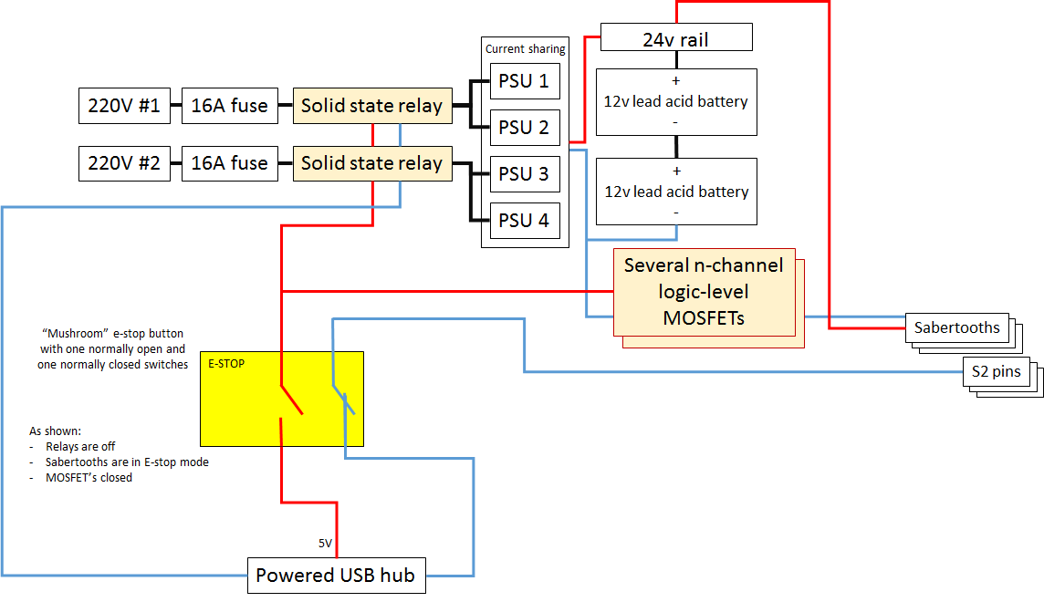

    Here is how I see the new power scheme:
    Sabertooth requires a battery connected in parallel with power supply to absorb back currents from the motors. Unfortunately, that makes an emergency switch located prior to PSU insufficient, as the battery will still be powering the motors even if 220V is cut off.
    Sabertooths Packetized Serial mode allows S2 pin to be used as emergency stop trigger, so that could be one solution if I can modify existing SMC3 code to work with Packetized Serial instead of the currently supported Simple Serial.
    I would, however, prefer to have something "more hardware" for e-stop. Can anyone recommend a way to cut a 24v line from the rail to Sabertooths with huge currents that it may carry?

    I believe some beefy MOSFET's could be used to break the line to GND instead:
    But is it a good solution for emergency stopping?

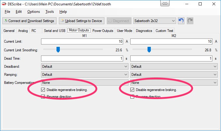

    They state this on their website in bold: https://www.dimensionengineering.com/products/sabertooth2x60
    I believe that, unlike 2x32, 2x60 cannot have regeneration turned off and always back-feeds power to the power source when motors are braking.
  14. Grigory
    Grigory Active Member Gold Contributor
    Jul 6, 2016
    202
    Moscow
    224Coins
    +305 / 1 / -0
    3DOF, 6DOF
    Wrote to DE support and got a response (they are amazingly quick in providing assistance!):
    I think I'll just use the built-in function then.

    What about capacitors for the back feed? If you do go batteries make sure they are sealed or they may vent harmful fumes.

    Capacitors may work as well, I believe. I do not have any idea, however, how to calculate the required capacity. That's why I intend to use two 12v AGM car batteries in series.

    Sabertooth 2x32 is version 3 driver and ability to work without buffer battery is one of the benefits. Judging by the data sheets, this does not apply to 2x60, unfortunately.
  19. Pit
    3,007
    30,512Coins
    +3,098 / 31 / -0
    Unfortunately, indeed. The 2x32 should be the first choice at least, which doesn't help you of course.
