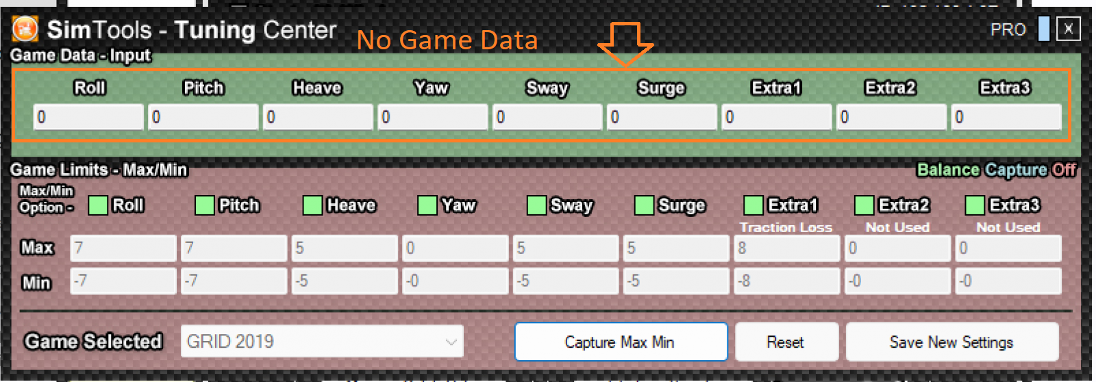

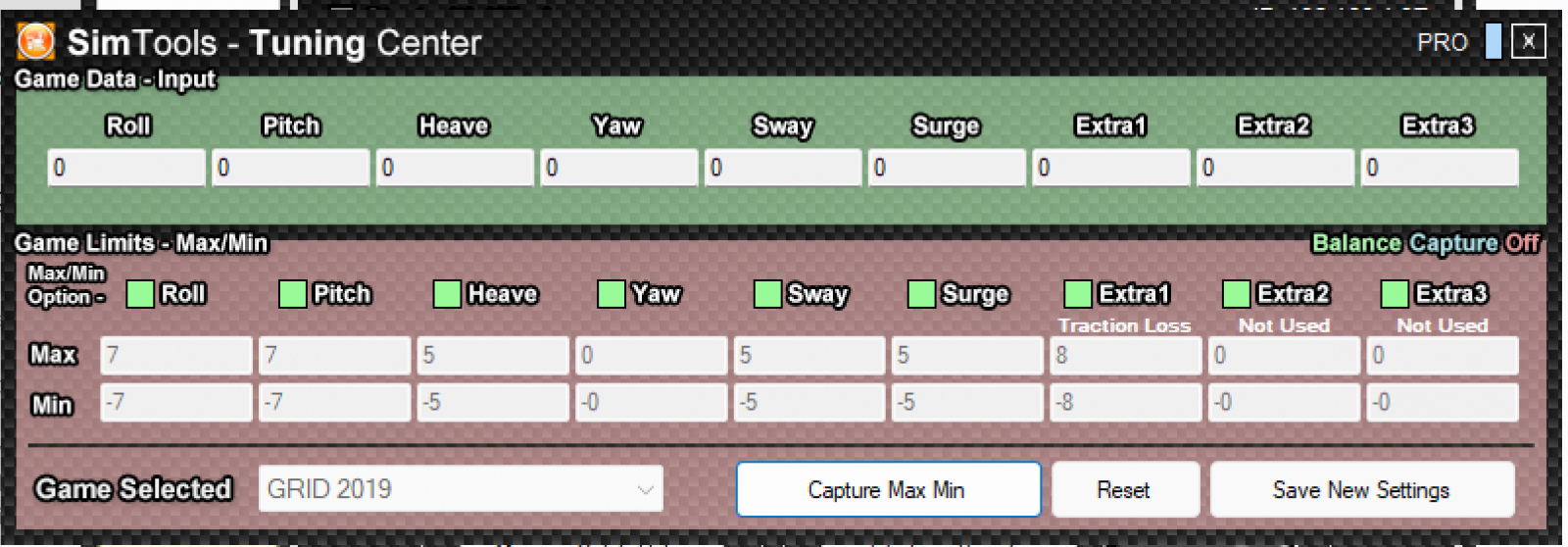

    These are my settings in the tuning center with the game running
  12. noorbeast
    22,159
    154,580Coins
    +11,190 / 57 / -2
    That shows no game data at all, which would mean no motion on any axis, did you start a race?

    Yea I was in the middle of a race. I'm definitely getting motion though. You can see the blue button in the corner. I'm getting motion just not heave and the motion is kind of weak. Only this game
    22,159
    154,580Coins
    +11,190 / 57 / -2
    There is no game data in the image you posted, so it can't be accurate if you have motion:

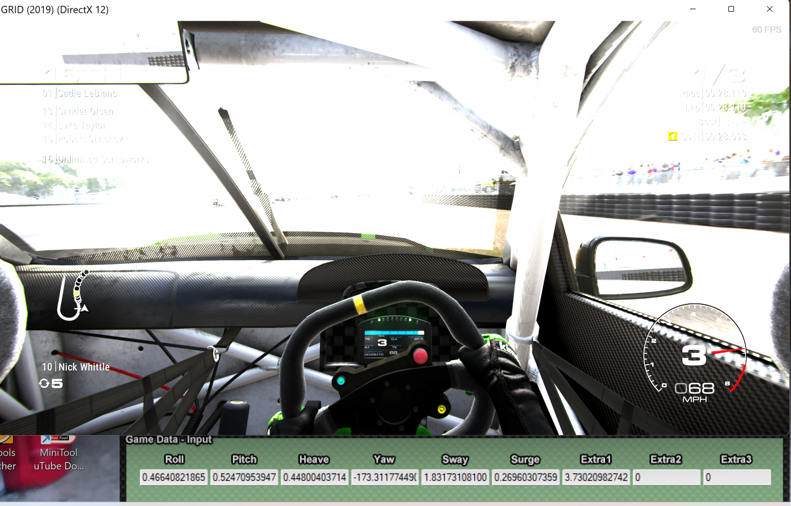

    Have the game running in a window, so that the Tuning Center can be seen at the same time, has data, and take and post a picture of that.
    I expect if heave data is present you can set heave somewhere around 0.5 - 1 in the Tuning Center you will feel it, and will be able to tweak from there.

    I can window it. I think I can delay the snapshot long enough to unpause the game, drive and capture the data
    I'll try it; thanks

    Looks like the output is on a super small scale...not sure why.
  19. noorbeast
    22,159
    154,580Coins
    +11,190 / 57 / -2
    The reason is likely that the car is on pretty level ground with small axis movement.
    Heave data is present, so use a lower value for heave in the Tuning Center to sharpen the heave motion.
