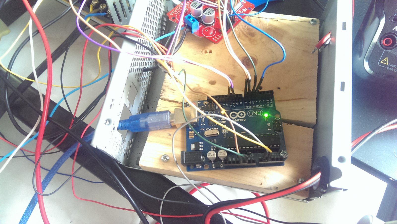

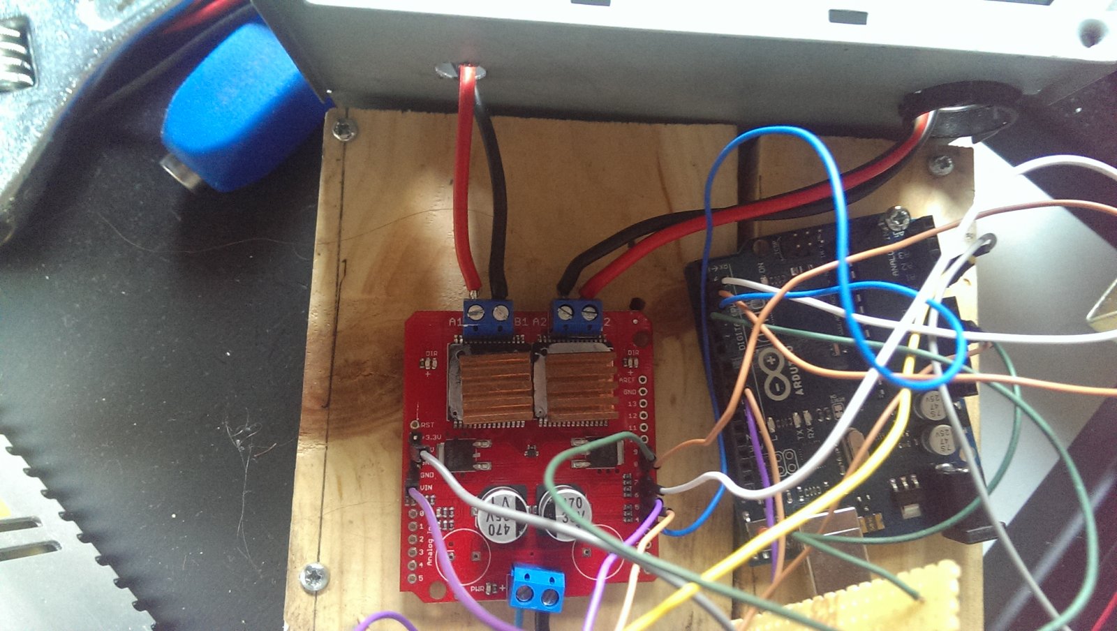

    First of all, SMC3 will stop the motors if they will pass the clip input or latest at the Max Limits line. If one motor do that like you have described IMO the polarity of this motor has to be checked out. If I plug in the USB connector while the PSU is on and the motors are at different positions the motors should turn into the middle position and then they are stopping.
    To measure the voltage you disconnect the motors from the MM and connect the volt meter. Sine is a welcome test to check out if the polarity will switch and if the voltage is 12V (or -12V) and not less.
    If you want to be sure if the Ard or the MM has some errors, you have to switch the Ard wiring and then the MM wiring as well for testing with.
    PS: do not give up ;)

    @Pit : So tested the things and it seem the motor 1 part of the MM does not give down that much voltage when the motor should be going downwards, but chech my video maybe my conclusion is not good:
    Motor1:
    Motor2:
    Original cabling where green line moving towards blue target properly on both motors:
    Since I have no better idea I think I will take apart the MM solderings and resolder the blue things of A1/B1, maybe there is some kind of problem...

    Redoing the soldering of A1/B1 was not the problem, the swithed polarity still sucks.. So I guess that is the source of my suffering?

    So getting both the Arduino and the MM changed, thankfully the ebay sellers are top sellers.

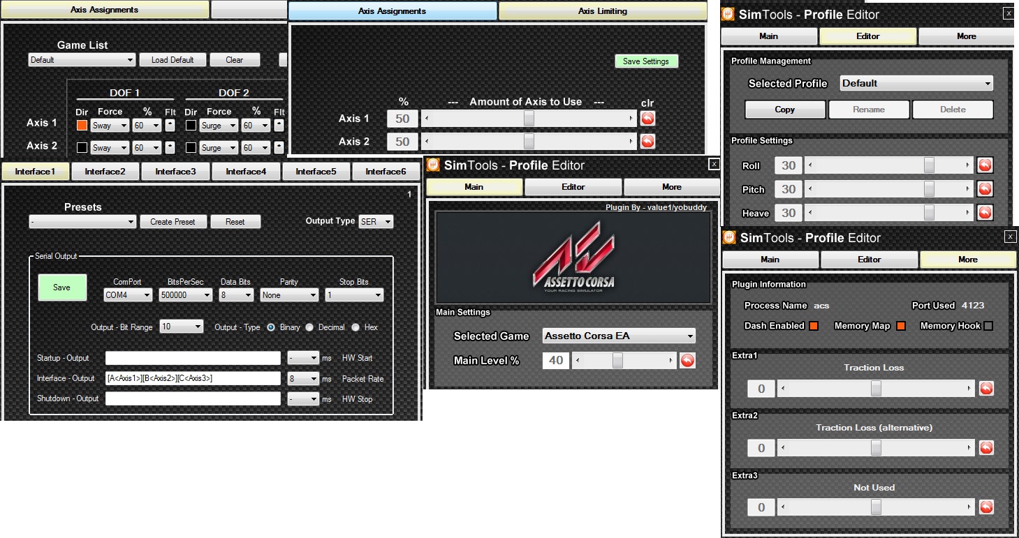

    Finally everything is working properly.
    It seems both motors have a little lag?!

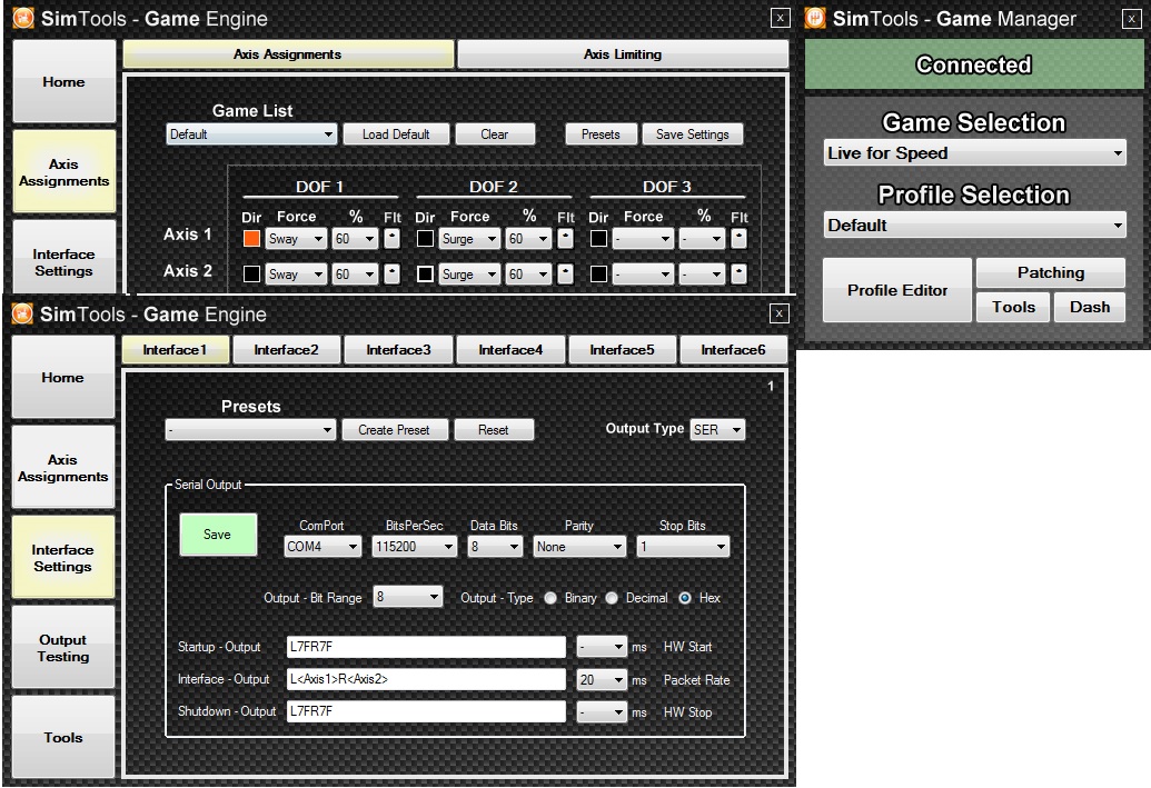

    Now I went through the setup guide of simtool, but when trying to test the simulator manually nothing happens.
    Settings:
  13. Pit
    3,012
    30,480Coins
    +3,097 / 31 / -0
    bitspersec should be 500000 and interface output 10ms

    Changed it but no luck.
    But if the SMC3 Utility can control the Arduino then its a setting issue with simtool?!

    Sooooooooo, fiddled about with things, finalized the box holding the electornics and fired up the baby :)
    For some strange reason only AC gets me motion, LFS no, but that is not that bad.
    Made a small video, unfortunately the program is trial so sorry about the text in the middle... Can't seem to find a normal software for this?!...(any tips welcome)
    To me it looks like the right hand side motor is not really doing much?!!!..
    Also the starting position of the two arms seem to be a bit off...
    These are my settings:
    Can someone please suggest a direction I should start going in?
    I will install Project Cars too, but AC is my main simulation for now.
    Thanks for the help guys! :)

    Have a look at the open source Open Broadcaster Software, it is free and you can record multiple sources including game windows, monitors and webcams: https://obsproject.com/download
    It seems the motors spend the majority of their time at or near a fully extended position, why is that?
    Your axis % allocations should be around 100%, you can go a bit over but don't overdo it.
    Why the axis limiting and low main level %, are you being so cautious for a reason?
