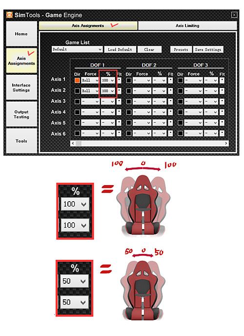

    Let's see if I understood starting from this assumption: The greater the percentage assigned to a movement in the axis the greater the value in tuning center can be set. In other words, if for example on an axis you set 100 for the roll, I could accept a very high value in the tuning center and the simulator would be reactive. If, on the other hand, I assigned a roll value of 20 to a certain axis, I would have to set a very low value in tuning center with consequent loss of detail.
    If I set the values of my two axes (axis 1 and 2) in this way 15 roll, 15 pitch, 25 surge, 30 heave, 35 sway then altogether about 120. With these values assigned within the game and in tuning center imposed "capture max-min". I drive on the track without exaggerating and save the values that result. So I return to play with values saved here in tuning center but the simulator is not very reactive.
    It is correct rather than reducing the values in tuning center, as if you lose the details go to increase the percentage assigned to each effect in the axis configuration, even if in this way my total value exceeds 120. The increase until leaving unchanged values first saved in tuning center my simulator becomes reactive.
    Is this reasoning correct?
    Informazioni su Google TraduttoreCommunityPer cellulariTutto su GooglePrivacy e TerminiGuidaInvia commenti
  3. yobuddy
    51,769Coins
    +5,206 / 19 / -0
    Not really buddy.
    Axis Assignments is so you can mix the DOF's into a way that makes sense for your simulator.
    Tuning Center values is so that the system knows how to handle each DOF properly.
    Personally I would setup the Axis Assignments settings to what makes logical since for the simulator first. Then I would use tuning center to capture the best Min / Max as I can for the game.
    Hope that makes sense buddy!

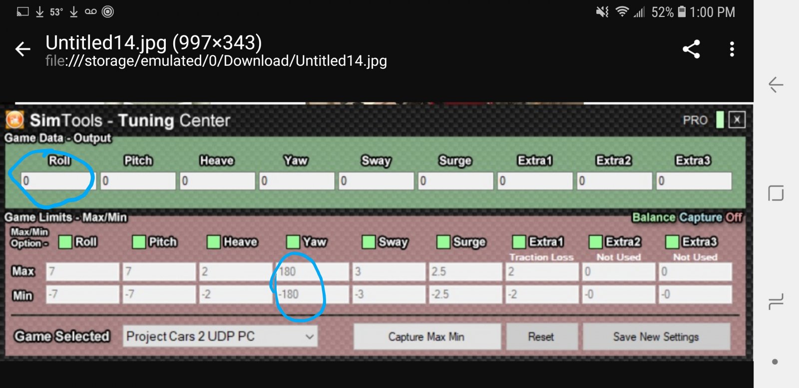

    Hi guys, I have a few questions .
    1) When I do the capture max/min in the tuning center , some of the axes get a very narrow range (ie. +2 -2) , why do I get such narrow ranges and how much of an incremental or decremental of these numbers affects the rig compared to changes done to axes that have a wider range (ie . 7 -7)? I mean how minimum is the change in that number (+2 -2) that has still some sort of effect on the rig ?
    2) Also, I notice that to yaw it is assigned the value (180 -180) but yaw is not even active in my axes set up. Yaw is assigned to extra 1. Would I need to change that yaw number too along with the numbers in extra 1 to have changes in the yaw?
    3) the data output Raw stays always to zero for me. Do those numbers need to be changed manually and what values should be?
  7. yobuddy
    51,769Coins
    +5,206 / 19 / -0
    It's what the game provides. It really does not matter to be honest.
    All games we have currently can do a 360, so this setting is correct.
    No, because you are not using it, you using traction loss from extra1, so you just need to adjust the extra1 max / min values.
    This is the output from the game, you will get data here when the game is running.
    Take care buddy!

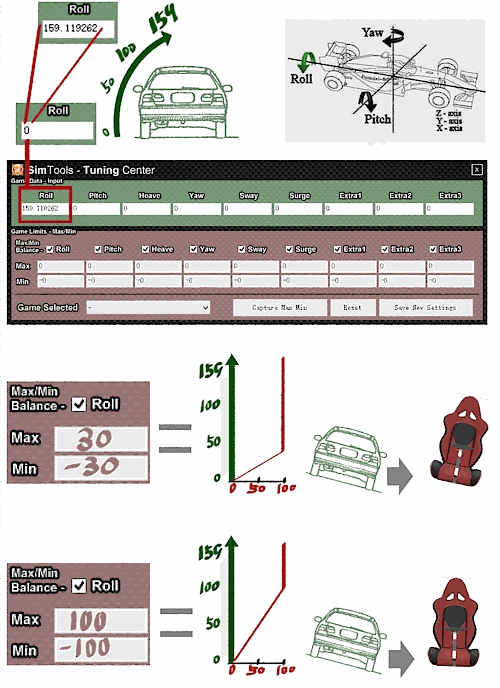

    I read the whole thread now the 2nd time, but I am still unsure, if I got it right.
    So, that`s what I understand:
    In the Game Data - Output fields of the Tuning Center are the telemetry values from the game (when running). The range is irrelevant and depends of the game.
    When you capture, you get the max/min values out of those data fields into your Max/Min fields, where you can also manually adapt them, if necessary.
    The meaning of the values is as follows:
    Example: Captured Max value for roll: 3.521
    That means that this value is taken as maximum (all values above, e.g. 4.0, are set to 3.521) as input for the rig /axis movement but also inccoperating the assigned axis value for "roll".
    If roll is set to 100% in GameEngine, and rig has 20° roll movement and when game is delivering 3.521 for roll (or above), axis is moving 100%, hence 20° degree.
    If assigned axis movement for roll is 50%, the axis would move to 10° degree, the same as if the game data would be 1.7605 and axis movement for roll at 100%.
    When you manually set the Max value to e.g. 4.0, then your axis will move only to 17,6° degree (88% of 20° degree, as 3.521 is 88% of 4.0) when a data value of 3.521 is sent by the game (assuming 100% axis assignment to roll).
    --> Higher values in Max/Min in TuningCenter: Faster reaction of axis, but not the full range of axis (assuming not more than 100% is assigned to axis).
    Is my assumption correct ?

    Simtools uses the value from the game.
    If value out of minimum and maximum (in tuning center), it's cropped to minimum and maximum.
    If you are outputting 10 bits from Simtools to the hardware, it's values from 0 to 1023.
    For example you have -10 to +10 in tuning center then:
    Game outputs -10 => 0 output to hardware
    Game outputs -12 => value cropped to -10 => 0 output to hardware
    Game outputs 0 => 511 output to hardware
    Game outputs 10 => 1023 output to hardware
    Game outputs 15 >= value cropped to 10 => 1023 output to hardware
    The resulting degrees/position on the hardware depends on how you treat the 0 to 1024 values on your hardware.

    Ok, that is exactly how I understand it.
    But then a higher value for Min/Max means a smaller (but faster) movement of the axis.
    Example: Game provides values between -7 and 7. If Max/Min is set to 7 / -7 and the current value is 7, then 1023 (10 bit ADC) is output to hardware (assuming axis assignment is 100%) which is maximal movement of axis.
    Now, if Max/Min is set manually to 10/-10, and the current value is the same (7) then only 717 is the output value (which results in a lesser movement of the axis, but quicker, as this point is reached earlier in time).
    Or is this completely nonsense what I am writing ???
  19. yobuddy
    51,769Coins
    +5,206 / 19 / -0
    @Arazok,
    the Smaller the value in the tuning center the faster the output is.
    Yes, but you have more range. So it takes longer to max the output out.
    There for a values of -7 and 7 would make for faster output over -10 and 10.
