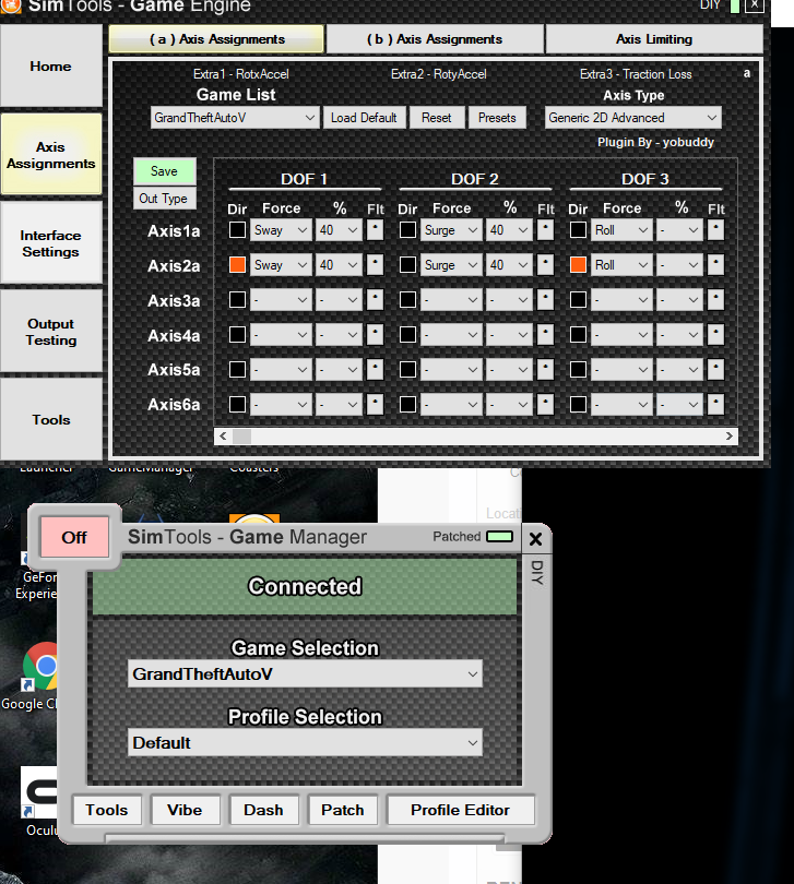

    TODAY I WANTED TO TRY THE GTA WITH THE PLUIG AND I DON'T KNOW WHAT HAPPENS THAT IT DOESN'T WORK, I'M UNINSTALLING GTA TO TEST AGAIN. I HAVE A 2 DOF SIMULATOR, AS I SAID BEFORE WHEN I AM IN A VEHICLE, THE SIMULATOR IS REALLY NORMAL, IF I SPEED THE SIMULATOR FORWARD IF I BRAKE GO FORWARD IF I TURN RIGHT THE SIMULATOR TURNS LEFT. ETC BUT WHEN I GET ON A HELICOPTER EVERYTHING IS THE OPPOSITE TODAY I WILL TRY TO MAKE A VIDEO.

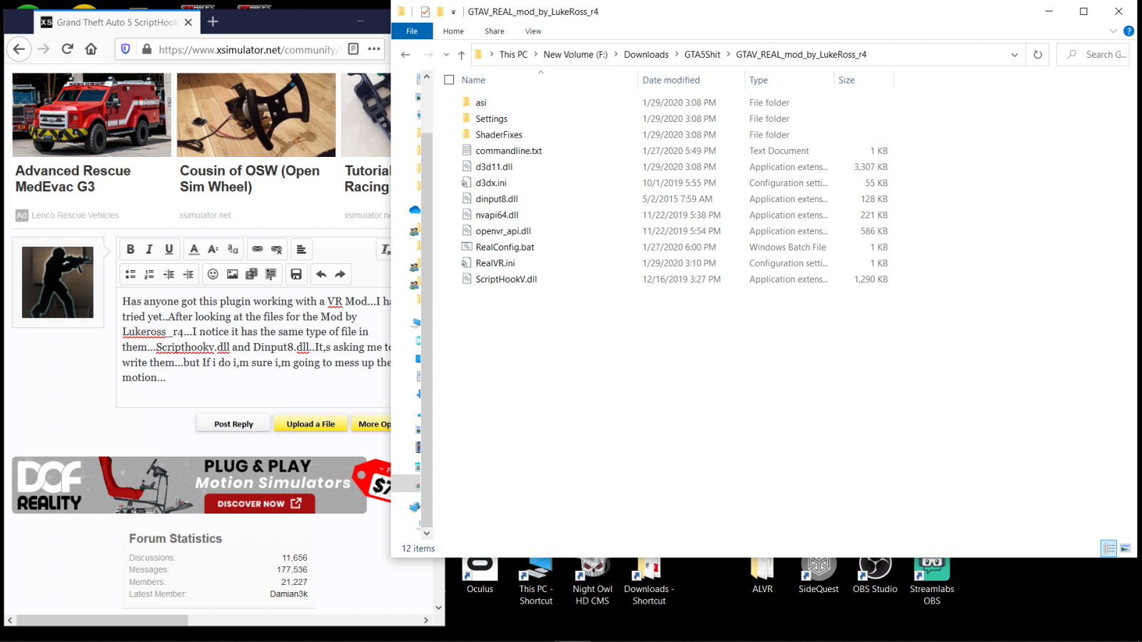

    Has anyone got this plugin working with a VR Mod...I haven't tried yet..After looking at the files for the Mod by Lukeross_r4...I notice it has the same type of file in them...Scripthookv.dll and Dinput8.dll..It,s asking me to over write them...but If i do i,m sure i,m going to mess up the motion...

    back up the files,.. they may be the same, I would use the latest version of them. The latest version ensures it will work with the latest memory map of GTAV.The way I understand it is,... Dinput.dll, is used to inject the ScriptHookv.dll to be used in the game. then ScriptHookv.dll loads the other script files, such as the scripthookdotnet3, which loads this telemetry plugin i created.

    Thank you..I,m going wait till someone on here confirms that it can be done..I get a little lost playing with sub folders...I seem to mess things up the first time around..being this is a very large download to reinstall the game..now that I'm looking around at all the cool Mods this game has...I would love to play this game in VR with controller support..Like this one..
    https://rly.sexy/project/gta-vive seem to be a older Mod..might not work...You guy/gays on here have more talent then me when it come to this stuff...LOL ..Once Again..Thank You ..I,m have a blast running People over...

    I would just run it without overwriting the 2 files, you most likely just installed them and have the latest versions of both... I would suspect that any older mod would work with the newer hook dlls. 2 cents

    [QUOTE = "kevinmarz, post: 199192, member: 31775"] ¿Alguien tiene este plugin trabajando con un VR Mod ... Todavía no lo he intentado ... Después de mirar los archivos para el Mod por Lukeross_r4 ... I observe que tiene el mismo tipo de archivo en ellos ... Scripthookv.dll y Dinput8.dll ... Me está pidiendo que los escriba en exceso ... pero si lo hago, estoy seguro de que voy a estropear el movimiento ... [/ CITA]
    Lo tengo funcionando en Vr con el mod del volante, todo correcto, lo he sobrescrito cuando me preguntaste y sin problemas, previamente instalé el mod vr, luego el mod de movimiento y luego el mod del volante

    ok, here is a photo of how I configured it and it works wonderfully on my 2 dof, sway, surge, roll, pitch.
    well, i'm still with the helicopter error, the only way is every time you get in the helicopter you have to go game engine and reverse the movements with (Dir), but the pluig is excellent. Congratulations!!!
    in case you can see some way to fix that detail from the helicopter it would be great

    You are not using pitch in your image, but you are using surge... i'm assuming on acceleration in a car,.. you surge/tilt back... thats the same thing thats going to happen in a heli when you accelerate forward,... regardless if a heli is actually tilting forward, am I wrong? I think your issue lies in this methodology being used for computing where the arm of your motor is.
    I use a separate controller that I built that has an algorithm on it that determines where the motor arms should be based on all 1-6 individual axis inputs, then it can mix the values on its own as complex as it likes.
    I think this is also where something like Thanos controllers are used for
    https://www.kickstarter.com/projects/1096461972/6dof-electronic-interface-for-motion-simulator-pla
    (let me know if there are better links)
    Anyone else have experience mixing a 2DOF like this method that can chime in?

    That was @Thanos 1280, see the FAQs here: https://www.xsimulator.net/community/faq/amc1280usb-motion-simulator-controller.336/
    @Thanos now has the new AMC-AASD15A servo controller, see the FAQs here: https://www.xsimulator.net/community/faq/amc-aasd15a-servo-controller.351/
    Mixing for a 2DOF motion profile should be done one axis at a time, see the tips and tricks here: https://www.xsimulator.net/community/faq/steps-to-create-a-motion-profile.228/
    You are correct that a number of conflicting things happen with a heli, it will generally pitch forward in flight, so that should be the primary simulation axis. On a 2DOF simulated surge is traditionally set as pitch up for acceleration and pitch down for braking, as with things like cars that is the appropriate simulation. I have not used the plugin but would expect it better to focus on pitch, as that should be consistent between vehicle including the heli and minimise surge on a 2DOF to things like simulating a gear shift, with bigger Min than Max setting in the Tuning Center, using a low number and limited axis movement range: https://www.xsimulator.net/community/faq/snappy-gear-change-motion.121/
